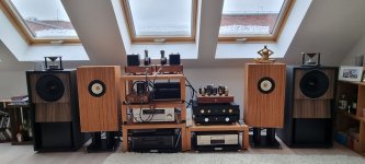

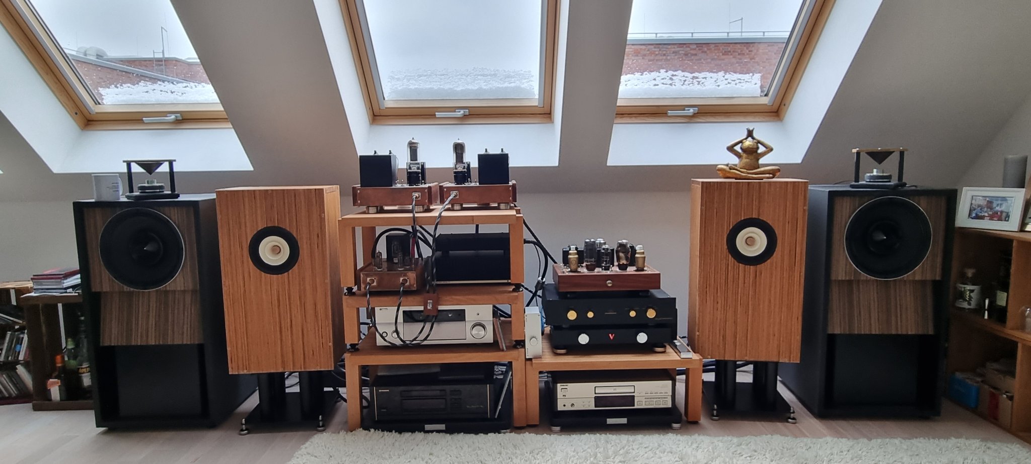

here a KANGLING with sonido 175 and Monacor a double horn,
Qts i thought the EBP is important Reso/Qes, so if the reso is high enough it works, look my Manger Basstuba.

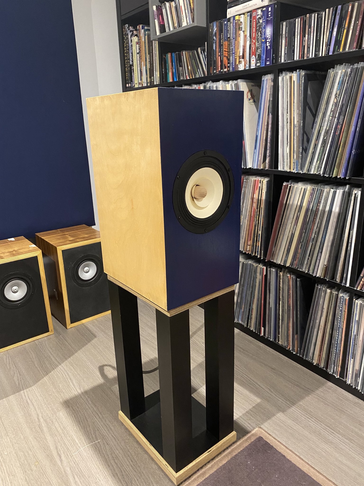

Hi gents,

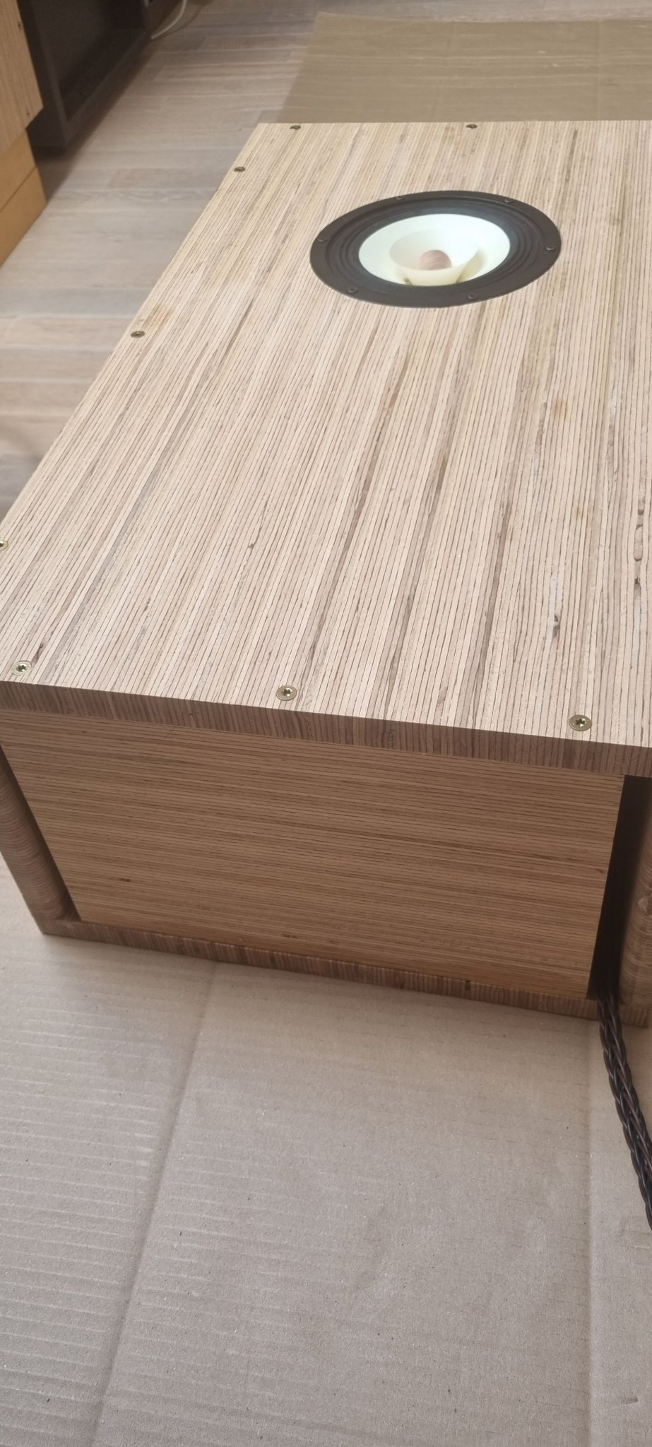

My DIY first try (poor-mans-build) with the lovely SFR175A. This cabinet was recommended by Janos from RealWorldAudio YT-Channel and initially for Fostex FF125WK. No speaker Terminals, Kimber cable direct soldered to driver.
Already have SFR-200A and SWR-300 in spare for next project.
This driver is awesome and this little, slot-ported cabinet is such fun to listen, also low frequencies are fine (sorry, no measures, listening Tests only and always people suprised how big soundstage and vocal precision is...). Of course most power I get with tube gear...
I've to say, I really love those drivers and price/quality is at least for me unbeatable!!

Gerihifi,
Those are nice boxes for your Sonido SFR175A. I just finished building enclosures for my same drivers from plans I got from Scottmoose. I'm really enjoying the sound, very detailed, layered and throw a huge soundstage.

Soundsmith,

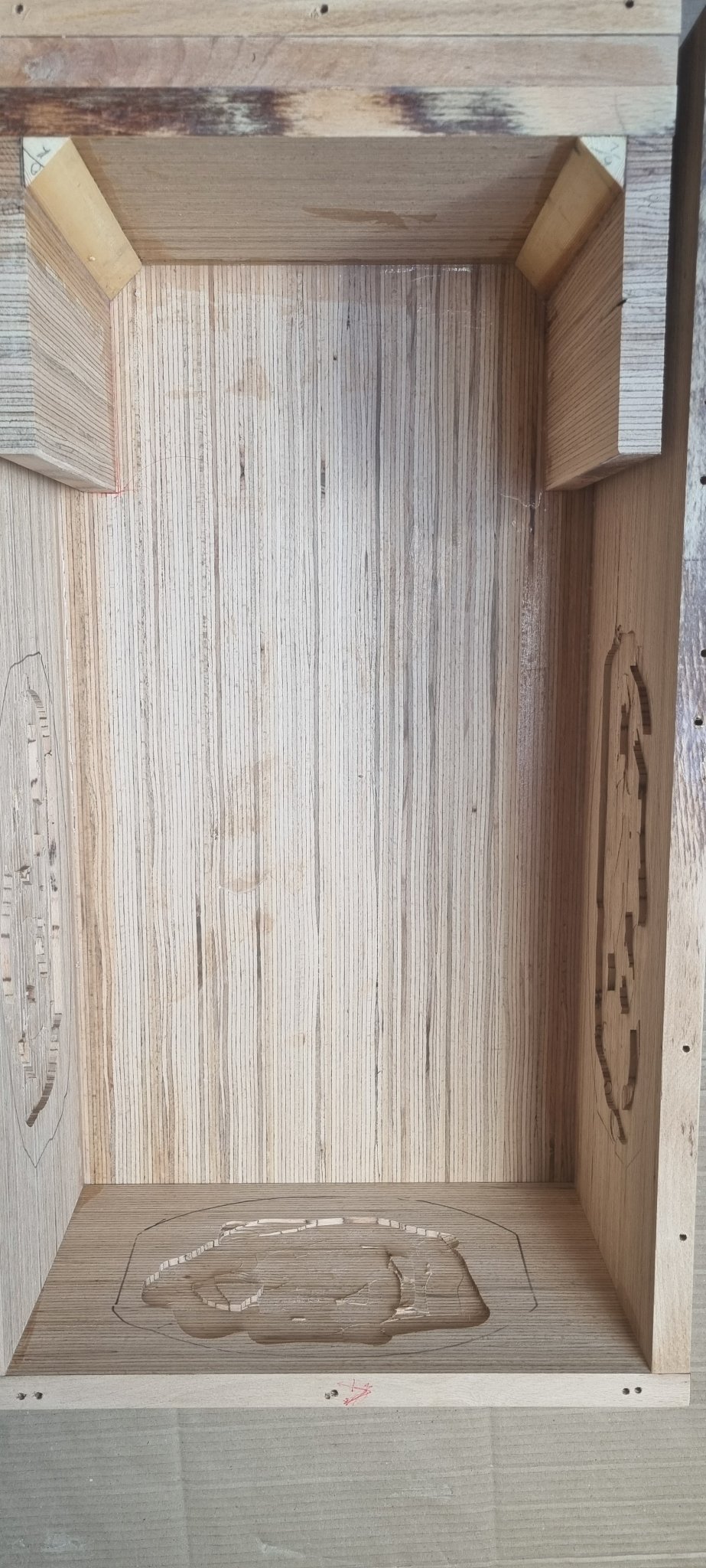

Cabinet is a traditional duct vented standmount. 18mm baltic birch finished with cherry veneer. Baffle is blue stained walnut veneer.
There's front to back and side to side bracing, one above and another below the driver.

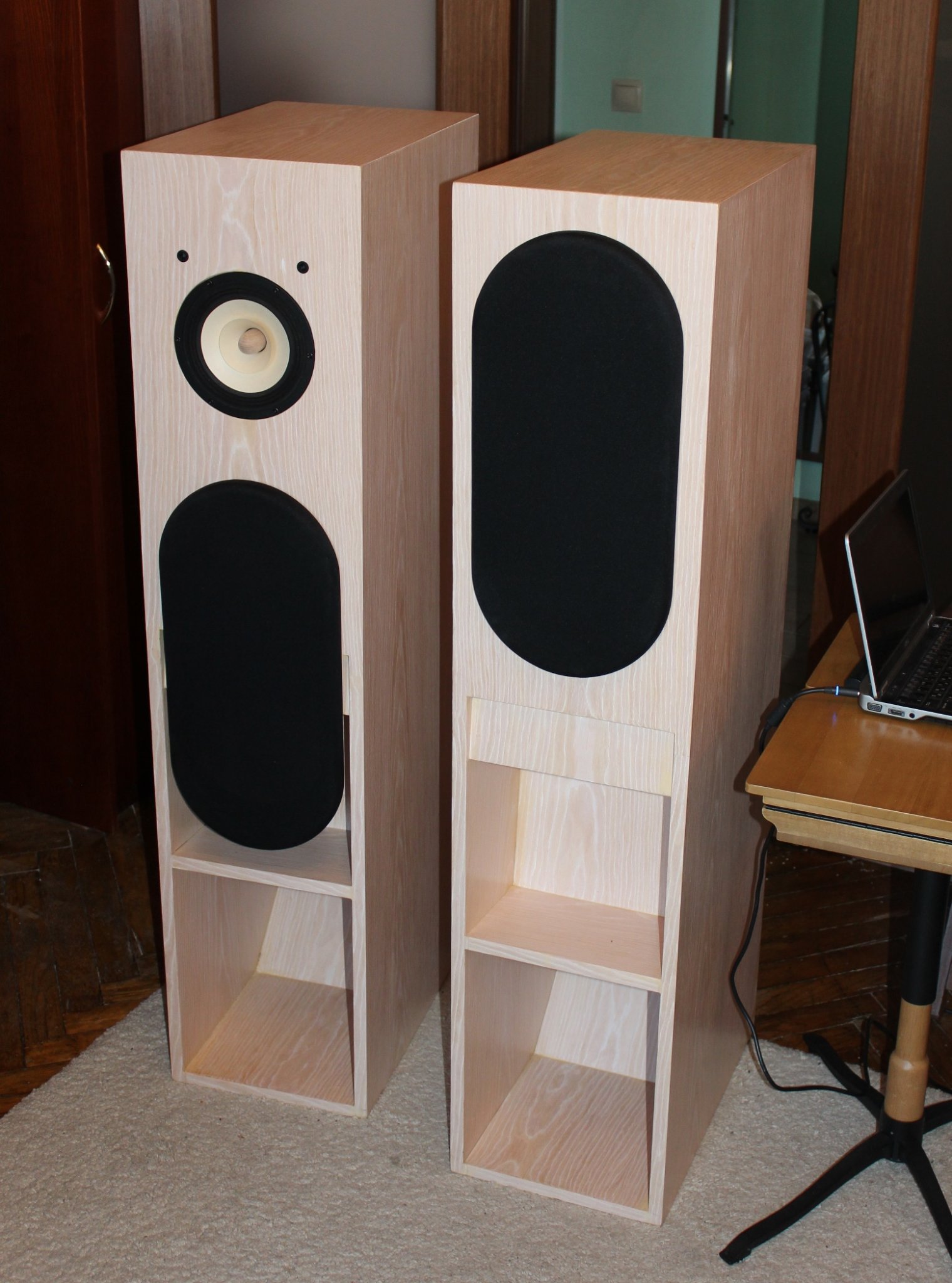

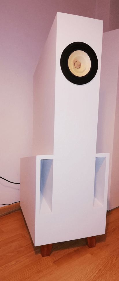

For the SFR 175/A drivers there is also such an excellent Horn box. It can be placed against the wall.
