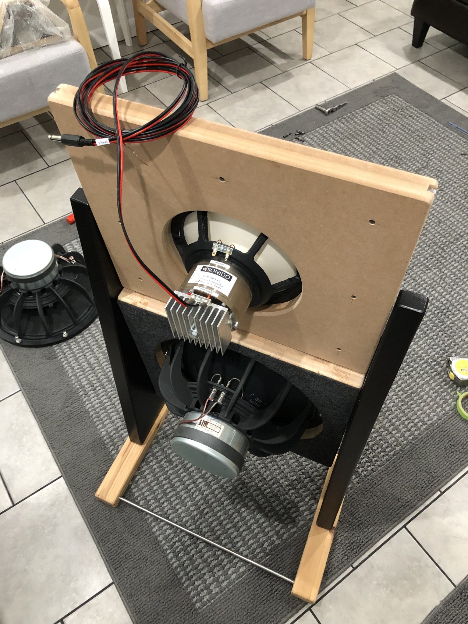

you have enough height for 2 screws at each side of upper panel, if you use wood screws
or you can mount vertically 2 square pipes or L profiles at back side, connecting lower and upper panels, using appropriate wood screws

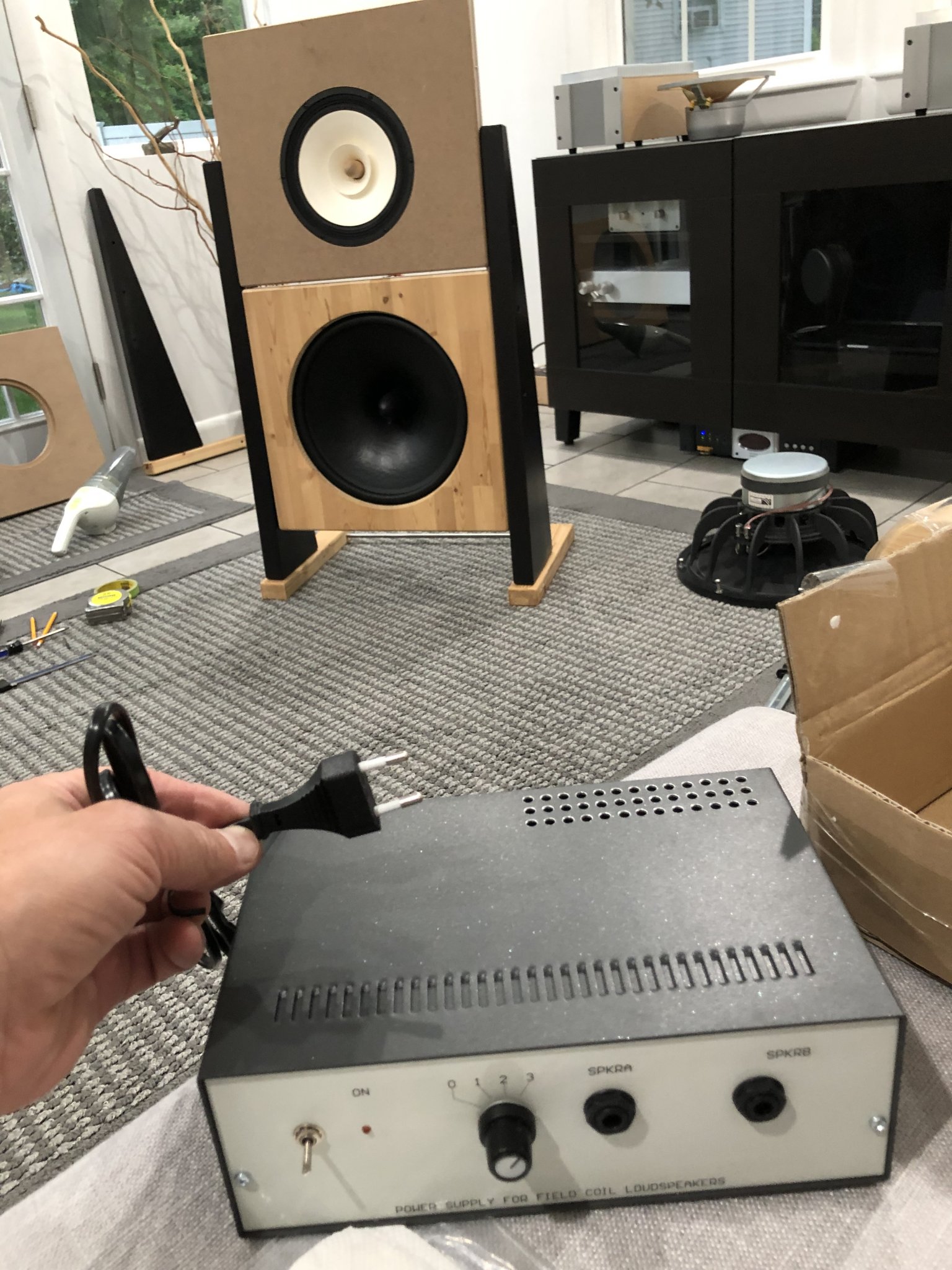

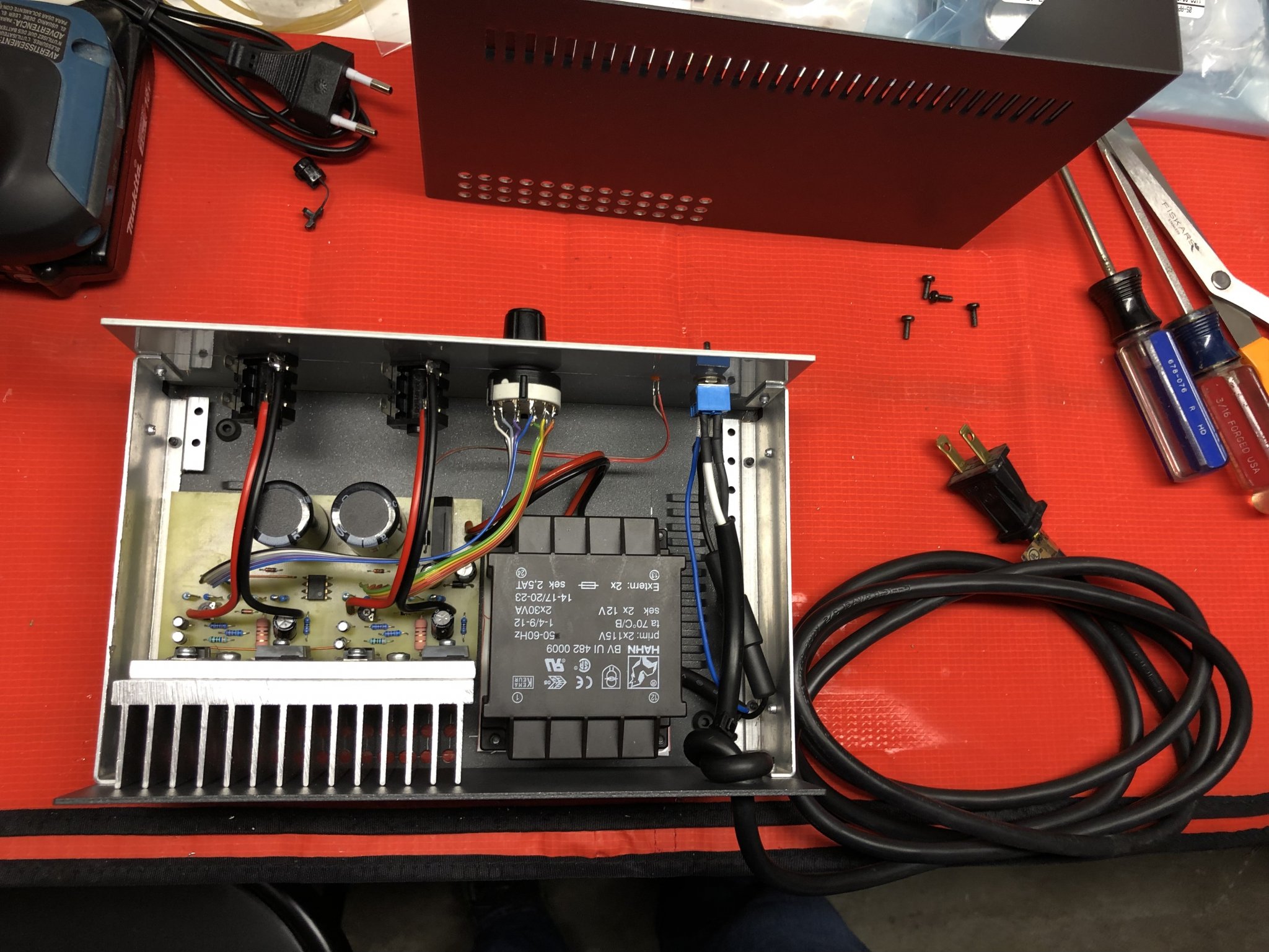

Yeah…I asked Istvan when I got them and checked inside the supply. Dual primary school 115 V 50-60 Hz tranny. Should be fine for US use. Just forgot I needed to rewire it properly 🤦♂️…gotta make sure of polarity and hot line is fused.
Rewired power supply box…just shot Istvan an email to run it by him and ask about output voltage I measured on the bench to make sure its where it should be…about 24.95V DC. Also asked him what setting he recommends for OB.

Pic of the business side of things and the supply guts.

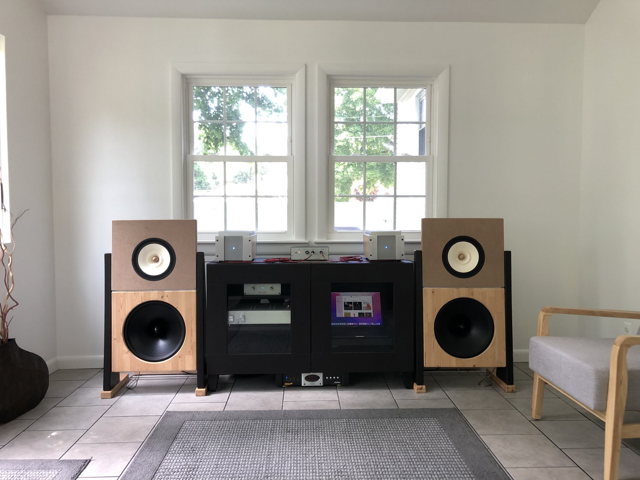

Today is a big day…my son is graduating high school!!!
We will be partying to the sweet sounds if my newly renovated open baffles featuring these wonderful Sonido field coils!
And they are sweet…and full…and ballsy!
First fire up this AM after I finished wiring gave me a deep overtone that I thought was the lack of a top end and need for a tweeter.
After letting them play a few hours I came back and sat down for another listen.
Still bass heavy…so I dialed back the low frequency gain knobs on the B5 crossover.

Istvan said I can play as I like with them on open baffle.
I toggled through from 0-3 settings…according to the data sheet QTS drops as the current being fed to the magnet increases…did I care?
I wanted to free these babys from bass duties anyway.
They seemed to open up and give me little more sparkle.
Lovely room filling sound stage.
Upped the gain at my source…Macbook Pro…things just got better.
Break in?…meh…they sing
I may want to try my Fostex T90A on top to see what happens.
Will try and do some sweeps with REW and my mic eventually.
Amp of choice is F2J monoblocks.
Will have to figure out how to wire up the T90A…Papa has that article on crossovers for current source amps.
For now 😁😁😁

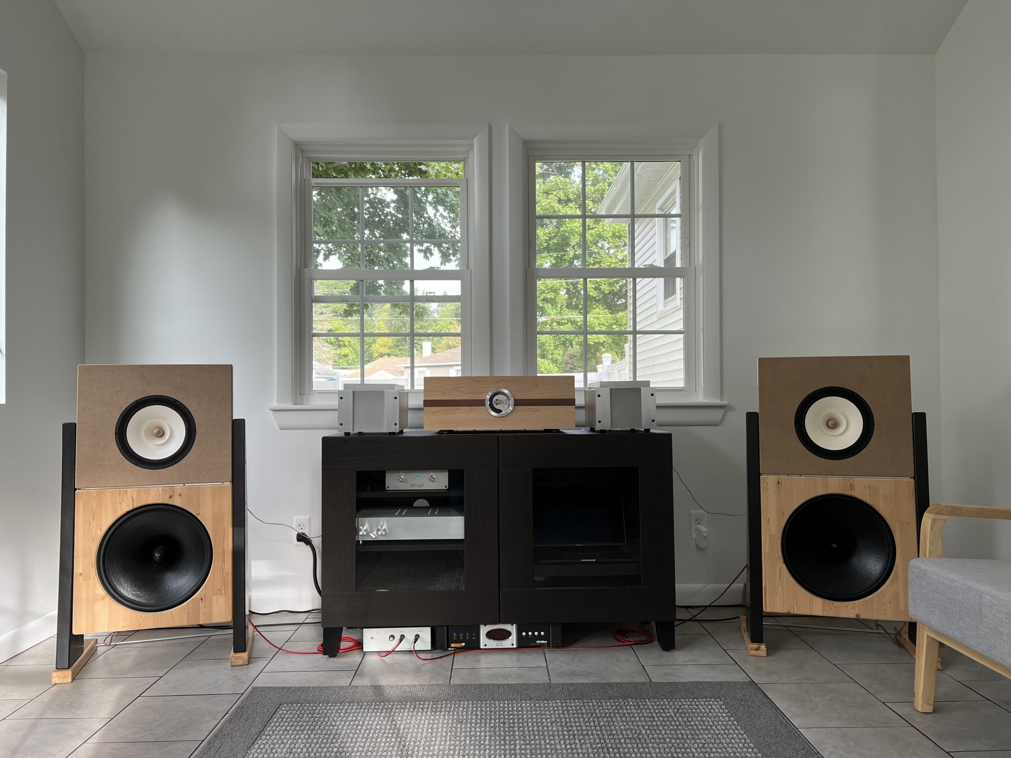

Yes indeed…I am very happy with the sound I am getting from these Sonido field coils. They are played every day.
I have not done any near field or room measurements as of yet…nor have I messed with a super tweeter. To be honest, I’m not anxious to.
I will say that repositioning of the speakers in the room gave me great improvements in sound stage…they are pushed out further and toed in a bit.
I am more preoccupied with resolving my BJ2 amps when I have time to work on them…chasing after some more current and I need better heat dissipation.
Even that is on pause with Fall knocking on our door here in New England…gotta sort the cars out for the cold season and service the furnace.
My greediness has me recently considering buying another pair of Sonido that would fit in a set of Oris front horns I have in storage to see what the results would be…they are that good.

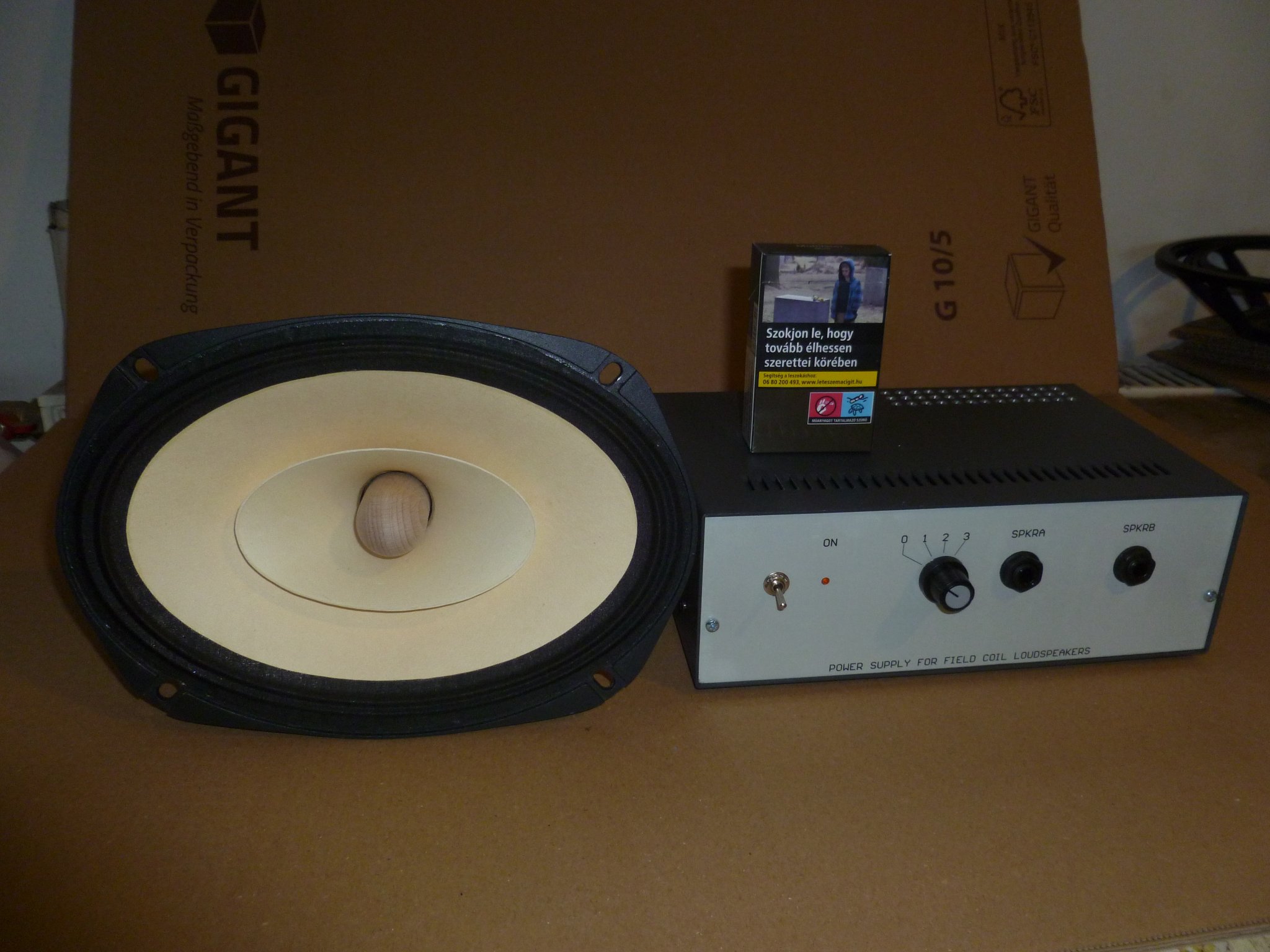

Please the is T/S parameters SONIDO Field-Coil drivers.
/Istvan.
