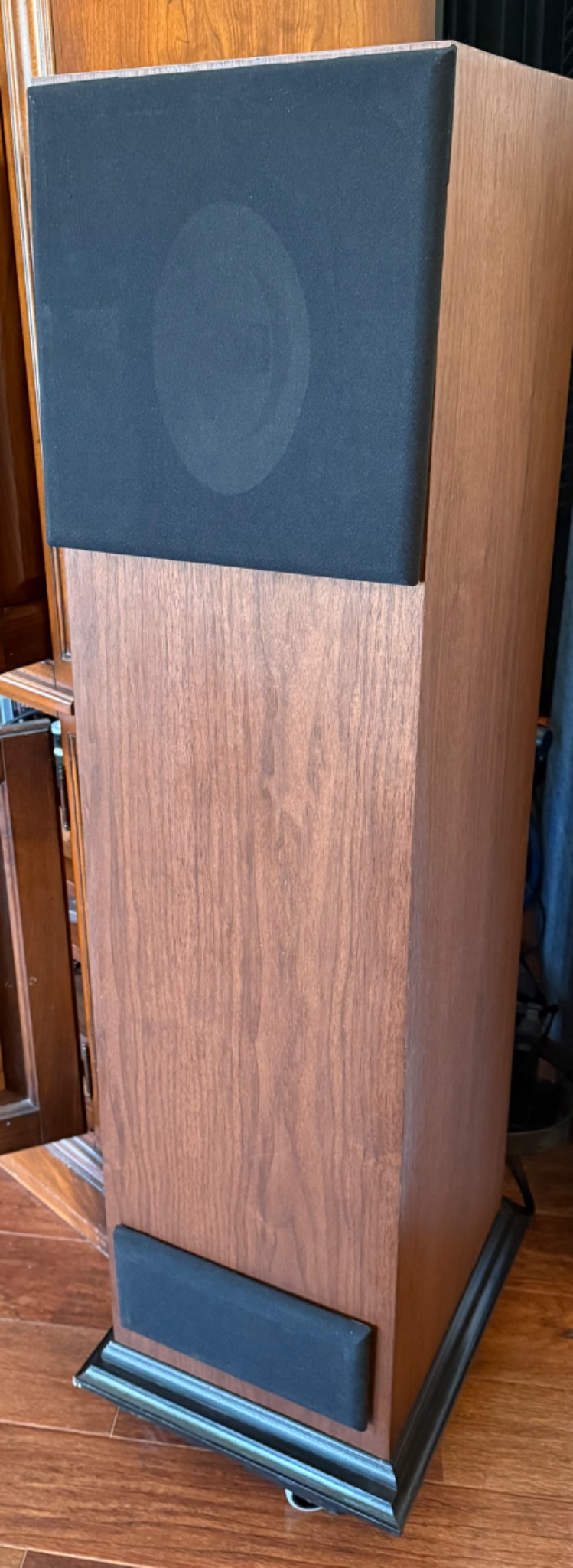

As an aside, I had an opportunity recently to listen to a pair of Cube Audio Neo F8 v1 speakers that were for sale near me.
They were built into custom cabinets supposedly based on a Cube design (I think it was just a bass reflex) very pretty, very shiny! All white to look sleek and match the new living room.

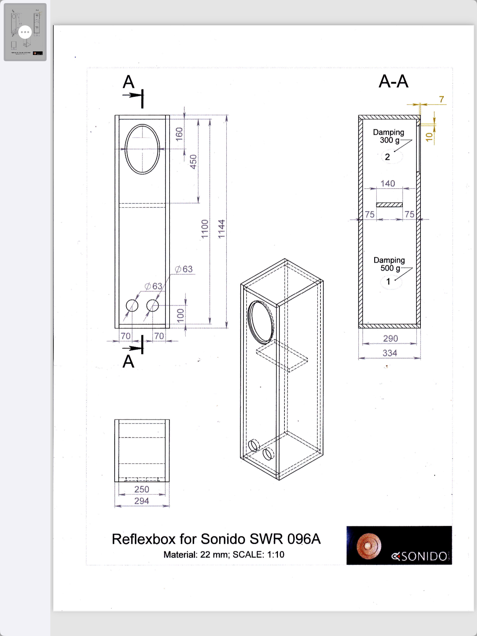

tampa, please this is the box for these SONIDO SFR 175/A drivers for you. If you have any questions, write to me : info@sonido.hu

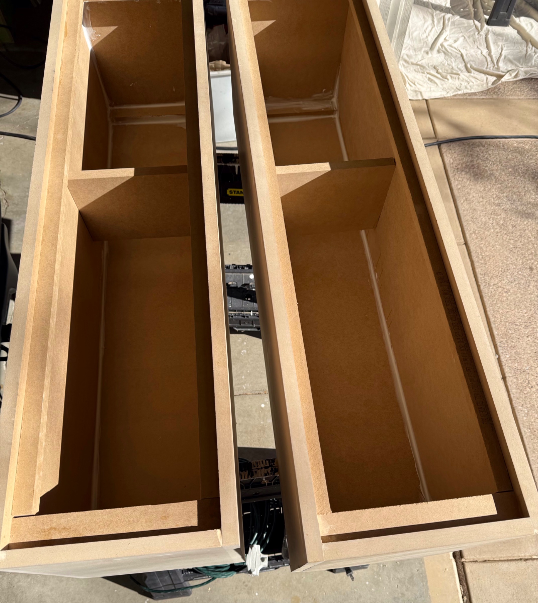

Went ahead and took a “leap of faith” and decided to build the Sonido Tower plan with the SWR096FC drivers. They arrived this week and look to be excellent build quality. Was a bit disappointed the speaker FC power cables and cabinet port tubes were not included in my packages. Contacted Istvan and he immediately offered to send them. Great customer service!

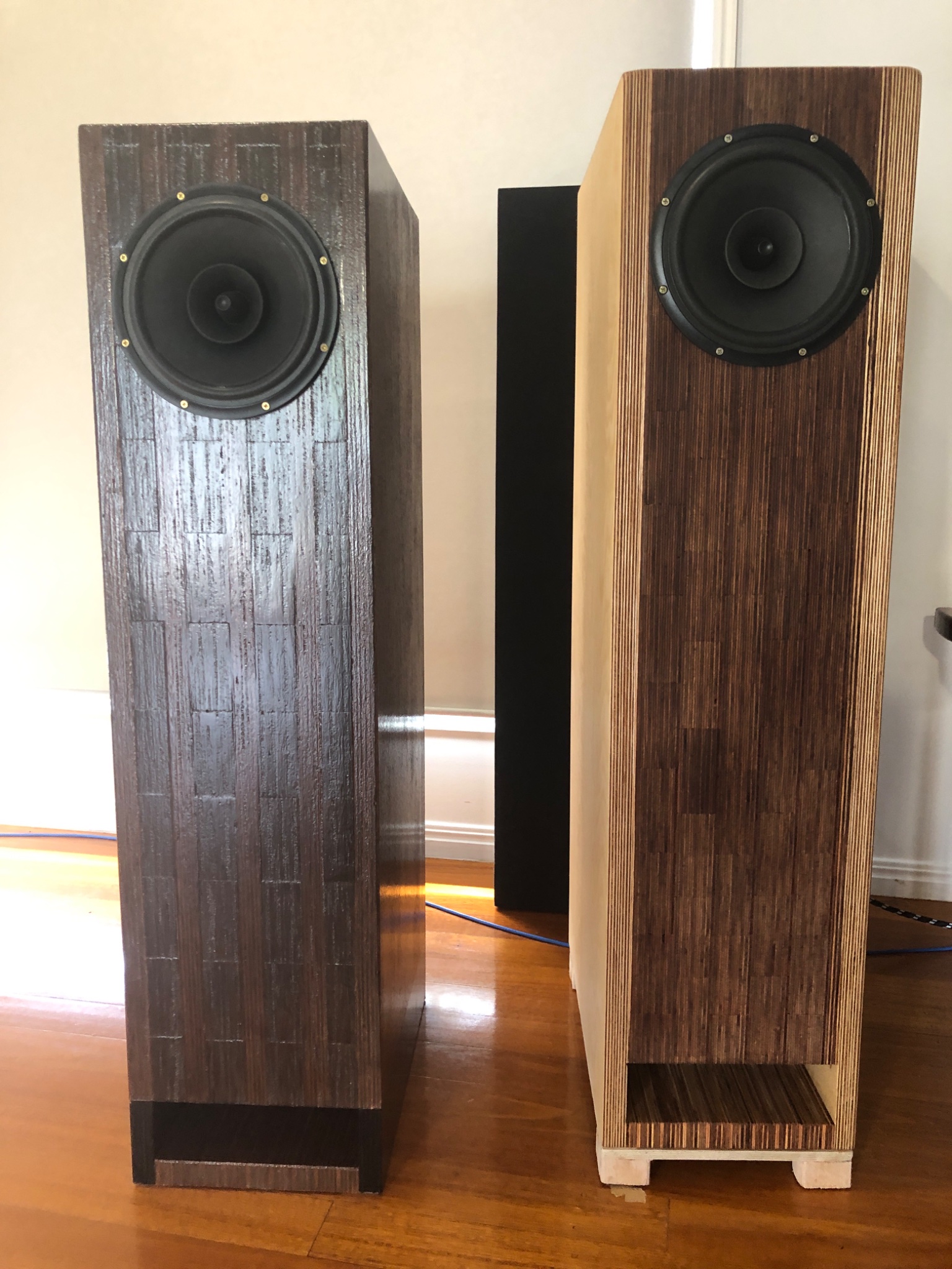

So the DIY single driver journey is relatively new to me, (as is this thread ) probably just the last 18 months, with a couple of years thinking 🤔 about it!
In that time, I’ve built eleven different folded MLTQWP boxes, working with the SB Acoustics budget 8 inch “ full range” driver.. ( High Quality Plywood and Machining is free to me)
I’m getting the best sound that I’ve ever heard in my house, ( before that I had Martin Logan Ethos.. sadly I thought that they were good)..

I have included a photo of some of my work..

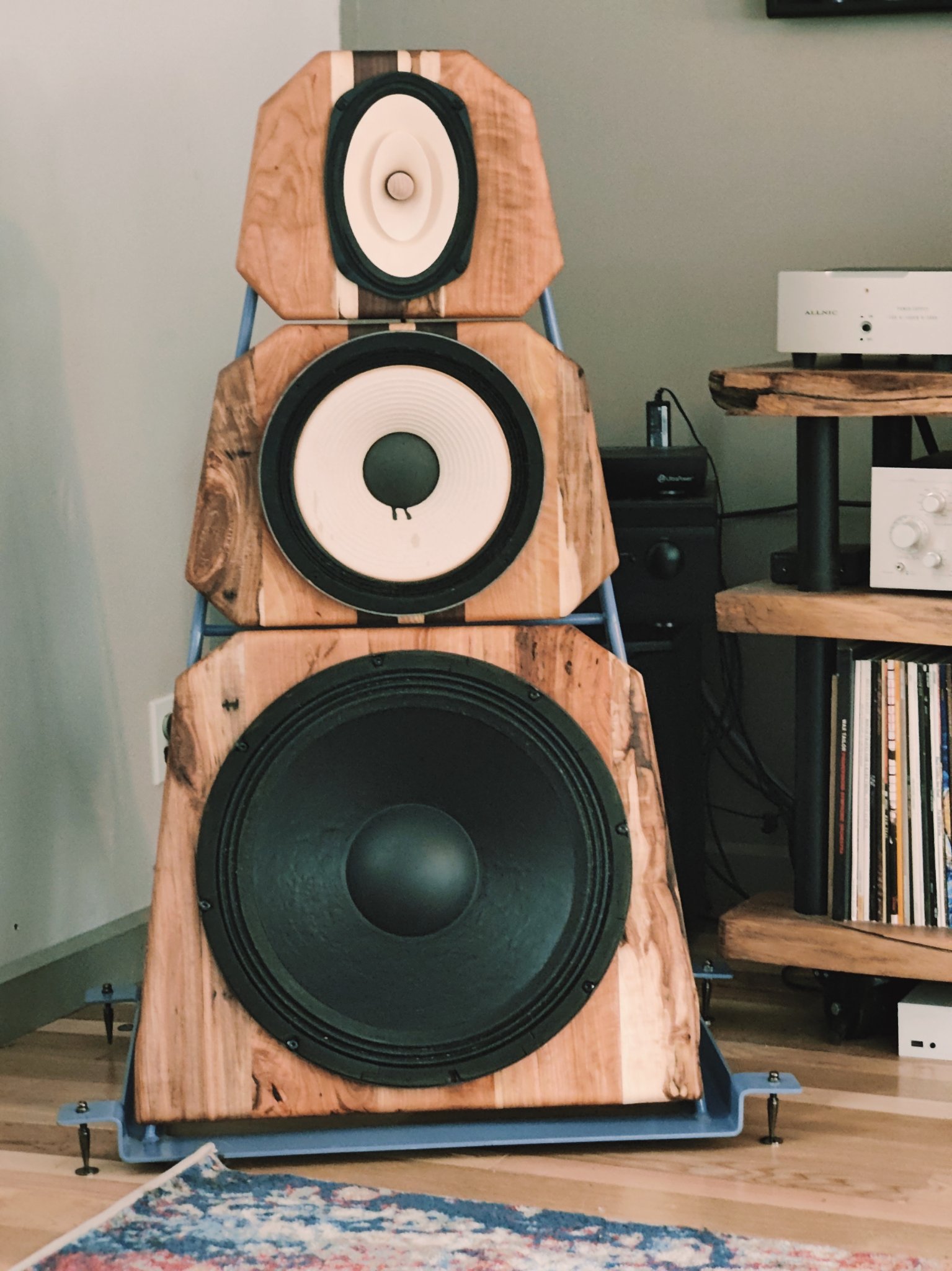

I took the “easy” way out with my Sonido field coils and went open baffle with 15” AE woofers for bass.
Mass loaded folded Voigt pipe box, because I’m look for more bass, not lower, but more of it.
You want gain then. A Voigt/Horn can do that.
The Voigt shoud be mass loaded, given the way the shape of a Voigt distributes the unwanted harmonics, the extra low pass filter at the terminus helps a lot.
The OB ia indeed a solution, the AE drivers are superb. A decent experimental platform.
But it is an OB.

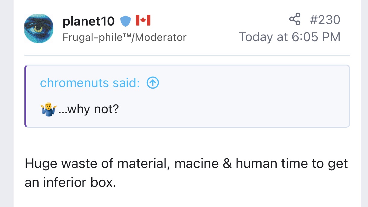

Huge waste of material, macine & human time to get an inferior box.
In a translam you have oriented the material in its weakest direction. No bracing and the rounded bends are counterproductive.

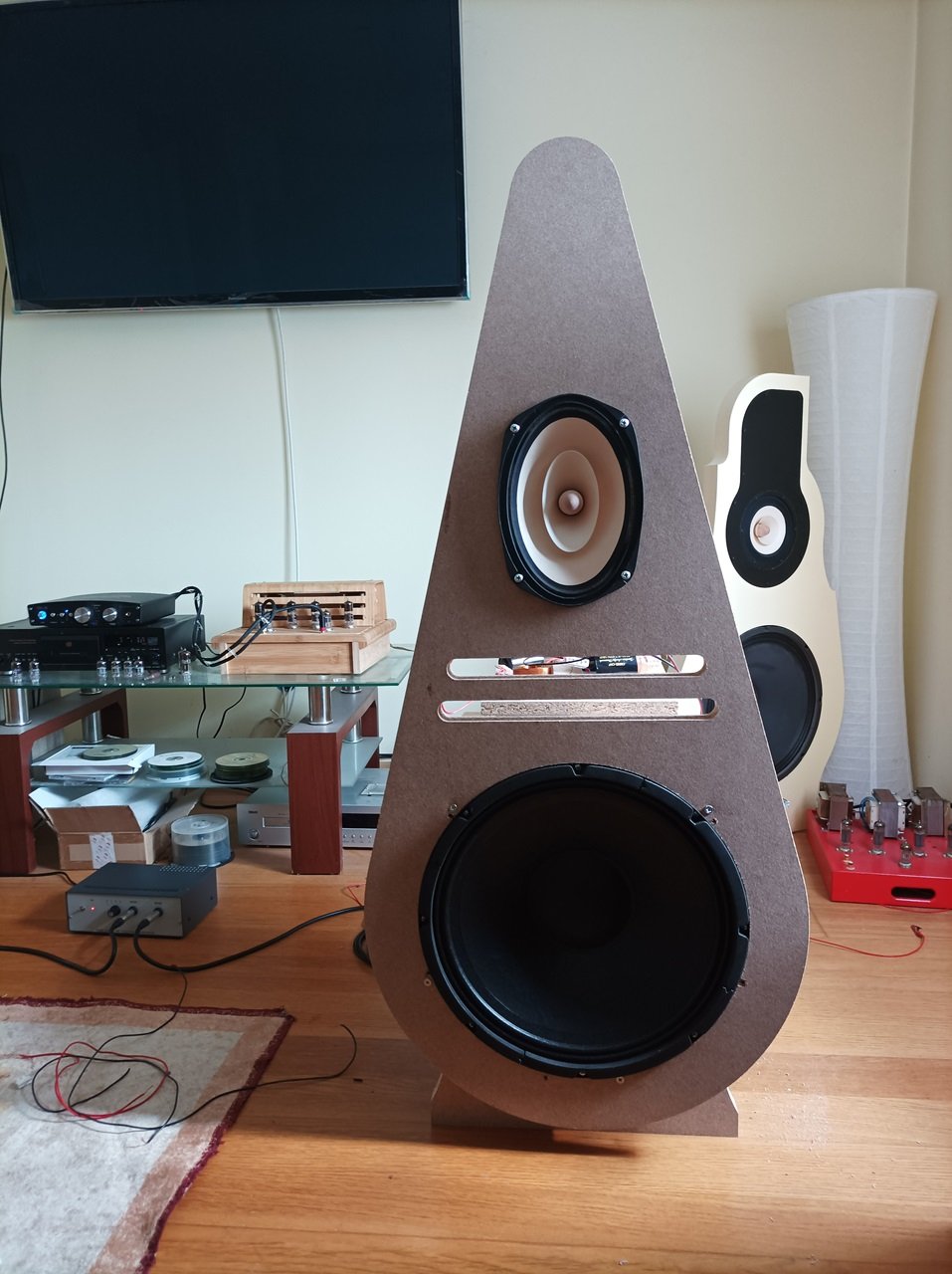

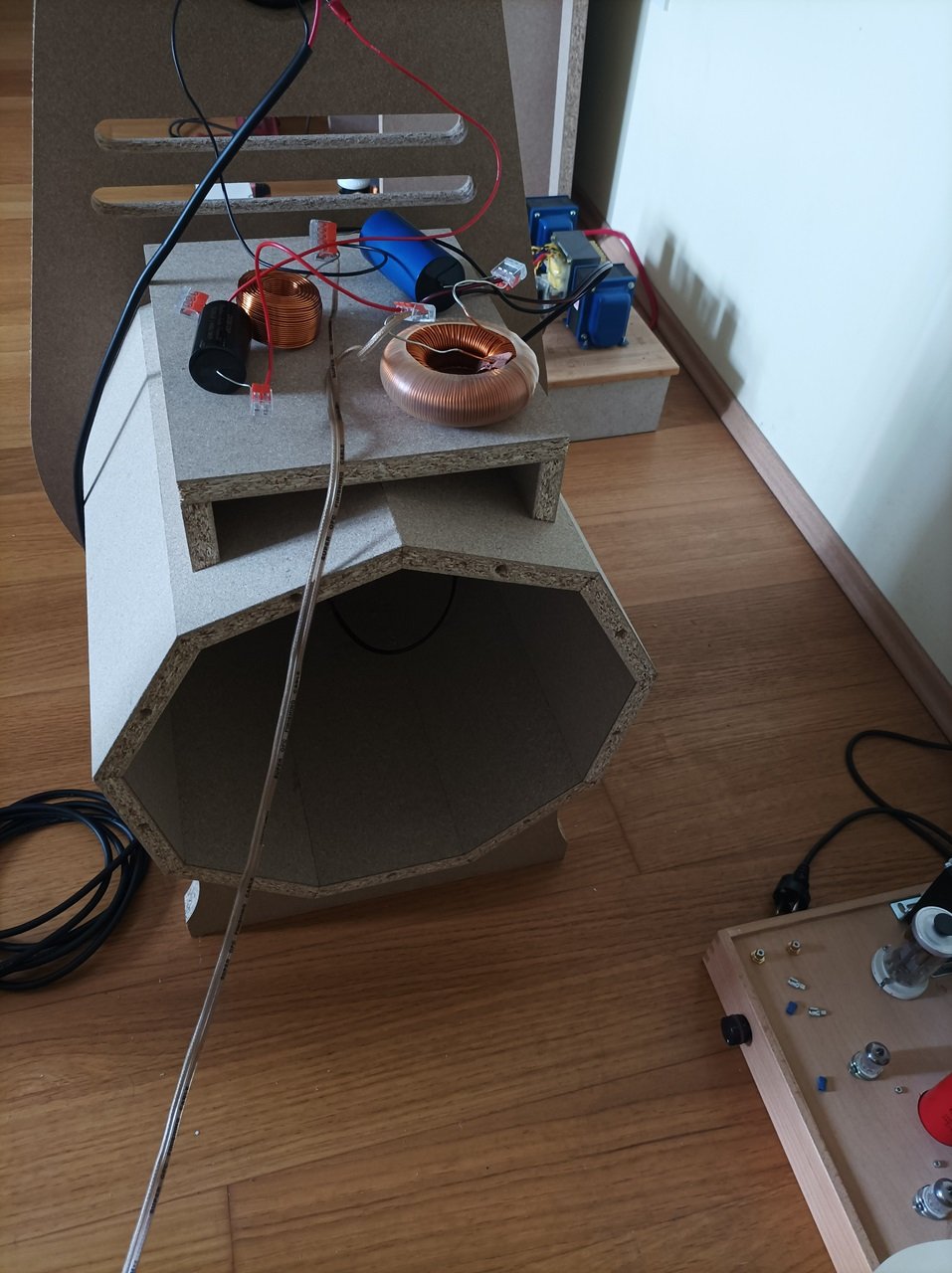

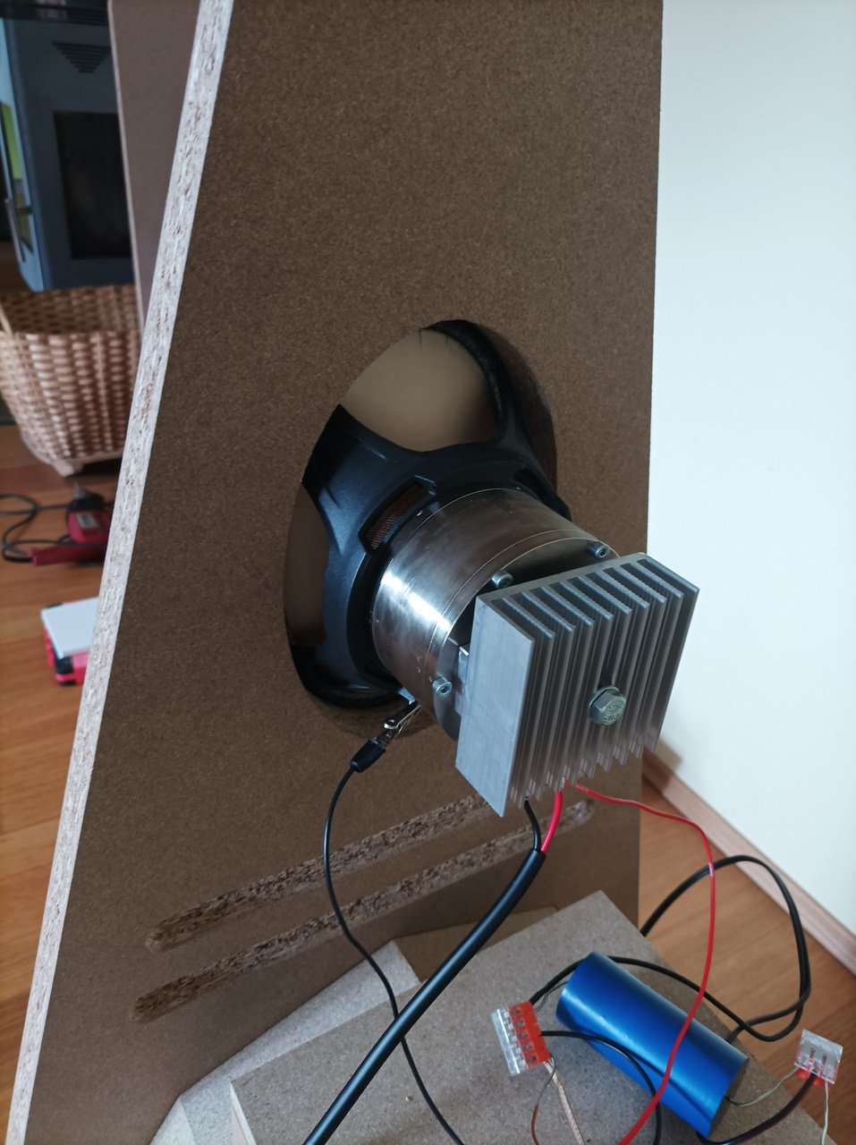

After too long I finally got around to making new speakers.
The project is still a test for now. Hence the use of materials. Crossover is still 1.0 version for now. The units are still new.
I used the SB 15OB350 for the bass and the Sonido FC SWR 096 for the FR.
The sound is very good right from the start. Maybe I caught the frequency cut quite well.
A few more pictures:

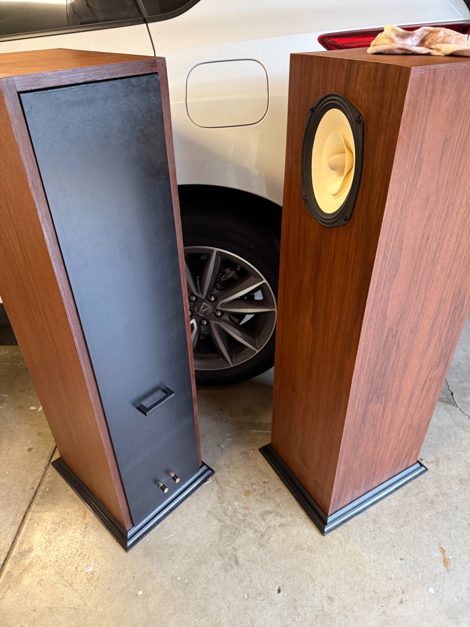

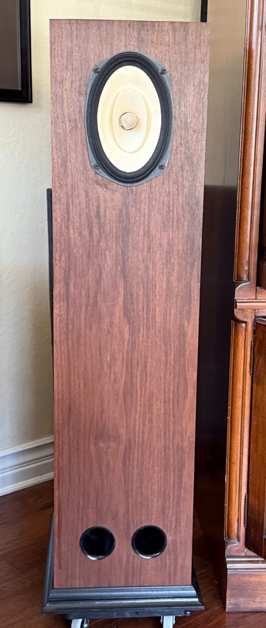

Finished my SWR096FC cabinets and I have 3 days of listening. The speakers keep sounding better with hours played. Will need some time to determine the best current setting for the FC drivers as well. Very happy with the SQ. The bass is the best I have heard on my system. The mids and highs are very nice but I have experienced some high fatigue (Resonance?) when vocalist push notes high and loud. Also notice some vocal lip hiss as notes end…oveall these drivers are really nice and improve my system noticeably. Istvan is a pleasure to work with and provides excellent communication and service. I have received some feedback that this Sonido cabinet ML-TL is poorly designed even though it is very similar to Scott’s 2020 plan posted above. For fun I will probably build some test boxes to try these drivers in. Thinking OB with sub support and smaller TL for experimental entertainment. Thank you Sonido!

JohnnyDee- I can’t comment on 8” drivers. Haven’t used them…these SWR096FC drivers are fantastic with more detail and transparency than I have heard on my system. Dealing with a bit of high fatigue. Turning the FC current setting to 1 helps and hoping break in will help as well. Not a major problem just need to dial the highs in a bit. Bass is outstanding.
