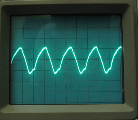

dc stability?
ok so i changed source resistor values to null the output offset and increase bias current.. i wound up replacing the resistor on the top JFET with a short, then decreasing the bottom one to around 10 ohms... not sure what the exact value is, i put a small trimmer pot in parallel w/the original 22 ohm resistor so i could vary it. bias current is now around 4.5mA.
the sound is in some ways better, but not quite right. it is smoother and less forward, i guess some of the harshness previously was from not enough bias current. however there is a tradeoff in that it sounds a bit muted and less dynamic now... maybe a little overbiased? the devices run a little warm now but not hot.
the larger problem i'm having is DC stability. i had to change my input shunt pot from the 25k Noble i busted to a 10k alps. however, when i change the volume, i think the DC offset is going all over the place. i measured it with no load connected, before the output coupling cap, and it was pretty stable, under 1mV. then i connected my power amp, and it shot up to 80mV, and changed as i varied the input shunt attenuator. the weird thing is, i am still using the Black Gates on the output, so i don't see how hooking up my amp would affect DC stability. i also did not notice this problem before i started fiddling with the source resistors. any ideas?
How are you looking at the output?
1) Are you looking at it with a 'scope or with a meter? COuld it be ultrasonic oscillation, whose average value depends on the connection.
2) Is the capacitor still OK, or could it have been damaged as well?

DC offset
Have you measured the DC offset of your input source?
Small measured DC offsets can be measured as an artifact of high frequency oscillations. I would not run a jfet in saturation in a circuit except as constant current source. A small source resistor
insures the the Jfet is not in saturation. It also provides local feedback which should make changes in DC offset with temperature smaller. If you are running long or fairly capacitive cables a small series resistance of 50 to 200 ohms may be in order as the circuit could be going into oscillations.

thanks for the suggestions guys...
i was measuring w/multimeter, i will check on my scope next. this DC offset is with no source component connected, just the load. i will check if my output coupling caps are still ok. the cables to my amp are only 1m and i don't think the capacitance is very high, my amp is 100k input impedance. still, i may have some oscillation here, i will have to look on my scope. you are right harry, there is a lot to discrete design... the dynamics of even a simple circuit like this can make things pretty harry... er, i mean hairy.
btw, i am still getting that 9mhz oscillation on my scope, WITH NOTHING CONNECTED. i.e. i shorted out my probe, connected ground to the tip, and i still have the interference. i have a PC nearby but no other electronics in the immediate area. i wonder if my 'scope is kaput, i got it on ebay for $250. maybe i will take a picture of the noise and put it up...
yikes!
you guys were right on the money, check this out.
850kHz oscillation, 2.5V (!!!) peak-to-peak. ugh. 🙁
time to stick the source resistors back in i guess. any other tips for getting stability out of this circuit? maybe decrease the open-loop gain by adjusting the top resistor? hmm, is there somewhere i could stick a compensation cap?

compensation
Shooting from the hip,
I think that 850 kHz is too low a frequency to be related to not having the gate resistors in, but you may want to add them anyway.
One place for a comp cap is across the 500 Ohm drain resistor. Maybe you could try values in the range of 1 nF.
Like I said, I'm shooting from the hip. I'll try to think about it more later.
What do you suppose the cable capacitance actually is? 50 to 100 pF?
What about the AC input impedance of the amp? Often the amp will have a high DC input impedance in parallel with a low pass filter that might be a 1 kOhm resistor +several nF capacitance.
The compensation idea I mentioned might do more harm than good; a 1 nF would add a 320 kHz pole to the system. Maybe the cap has to be much bigger, but if it is much lower then you get into phase issues in the audio band. It depends on where the problem is arising. So consider it well before proceeding. Maybe you will have to put a R on the order of tens of Ohms in series with the C.
Just ideas.
I don't remember, do you have a simulator to play with?
