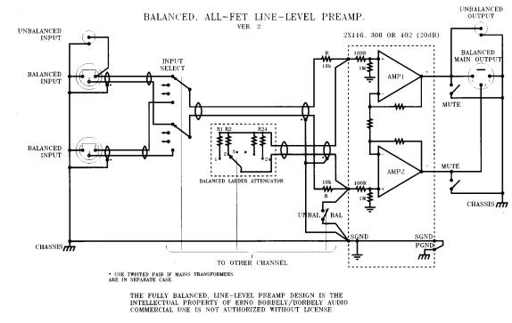

Dorkus,
I noticed that you tend to favour Broberly complementary designs. I just came across that application which might be of some use to you. As you see the parts count doubles but no caps in the signal path.🙂
