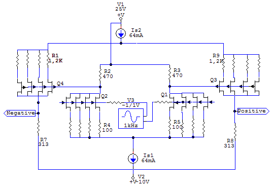

Simple 2 stages with attenuator in between?
Please find attached a simple preamp circuit. It is missing trim and detail engineering. I like it for the following reasons:
1. "No" feedback
2. As much or little gain as you want
3. No cascodes
4. No level shifters
5. Room for attenuator between stages which DOES NOT have to go to ground (runs in balanced mode).
6. Fully balanced: converts balanced to single ended and vice versa
7. DC coupled
8. For single ended operation, switching phase is very easy, just choose the other output.
9. This is "basically single ended application" of a balanced circuit. I say this since single ended gain is developed over a single resistor with "single" gain device. Borbely appears quite fond of the other approach, (push-pull) input with complementary JFET's with their gates connected.
Let me just explain briefly what is going on in the output stage. I chose drain output so that voltages can be shifted back to zero without added complexity. The gain of the ouput stage is just over 1, so there is significant degeneration. It can be construed that the output impedance will be very low even given the drain output. Without degeneration, balanced mode output impedance is 616 Ohms as shown. With feedback, it is probably in the region of 200 or so Ohms. Of course an SE output has half that output impedance.
I would argue this is just about as simple as you can make a circuit given a requirement for 2 amplification stages with passive attenuation between them.
What do you think?
Petter

Interesting, Petter.
Have you simulated this? With which FETs?
How much do you feel you gain from the second stage being differential also as opposed to a more conventional common source amplifier tied to the rails? (besides higher PSRR). Performance could be quite good without going complementary, but DC balance if you're using it single ended would be a problem. Were you considering output capacitors?
The gain structure is very similar to an FET DAC output buffer I designed, but my circuit is more (too much?) complicated compared with yours, it is complementary, and I used somewhat higher power supply rails and Zetex bipolars for the outputs. It is a NLFB circuit also, and uses some other measures to linearize the first diff amp, which can do single ended to balanced and vice versa; it's designed to work from differential DAC output chip.
I like your concept- hopefully you'll keep us informed of how it develops.
Jon

I have not simulated this, but I have built something very similar in my Pearl. I would say that the second stage in my pearl (SE version of the above) with 4 JFETs has fairly similar operating conditions as the above -- except it runs with cascode due to the much higher gain.
Balanced operation of output stage costs very little in terms of components and alows a volume control which does not involve ground. I like the symmetry, and it is easy to guarantee absolute output voltage level by trimming the current source. Current sources in diff amps really are very neat for this purpose, as they handle biasing automatically, as well as output DC level 🙂
No, I did not consider output capacitors. I use the best ones available on the market: No such things. It is true that one could go with n polarity devices all around, but as you state, that means more complicated power supply and/or strategically placed coupling capacitors.
I originally had higher PSU voltage for the bottom side, but decided to reduce it given that I was expecting flames due to higher output impedance this causes. Of course, one could build this like I build my Pearl v2 which is balanced with 8 JFET's per half per stage. Then we could double the low side voltage while keeping the output impedance the same.
Suggested devices: n: 2SK170, p: 2SJ109 or something like that.
Petter

Well my Pearl which is basically the same sounds very good. It is not really directly comparable, though.
A pro friend of mine says that he feels that symmetric Borbely type push-pull input has a less "coarse distortion structure" whatever that means.
I would think this type of circuit, especially with the high level of degeneration will be extremely linear even without loop feedback. Incidentally loop feedback is easily implented, but you have to "cross" so that you take output on right to input on left and vice versa given the even number of gain stages.
Noise should also be low since all gain is takein in first stage, and since devices are very low noise + paralled (good enough for an MC RIAA stage).
The circuit works with any gain device. Some may prefer BJT's, tubes or a mix thereof.
Petter

As beeing an amplifier designer.
As beeing an amplifier designer since many years.
I must say your entuiasm is fantastic.
I am no fan of Nelson Pass designs, neither can I understand
the "use (MOS)FETs constructions at any price"-spirit.
In audio low noise bipolar is mostly
the most suitable alternative.
And in the output stage Bipolar have no match!
I have seen at your suggestions. They might work well,
but aren't they a little unnessesary complicated?
Why make things harder than it need to be?
Although no fan of Pass Amps, one of Nelson's
guidelines is "KEEP IT SIMPLE".
There I agree totally.
Often this is the most cost effective way also.
Less money spent.
Short signal path.
Fewer components for signal to pass through,
and thereby be colorated.
Few and good components is the way to go.
This is the best HIFI preamp design I have ever seen.
Give it an eye.
Simple is not the same as bad.
In this case quite the opposite.
http://www.mitedu.freeserve.co.uk/Circuits/Audio/gmpre.htm

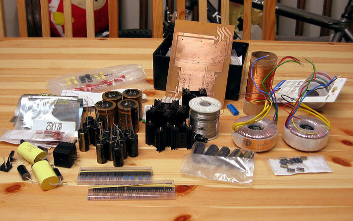

still alive and kicking
just wanted to let everyone know that SoD is still alive and well. it took me longer than expected to get the parts i needed together (and i still wound up going to Radio Shack for a few things) but i am ready to start prototyping. here are some goodies i've assembled for the first phase of the project... nothing too fancy but some nice Nichicon Muse/Panasonic FC power supply caps, Black Gate coupling caps, Panasonic P polypropylene film bypasses, some leftover Solens, Noble pot, Holco/Yageo/RS carbon film resistors (just for prototyping, Caddocks can come later), the necessary MOSFETS and JFETS, etc. etc. you can also see the power supply circuit board i etched last night, i will post details later on how making that went (i tried regular glossy paper this time instead of "special" toner transfer paper i used in the past).
first up... the Borberly JFET buffer (based on White cathode follower), to be followed by the SE JFET line amp. after i finish the power supply of course (the simple pass regulator design used in BoSoZ).

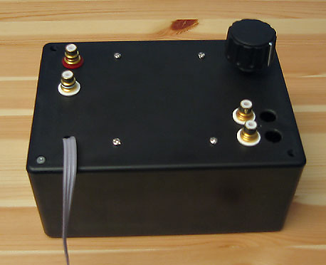

JFET buffer complete
i just finished my Borbely JFET buffer tonight, for a background of the circuit check out this thread:
http://www.diyaudio.com/forums/showthread.php?threadid=2281
my circuit is the same as shown at the bottom, with Harry's last corrections. i've just plugged it into my system and the sound is very promising... can't say it sounds exactly like a straight-wire bypass but it is impressively clean, with great dynamics. i used really cheapo-quality parts too so the circuit is performing nowhere near its potential. more details and pics to follow soon...

buffer circuit
here's a picture of the (messy) circuit i wired together. as i mentioned earlier, parts quality is pretty ordinary so i am not extracting the "ultimate" potential of this circuit, but just trying to get a feel for its capabilities. the resistors are cheap Yageo (Digikey) and a couple Radio Shack carbon films, except for attenuator series resistor which is a 15k Holco. a Noble 25k pot is used for attenuator shunt. the feedback cap is a .15uF Solen metalized polypropylene, the closest thing i had to the .22uF specified by Borbely. local supply bypassing is a 1000uF Pana FC and .01uF Pana P film.
i did not even bother matching devices (too lazy, and i haven't put together my matching setup yet) so there is 30mV of offset in both channels. the output of the circuit is therefore coupled with a 10uF Black Gate nonpolar, followed by a 100k shunt resistor.

here's a picture of the box the circuit is in, just a plastic Radio Shack project enclosure.
