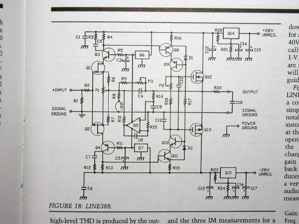

Borbely superbuffer
Hello guys,
I am an absolute beginner in DIY audio, but since there's a lot about Borbely, what do you think of his superbuffer in
http://www.borbelyaudio.com/borb502.pdf[/URL]

the borberly DC-coupled FET line amp we were talking about (the one the single-ended guys didn't like
) is actually a tweaked-out version of the super buffer. the line amp includes source followers for additional output drive capability, and a servo for better DC stability. i suspect it sounds pretty good but i've never tried it, i'm probably going to try the full line amp version. check out the article on the borberly site on the all-FET line amp, from the 5/02 issue of AudioXPress, it mentions the super buffer.

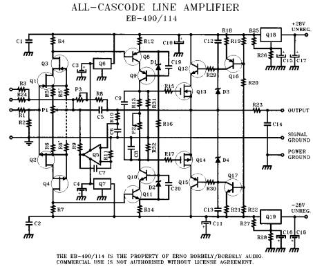

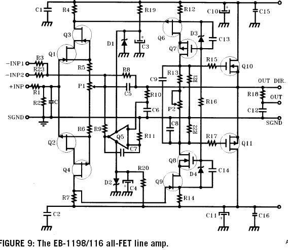

original "super buffer" vs. EB-1198

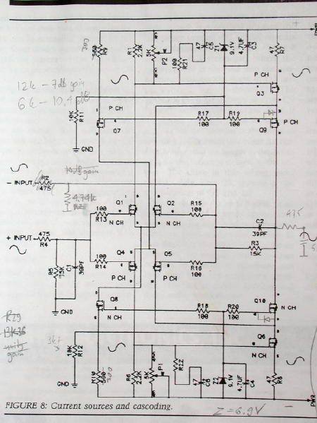

you are right ren, the latest complementary FET design from borbely does not cascode the output stage, only the diff inputs and 2nd gain stage. the output are traditional source followers using MOSFETs.
i am starting to wonder if the "super buffer," from which the latest design is derived, is worth a try. borbely mentions that the latest one (the EB-1198, we should really refer to these by model # from now on to avoid confusion) was designed with even greater drive capability in mind - he wanted to be able to drive 100 ohm headphones in Class A w/low distortion. this sort of overkill is nice in a preamp but not necessary in most systems. the super buffer is a little simpler than the 1198 (one less active stage) and also does w/o the DC servo that people seem to have a strong distaste for. i wonder why the addition of the output stage necessitates a servo in the 1198, or is borberly just going for extreme DC stability there? in any case i think i may prototype the super buffer instead of the 1198, and compare that to the SE-FET design that the others favor. with very tight device matching, i think the performance could be quite good. thoughts?

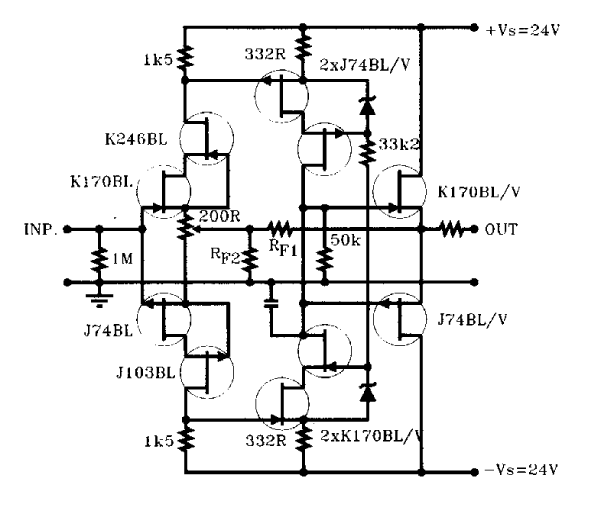

oh, and speaking of the SE-FET design... does anyone have any concrete topology changes from the original design? if i can not get suggestions specific enough to be drawn out in a schematic, then i will just go with the original layout.

p.s. it seems to me that it is very dangerous to make broad generalizations about topics such as cascodes. analog design and analysis is so dynamic and complex that the effectiveness of a given technique can hardly be isolated, rather its role must be evaluated only in the context of the circuit's implementation and performance as a whole. if you want to talk about cascodes, you should really specify where and how it will be used or it is of little value to us. therefore, comments like "cascodes sound bad" will be summarily ignored from now on.

has anyone built ANY of these circuits we've talked about? i think someone, jam maybe, said they've tried most of them but does anyone still have a working version they've listened to extensively and can comment on? apart from the circuit theory i'd like to have some listening impressions.
also, has anyone tried building the forssell design:
http://www.forsselltech.com/JFET Opamp.PDF
yes it's an opamp but hey who knows maybe it sounds really good.
