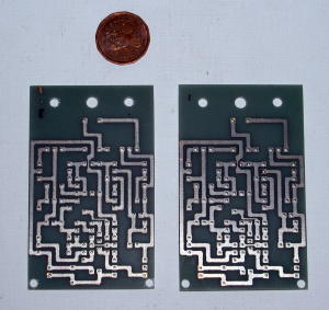

If you'll look at Aleph Ono gain stage you notice that it is very similar topology done with JFETs. I might try it for my retro preamp, since I have boards etched already.
