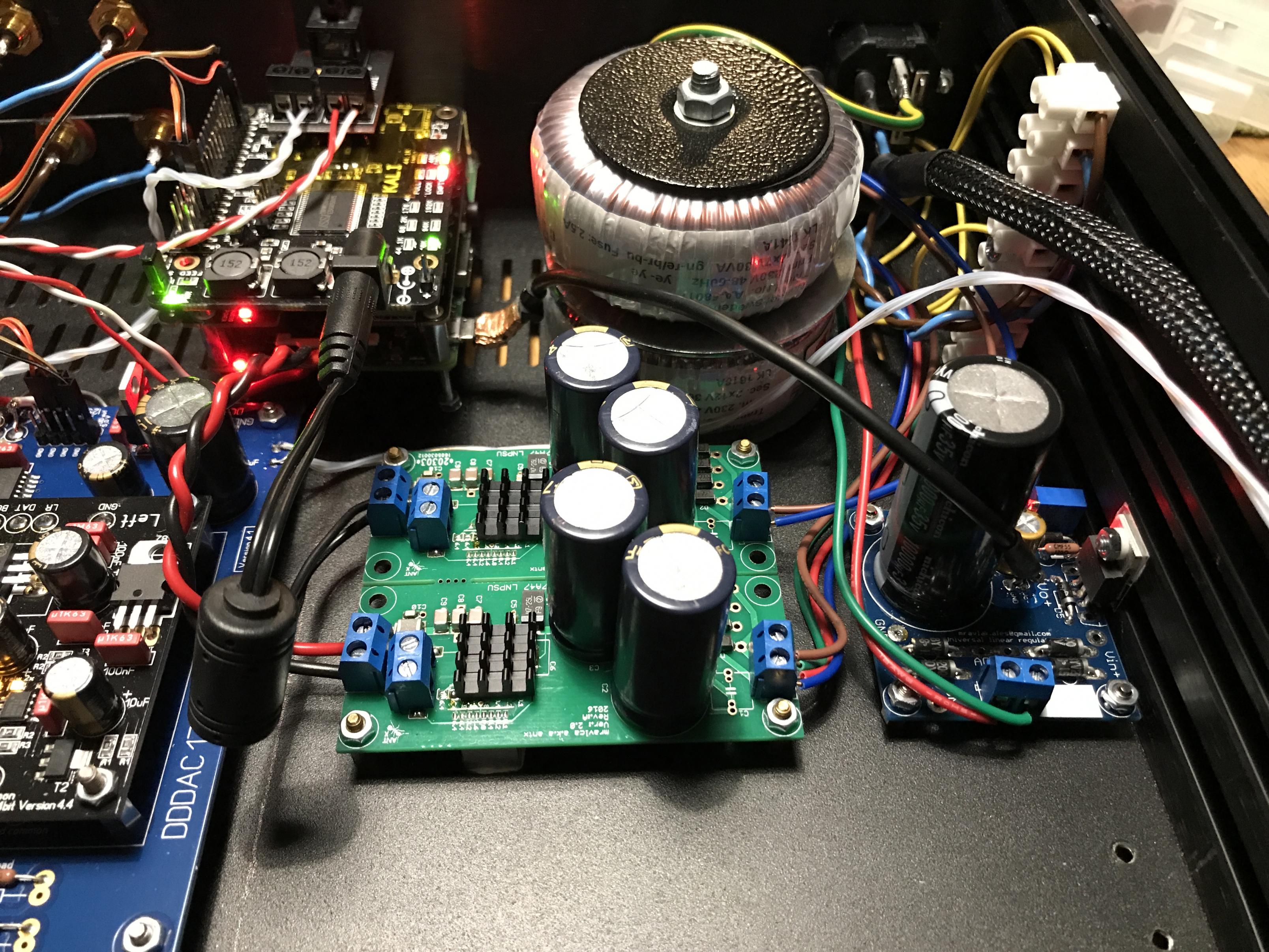

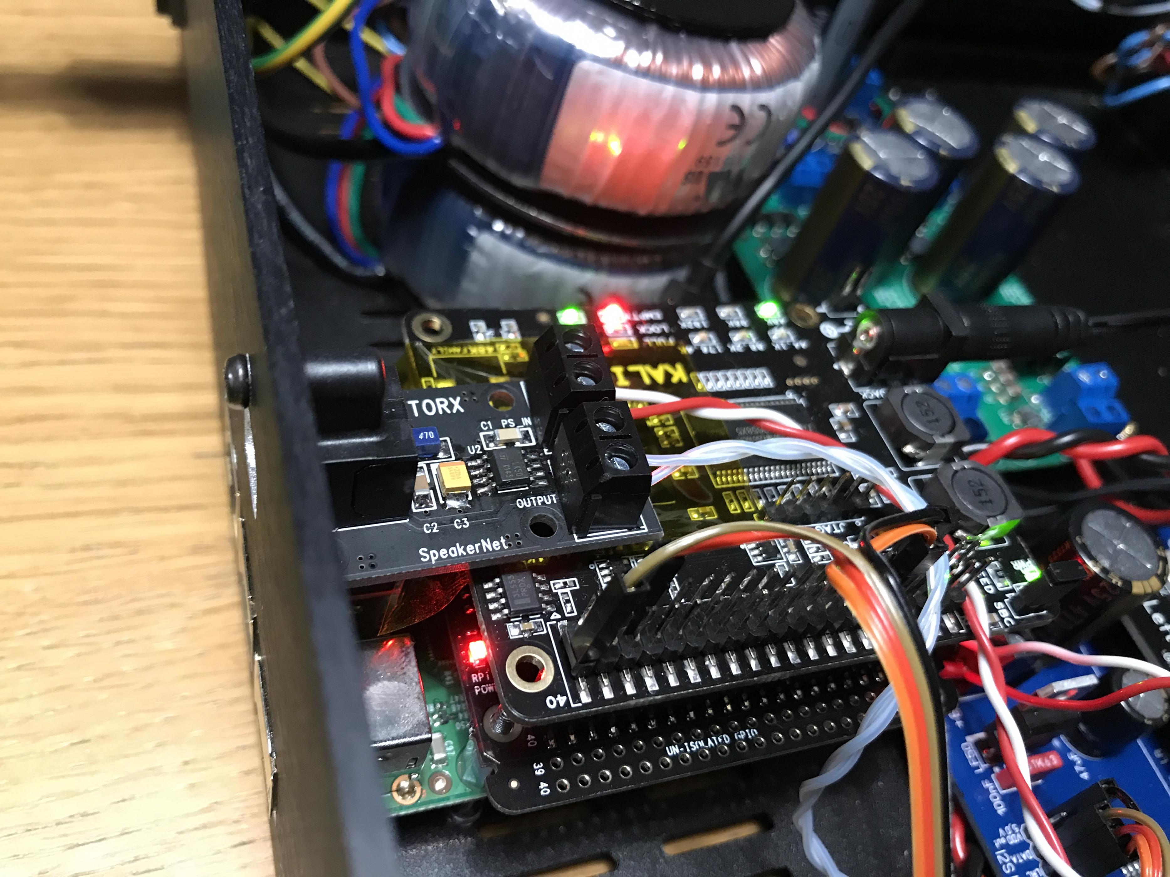

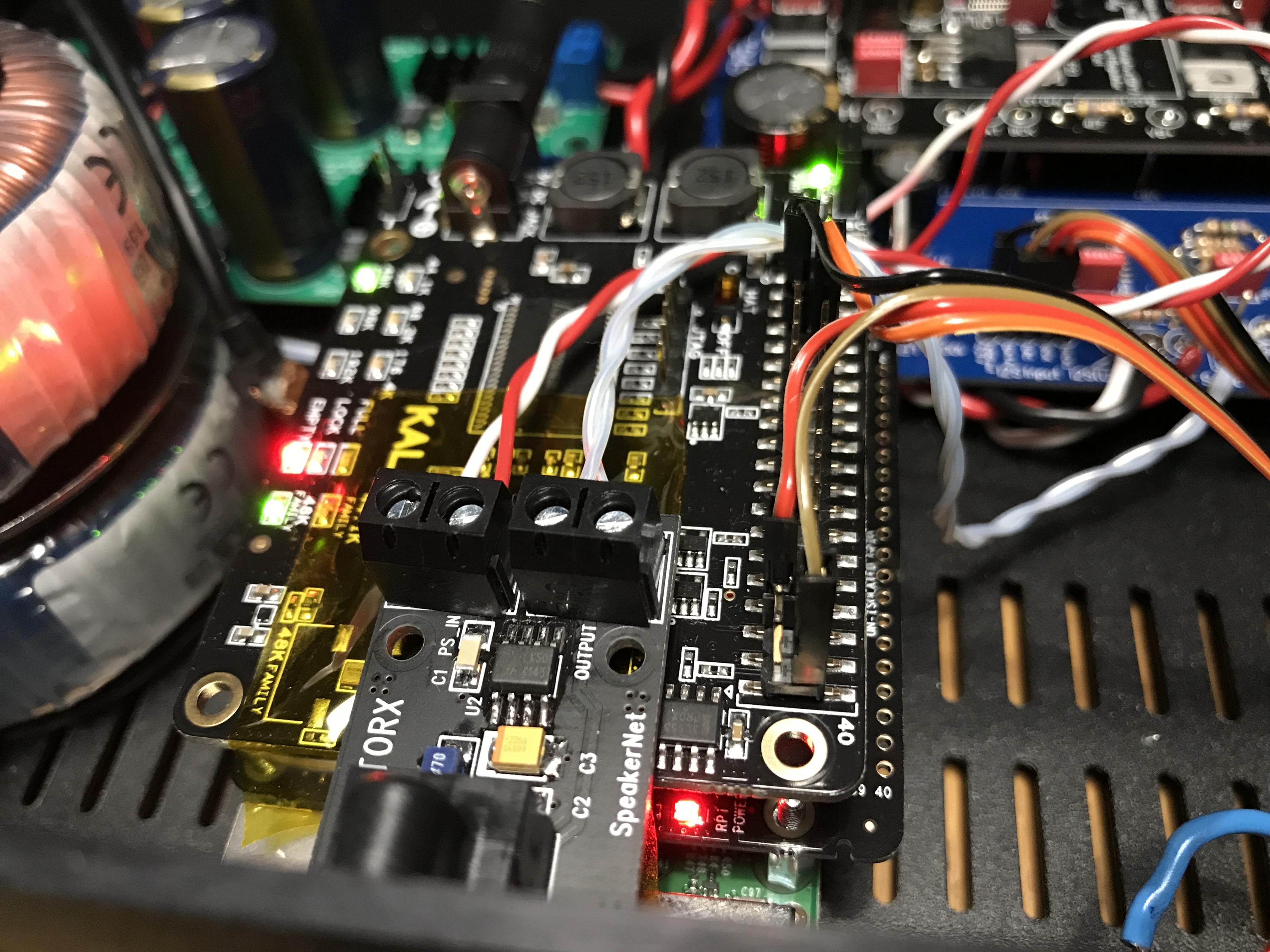

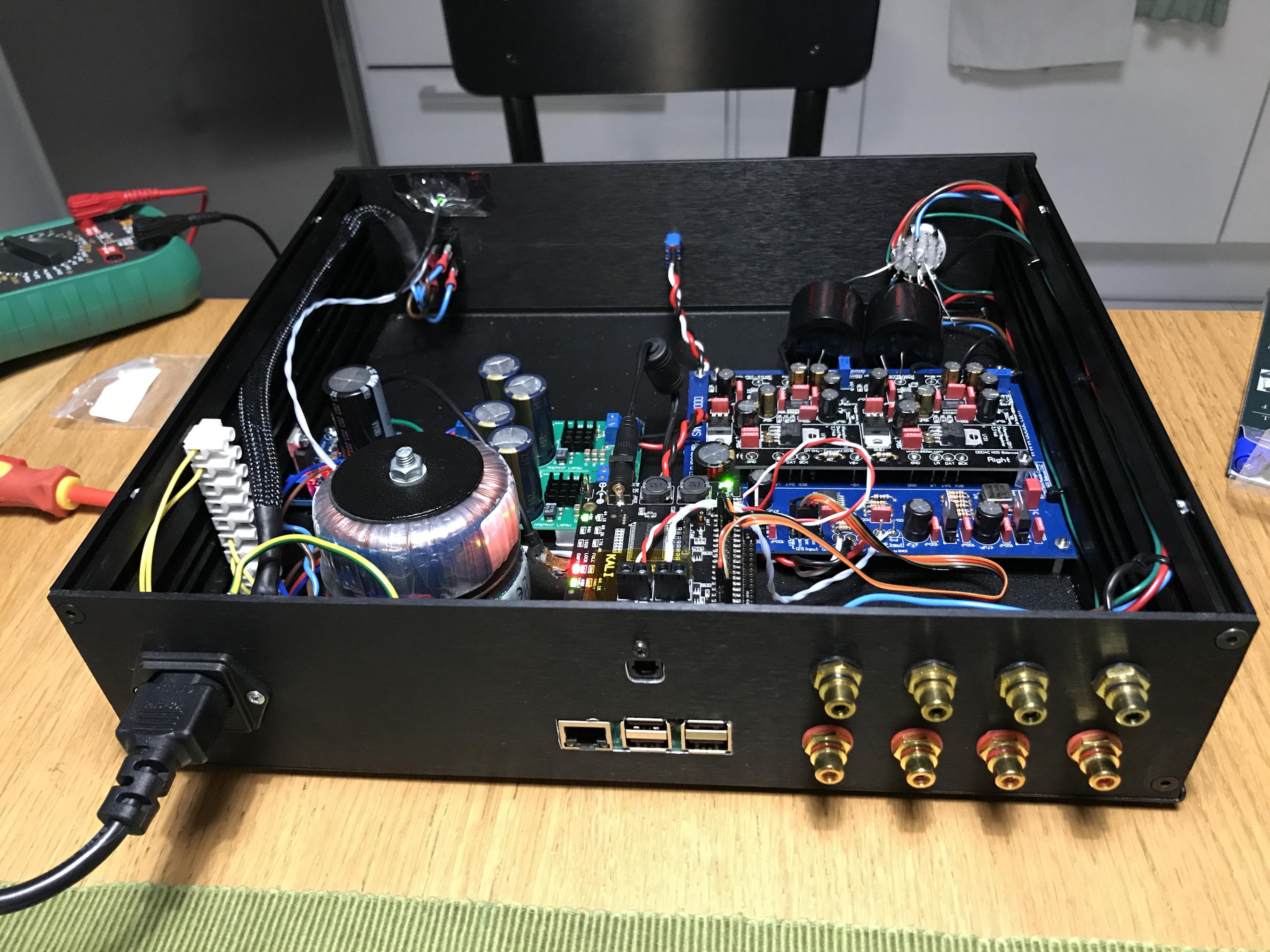

I managed to get my RPI - Isolator HAT - KALI - DDDAC combination up and running late last evening. I tested the functionality with Moode player by playing 24/192, 24/96 and 16/44.1 flac files. All of them worked flawlessly. No critical listening yet.
I'm powering the RPI with forum member mravlca's universal PS and the KALI is powered with mravlca's TPS7A4700 PS. I attached couple of quick and dirty iPhone pics.
Ok, for some reason I'm not able to add pics as an attachment. I'll try later perhaps...

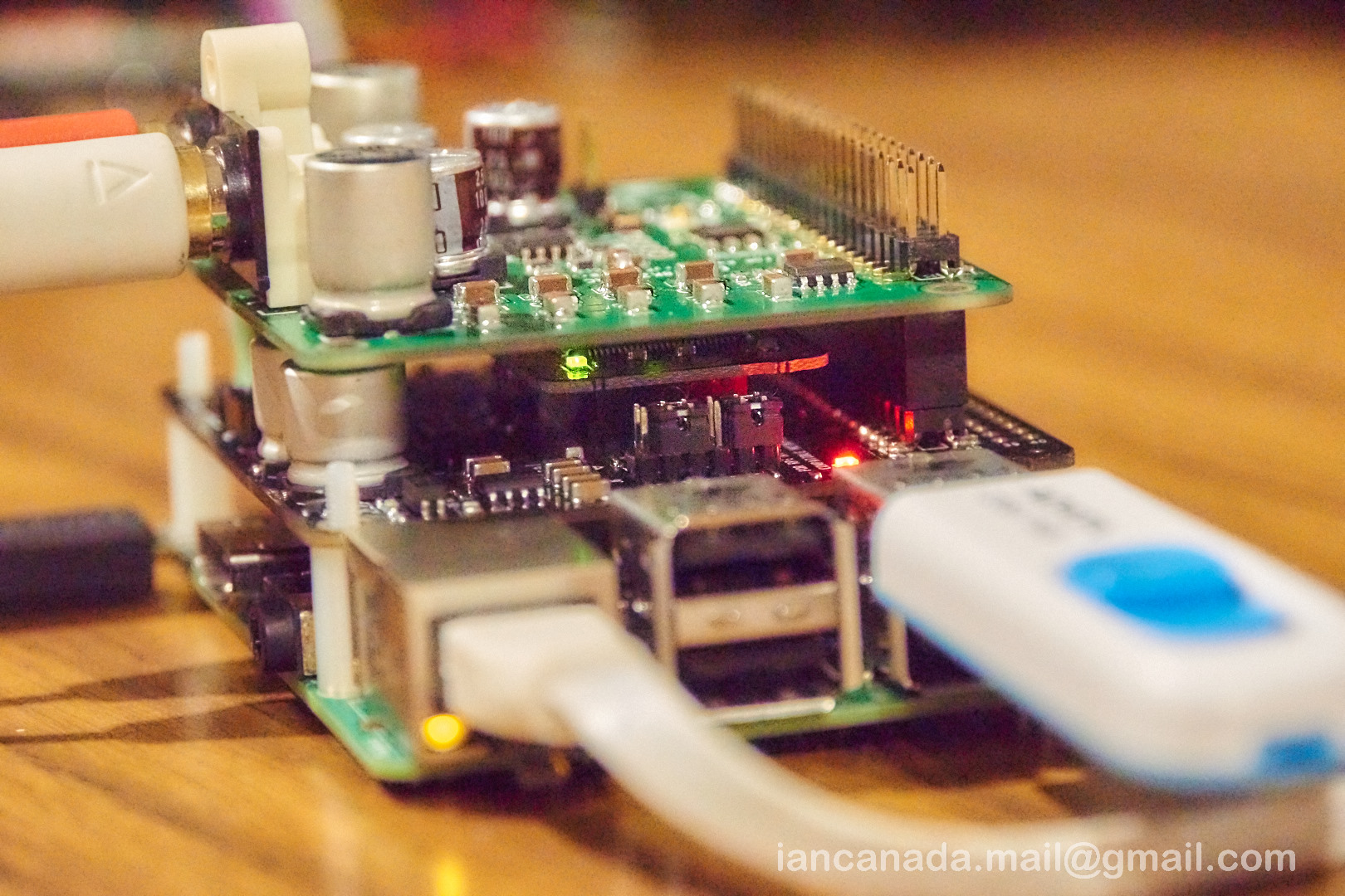

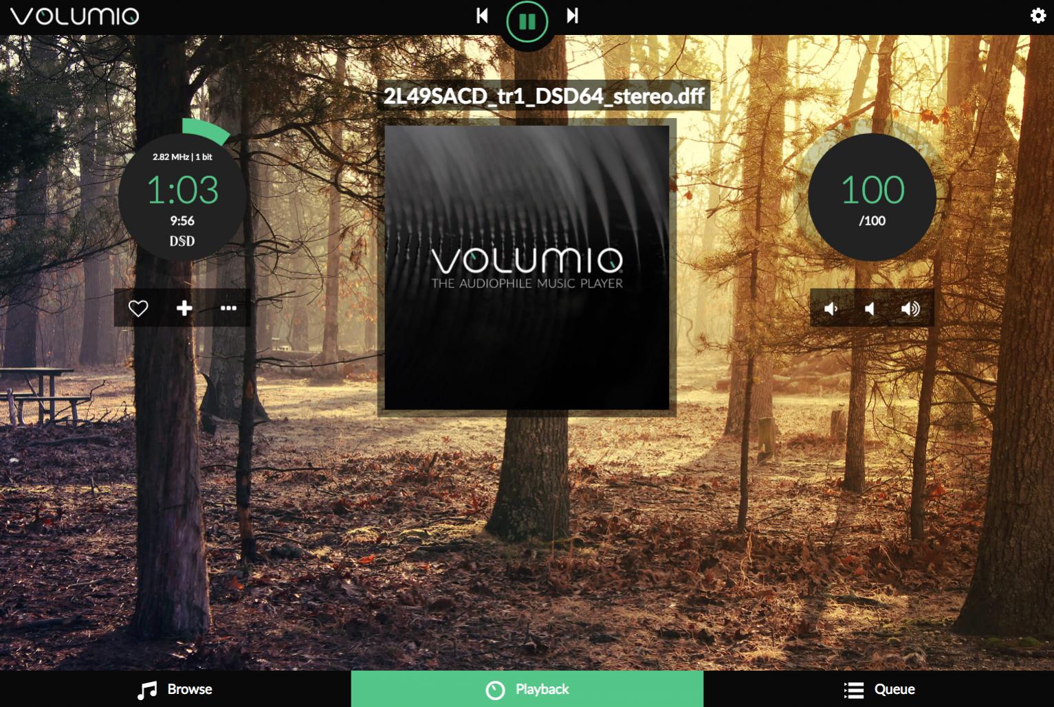

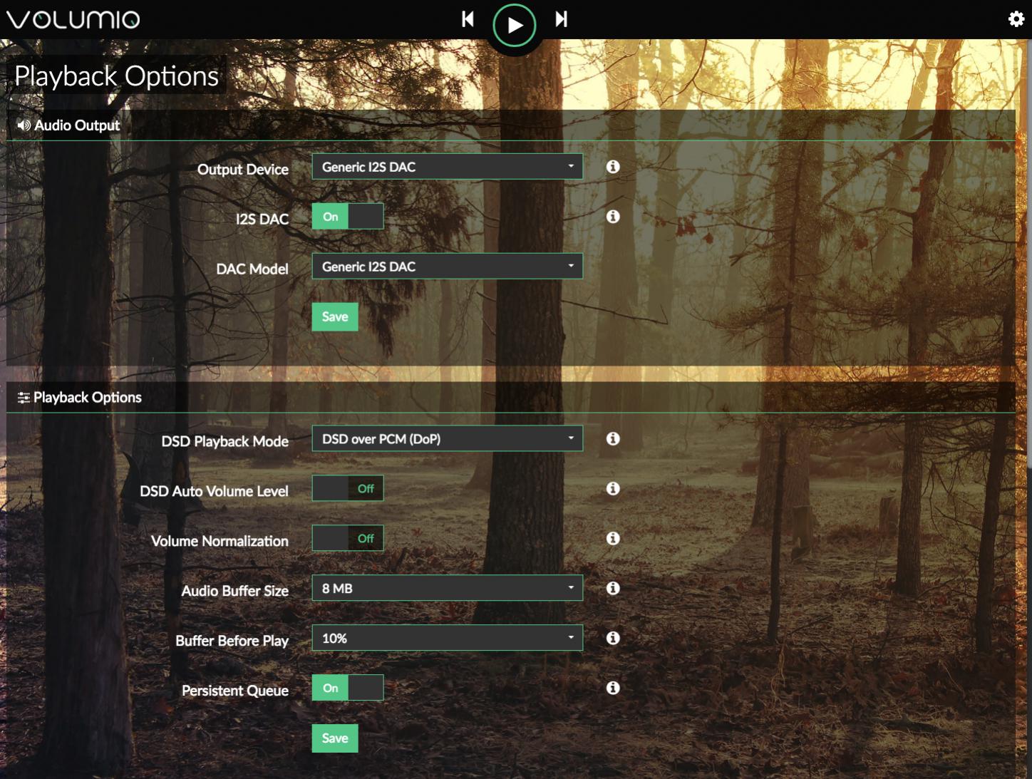

Volumio Plays DSD music with DoP decoder on a IsolatorPi
1. Enable DSD over PCM (DoP) on Volumio setup manual.
2. Play a DSD music file,
DSD format music files can be downloaded from 2L:
2L High Resolution Music .:. free TEST BENCH
3. You will see DSD LED is lid on the DoP decoder board. Now with a DSD capable DAC, you can enjoy the DSD music.
(DAC HAT in the picture is the prototype of my ES9018K2M I2S/DSD DAC)
There is still something I noticed,
1. Volumio doesn't have any problem playing DSD64 music.
2. However, when play higher rate DSD128 music files, DSD LED doesn't light, Volumio output 192KHz I2S rather than DoP code. It seems that DSD was converted to PCM on-the-fly by Volumio in this case.
But I think it's still reasonable. To run DSD128, DoP has to be packaged into a 352.8KHz I2S stream. However Volumio doesn't support such high Fs so far, so it has to be converted to 192KHz on-the-fly. Just hope it can be capable for 384KHz soon.
Ian
