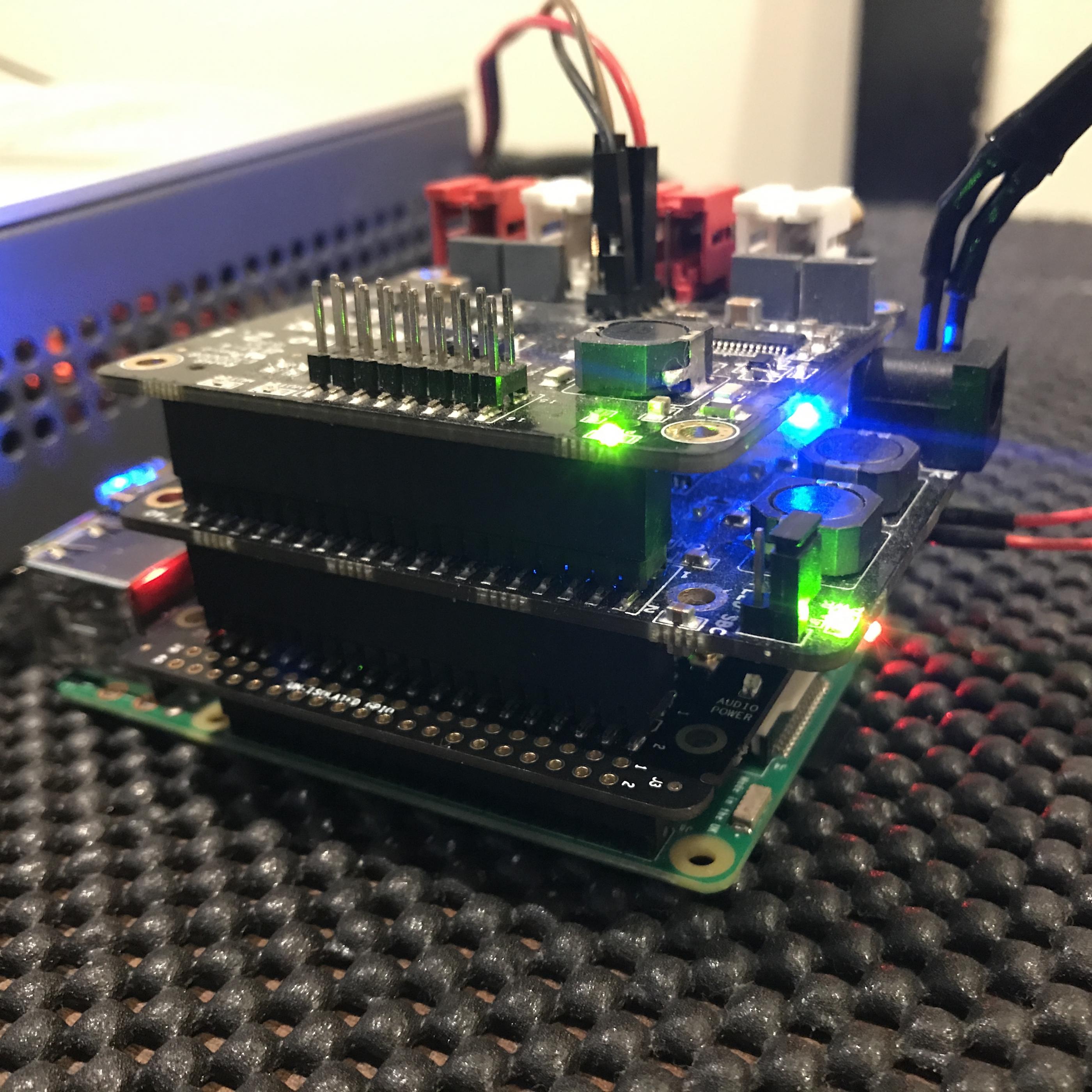

Hi Ian,
Looks like there's more going on with that one... its audio power LED never lights and I can't get it to do anything. Completely matched it (jumpers) to the other board, swapped things around, tried a digi+ board, misc etc. The other one just works.
Any ideas or things to check?
Ian: After more experimenting, slave mode with kali/piano works... still no audio power LED, so partially working.
Hifiberry DAC+ PRO, Allo Boss, pi2media does *not* work on this board... whereas it does on the other.
Hi sckamer,
Just realized one is working the other isn't. Try to remove the u.fl socket at the wrong position if that is the bad one. I'll send you a new one if you still can not make it a work.
Ian
