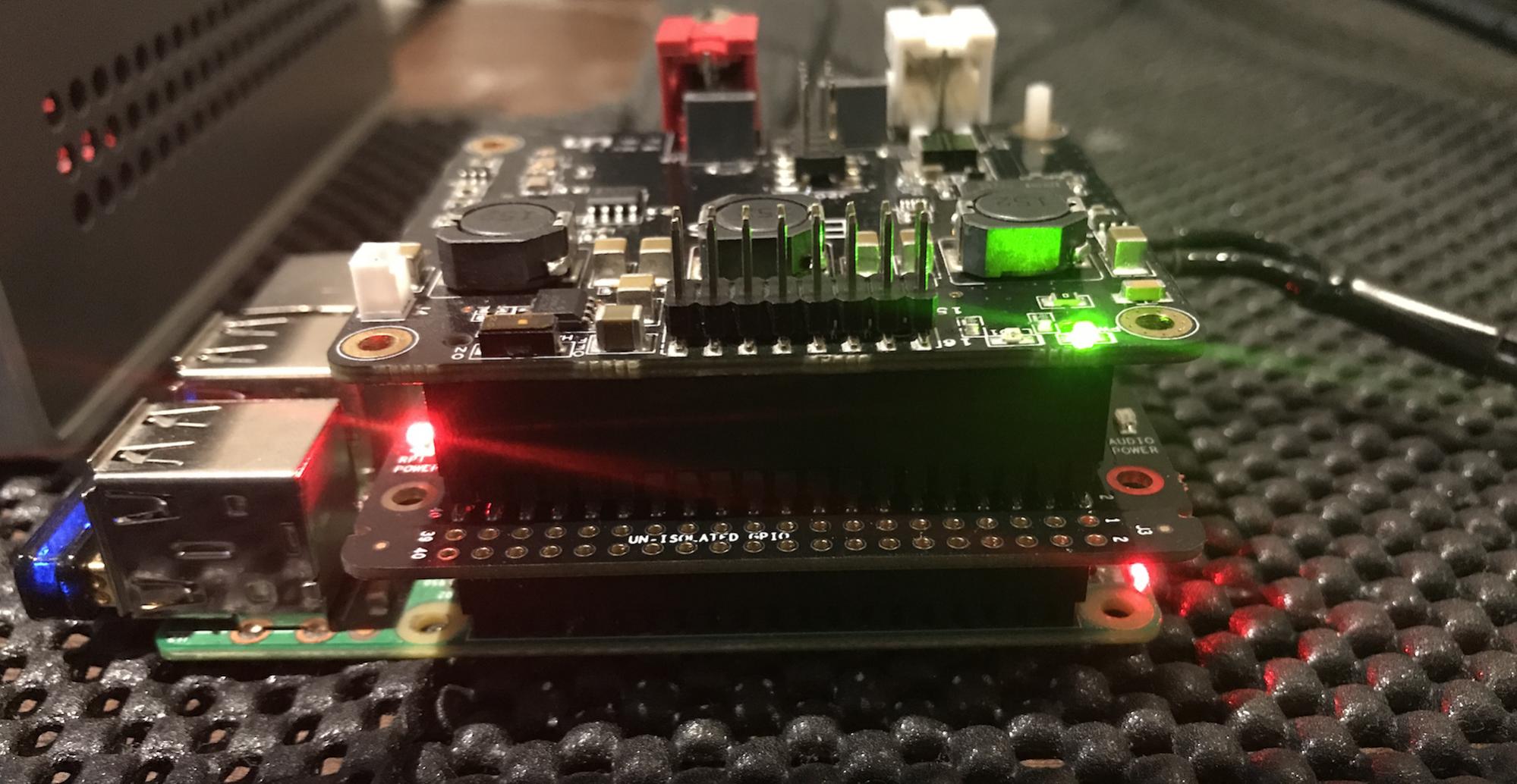

I received the Group Buy 2017 parcel today, just 4 days total including the weekend and passing through U.S.Customs, pretty speedy delivery by Canada Post/USPS.
Connection of the IsolatorPi was straightforward, to get started I'm powering a MamboBerry LS DAC+ directly, and the RPi3 each with their own iFi iPower 5v.
Initial impressions are very favorable in terms of increased clarity and veil lifting, as well as a somewhat surprising boost in apparent dynamic slam. I was expecting micro dynamic contrast might improve (it did), but I wasn't really expecting such a lift in overall punchiness or dynamic peaks.
I'm not sure if that is simply because each board now has it's own 2.5 amps at it's disposal or what, but it's not a tiny difficult to listen for difference, rather pronounced I'd say.
Now I'm late for dinner, but when I return I'll substitute the UpTone Audio LPS-1 UltraCap supply to power the DAC board.
Great work Ian, very nice indeed.
PS - does anyone know if I can remove the blue jumper on the MamboBerry board? I can't remember exactly what it does and I also can't find any documentation on it.

Hi MikeyFresh,
You are the No.1 of GB2017, glad having this good news.
Yes, CanadaPost did good job, but just hope not only for this time.
Isolator give you a clean ground, but how far you can go will be determined by your power supply and the clock jitter.
Enjoy your project, I'm looking forward to more of your testing result.
B.T.W, You took good picture, what camera and lens did you use?

Hi Ian,
I am honored to be first GB2017 participant to receive and install the IsolatorPi, and if anyone beat me to it but didn't yet post here, congrats to them too.
I also thank you for the fast shipment, everything went very smoothly! I was most concerned with the USPS end of it, as they don't always do a fantastic job, but this time they performed well as did Canada Post.
Yes based on this early result, I have no doubt this will scale up well with my UpTone LPS-1, or more specifically the IsolatorPi will allow a scale up in performance otherwise not possible with standard RPi installs.
Thank you for the photo compliment, there was limited natural light available in that room, but the Olympus E-PL3 m4/3 with 25mm f1.8 lens did the job in conjunction with a couple of incandescent bulbs.

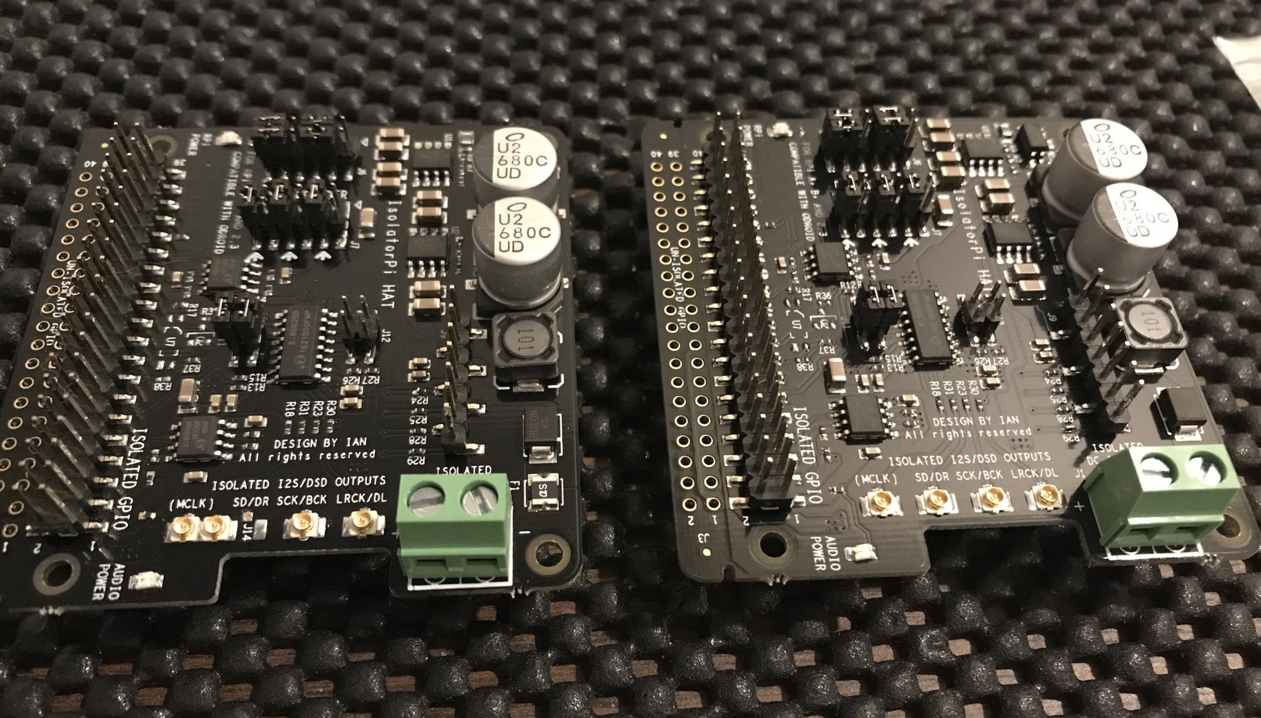

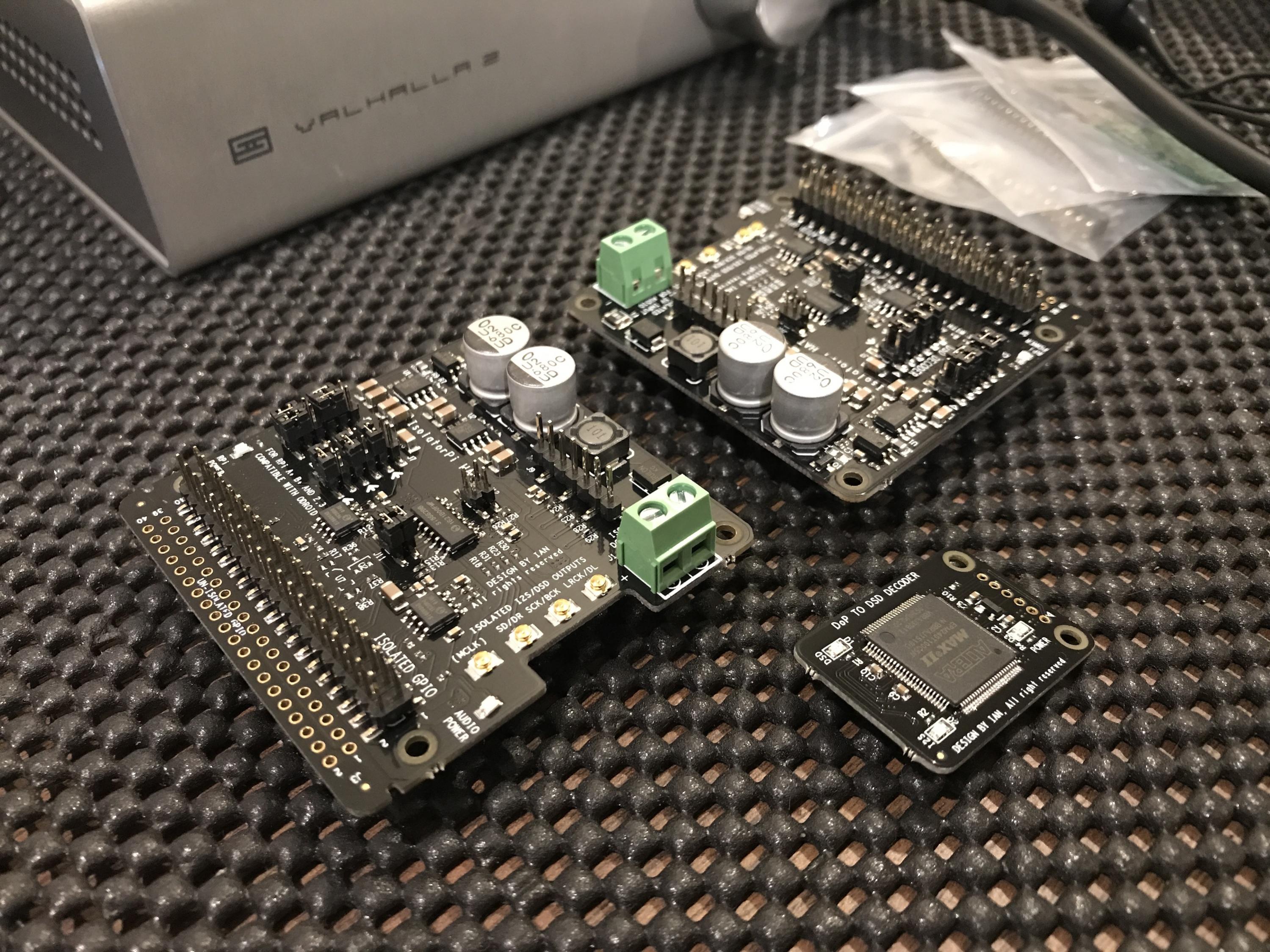

Look what showed up, was not expecting these until Friday!
Interesting pic'n'place blip (see the u'fl sockets)
Thanks Ian.
@sckramer,
You are really very lucky .
Do you need a u.fl socket to fix it? Or, I can help.
Ian

I can probably work around it, and eventually use my rework station to fix it. So all good.
That's great!
Ian

Hi Greg,
Well it's after midnight in NY and I just now shut down the listening session for the evening. GREAT stuff all the way around, but especially with the UpTone LPS-1 powering the MamboBerry DAC.
The LPS-1 took things to another level, and thats no knock on the very good and inexpensive iPower, but the LPS-1 outclassed it in all ways, especially soundstage size and focus.
I am supplying the DAC, and the RPi separately, but still unclear to me if the jumper is needed.
I don't think it is, as my memory says it is as you described with the original Mambo DAC, the jumper is only used when powering just the DAC, and the DAC in turn powers the RPi. That was my old set-up, but not anymore with the IsolatorPi in place, they are now separately powered so I think I can get rid of that jumper, or maybe not if thats how the IsolatorPi gets it's power.
I can't imagine it will cause any harm to try it, the worst that would happen is it won't work and I'll just put it back. I guess for peace of mind I could also email the folks at Collybia to confirm.
Yes, the IKEA small size bamboo boards are perfect for things involving the RPi, or the LPS-1, and inexpensive to boot.
I'll bet your LPS-1 powered HAT stacks sound crazy good, I wish I also had another good 5v LPS to try but for right now I only have the UpTone UltraCap.
Cheers and goodnight from New York!
@sckramer,
Ian
Hi Ian,
Looks like there's more going on with that one... its audio power LED never lights and I can't get it to do anything. Completely matched it (jumpers) to the other board, swapped things around, tried a digi+ board, misc etc. The other one just works.
Any ideas or things to check?
In your setup, If you remove the blue jumper, the 'audio' side of the isolator will not be powered...
