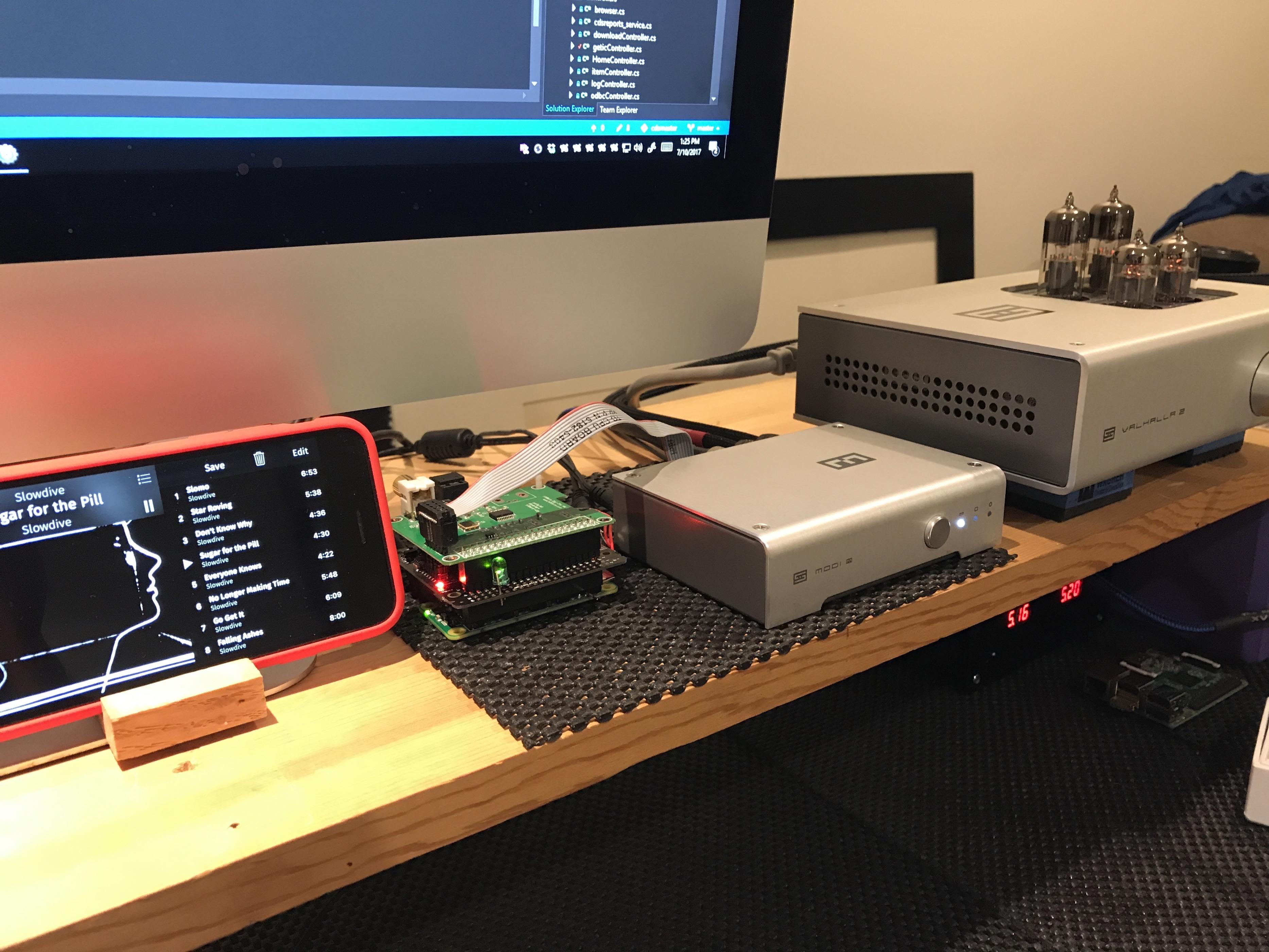

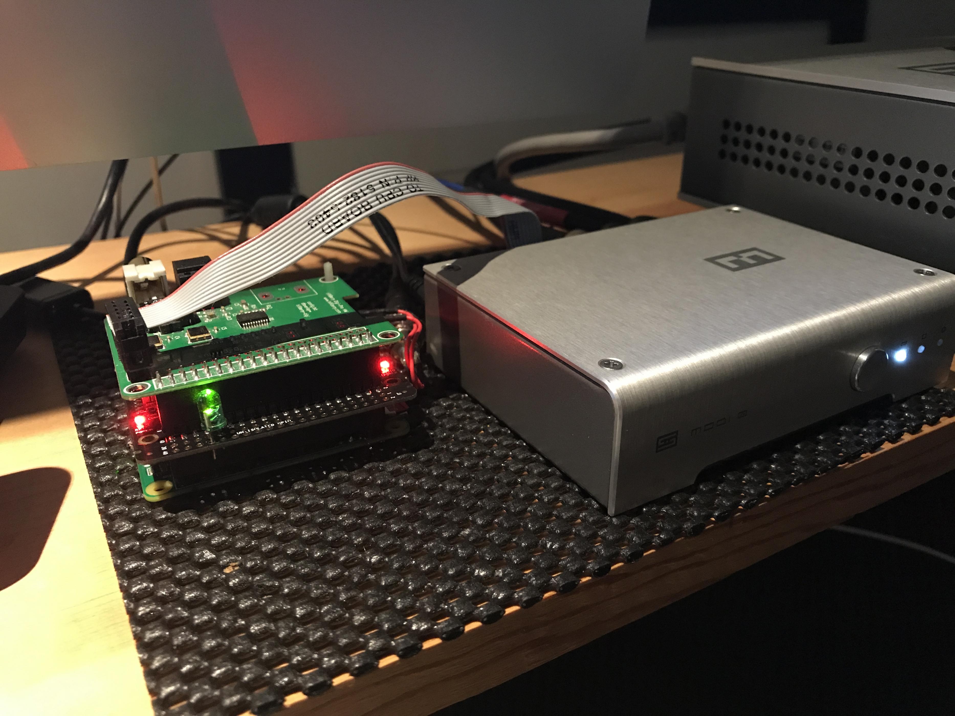

Ian, So my replacement works!
Started comparing with a simple i2s source, a raw hifiberry digi+pro (no on board regulation, at least with my beta board).
It's surprisingly easy to hear the improvement even on headphones! It's digging down into the noise, bringing out subtlety. Easier to get into the volume, nice varied leading edge.
Learning that you are not isolating/mirroring all GPIO's. For example this digi+pro relies on GPIO5 (44.1x) and 6 (48x) to select the crystal -- so I set piCorePlayer to sample everything to 48. (It passes thru GPIO6)
I don't plan on using the digi+pro, but thought the digi+pro would be a pretty popular board to use with this...
Any thoughts?
Thanks!!!
PS. I'll send you that half broken board this week.
