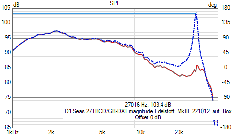

I compared a notch in series to a Seas DXT tweeter 1:1 non-blinded during measurements and noticed a clear difference with fast sine sweeps up to~48kHz (96kHz sampling frequency) fully exciting the resonance. Without the notch there was a sharp buzzing note in the reverberation after the measurement that disappears completely with the filter applied. Difference was very obvious. Same test with a Bliesma T25A (breakup @34kHz) not so...
@IamJF personally I like the DXT very much, very neutral sound if applied/used right.

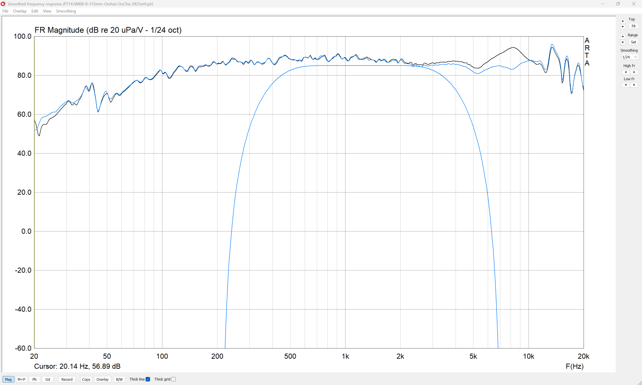

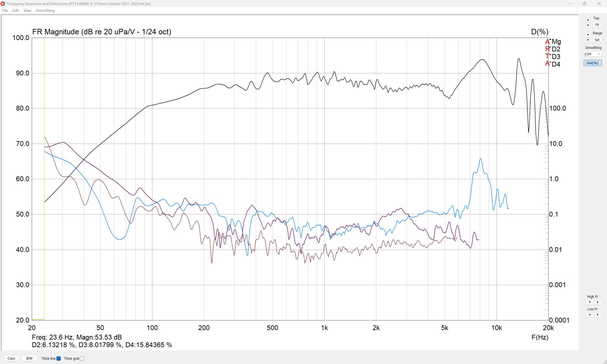

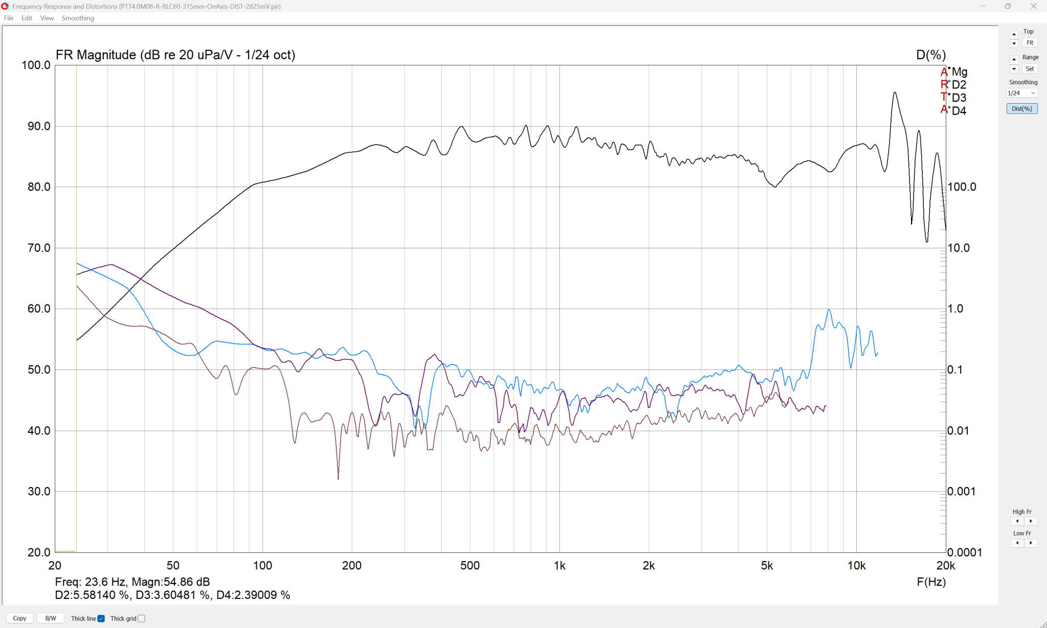

In an effort to try to understand how to interprete distortion measurments and impact of a parallel RLC in series with a driver the following measurements with ARTA at 315mm on-axis of the PTT4.0M08-NAC04 mounted in box and at 2.83 Vrms:
The driver without RLC:

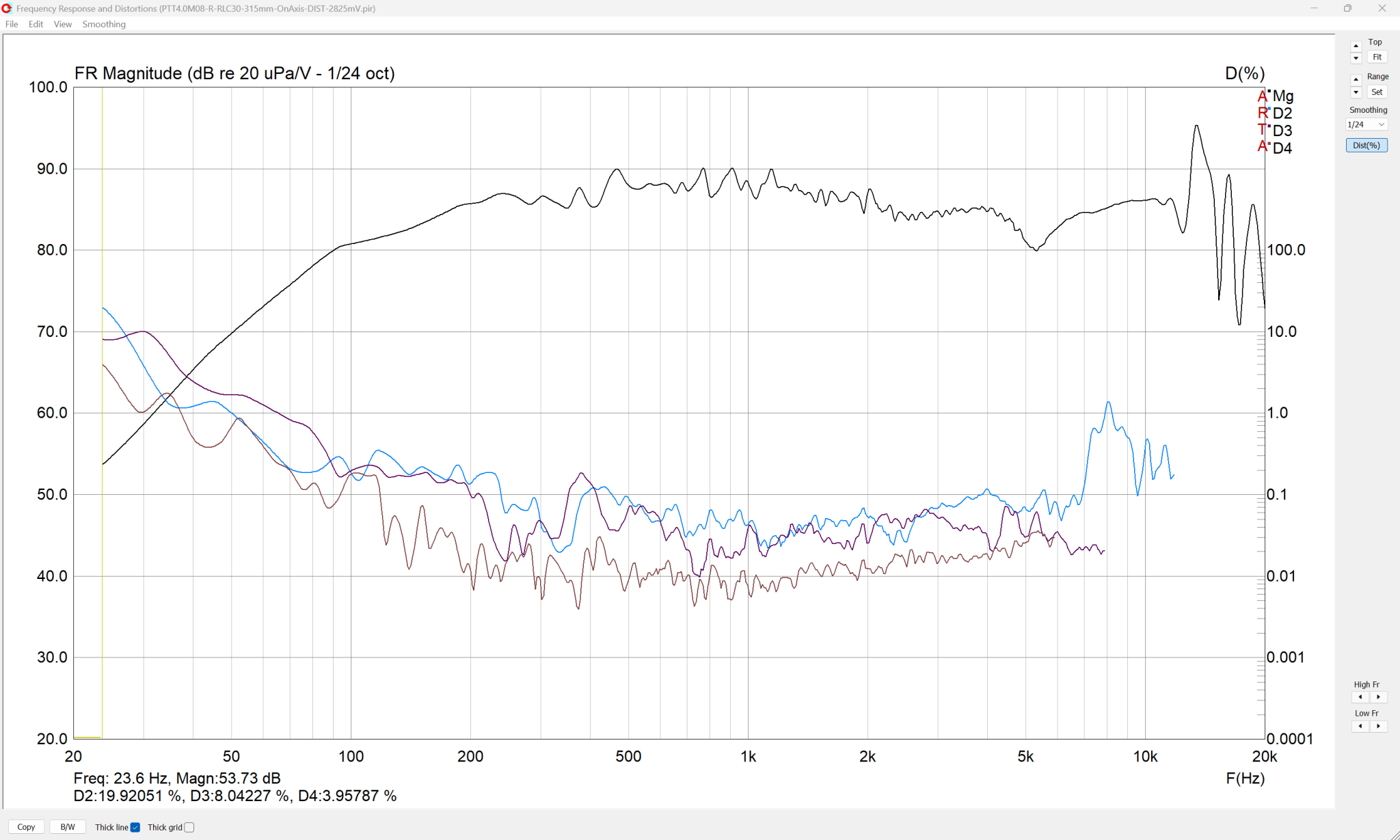

RLC with 30Ohm:

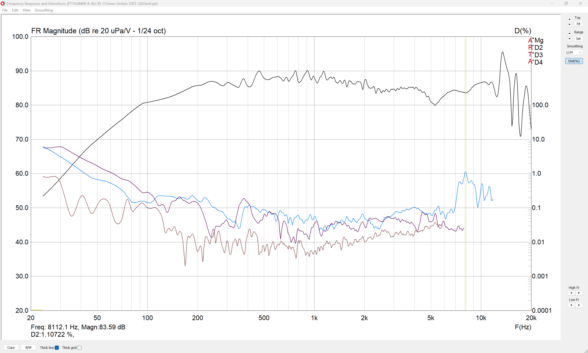

RLC with 45Ohm:
RLC with 60Ohm:
My interpretation: The cone-breakup has a spl peak at 8.2kHz, and applying an RLC tuned at that frequency gives a reduction at 8.2 , also 8.2/3 and less so at 8.2/5 .
Also that the R value in the RLC has significant effect on the SPL and Distortion reduction at 8.2kHz, not so for Distortion reduction at 8.2/3.
Whether this is audible will be the next test, to give an idea of the active filtering that will be applied:
Note: the phase is not shown, but the filter that will be applied is linear phase.
Interested in other interpretations ;-)
RLC with 30Ohm:
RLC with 45Ohm:
Some obvious observations, but still...:
Would that be correct and complete?
- DSP filters can't suppress driver own created harmonics (aka distortion) - anything going on in the pass band that generates 2:nd 3rd etc will playout outside the passband.
- DSP filters can't suppress down stream electronics to generate and playout distortion in the passband.
- DSP filters can't suppress down stream electronics to generate and playout distortion in the stop band - analog filters will.
- DSP filters can't suppress the rubbish sent back by a driver to the driving amp - in the stop band, analog filters will (by its increasing impedance towards the amp (?))
- DSP filters can suppress resonances in the pass band(s).. that trigger distortion downstream and thus reduce playout level of these harmonics.
- DSP filters can suppress frequencies in the stop band.., that trigger distortion downstream and thus reduce playout level of these harmonics - this was the case above...

It's very important to state if the chart describe where the distortion is triggered (e.g. 1k) or if it shows where it occurs (e.g. 3k for 3rd). REW has a tick box to choose which one to display. You use something else - right?
Yes, that 2.6kHz peak in HD3 would be real acoustic output, but the output is at 8kHz 😉The distortion reduction 3th harmonics at 2.6 kHz would that be real at that frequency range?
2.6kHz is on the pass band so gets full input signal as your low pass filter is higher, around 3-4kHz. Obviously you have cone moving at frequencies on the pass band. Also the power amp would be after the DSP. Both the amp and driver would generate some distortion products including harmonics, which extend way beyond the pass band and any that lands on the cone resonance will get amplified further.
3rd harmonic is likely from driver motor and it appears in current through voice coil. Increasing series impedance by using RLC filter or just series inductor reduces the current so reduces acoustic output of this sorta distortion.
Yes i use ARTAIt's very important to state if the chart describe where the distortion is triggered (e.g. 1k) or if it shows where it occurs (e.g. 3k for 3rd). REW has a tick box to choose which one to display. You use something else - right?
