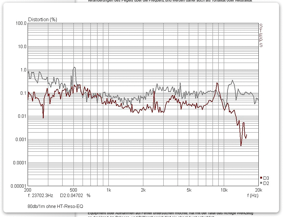

Attached. This was part of the old Tafal project with (IIRC) a modified H0883.

You guys seem to be missing the point of my inquiry. I'm asking specifically, why should I care about reduction of harmonic content at 25khz through use of a notch filter? Image above of DXT might look "bad", but all the "Bad" stuff is at 25kHz range, show me something that occurs at <20kHz please.

See my post above, and the links: the point of notching the HF resonance has nothing to do with lowering HD at that frequency. It's done to lower the resonant amplified distortion lower down in the audio band. So in the case of, say, an unfiltered 25KHz resonance, you will likely encounter a spike in HD3 at 8.33KHz, F5 at 5KHz & so on, which will be reduced if you add a high impedance notch on the HF mode -you can see that clearly in the animated gif I provided above. The old H0883 had its main dome resonance at just over 26KHz: you can see the spike in HD3 at about 8.7KHz resulting from this, and how it in particular (but overall HD3 too) is significantly attenuated when the HF mode is notched out. And so on & so forth. It's exactly the same method more commonly [these things being relative 😉 ] used on midbass drivers for the same purpose. It just happens to be higher in frequency.
