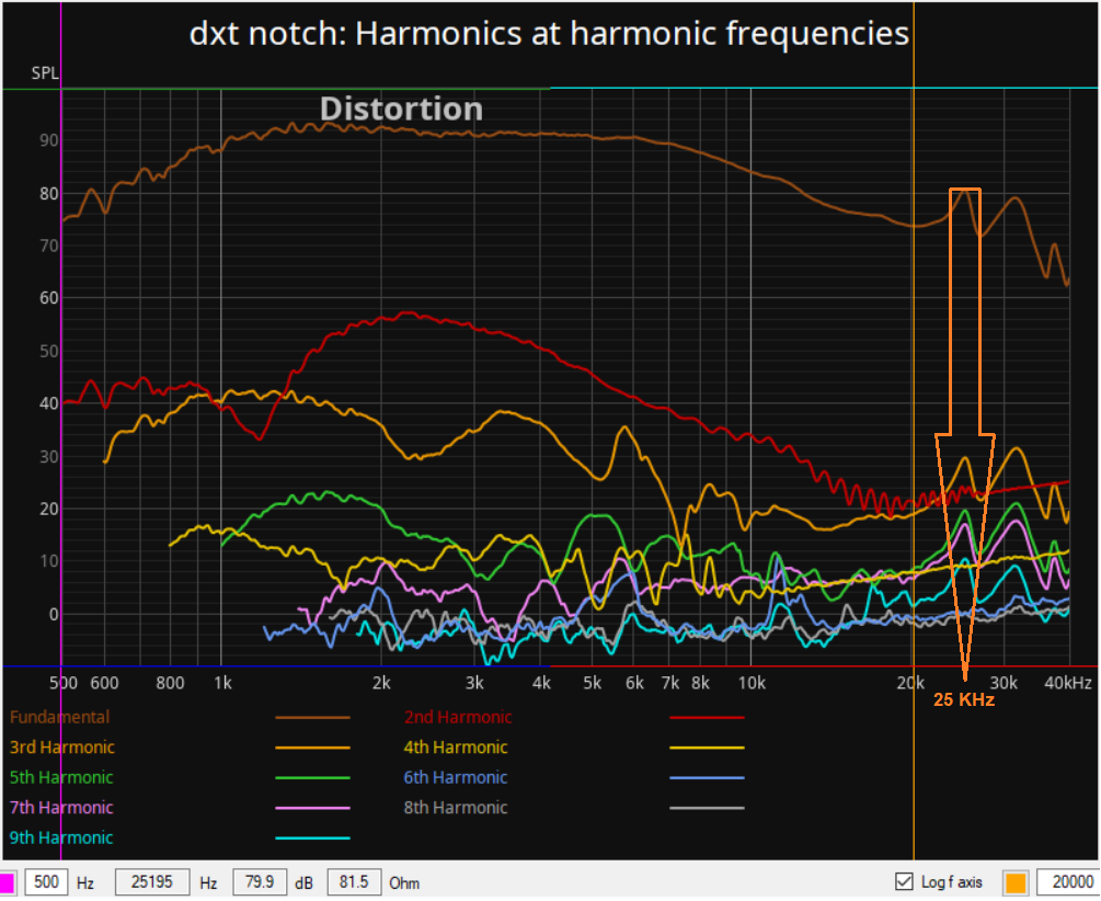

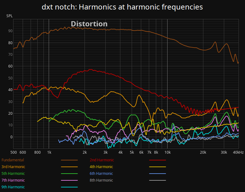

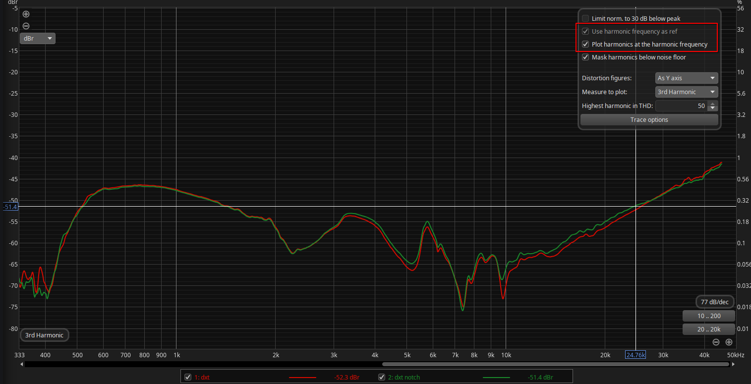

Reduced with a notch - looks amazing, right?

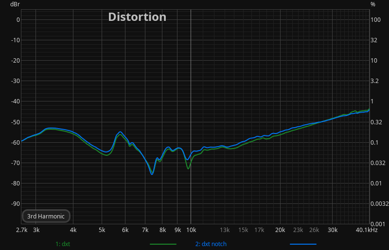

Let's compare H3 relative to the fundamental, at the harmonic frequency. Nothing has changed.
I'll say again, then move on from this dead horse - why should I care about anything that occurs at 25kHz? What benefit does the notch provide at frequencies heard by humans?
Comprehend?

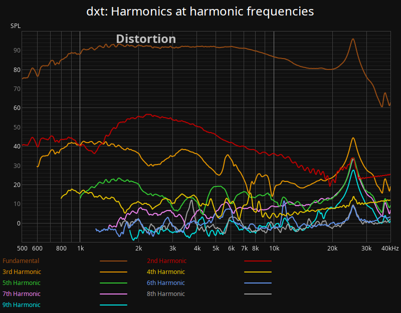

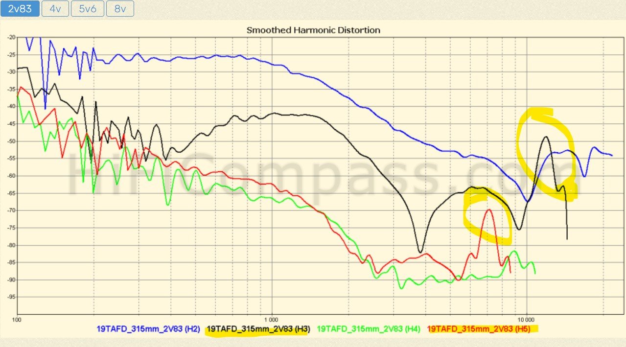

See supersonic peak in FR. Now see how there are similar peaks in the HD values at lower frequencies? THAT is why a peak at a HF is consequential, and not because of the primary effect of the SPL. But if you do not care about HD, then yes I guess "meh" would be an appropriate response.

HD distortion plots are easily interpreted wrong, there is no subharmonics although it looks like it. Usually a HD graph shows peak at fundamental but the harmonic acoustic output is not at the fundamental but at it's frequency, multiple of the fundamental. Peak in HD3 graph at 8.3kHz is not sound at 8.3kHz, thats the fundamental which has a HD3 to it, which outputs at the 25kHz as sound. Attenuating the 25kHz would drop HD3 of 8.3kHz, likely inaudible change in sound because sound at 25kHz got attenuated. The graph cleans up though.

Okay, hear me out here-
Does this mean the DXT as pictured above, which is considered robust and can xover low, should not be used below 8kHz because 2nd order rises below there when viewing harmonics at the aligned audible frequency?
It seems counterintuitive to suggest suppression of the fundamental to reduce harmonic peaks at that frequency when they are both inaudible to the human ear and at the same time more suppressed than would be audible if at -50dB.
However, it seems most take the HD2 as shown for second order rise and attempt to xover above where it rises. No one has past corrected my typical usage this way, so as such I may actually have fallen prey to this interpretation as well. Fortunately, it doesn't seem to have impacted the results of my projects. However, now I question my implementation methods.

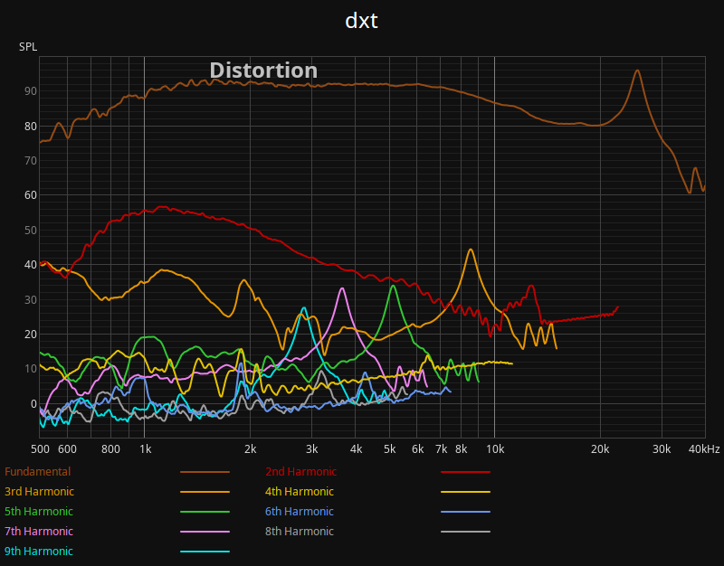

to rephrase it, you mean the 8K HD3 is NOT due to a 2K origin that creates a H3 peak there, But instead is a fundamental disto at 8k Hz marked H3 that will hearable at x3 so 24K hz ?
It's not clear to me why there is no H3 sound at 8K while there is a peak there ! why they just no show on the HD3 orange currve a peak at 25K hz instead ?
I'm just looking measurements looking at H3 peaks for instance, just hoping it will not polute the same fundamental and H2 frequency in the threshold of audibility (= don't care if the H3 is at -40 dB, and even less if the H5 is even less) ? Or if in the threshold of audibility at this frequenty, accept its effect in relation to the fundamental and H2 : clearly hopping it is below H2. So I was wrong there ?
So not sure I understood what you wrote.
As I understand it : ideal would be a mic that has flat H2 H3 etc, each below the above number : so H7<H6<H5<H4<H3<H2<fundamental in spl level, idem for the driver, in order the well recorded instruments exhibit their harmonic structure we need to recognize them; i.e. for illustration some instruments at some frequencies have more odd orders than even and so on.

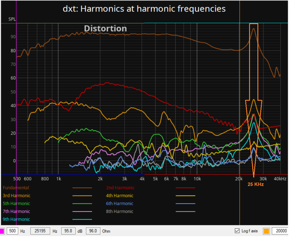

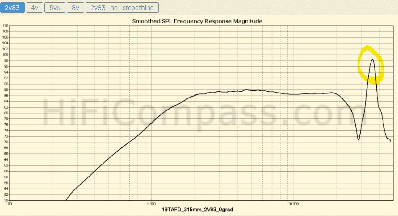

For the reader I will attempt to clarify what is being discussed here
1) peaking/ringing of the hard dome in the ultrasound band (tail or base of arrow)
2) effects on harmonics at the frequency where they fall (tip or head arrow)
3) reducing the resonance at 25KHz down to 80dB (see: tail or base of arrow), ALSO reduces all harmonics (head or tip of arrow)
@DcibeL is not asking whether the ultrasonic notch filter is removing the peaking/ringing. Clearly it is.
He is also not asking whether the harmonics are reduced- clearly it is: all the harmonics that fall at 25KHz are also reduced when the ultrasonic notch filter is introduced.
What he is asking is this- Is there any other reason for using an ultrasonic notch?
Because if we can't hear above 20KHz, why should we care about the fundamental at 25KHz, or the harmonics that fall at 25KHz?
So I guess it depends on the position that one takes- can you or I hear above 20KHz? There is a recent to study that showed that a group of people could not reliably hear, nor the brain be measured to able to detect when ultrasonic content had been removed from the speaker.
I've had my hearing tested and I for one cannot hear above 16KHz.
For me, there's no need for tweeters that extend above 20KHz, and also no need to notch out ultrasonics.

When determining the lower cut-off point at the tweeter, for some years it has been a habit for some of us to look at the harmonics at the frequency where they are excited.
Here at 3KHz, the fundamental is 92dB, it's 2nd harmonic is at 42dB (-50dB),
At 1KHz the fundamental is 88dB, it's harmonic is at 56dB; (-32dB), which is higher.
Based on this representation, we might consider an ideal Fc somewhere below 3KHz but above 1KHz.
Please do NOT look at the chart where the harmonics fall, that will just confuse things further.
@wolf_teeth

The kicker in comparison of the above two graphs, is that the relative level between fundamental and harmonic level at any frequency is unchanged. In the measurement with the notch filter in place, the fundamental and the harmonics are reduced by the same amount. There never was a "harmonic" problem per se, only a peak in fundamental response due to a resonant mode. It bears repeating, this graph shows a direct comparison of relative harmonic level, using the harmonic frequency as the fundamental reference, there truly is no meaningful change with respect to harmonic levels relative to the fundamental, the notch simply allows it all to be reduced by the same amount.

Hi, yeah it depends how your graph settings are. As Dcibel shows above you can swith to show the HD where it actually outputs, by checking "Plot harmonic at the harmonic frequency" in REW. By default HD plots show the fundamental which causes it. If you have a "subharmonic" of a resonance in your graph, change your plot settings and you see all the "subharmonics" line up at the resonance instead.to rephrase it, you mean the 8K HD3 is NOT due to a 2K origin that creates a H3 peak there, But instead is a fundamental disto at 8k Hz marked H3 that will hearable at x3 so 24K hz ?
It's a useful setting to be able to switch, you can see either what frequency causes HD, or at which frequency the HD outputs. Just be mindful which plot you are looking at.
