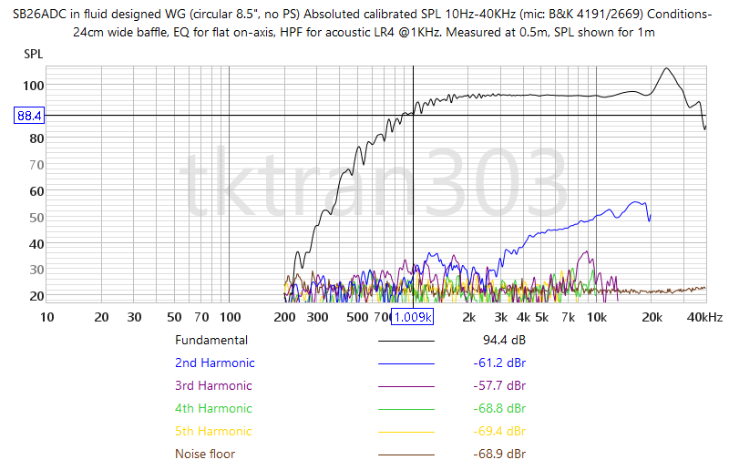

In collaboration with @fluid, here it is mounted on a custom waveguide, with a HPF for acoustic LR4 1KHz, to match a 8” midwoofer on a 24cm wide baffle.
Measured for 96dB/1m:

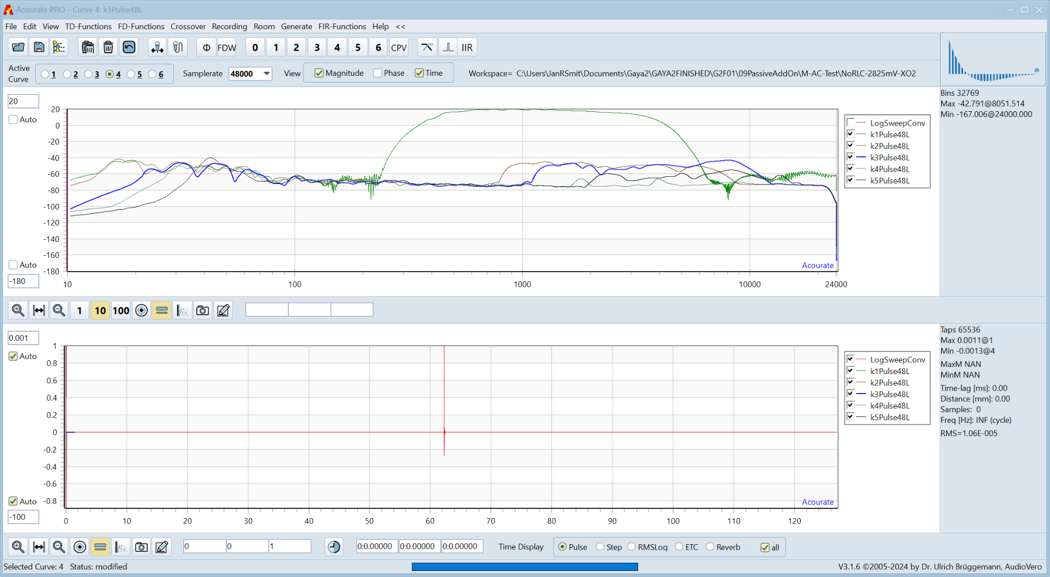

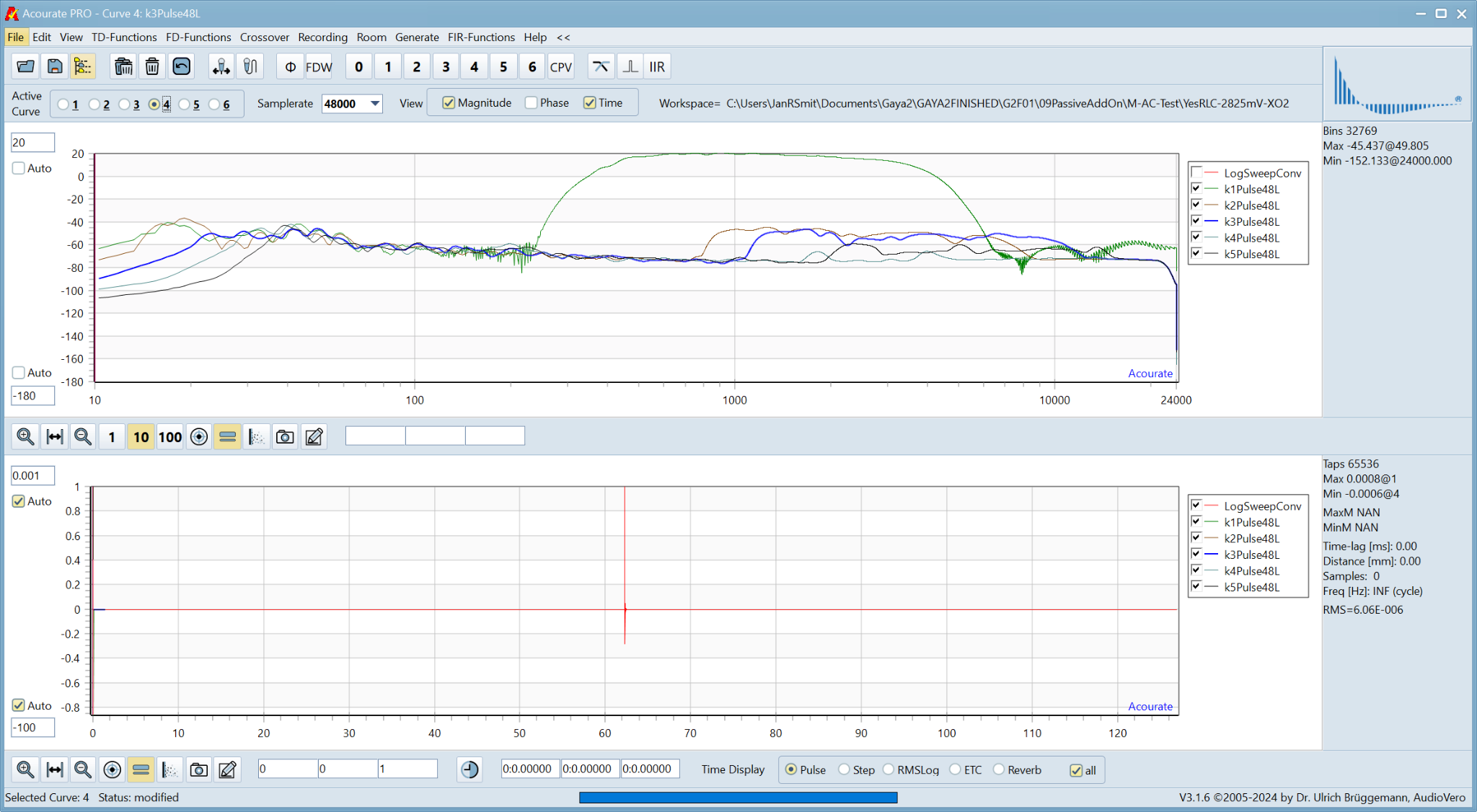

Following my post https://www.diyaudio.com/community/threads/some-speaker-driver-measurements.317632/post-7957155 i did test on distortion effect of a parallel RLC in series with a midrange and an active filter applied:
NoRLC:
Yes RLC:
From this test it appears that it makes a difference in distortion even if the conebreakup frequency is in the stopband. In this case filter is 3.4kHz and fully (> -200dB) down 6.9kHz, cone breakup at 8.2kHz.
Aim is to do Yes/No listening tests on thursday.
NoRLC:
Yes RLC:
Am I interpreting these graphs correctly if I observe in all cases the distortion remains below some 60dB?
Yet I find it difficult to conceptualize the distortion between 7 and 10Khz is actually above the acoustic output of the driver.
Yes i agree, i also am still struggling with the interpretation of the distortion graphs. But distortion generated by the driver could be present outside of the signal driven output. Why not ?

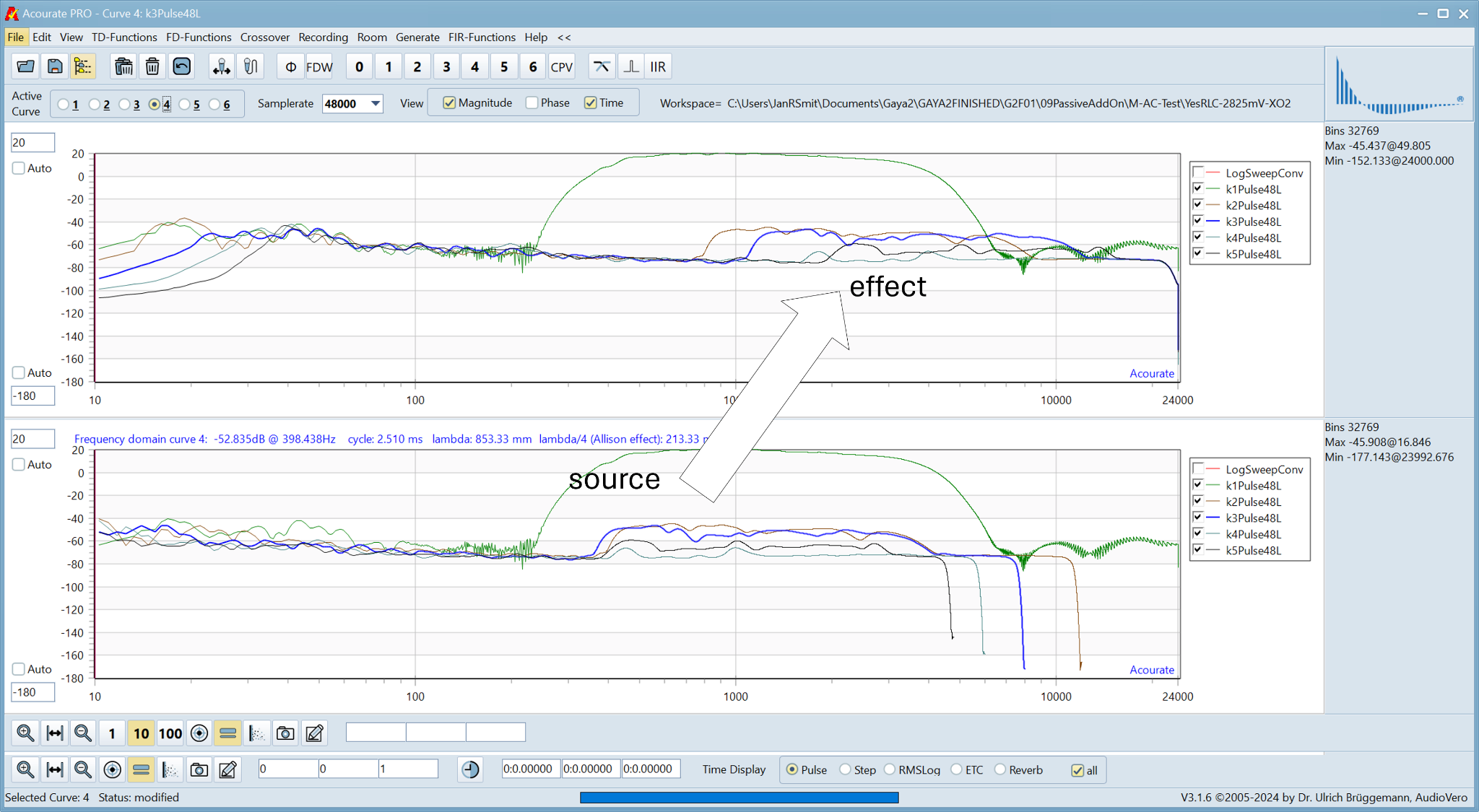

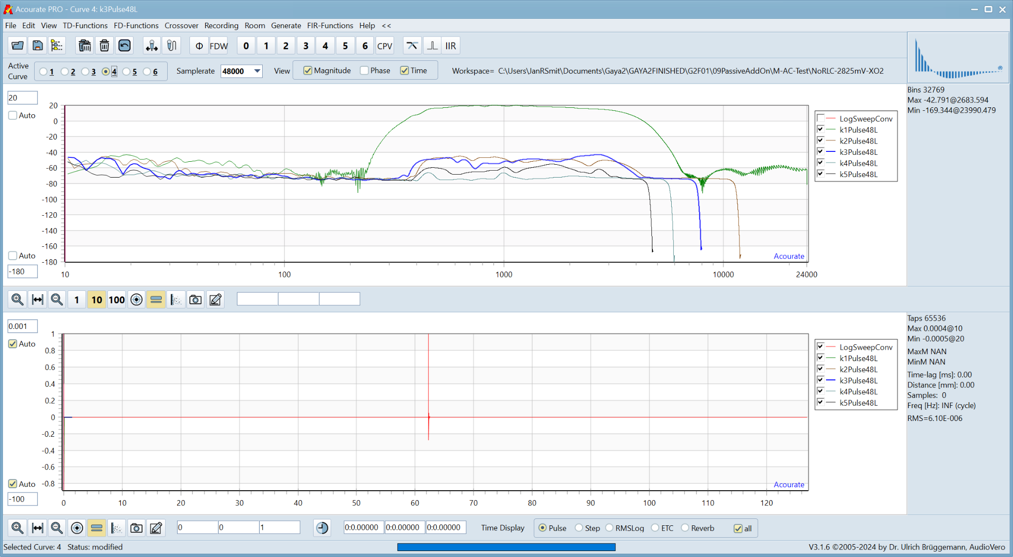

Have a break:
Screenshots 1/3 show the spectrum of all k2...k5 harmonic distortion products.
Screenshots 2/4 show the amount of k2...k5 of harmonic distortion at any k1 frequency.
Look e.g. at k5 (the black line).
Screenshot 1/3: The spectrum of k5 shows a peak at approx. 12.5kHz.
Screenshot 2/4: This same peak is visible at k1 = approx. 2.5kHz (which is well inside the passband)
5 * 2.5kHz = 12.5kHz
Nearly every driver will produce some harmonic distortion products above it's passband, especially for the higher harmonics.
Now for something completely different:
You e.g. measure a metal dome which breaks up @ 30kHz. Now look at a screenshot 2/4-type of k2...k5 graph.
This graph shows seemingly peaking of k2 at 15kHz, k3 at 10kHz, k4 at 7k5, k5 at 6kHz.
Be then aware that these peaks do not represent any real k2 ...k5. It's simply the inverse of k1 * n = kn. It's 30kHz / n = kn.
If there were any harmonic distortive products of the 30kHz cone resonance/breakup, then within a spectrum of k2 at 60kHz, k3 at 90kHz ...
Last not least and nota bene:
You showed Acourate screenshots. It's one of the specialties of Acourate that there are many and also not-so-obvious bells and wistles, leading to some risk of getting irritated by it's results. In case of pending mental crash better then immediately consult Uli Brüggemann, which most of the time will gently explain what has gone wrong ...
Instead, my wrong with these ARTA graphs was to look at the delta dB between the SPL and the kx graphs which I interpreted being some -40db one from the other, erroneously relating these graphs to the leftside db scaling. I erroneously did not pay attention to the hd scaling at the right side. Sorry.
I have direct contact with Uli, my measurements are not wrong in the technical sense. I face some issues with my audio-interfaces which were not logical.
Images 2 and 4 are the ones i read , the 1 and 3 are just for assurance. It is a mental thing to multiply per Hn at k1.
It sort of hit me, more of a Aha kind, why Uli provides the tick box SRC (Source). I already marked my results with YesSRC and NoSRC.
So YesSRC shows the source (where in the spectrum the hd is created) of the harmonic, and NoSRC shows the frequency of the harmonic, in essence:
So the interpretation is clear now. The effect of the applied filter also.
(Of course a proper spectorgram will show the time dimension as well, but this is quite readable now)
I do not regularly follow this forum but I've come across this thread today.
Here I have some necessary comments:
1. when we talk about the order of a harmonic distortion we talk about a factor by which a frequency gets multiplied. So for a simple example a 1 kHz sinewave will show up a 5 kHz distortion as a k5 result. This way a driver playing in combination with a bandpass crossover can produce frequencies above the given crossover.
2a. the distortion chart can show the frequencies as measured. So e.g. in the frequency response shown above ("effect") the distortions replicate the bandpass frequencies multiplied by factor 2, 3 ...
2b. the interpretation of a picture like 2a can be confusing. It is sometimes helpful to see a direct comparison between a certain frequency of a harmonic distortion and its origin = 1st order frequency. In such a case you would always need to calculate with the according factors.
Thus another representation makes sense. By applying a samplerate conversion (this is meant by SRC here!) now all the distortions are displayed in the same frequency range. In the given example (wrongly titled as "source") you can nicely see how the shape of the 1st harmonic is replicated by the higher harmonics. So you can detect a "connection". Of course you need to keep in mind that in reality the distortion frequencies are higher than displayed.
Now i understand my confusion, i knew from the wiki it was sample rate conversion, but in my mind it was stored as source. Thanks for your input @uli.brueggemann
