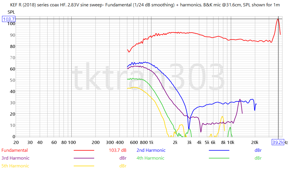

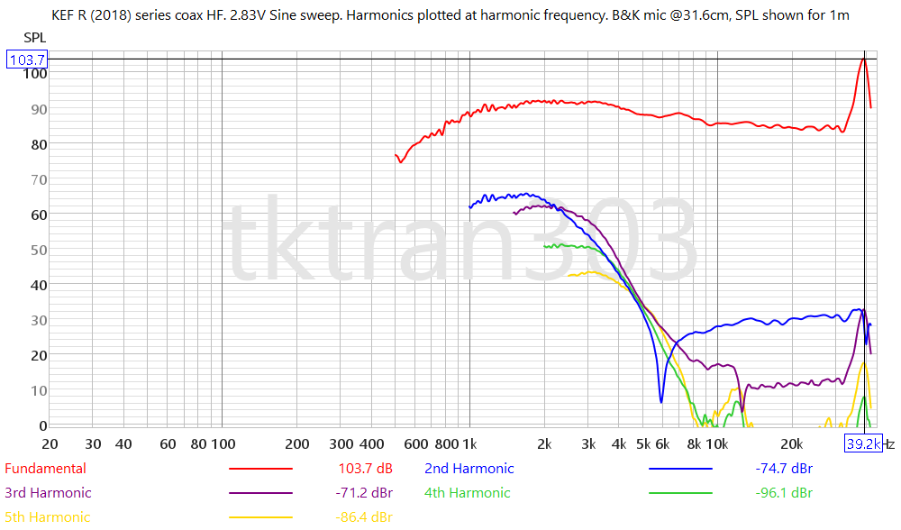

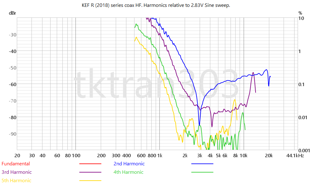

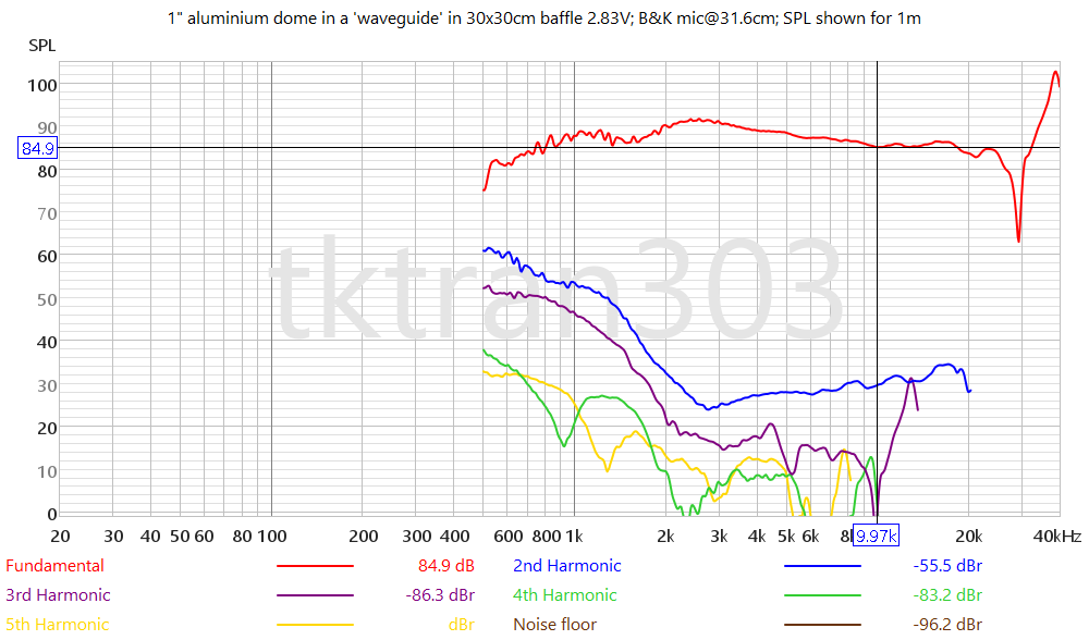

Here's a what an "ordinary" hard dome can do-
NB.
1. the first resonance is 35KHz -> Is there a need for pushing the ultrasonic resonance even higher?
2. H3 and higher harmonics sit around 20dB -> How many rooms are capable for <20dB?

That is correct. It's breakup manifests first as a dip at 25KHz.

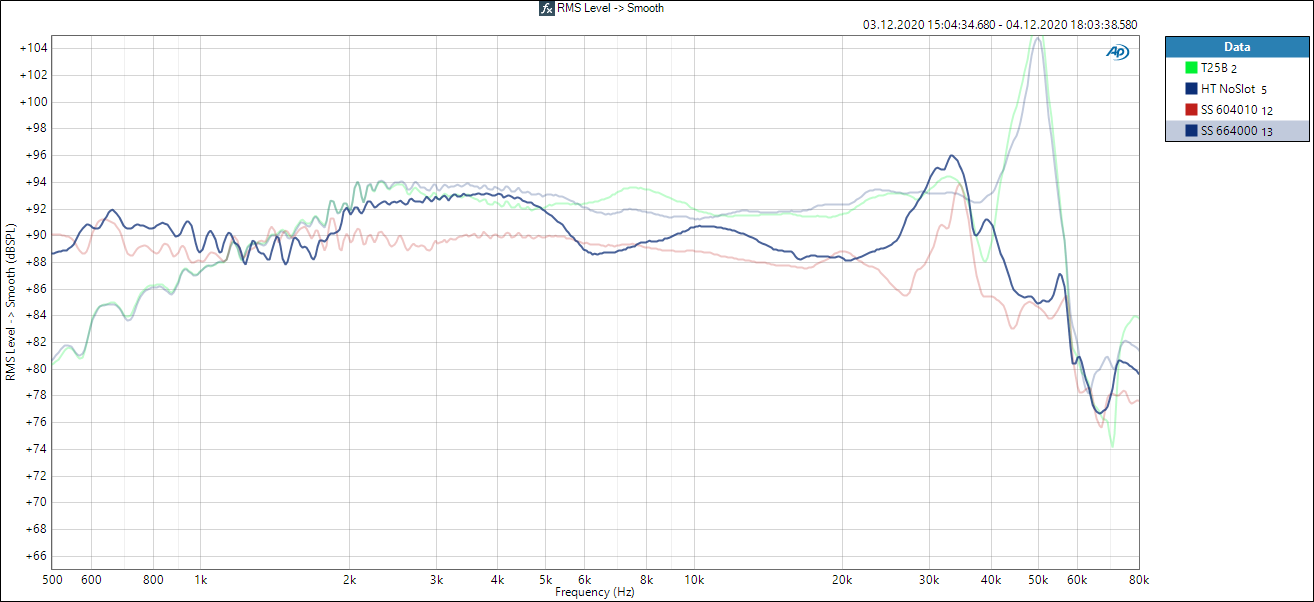

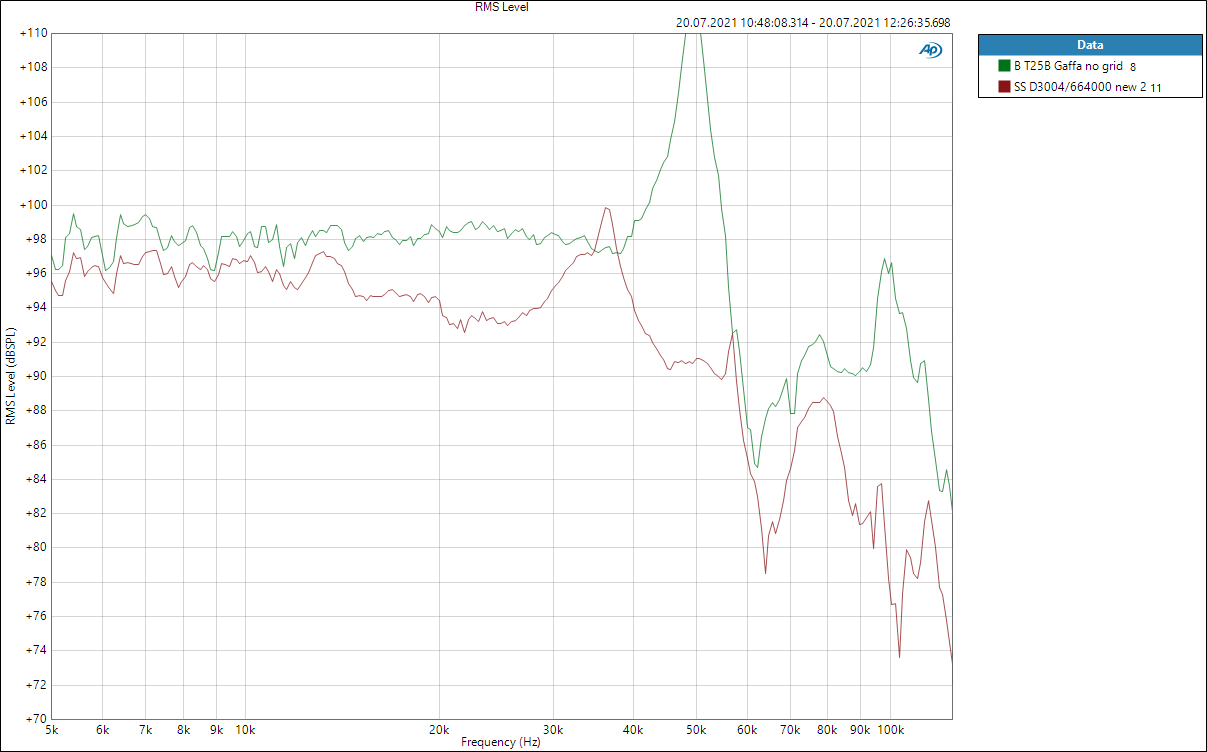

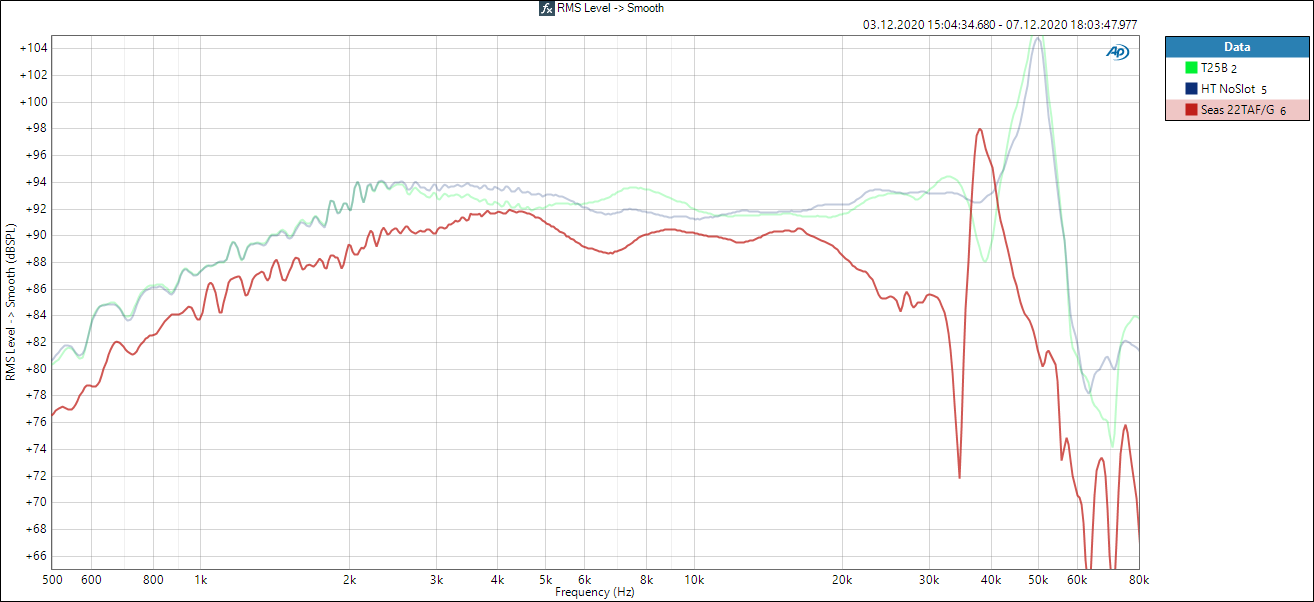

Let's look at some measurements, a little mess but I hope we get the point.

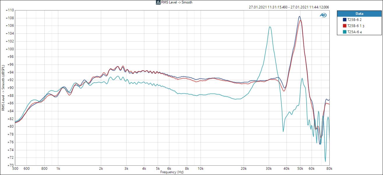

Bliesma T25A vs T25B:
T25B is a league of it's own when you need high membrane resonance (what I needed for a project). Als sensitivity is very high, THD low, off axis better as most 1" (but not as extreme as T25A).
The dip at 40kHz is not from the membrane, it's from the grill and grove around the tweeter. Can be defeated when you are willing to do some changes but as the membrane still needs protection and we probably don't hear it ...
As soon as you introduce a new grid you get new influences. It's hard to beat the original performance (but not impossible ;-))
Scan Speak Beryllium in comparison. I also really like the sound of these.

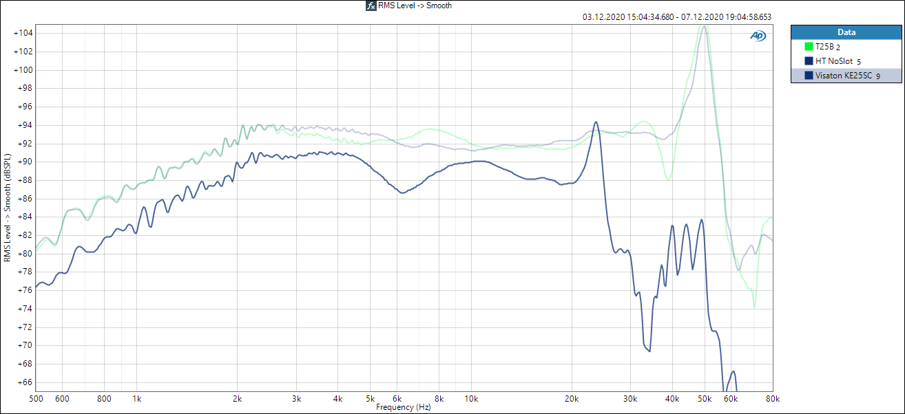

Something more classical, Visaton KE25SC - also a good and very robust tweeter. This is the old version, I measured newer ones which did not perform the same.

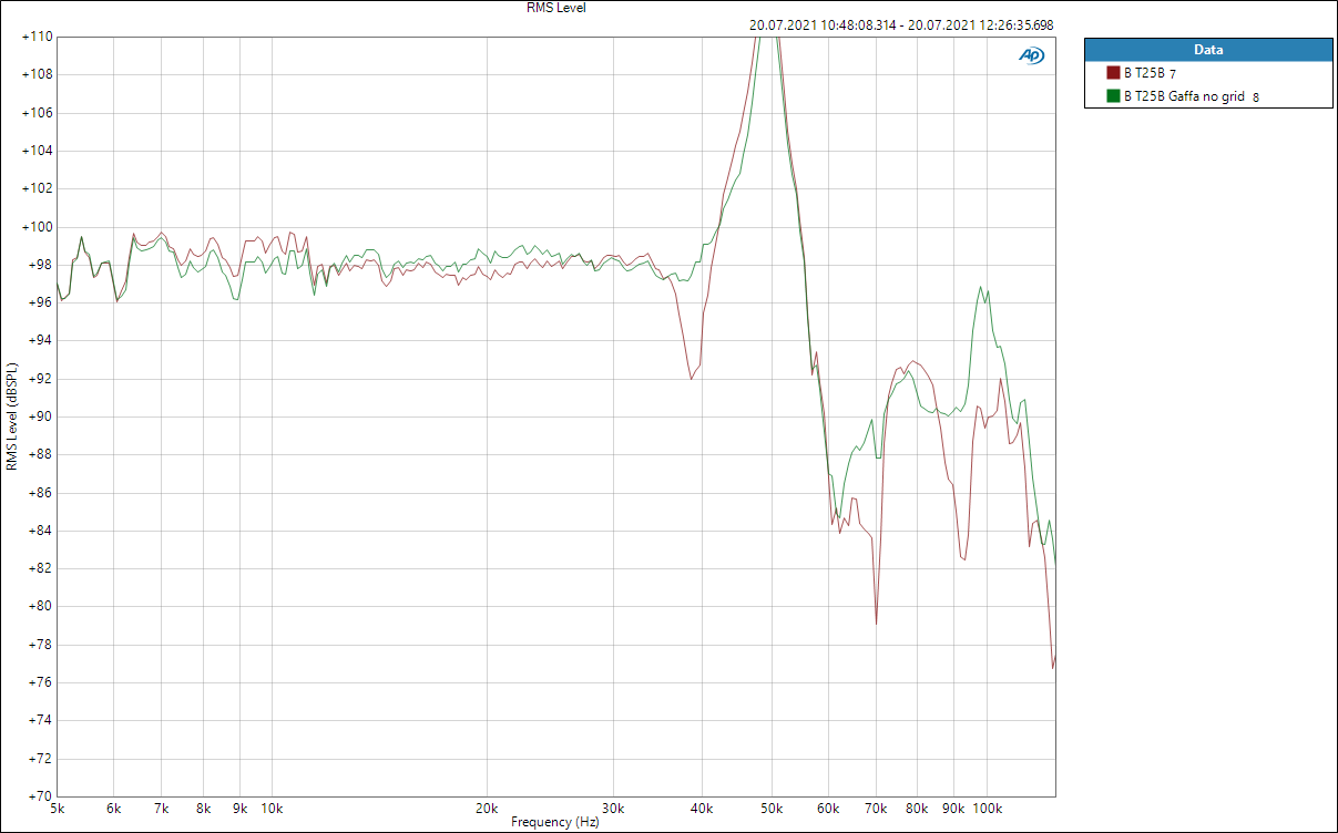

And a different set of measurements and measurement baffle.

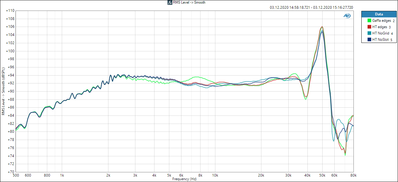

T25B with modification:
These dips before the peak are often influences from the frontplate and not the membrane itself.
Compared to ScanSpeak:

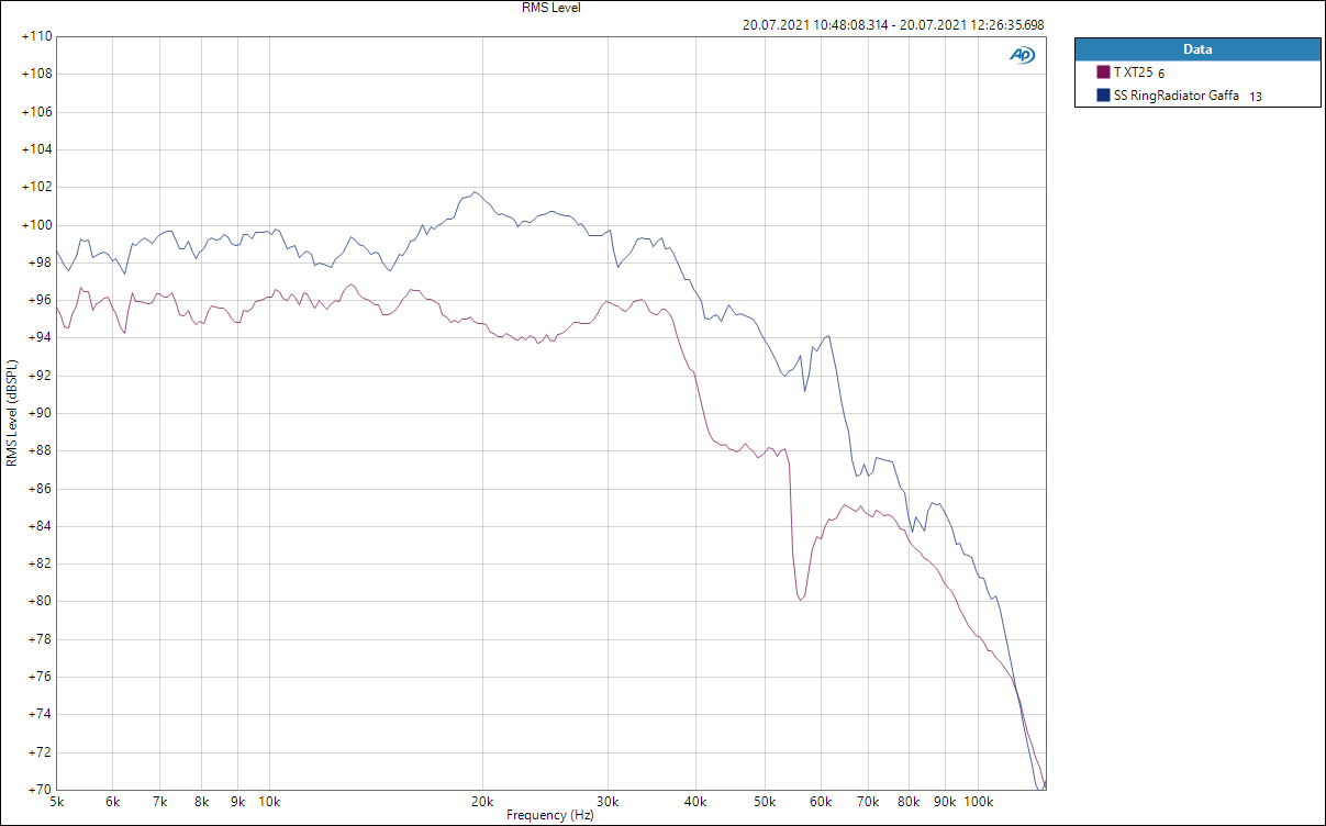

And now - some ring radiators:
I REALLY like the sound of these - but dislike their off axis behaviour. And it shows with practical listening when you are not stuck to one chair in your room.
I used a monitor with ring radiator for a few years - when the sound was right close it was dull in the room. When it was good in the room it was way too much up close.
We would need a modern, SMALL ring radiator which can still play down to 2kHz and has enough sensitivity. This could be a great budget option.

If you are in need of a tweeter for scientific purposes, then I can see why one might need pristine ultrasonic response.
For listening to music, a well designed aluminium dome is fine.

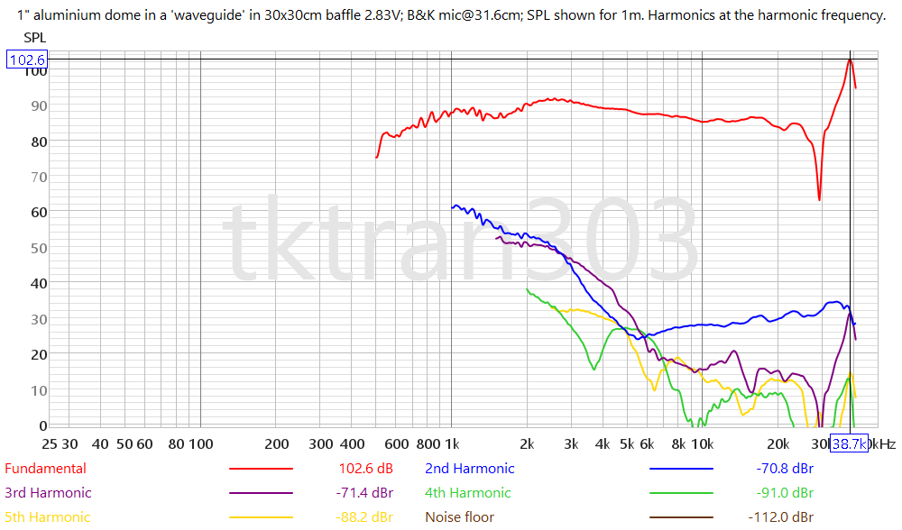

Here's another:
Here's another view:
Whether we are concerned about the dip at 29KHz, or the peak at 39KHz, both are far beyond our hearing ability.
And I'm not going to bother with ultrasonic notch filters. As demonstrated by @DcibeL it only bring downs the harmonics that fall at 39KHz, which we cannot hear anyway.

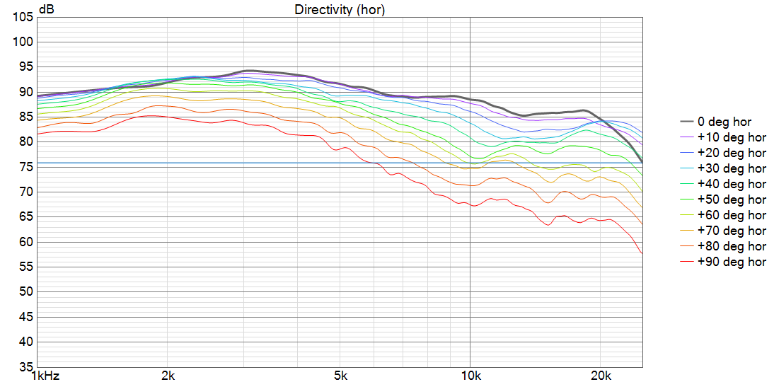

From a scientifical side of the discussion, I like the 22 TAF/G off axis response too. But to help on the low end to match a bigger midrange, it doesn't really need a WG. But certainly become a very goo tweeter with one. Look at the off axis response here and notice the first break up. https://hificompass.com/en/speakers/measurements/seas/seas-22taf/g-h1283. For I, it measures better than a SB Be. But of course theorical as the SB Be can be crossed over much lower and anywway has not the same exotic dome material.
