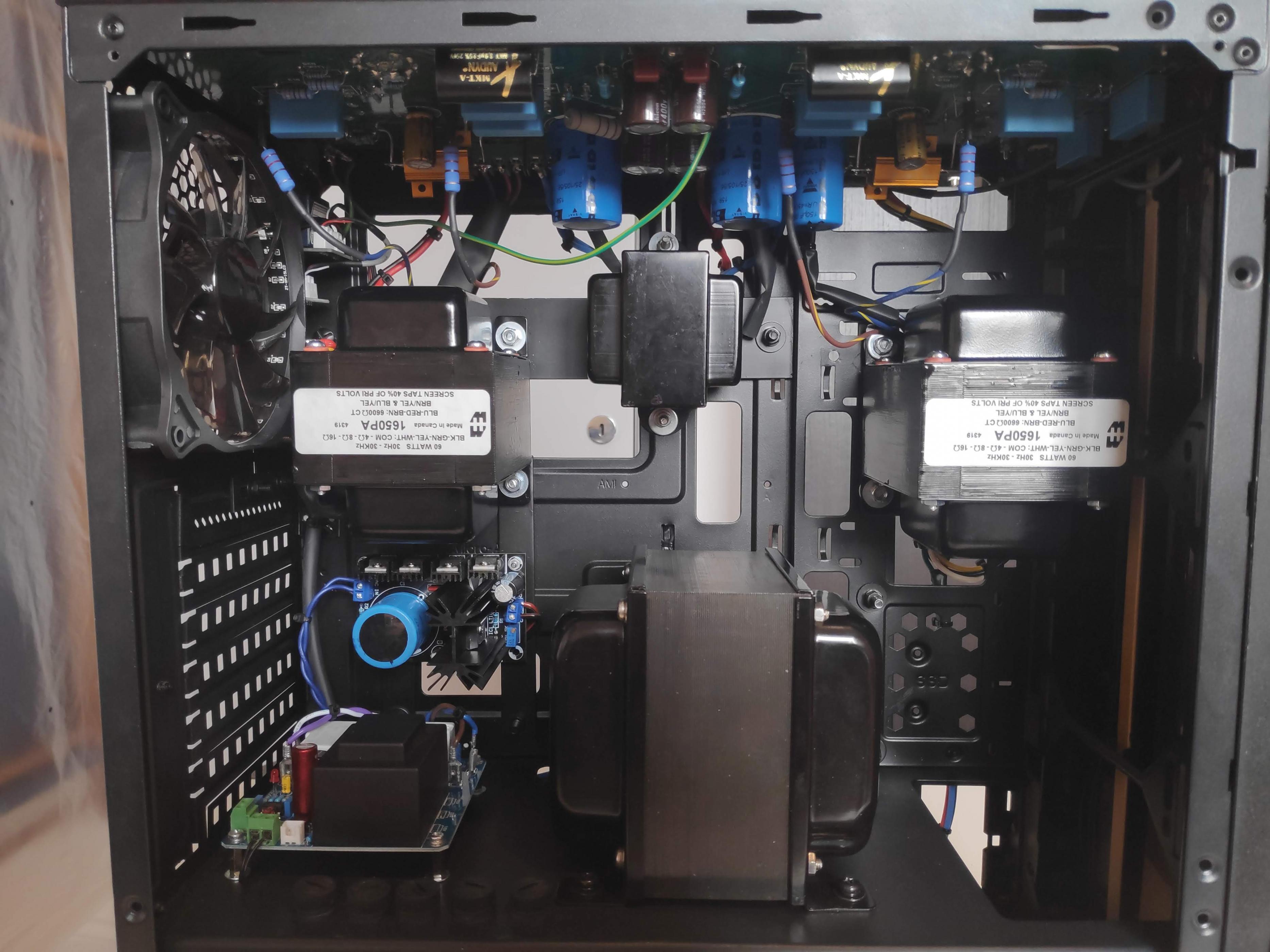

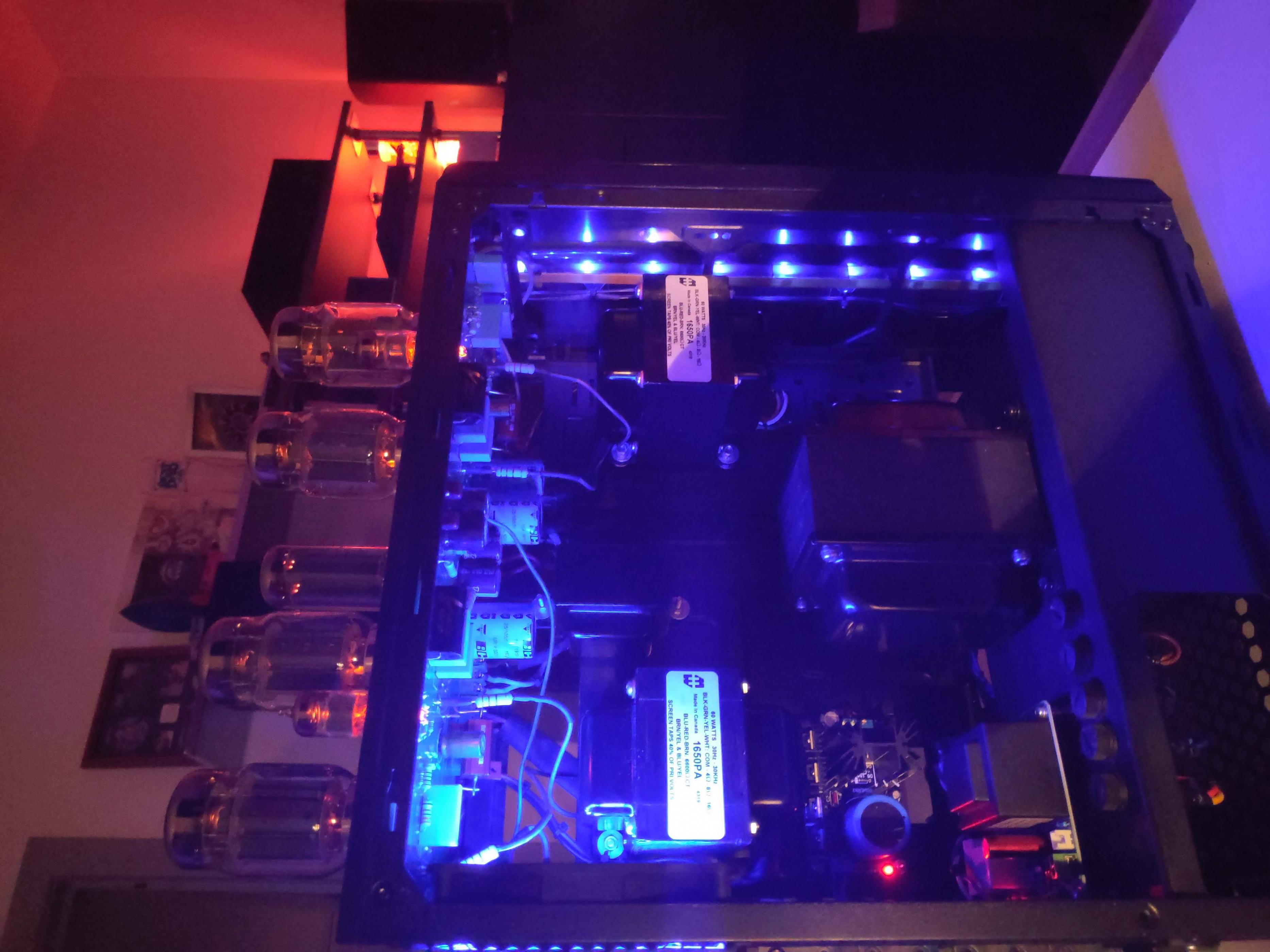

This is the only change I have on the board stage 1 and 2 coupled with a capacitor and the required bias resistors. When I dismantle I'll reverse engineer the board to see if there is anything else missing in the diagram.
(It double sided so I need to fully dismantle) . Will probably do it in LTSpice first.

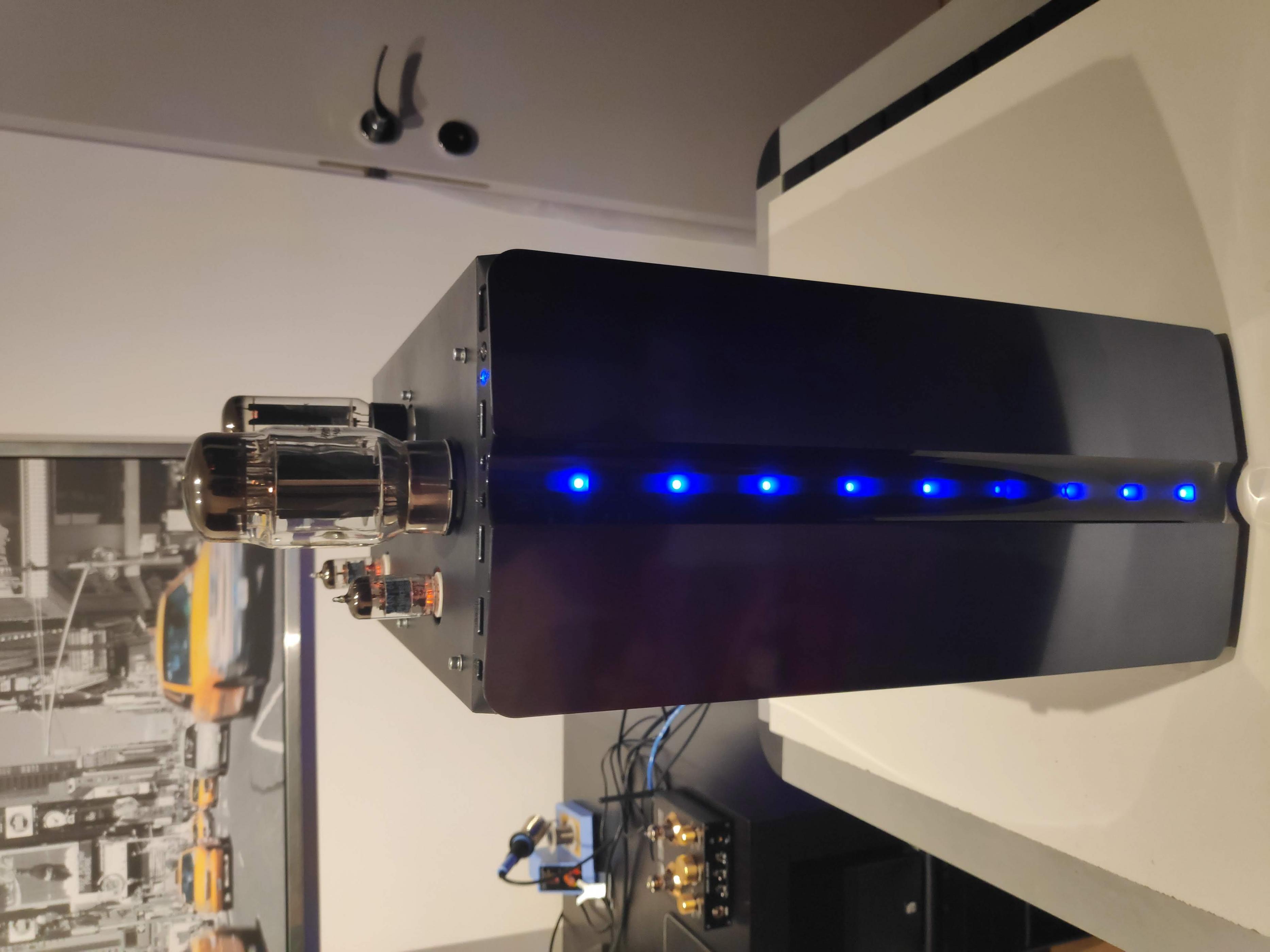

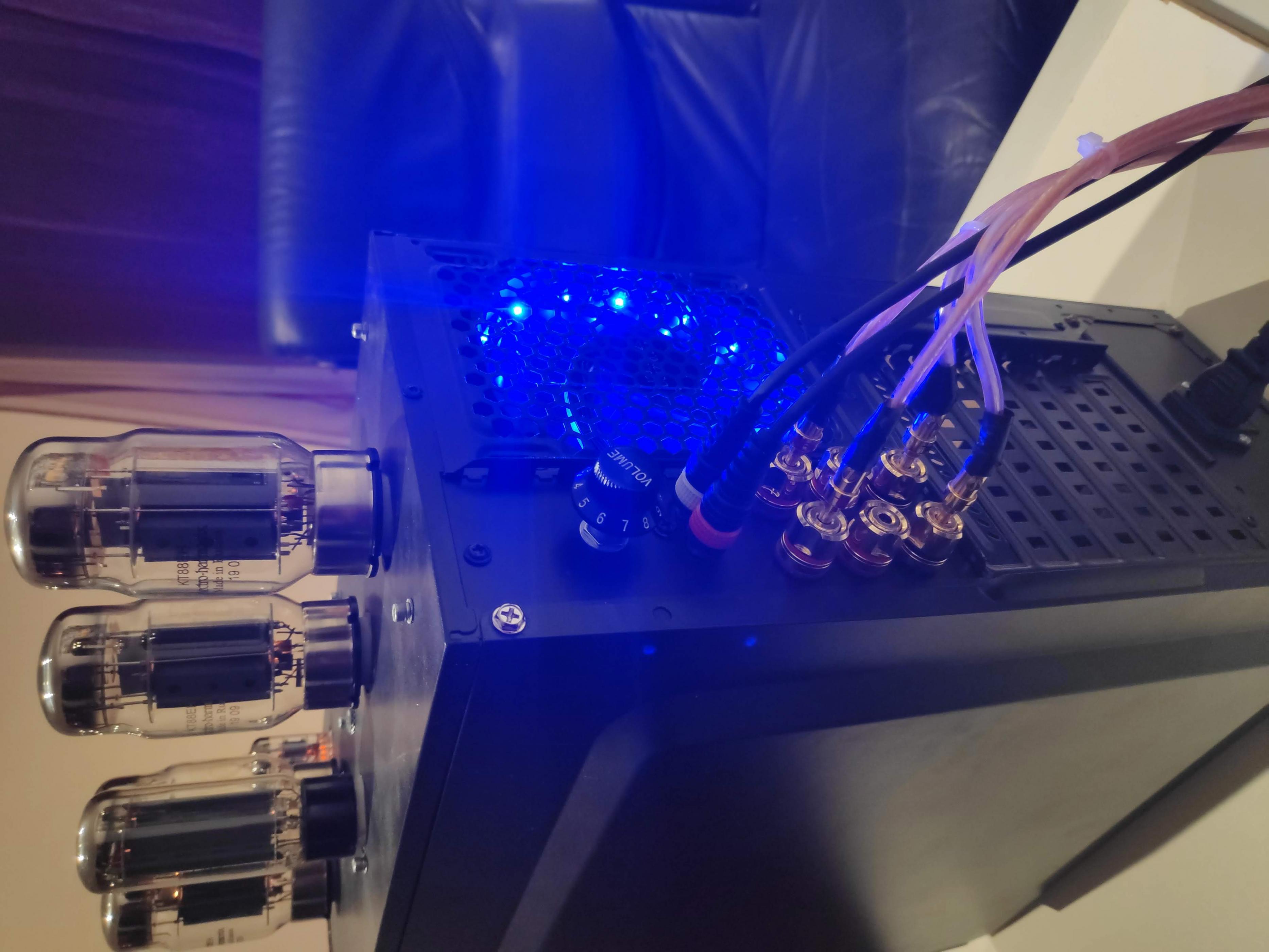

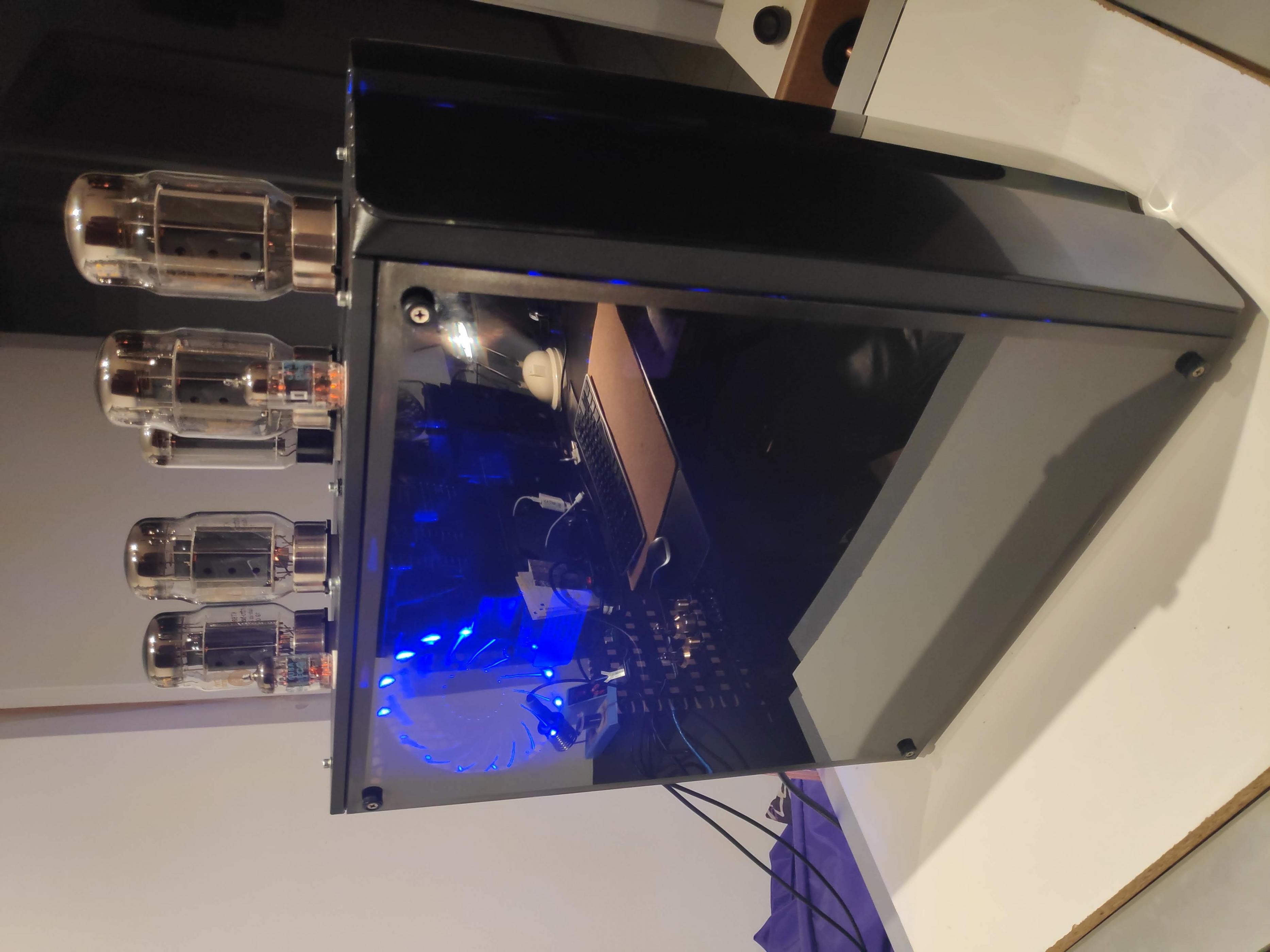

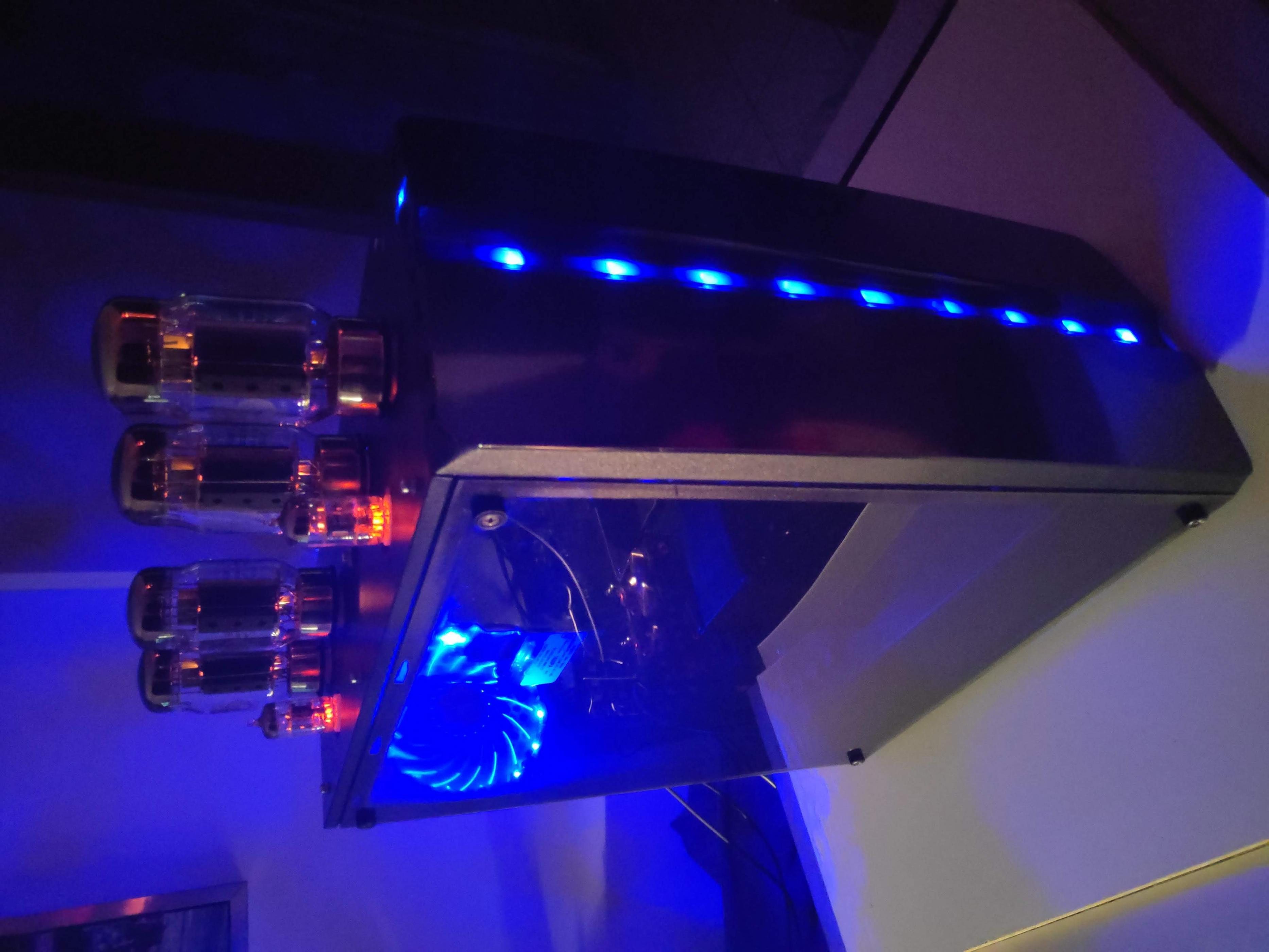

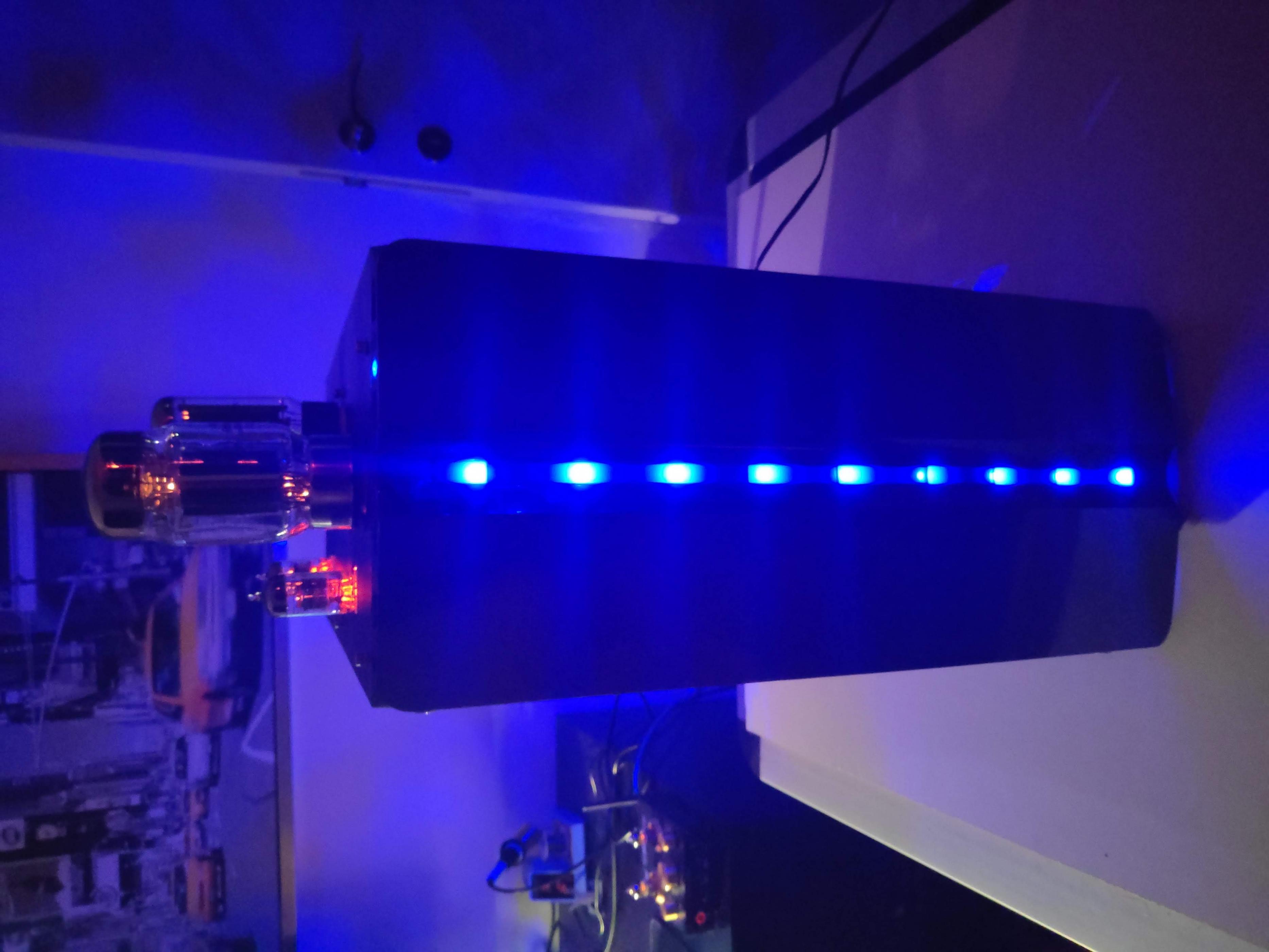

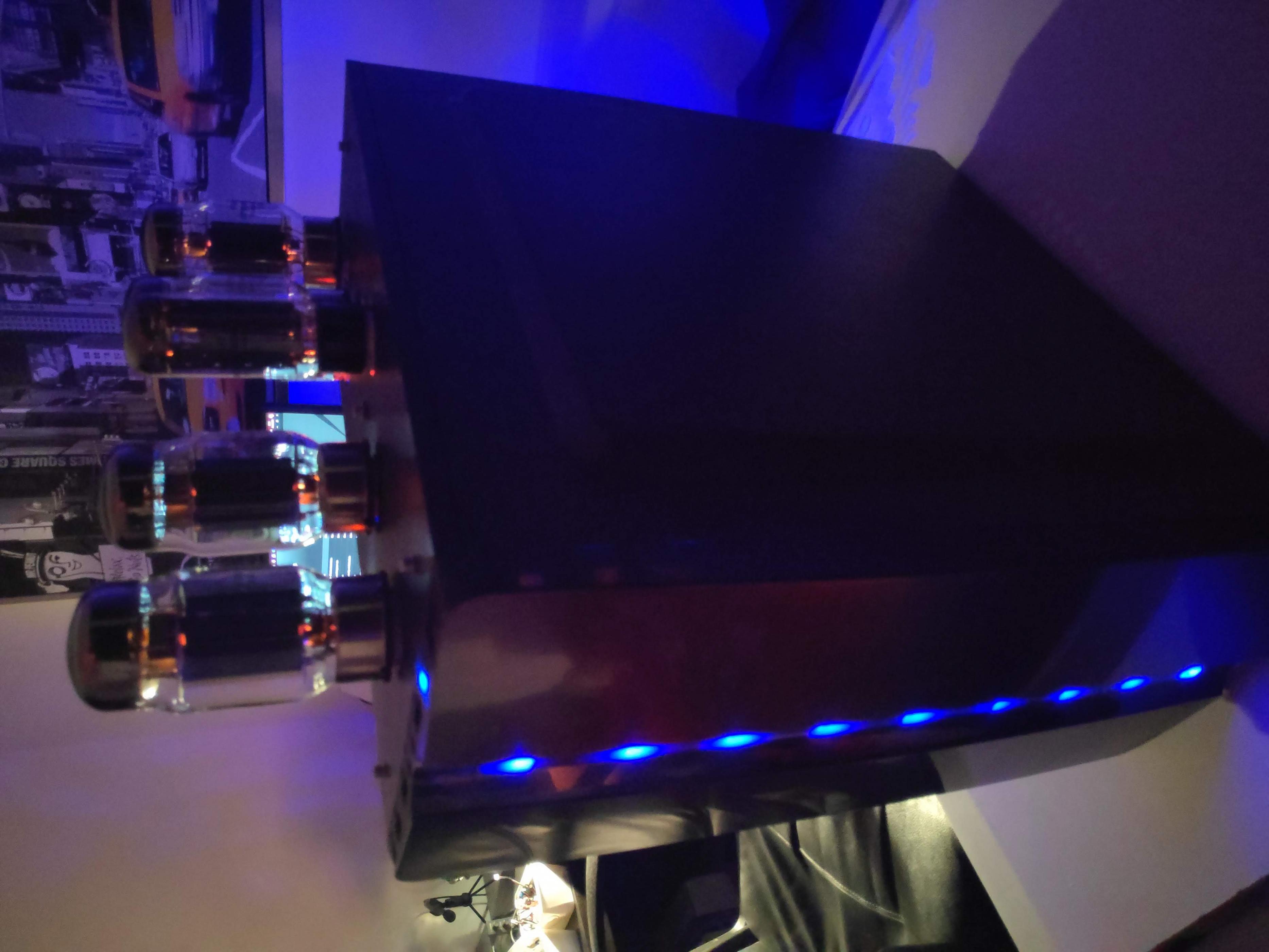

For fun shared the final result.
Thx again for all the help,
Ives
