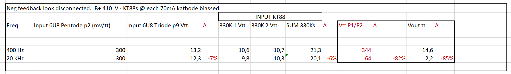

PeterTub, Prairieboy, KevinKr and all of you thank you for the feedback, I'm back from holiday and I have redone the measurements without the negative feedback connected and it is bad. I am using the output transformers that Prairieboy linked. Without neg feedback I have 82% less output on 20 KHz than on 400 Hz . I triple checked every measurement. (See attachment) All is reasonable up to the KT88's grids but at the output of the opt's or even the PLATE-PATE voltage drops dramatically. (something I did not expect) B+ stays stable.
I cannot say I fully understand why the plate to plate voltage drops. I would think higher frequency is higher transformer resistance and less load on the tubes. But maybe the tubes internal resistance increases or the secondary wingdings give more load ..or ..or ? For the moment I'm thinking of ordering another transformer (Hammond) and I'm reading about load-lines to determine if I need the 4Ks/5Ks(as now) /6.3Ks. I'm looking at this load-line calculator Loadline calculator for power stages with reactive load - Vacuum Tube Amplifiers - DIY but I'm not sure were the operating point should be, I see the power increasing but there must be more than that like THD and impact on frequency response ? ...
Still any input on the original problem above, the drop in plate to plate voltage is greatly appreciated. I'm a bit lost ...

IvesH, can you clarify your post #29 results please. Are all those voltage measurements a pk-pk level (as you refer to them as 'tt')? Are they measured by your scope? How have you set up your probes and scope to measure KT88 plate-to-plate voltage? Is your speaker secondary grounded (as the schematic in post #1 doesn't show that)? Are the KT88's connected in triode or pentode or UL mode?
Are your measurements taken when operation is sufficiently within class A (ie. sufficiently below clipping with only minor rise in distortion)?
Maybe if you include your setup conditions in with your results in an attachment then that would be less ambiguous.

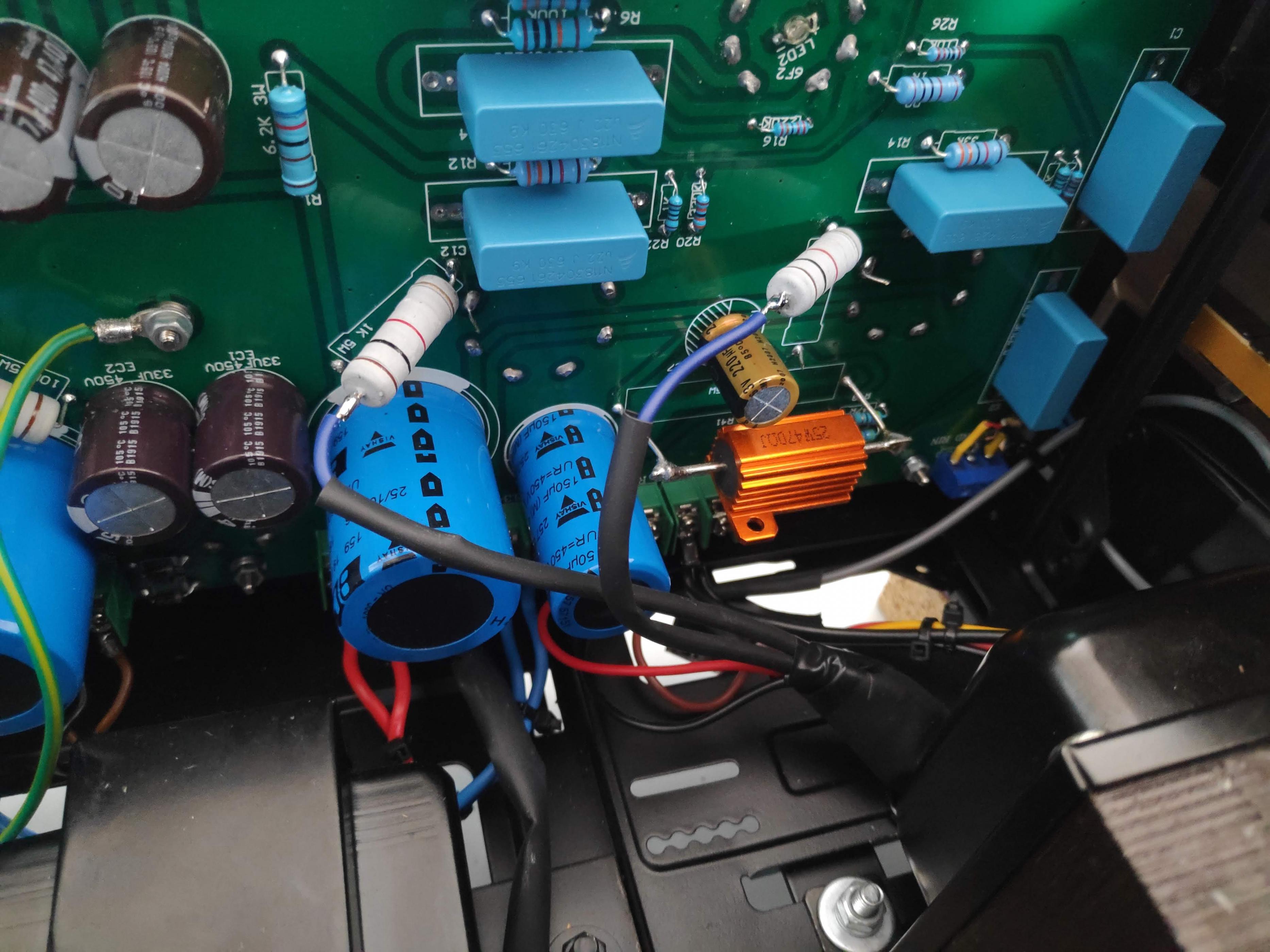

Hi Ives, just to clear up some minor confusion on your part, the connection you refer to as "triode" is in fact pentode connection. For triode mode the screens are connected to the plates of their respective output tube. (I typically use a 100 ohm resistor between pins 3 and 4 of each output tube.)
Did you cut the etch between pins 4 of the output tubes on the original board when you connected in UL mode? The pentode mode connection shows the screens both tied to that single 1K/5W resistor to B+.
Currently you have tried pentode mode, if pin 4 of both output tubes are connected together still then connecting the UL taps to the screens has shorted part of the output transformer. I'd not expect it to work in that scenario, so have you separated pin 4 on each output tube from the original PCB trace by cutting it?
You have not tried triode mode at all to the best of my ability to understand what you are doing. 😀

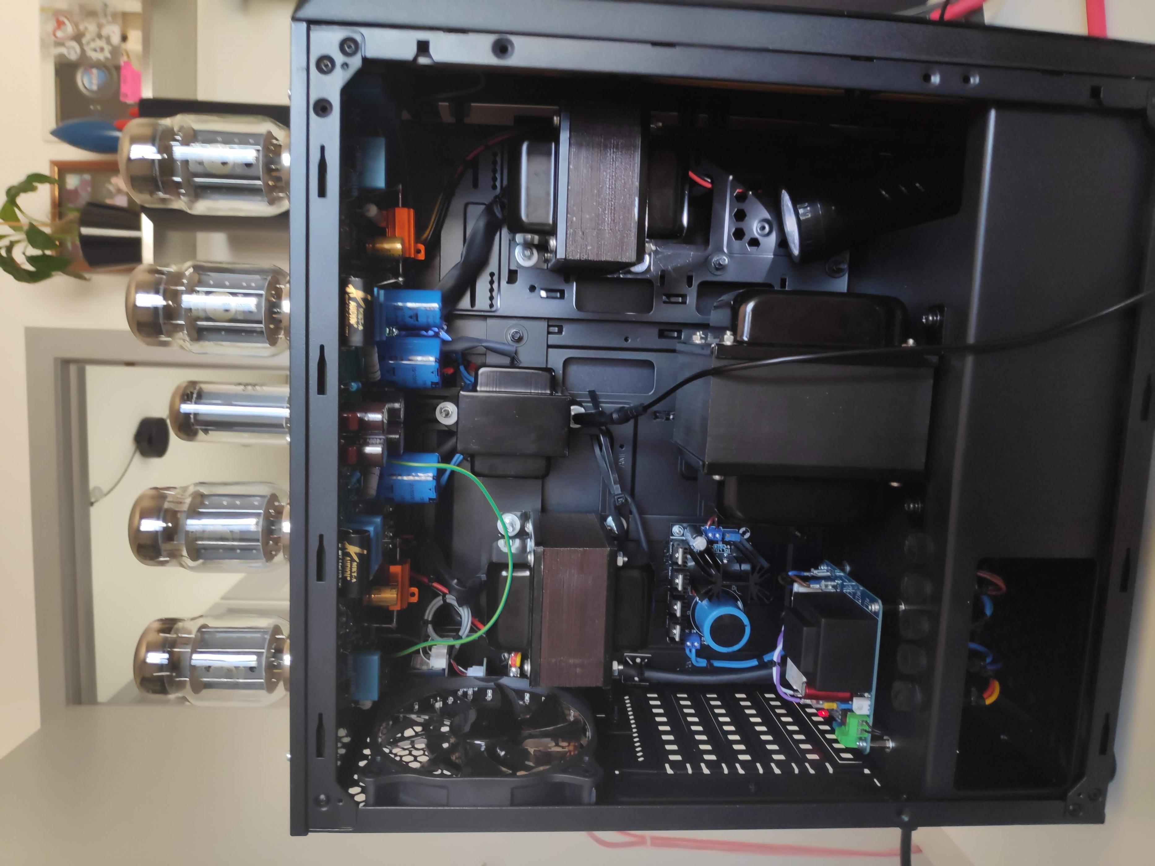

Can you post some pictures of how things are arranged.
Hi Trobbins, Yes I use tt (top/top) as pk-pk, I measured across the ot / plates with a normal probe set to 1/10th and with a RMS multimeter at 400 Hz , same result. Yes secondary is grounded. At present the screens /g2/ pin 4 are connected to the UL connection of the OT (via the 1K resistor that was connected to B+) I just disconnected the hot B+ side from the 1K and connected that to the UL connections. Also tried a direct connect from the UL connection to the screen/g2 pin 4. This gave the same frequency response.
Hi Kevinkr, you are correct I have not tried triode mode, will do that tonight. Pin 4 of the output tubes are not connected together, each of them has/had a separate 1K to B+ (picture attached) , now connected to the UL OT connections.
ps1, attached pictures, this is for testing , will clean up the board, appropriate resistors and connections later.
ps2, Pin 1 and 8 are not connected together seems conflicting with the earlier comment from petertub since the board states EL34/KT88, anyhow focussing on the KT88 for now.
