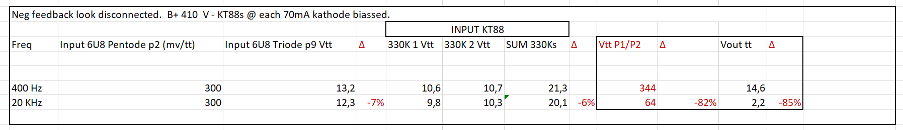

Guys, I have redone and attached the final measurements, also in triode mode before I go output transformer hunting.
Do these values seem normal to you, now not specifically the Freq response (@ 20 Khz) but the produced output power.
It seems the original pentode configuration is the best trade-off between output power and linearity and at low output the (transformer ?) linearity (as expected) is better
Final thoughts ? Again thanks for the feedback, I learned a lot

IvesH, your results from post #41 indicate to me that your 'high volume' measurement is likely causing class AB operation to start softly cutting off one side of the output stage, and that is effectively increasing the shunt capacitance being experienced by the signal passing through the other side, and hence degrading the HF roll-off.
One hassle with making any interpretation is that you have included feedback with that latest result, which imho clouds any outcomes you may want from that measurement comparison.

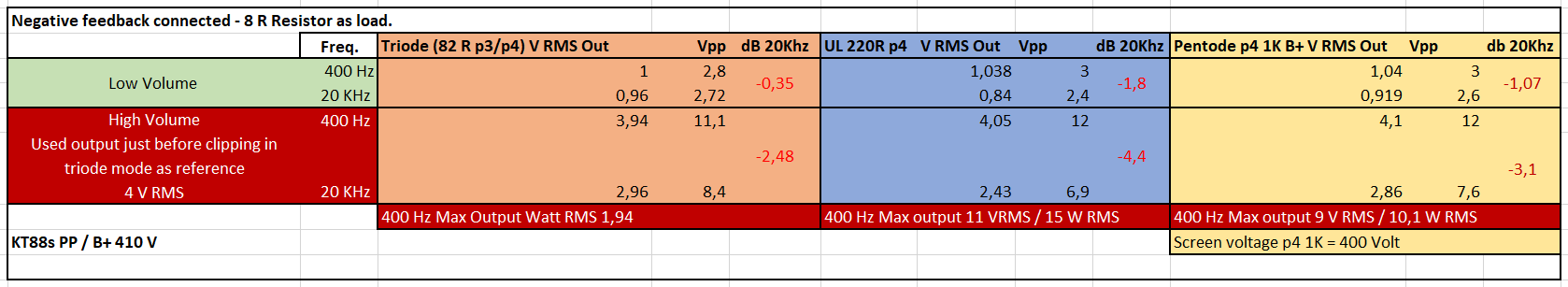

It looks like there is an error with the red filled cell for triode mode, as it shows 1.94 ??
Also your other red filled cells show different W levels than the result cells. You seem to identify 10-15W max output levels, and seem to confusingly use the same signal input level for all tests?
I have a couple of other thoughts, and that is about the output stage operating point and supply voltage.
I'm assuming you have about 60V across the cathode bias network so your effective plate voltage is about 350V, I'd expect about 500 - 550Vpp to be a reasonable upper limit under such circumstances, it would seem you need more plate voltage. (Removing the rectifier tube which does nothing useful except look pretty and delay the B+ might net you another 30V - 40V which would help..
I assume combined quiescent current is around 120mA - 130mA and the tubes are well matched.
The other thing is how much swing does your driver provide before it runs out of steam?
Finally are you sure that is actually an 8 ohm tap? Try loading with 4 ohms and seem what happens, if you achieve > 10Vrms it's likely a 4 ohm tap.

Hi trobbins, I measured under more or less the same conditions, the low volume is 1 V RMS and the "high" volume on 4v RMS (the max I could get out of triode mode, and used that as reference for the pentode and UL comparison) , the maximum power one is what I could squeeze out in that mode at 400 Hz, I will confirm power output in triode mode,
The main concern I have is that you have global negative feedback connected whilst trying to take measurements to characterise the HF response of the output stage.

Kevin,kr, Trobbings, all helpful hands at max output in UL 11V RMS /15W RMS (32 a 34 Vpp 400 Hz) I have pretty much the same voltages on the driver, the triode output (pin 1 and 8) / KT88s input. 330K/1K
Confirmed 8 Ohm connection is 8 Ohm, on 4 Ohm same power result 15W RMS (Less voltage / more current)

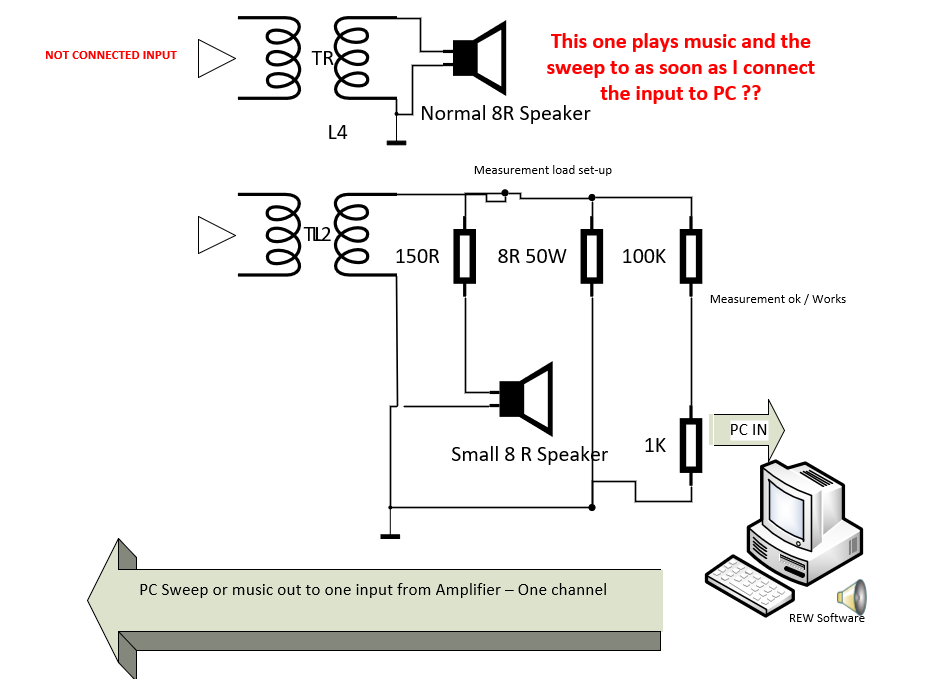

Kevin I was just going to measure the frequency response,my above feedback was based on power output at 4 Ohm. Stumbled a ghost / crosstalk phenomenon. (I always tested with one channel connected only now all tubes are in and 2nd speaker connected)
I'm sending in signal (music / sweep) in one channel, OK no problems here
My output load "device" has 8 R/50W resistor , in parallel with 150R with a small speaker and a 30K /1K voltage divider
The divided voltage over the 1K I feeds back to my PC input for the frequency response measurement with REW
As soon as I connect the feedback input the dormant channel with no input starts to become active / provide sound at reasonable volume (music or measurement sweep)
Disconnect the input into PC loop again and it stops ... , actually starts stops as soon as I connect the GND.
But that channel has no input connected ...
Ghost in the machine ...

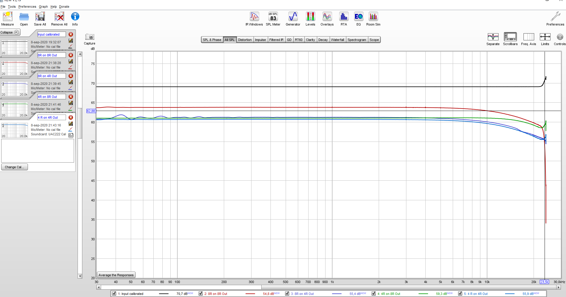

KevinKr, all,
I attached the freq response in combination 4/8 R load over 4/8 R outputs.
I switched my mindset back from focussed measuring crazy mode to relaxed listening, now running in UL mode and it actually does not sound that bad at all. Although we know at full power output / freq it is poor, still going to replace the transformers so I'll give an update here in a few weeks.
In hindsight, I did not pay attention at the time they were cheap (good specs ... but cheap ...) , I mostly build loudspeakers or SS amplifiers ... but I'm sold on tubes. Next one will be with proper neg biassing and all the trims ...
Thx for all the input ! , I'll be back 🙂

IvesH, it seems like you have some faultfinding to do wrt the ghost! Eg, pull out V2 on the ghost channel; disconnect the feedback.
Was the calibration test in post #58 a loop-back test of your measurement system with the PC sweep signal connected to the output 100k/1k attenuator to form the test loop?

To be honest those sweeps look ok, not brilliant, but ok. I've had similar results before I tweaked a valve amp. Also I'd just use a scope and a sig gen for a quick manual sweep around the frequency concerned. I'd also sweep each individual stage to verify it is the OPT.
If it is the OPT the circuit can be tweaked to give you a bit of HF boost that or tweaked so HF doesn't get rolled off so quick before the driver/ OP stage.
