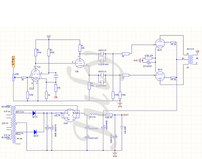

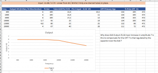

I'm building a KT88/ EL34 CLASS A push-pull tube amplifier with a board I bought online. I attached the schematics below.
Power enough but the frequency response is poor and drops significantly as from 10 KHz.
The output transformers are supposed to be 5K 60W Push-Pull Ultra Linear, Theoretical Frequency response: 20Hz-25 Khz + -1DB, for KT88 KT100 EL34 6L6 5881.
With KT-88 or EL34 tubes it stays the same (with adjusted BIAS).
I disconnected the negative feedback loop to check if that was causing it but sadly no improvement. For the rest it is a very simple design, so I fear it is caused by the expensive output transformers. Hope you guys (and girls) can suggest or hints to investigate further …
Some specs:
6U8 pentode used as voltage amplifier and triode as differential splitter
360 AC input for B+
B+ 410 Volt (Unloaded 512 Volt)
54UGB Full-Wave Vacuum Rectifier
Separate DC driven 6U8 filaments at 6.26 V DC
KT-88 Tubes biased at 70 mA
From the start replaced all caps with brand new ones.
All resistors measured and good 1 %
Very stable B+
Same result with EL34 tubes.
Any suggestions welcome !
Measurements.png - Google Drive

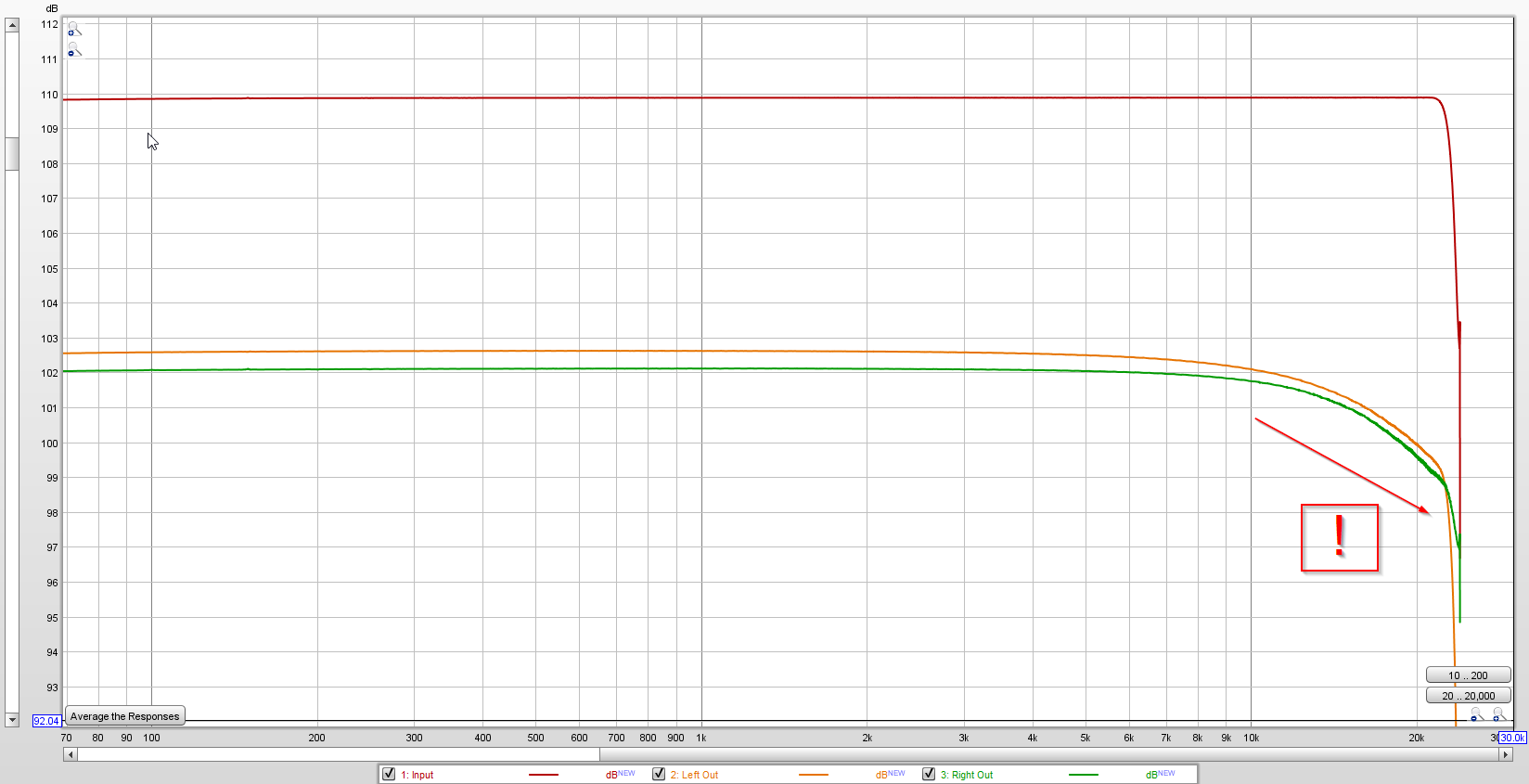

Are you use soundcard and program (ARTA?) for measuring freq. curve?
Seems the soundcard working at 44.1kHz, so the HF limit of measuring at 22kHz (Red input curve).
The first image HF behaviour not -so- poor, -3dB (green: 102-99dB) at about 22kHz.
Commerce transformer.
If the measured voltages are correct (good high frequency RMS AC voltmeter -not handheld- ), at 20kHz you measured about -3.5dB, which is different from 1. image freq. curve (-2.5dB).
BTW the schematic shows trioded tubes at PP, but you wrote that transformer bandwidth is 20Hz-25 Khz + -1DB as ultra linear.

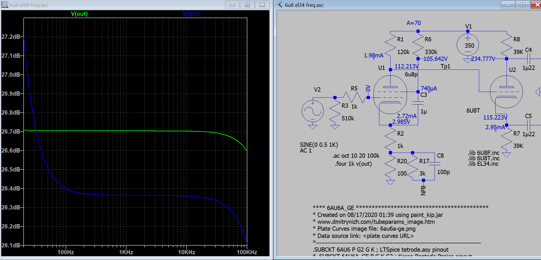

The question in picture 3 "why does 6U8 increase.." that is feedbackAttached the images now instead of links.
Thx for all the feedback, seems they are all pointing into the same direction. I'll recheck the connections again. At one time the 2 plate connections where reversed , and the negative feedback became positive and the amp oscillated. Problem is I looked at these already a while and it seems correct based on colouring and info I got from the transformers ... I'll be back 🙂
trying to compensate what the transformer limits.

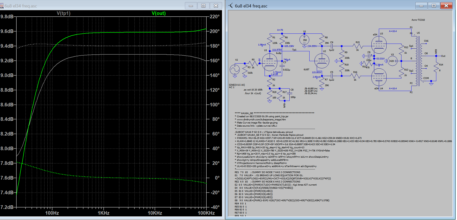

Super "feedback "guys, yours not the amp 🙄 , petertub and euro21 , I attached the difference without the neg feedback and you do see that the amp is trying to compensate. The values are measured with my scope. True it is not so bad (plays reasonable) but normally I'm used to see the output start dropping past the 20 Khz mark. My usual build are CLASS A transistors. yes I am using REW(calibrated) correct the red is input dropping at 22 KhZ due to the behringer UCA22 I use as input /output.
Looks like classic pentode connection to me.

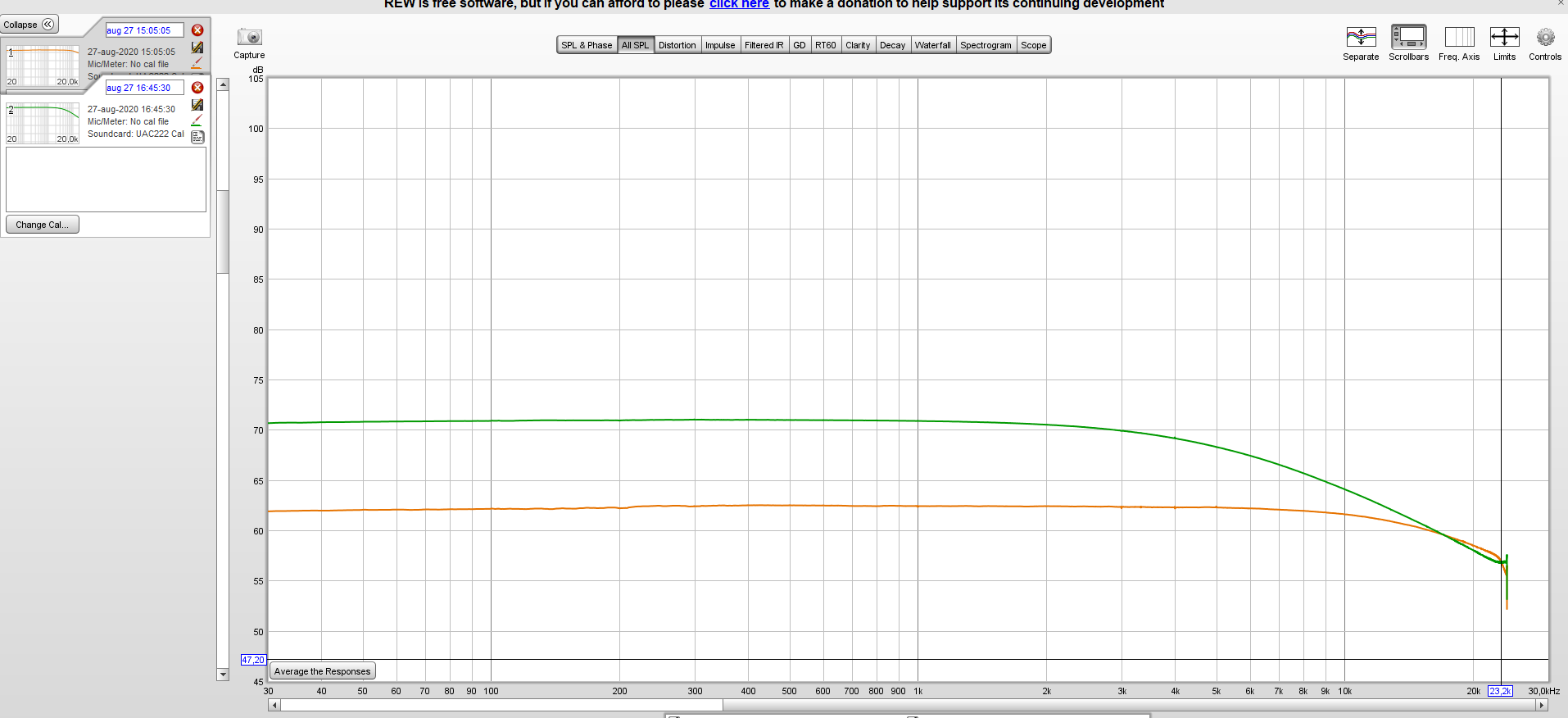

Shall I as a test connect one of the OT to one of my linear amplifiers, do a sweep and see what comes out ? secondary on the amplifier and measure primary or vise versa (can do both) at low voltages.
Good or bad idea ? or irrelevant results ?
If you have -low output impedance- SS amplifier (for example 50W), connect to +Out 8R 50W resistor.
Connect resistor other end to OPT secondary "8R", connect SS amp -Out to secondary "gnd"
Load both primary part with 5k (10-25W) resistor.
Carefully increase signal generator volume on SS amp input.
Beware, on the primary sides may occur hundred Volt peeks!
Measure it with high voltage RMS AC voltmeter.
I use Kenwood 2 channel AC voltmeter, which have 1V output for soundcard measuring.

Everybody thank you for the suggestions but to be clear I have a problem in the high frequency part (drop as from 10 K) but as kevinKR said it is not extremely bad, still I would like to get past 20 Khz at -0 db, it can be my imagination running wild but it sounds not as "fresh, sparkling"as it should. At present I'm on a week holiday with the misses but will start tinkering again next week (missing it already 🙂) The output transformers details are posted above. Thx and enjoy the rest of your day , stay safe.
