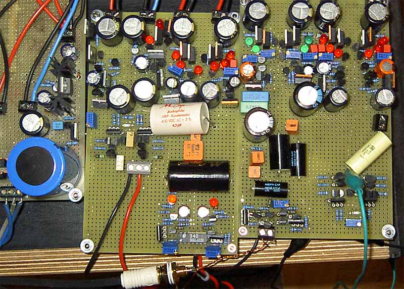

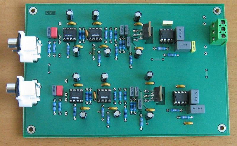

it is only an inter-step (functional sample, the resulting PCB will be smaller and include switches for input impedance, MC/MM etc.).
Yes, it might be possible to share the circuit, after all the tests.

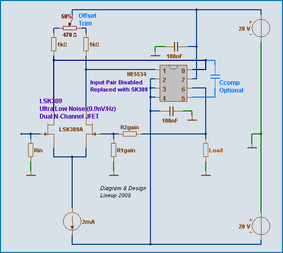

There are some nice low-noise ideas in an old National Application Note:
National AN-222 ( 1979 )
It is ways to use low noise monolithic dual transistors for lowest noise.
Today we have even better such duals. Both JFET and BJT.
I do not know if attached idea captured from AN-222 as a standalone would be for MC.
But for MM cartridge I think it will perform very well.
I am sure people with MM based pickups will read this topic with interest, too.
So I post a couple of posts.
Lineup 🙂

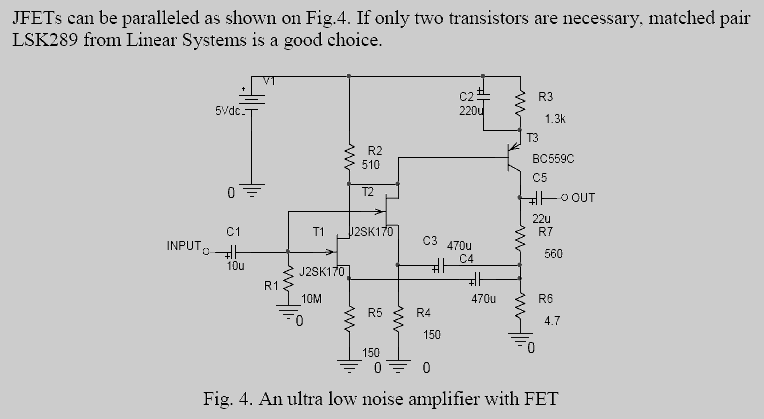

Here is another 'old idea'.
It is a capture of a most low noise and interesting circuit.
All discrete with matched monolithic JFET parallelled as input.
Capture from this Paper by Janasek:
Hompage: www.janascard.cz
Design of ultra low noise amplifiers - Vojtěch Janásek
Lineup 🙂
Lineup 🙂
