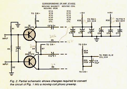

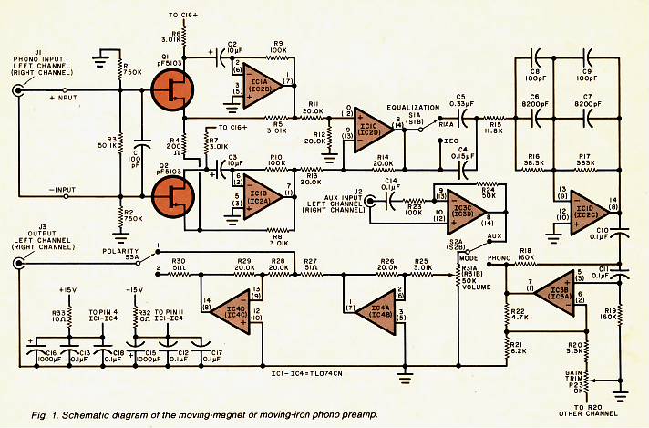

Here's the schematics of the Roberts MM preamp, I think.
The nice feature is the balanced input.

Nope
Those are the schematics for his P-10 preamp. The P-100 is a completely different design, and several years newer.
This design is 100% active EQ. The EQ network is in the feedback loop of IC-1D.
Don't get me wrong...the P-10 is still an EXCELLENT preamp!
The P-100 blows it away though!
We used to use the P-10 in broadcast. Note that the polarity switch actually switches between two sides of a differential output. We used to use this as a balanced output which allowed us to run the preamp output through patch bays, etc.
We'd simply put a TRS phone jack in place of the RCA output jacks and connect it to 1 and 2 on the switch.
Later, we used these preamps as 'balancers' for consumer CD players by using the aux inputs on the unit.
John actually began offering this as a no cost option on the preamp.

I would assume that a balanced input would be more noisey than a single ended input for phono amplification.
It depends...
The FETs that John used were quite quiet...and the Bipolars he used for the MC preamp even more so. Generally, I find that while balanced inputs might have a bit more hiss, they also have quite a bit less hum then single ended designs. To my ears at least, hum sticks out more then broadband noise does, simply because there's one frequency to 'hone in' on.
IIRC (and it's been 15 years) the P-10 was really quiet...actually a bit quieter then the P-100 (because the FET in the P-100 was running class A without feedback). The 75 us pole (high end roll off) was a selected cap just after this FET-which reduced some of its hiss by literally rolling it off. Then there was an active EQ stage that applied the necessary bass boost below 1 kHz.
The P-100 also did have a DC servo and line driver output. IIRC, John used a 5532 for the EQ and output stage. I used to replace the 5532 with an AD-712 because I thought it sounded a bit better. I'd LOVE to hear the P-100 with one of the new National duals in place of the 5532.
Sorry for the rambling post, but I'm typing what I remember as I clear the cobwebs in my mind...
