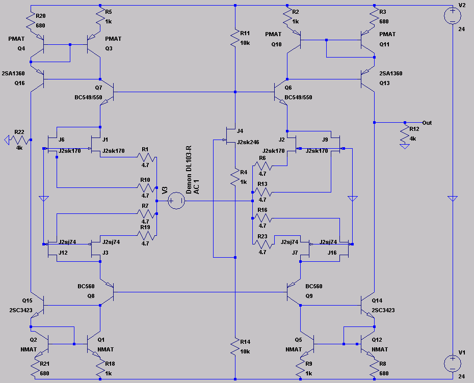

Is headroom really an important issue if the supply voltage is at least +-15 volts and if a totally passive correction is chosen. I have never measured how much a click in the LP will generate. All my RIAA amps so far have been the active variant.Bonsai said:Talking about the topology, I do have a predilection for the active a approach due to headroom requirements on the passive approach and possibly higher overall noise.
On a MM I guess 3mV output at 1Khz. Assume at 20Khz 20dB above this (yes, I agree there is not much musical energy at 20Khz but as you point out there's clicks and pops which probably do have quite a bit of high audio frequency content). That takes us to c. 300mV. Then add some overload margin - take your pick here - at 1Khz a lot of people look for around 26dB - lets call it 6dB at 20kHz - now we are at 600mV. If you need an out put of 300mV midband, that means a typical gain of 100 . . . . so now we are at 30V output at 20Khz
Of course I've over simplified a bit to illustrate the point. If you use a passive approach, the first stage gain will have to be limited to overcome this problem, and you will generally need a second stage of gain. However, this will mean you have to accept more noise, since ideally you want to put as much gain up front for lowest noise.
So, maybe this is why passive topology is a better fit for tubes where you can get the headroom.

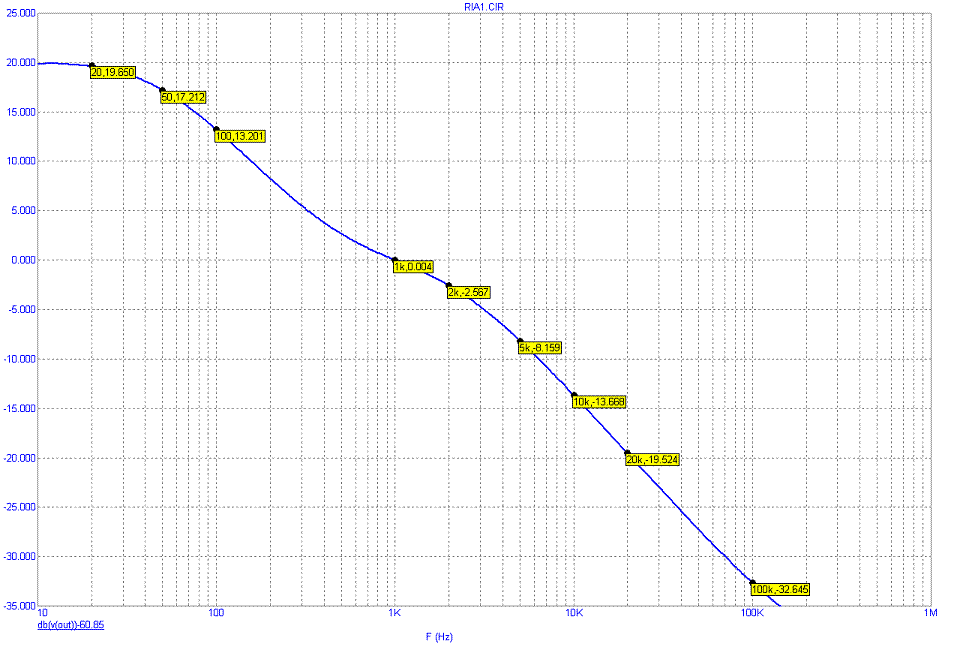

You have different headrooms for different topologies. This can be studied in LTSpice very easily.
What Mr. Rollins means is different gains when he writes "gain loss".

Rudiger, nice design - .001 simmed distortion. Put a bit of GNF around that thing and you'd easily get to 100ppb!
I see a lot of designs with JFET's but my concern is over matching and availability (P-chan seems to be the main issue).
