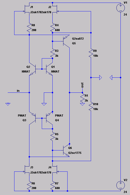

currently, I'm trying variations of the shown input stage:
the nmat and pmat transistors are actually a that340-transistor array, R1 is currently 10k. This is followed by an passive riaa network. I'm experimenting with mosfets in place of Q2/Q6 and with a DC servo.
The second stage is a blowtorchstyle gain stage but not balanced. The sound ist very detailed and punchy. It is not balanced, but really worth exploring.
