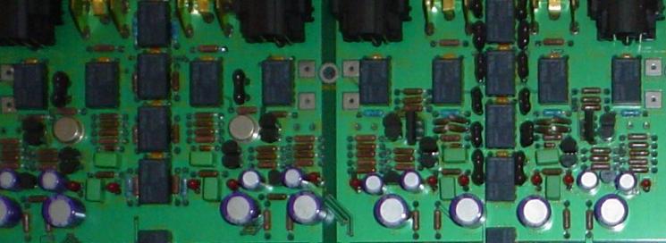

PMA said:
to cover and switch
Is that a problemo ?
Moving coil stage on the left side of the picture. (RIAA is not on it)
The various combinations are PIC stored and push button selected, same-same for the MM stage on the right.
