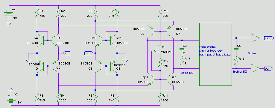

This was the conceptual schematic

Hi Tino,
thanks for the schematic.
What I have build and currently using it a variation of this threads post #27
It's along these lines of thinking. The input offset is under 1mV now, but may well be higher when using unmatched components.
The sound of the corresponding pre is detailed and powerful, but still a work in progress.
Rüdiger

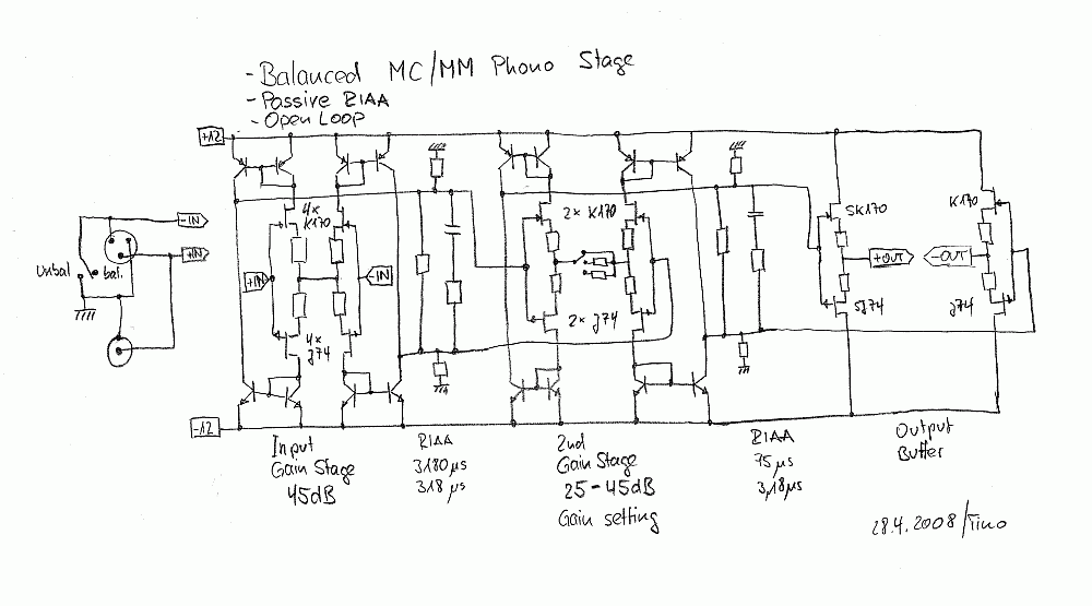

I went away from that idea, and am thinking about something along this conceptual schematic.
Which would also be my contribution for the thread topic.

Tino -
The circuit you have posted is broadly similar to what we have been using at Ayre for many years. Of course, the devil is in the details, and I will leave it to you to work those out. However, here are a few points:
a) There is no need for paralleled parts in the second stage. The gain of the first stage ensures that.
b) You are better off to have the adjustable gain in the first stage. Otherwise you are open to overload problems in the first stage with high output cartridges.
c) Your design is DC coupled. There is no way to have this work with an overall gain in the 60 dB to 80 dB range -- and that's at 1 kHz. At DC, the overall gain will be in the 80 dB to 100 dB range!! You need to either AC couple or use a servo, pick your poison.
And of course, the J74 is now officially discontinued. Luckily, we placed a large order for our lifetime buy purchase. I estimate a 50 year supply....
