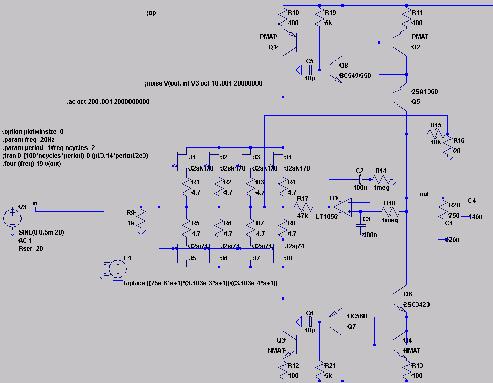

Here is a more conservative input stage with riaa that won't destroy any cart. The servo opamp is indicative and chosen here because of ease of implementation in LTSpice, I would chose AD820, OPA134 or OPA627.
All runs from +/- 12V rails.
THD is non-exsistent, output noise in the chosen band is 1.8µV/rtHz (where full output swing @1k is 20mV) so a bit highish for this foruims standards, but probably buried under surface noise during playback.
1k gain is 26dB, so another 30 - 40dB gain stage must follow.
The FETs I have are between 7-8mA IDSS, so they bias around 6mA each here. The quality of Q5/Q6 seem crucial, differnt types give quite different performance.
I will eventually build and compare it with my cart destroyer circuits.

Thanks, Onvinyl.
Something like that, I will try to setup in my spice.
We can go several ways here, if we omit Input cap, which the knowing think we shoud.
1. Provide AC and DC global feedback combined
2. Provide AC and DC global feedback. Separate, like your Opamp based servo
3. Provide DC feedback only. No global AC FB, like Charles Hansen in Ayre expensive RIAA amp.
4. No FB. Try to make a linear amplifier. Use output capacitor of high quality, like Pass Labs Pearl Phono.
What we use is much a matter of taste. There are many roads, but they will go to Rome in Italy!
I would use a method that I like and feel good about:
Provide lower level AC feedback + use a good Audio Capacitor, polypropylen, at output of stage.
How much gain should be in first stage for MC RIAA?
We know that some pickups deliver only like 0.5-1.0 mV peak in audioband and maybe lower than this.
??? What input level do we need to feed the other stages?
+26dB as in your circuit means gain x20.

Hi lineup,
I would avoid caps at least between stages, but prefer to no caps at all.
Regarding AC feedback: I would avoid it if I could. I have a open loop 2x4 FET input stage followed by a folded cascode, but for optimum performance I'd need over 50mA current in the fc device. That's a bit unsane. Gain isn't sufficient, too.
The Rabeyrolles-style input stage I'm currently using has no AC FB-loop the way I use it and sounds great, but has that potential input offest issue.
Rüdiger
