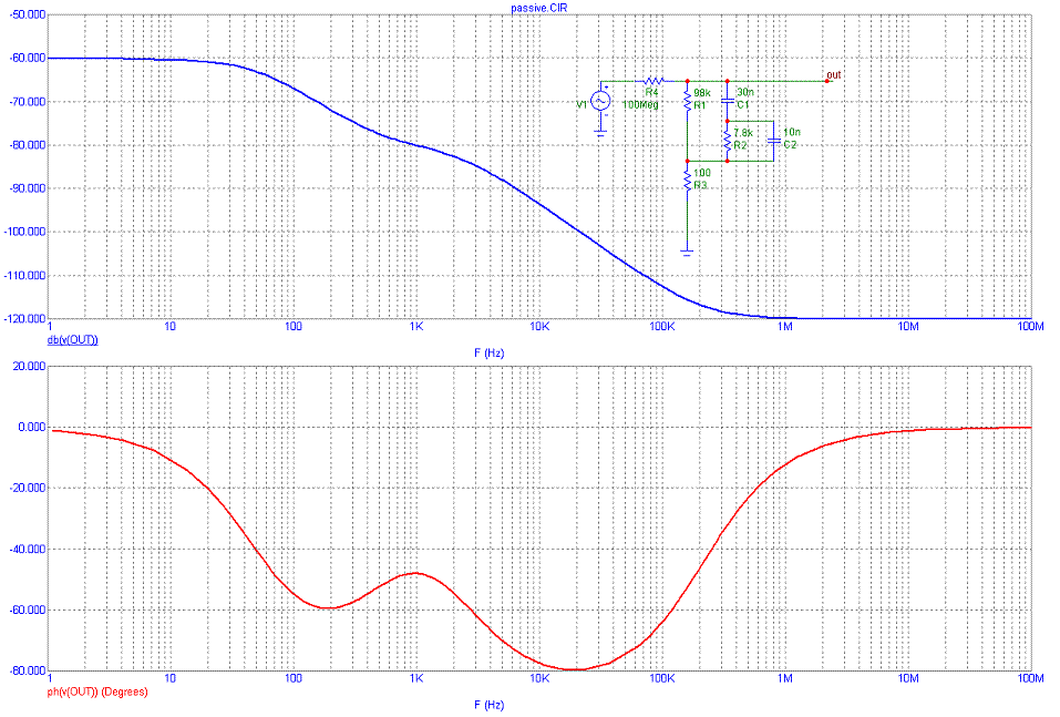

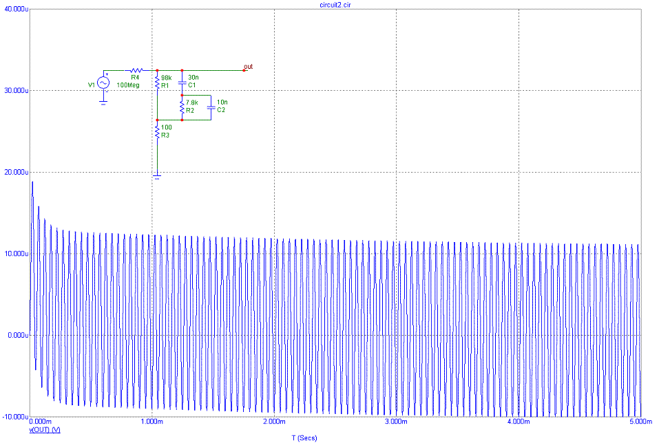

Wow! Transient behaviour of RIAA equalization is really pretty interesting. Look at the passive circuit response. We sometimes blame it on servos or AC coupling, no no
. It is ONLY a question of RIAA transfer characteristics, no matter how it is realized, just MATH.

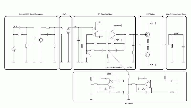

Attached is a RIAA I put together to try out some ideas.
The first OPamp is AD745. The 2nd OPamp can be one's preferred OPamp. The AD745 is powered by +-5V and the 2nd by max allowed rails.
If one likes, one can force th OPamps into class A.
Servo OPamps can be for ex OPA134.

You ment something else I'll believe?Sigurd Ruschkow said:The AD745 is powered by +-5V

No,
my idea to use such low rails is that Ib goes down.
Sigurd

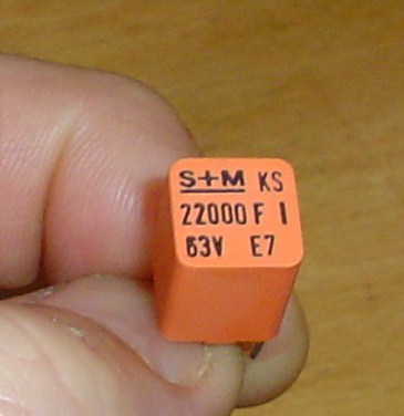

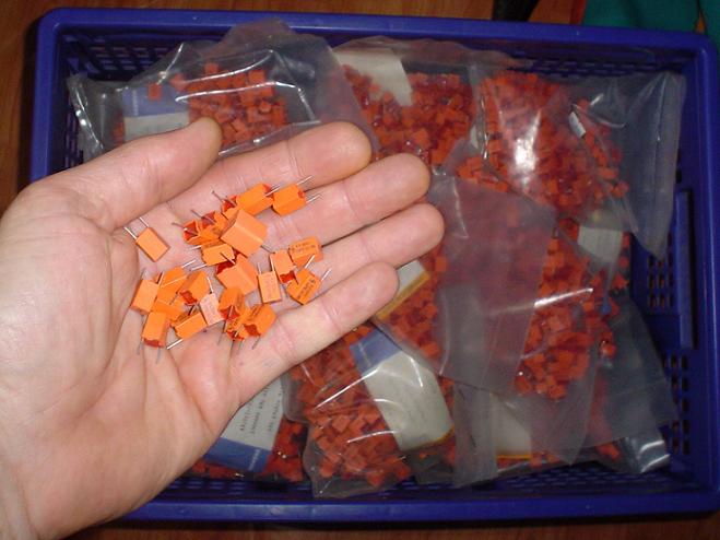

jacco vermeulen said:Que, for a FET input opamp ?
That's the general problemo overhere, everything is Orange, even polystyrenes for phono EQ.

The first opamp should have as high supply voltage as possible if you want to have a passive correction. Ib is rather uninteresting, surely?Sigurd Ruschkow said:No,
