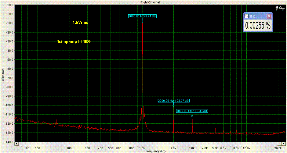

PMA said:New result, 1st opamp is LT1028. 4.6Vrms output, generator still without LP filter.

Listening tests will take place in some 2 weeks. I am waiting for housing, as I do not want to run listening tests with unshielded PCB. Though it has groundplane, it is not sufficient shielding.
PMA -
interesting test.
Looking in the datasheets, I see:
LT1028: en = 0.85 nV / sqrt(Hz) @ 1kHz
OPA627:en = 5.2 nV / sqrt(Hz) @ 1kHz
and wonder what is the noise floor of your measurement setup?

PMA said:Difference in noise for OPA627 nad LT1028, used as 1st opamp in the MC preamp. 0dB = 1Vrms.
Sigurd, you may have a point. How low noise has the soundcard itself? Should the noise be 15-16 dB lower?
I figure, either the soundcard is the limit,
or the resistors are setting the limit for the circuit,
or are we getting noise from the PSU?

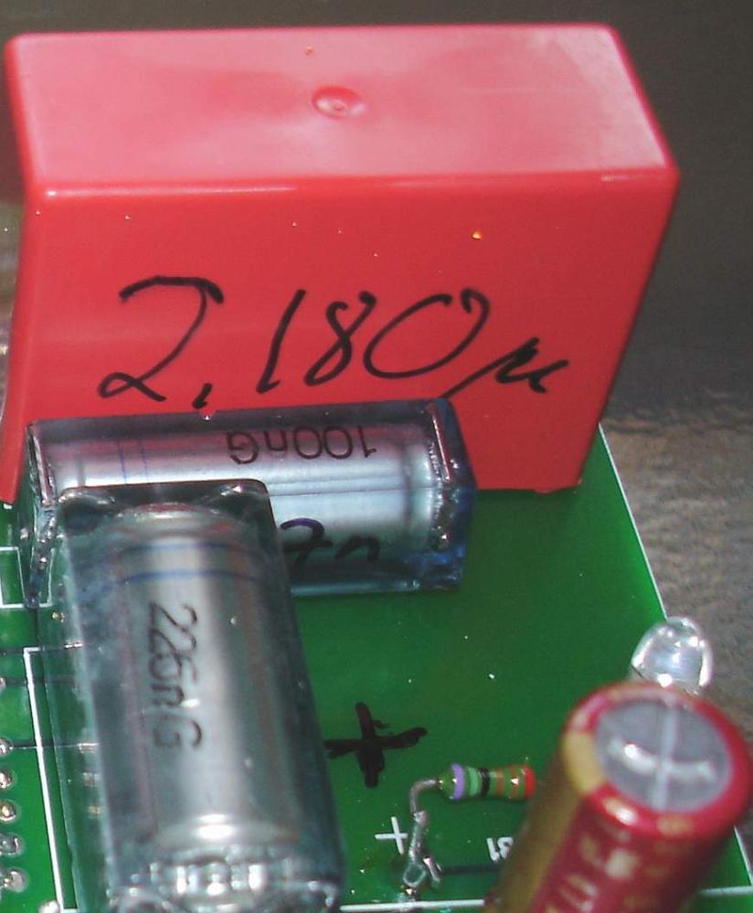

peranders said:Sigurd, you may have a point. How low noise has the soundcard itself? Should the noise be 15-16 dB lower?
REL capacitors Film and Foil PS caps are available up to 3uF; the RTX series which is film and tin foil. Their RT serie goes up to 470n.
All from Percy Audio.
Attached is a photo of a 226nF and a 100nF RIFA PS cap.
You will aslo see a 2u2 WIMA cap.
SIgurd
SIgurd

Not the soundcard, my noise floor for given setup is about -135dB.
You have not added any resistor noise to your LT1028 estimation, have you? You really know how much noise is for 100ohm, I guess .😀
With the resistors used, the measurement fits quite well, there is a 6dB difference which indicates to some 2.6nV/rt for LT1028 + resistor network.
