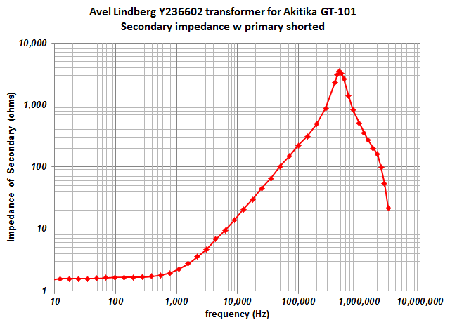

Morgan Jones wrote an article in Linear Audio v.5 called "Rectifier Snubbing - Background and Best Practices". In the article he advocated plotting impedance versus frequency, as a way to measure transformer leakage inductance, capacitance, magnetizing inductance, core losses, etc.
Jones used a HAMEG model 8118 LCR bridge ($2300) to measure some of his data, and measured the rest by hand using a sinewave generator, a resistor, and a dual channel oscilloscope. It's actually a fairly simple setup: you build a voltage divider: top arm is a fixed resistor of known value, bottom arm is Impedance_Under_Test. You apply a sinewave of known frequency across both. Use scope channel#1 to measure V_across_both, use channel#2 to measure V_across_Impedance_Under_Test. Record both in a spreadsheet. Then have the spreadsheet calculate the voltage divider mathematics that computes the impedance of the bottom leg, given the impedance of the top leg and the voltage ratio.
If your scope is digital, it'll measure these two voltages for you and display the values right on the face. ProTip: run the horizontal sweep slowly, slow enough that you get ten or more periods on the scope face, and set the scope measurement functions to display RMS voltage. This will give it enough data to average out noise, and to average out any errors cause by having a non-integer number of periods in the calculation.
I did all of the above, myself, on my kitchen table. I got plots whose shape resembled those in Morgan Jones's article. Some of my measured data is displayed below.
Jones's idea is to model the various segments of the plot, with resistors, capacitors, and inductors. For example the flat zone over on the far left, is modeled as a resistor whose value is 1.5 ohms. Beware: the secondary DC resistance (measured with an ohmmeter) of this transformer, was less than 0.5 ohms. The flat zone in impedance-versus-frequency, is a combination of DC resistance plus other low frequency losses (in the core). So the 1.5 ohm resistor in the equivalent circuit model, handles both.
You could make these same kinds of measurements yourself, if you really wanted to. All you need is a sinewave generator, a two channel oscilloscope, and patience. Your measured plots let you extract magnetizing inductance, leakage inductance, low frequency equivalent-resistive losses, etc. Homework problems on the attached measurements below: (HW1): Which segment of the plot should be used to extract secondary inductance {between frequency X and frequency Y, for which values of X and Y}?? (HW2): From the plot, what is the secondary leakage inductance in Henrys, approximately?

HW1: in your case, c60Hz
HW2: XL = 2PifL if we read XL to be circa 1.5R then circa 4mH but am uncertain as to whether this is secondary inductance (= secondary self-inductance) or secondary leakage inductance and which figure is demanded by LTspice*.

Regrettably, wrong and wrong.

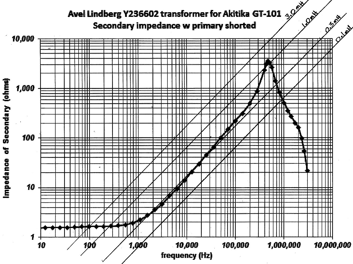

Find the zone in which the plotted data behaves like an ideal inductor would behave. Then calculate: what ideal inductor value would have impedance vs freq which matches the measured data in that zone.
Or, if you seek an approach which replaces thinking with doing, plot the impedance-vs-frequency curves of several different ideal inductors (0.1mH, 0.3mH, 1.0mH, 3.0mH) on the same graph as the transformer measurements. Which ideal inductor's impedance_vs_frequency curve, most closely approximates the measured data? Do this again at finer granularity, i.e., zoom in. After a couple of iterations you'll have a best-fit-within-10% ideal inductor value. And you never had to think; merely plot.
The way to deduce this is a measurement of secondary leakage inductance, is to read the plot title. It says the primary is shorted. This removes the secondary magnetizing inductance, leaving only the secondary leakage inductance to be measured.

At frequency f Hertz, an ideal inductor's impedance X_sub_L is given by
  • X_sub_L = 2 * pi * f * L
where L is the inductance in Henrys and pi=3.14159...
As frequency rises, so does the inductor's impedance. At infinite frequency, the inductor's impedance is infinity ("it's an open circuit at high frequencies"). At zero frequency, the inductor's impedance is zero ("it's a short circuit at DC").
In particular, for every 10X increase in frequency, the inductance increases 10X. When we plot inductor impedance vs frequency on log log axes, we see that impedance rises one decade, for every decade increase in frequency.
Take at a look at the attached plot. It performs the all-perspiration, no-inspiration activity suggested in (this post). Notice how the ideal inductors' impedances rise with rising frequency, at one decade per decade.

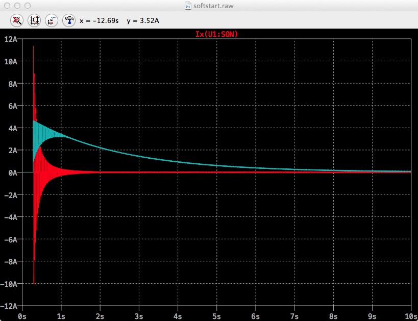

Today I'm rather baffled by phase and it's impact on the current waveforms for the soft start board models I did. BTW I have updated these to be able to model any NTC in-rush current limiter rather than just selecting from the EPCOS models which are rather restrictive in terms of specs. One just needs to enter the parameters for the NTC in question (nominal R, dissipation constant, thermal time constant etc).
Softstart.asc models the board as configured (i.e. 4 x 180R resistors, no hysteresis etc) for peak UK voltage. It's interesting to look at the current waveforms through the resistors and through the relay bypass while varying the starting phase. Below is a graphic of the latter over 10 seconds - red is with 0 degree starting phase and turquoise is with 90 degree starting phase.
I was expecting them to be of relatively similar 'form' albeit of different amplitude and 'duration'. They're extremely different in shape. They integrate to very different numbers: 372mA for 0 starting phase and 1.57A for 90 degree starting phase. Integrating their power cousins yields very different joules: 3.78J for 0 degrees and 6.3 for 90 degrees. Looking at the waveform through the 4 resistors also shows very different results: 420.7mA / 161.9J for zero degrees and 711.8mA / 201.6J for 90 degrees. While of course one wouldn't expect each scenario to total to exactly the same joules (more energy is burnt off in the resistor bank than in the other) I did not expect them to be so different.
Something screwy with the model or readily explained?

I'll bet that you didn't include the ON/OFF switch, which applies mains power to the transformer + softstart board.
I'll bet that, instead, you just applied a phase shifted sine wave "because it was easier."
I'll bet that your simulation shows DC flowing in the transformer primary at time=0, and I'll bet this DC current is equal to VmainsPeak / (Rsoftstart + Rprimary) , more or less.
It is not a good idea to squirt DC thru the primary of a transformer.
If you do have a switch in your simulation, I'll bet it isn't working properly. If you don't have one, then you just squandered one of your precious "please help me diyAudio" wishes, on a very clumsy blunder. Either put the switch in the simulation, or else figure out an appropriate set of LTSPICE ".IC" directives (IC = Initial Condition) which guarantee that all primary current pathways have zero microamps flowing thru them, before "switch on". Then figure out how to do this for varying phase angles.
🙂 No switch and, yes, a phase shifted sine wave, but not because I thought it was easier; rather merely because I was thinking at time=0 all could be immediately 'switched on/connected' to such voltage source (in real life just remove the chassis power switch and have no mains plug receptacle switch and there you are) with the starting phase of the voltage source being wherever it lies and so I thought it not a bad assumption. Indeed, current at the primary at T=0 is non-zero, but if Phi is defined by LTspice merely as starting phase of a sine voltage source I'm not sure why that naturally leads to this result (and from there why a switch would remove the issue). I will explore more.

I updated my models to include a power switch. I borrowed from BigE's work:
.model NO SW(Vt=4.8 Vh=3.6 Ron=.075)
and drove it with a pulsed voltage source, initial 0V stepping to 10V (10nS rise/fall) with no delay. Output for non-zero mains Phi now makes a lot more sense. (I'm still pondering the vagaries of why.) I hope it is now okay to examine phase by merely changing Phi in the mains voltage source.
