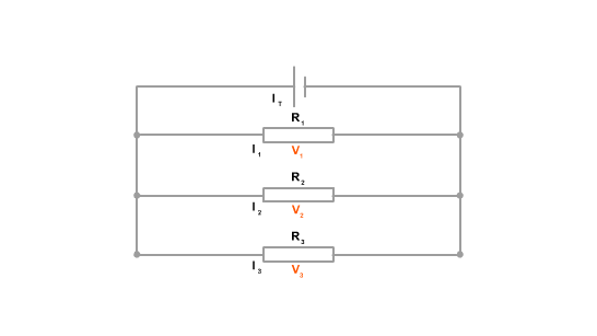

So I'd take it what you are saying is that I1, I2 and I3 on both figures I attached are the same then?
Keep in mind we are dealing with 50/60Hz. Inductance (due to helical turns) and other impedances are virtually irrelevant to the resistor elements.
Yes we can leave them be.

On the subject of an element's current rating (or dissipation rating for that matter), can I ask the following basic and general question: if, for example, an NTC is rated for 2.5A and is on for just half a second, can I integrate the 0.5s wave form and rely on the RMS figure even if that RMS figure were to be much higher should the NTC be on for one full second?

...........So I'd take it what you are saying is that I1, I2 and I3 on both figures I attached are the same then?...........
I said
The current through both sets are the same,
You are showing a very different current in the three paralleled resistors.
I1 left cannot be the same as I1 right.
The left is a part of a series combination of smaller value resistors.
The right is a part of a parallel combination of much larger value resistors.
I1left><I1right.
I said the current is the same.
I1left><I1right.
I only took that from the net, of course I1 on the left is not equal to I1 on the right. Duh, I guess I should have drawn my own image.
Anyway, what the two images show is that...
1. The current in series resistors are the same for all resistors.
2. The current in parallel resistors are shared by the resistors in parallel.
So to say that 4-series 10R 5W resistors is better than 4-parallel 160R 5W resistors is somewhat reversed? Right?

Would this be enough to explain the current flowing in the resistors? Isn't the current being shared in the parallel arrangement instead of having the same current flowing in each resistor in the series arrangement?

However, I'm still confused with the series resistor being better than the parallel resistors in terms of handling current because of current sharing. I do take note about the thicker wire on the lower resistance resistors.
