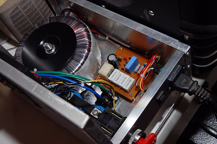

As noted above I think it wouldn't be hard to have a board that could accommodate parallel resistors or series NTCs (2).
However, to do that, the resistors also needs to be in a series arrangement.

I'd just like to point out that reconstructing the board to take parallel resistors or two series NTC (or just one) would not be hard.
You can do that now with the existing boards, parallel resistors or a single NTC.
Andrew has pointed out that a couple of NTCs in series may be preferred/needed in some situations
with NTC's? nah, i wouldn't do that at all....
That however is something you cannot "officially" do with the existing boards, however, as diyers, you can always connect and solder two leads of two NTCs and then solder the other two leads to the board. Some heatshrink wraps should do nicely.
Agreed. I also suspect there's no need in most situations for there to be two in series - just have the switch flick before the rating of the NTC is exceeded.
I'm still interested in why Andrew is pressing for series rather than parallel resistors...the desire to use NTCs rather than resistors doesn't demand the resistors be in series also.

Perhaps but many years ago, I built an F1 with crazy amounts of capacitance and used a single CL-60 in the primary. The slow blow fuse kept on blowing up upon power up so we end up using two CL-60 in series.
Me too. In the hopes of making a better, easy to build soft start.
I did make one with comparators, timers, etc but it has proven to be far more complicated and I assume it would be also for someone else to build. I think Andrew has commented before regarding control of the timing which will be better having it's own "real" timer. But KISS principle tend to be against it.
This soft start has so far worked with amps I use everyday, I also use an early prototype on my cnc psu because of the large toroid and amount of capacitance I used.
Yet the circuit has a readily controllable "timer" - set to taste using C2 and/or the current limiting LED resistor.
I note that Self says to NOT place resistors in series: "with a parallel connection, if one of the resistors fails open-circuit (which is by far the most likely mode), the inrush system will probably keep working satisfactorily."

At least in my project it's a very good idea to have them switched out. Furthermore, switching them out increases the chances they cool ahead of a 'hot start'.
Indeed. I use a large 1uf cap for C2 and just tailor fit. This is especially useful for me when using different brands of relays.
That is also a good point but I'm keeping an open mind on the idea of series resistors too. Especially in the are of reliability.
