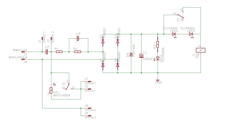

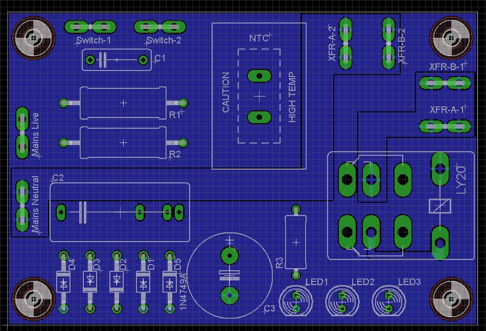

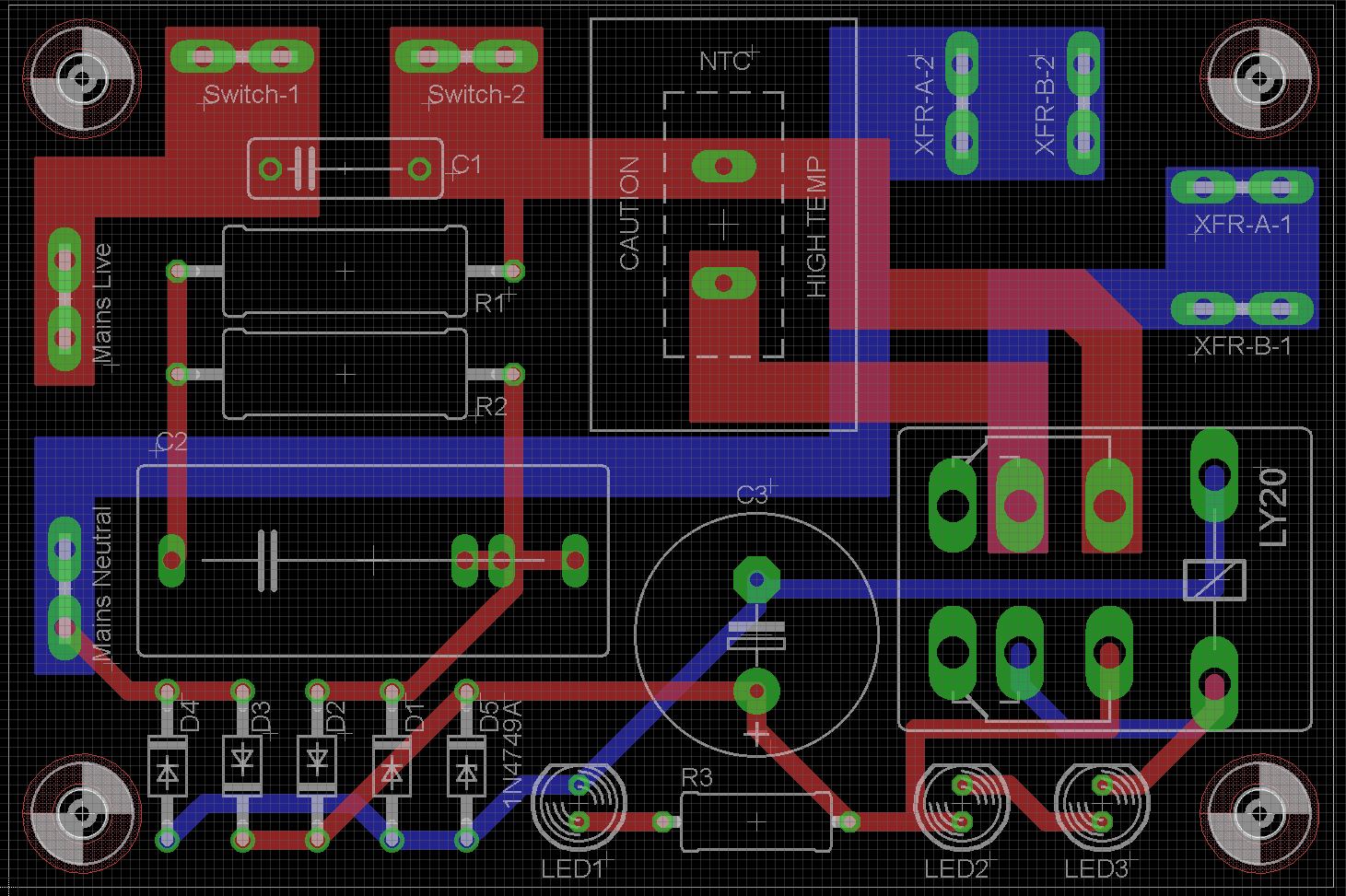

I had a play around with a board layout for the soft start design we've been kicking around - the one which makes use of a big fat NTC ICL. As my project has two transformers, I wanted two sets of output connectors. Annoyingly I couldn't get the connections for each transformer next to each other because of the criss-crossing required; instead the two 'live' are adjacent and the two 'neutral' adjacent. I'm still poking around with it but if anyone has suggestions I'd gladly hear them. The board is 6x9cm (mounting holes on 1cm grid).
Hi, I think it would be a very good idea to do some research on AC mains safety regulations. Two words to look up are "creepage" and "clearance". Here are a couple of links but I don't know whether these are the best or the worst on the internet.
(link 1) .... (link 2) .... (link 3) .... (link 4)
Your PCB layout appears to place live AC mains traces, rather near to other things. Maybe this isn't a good idea.

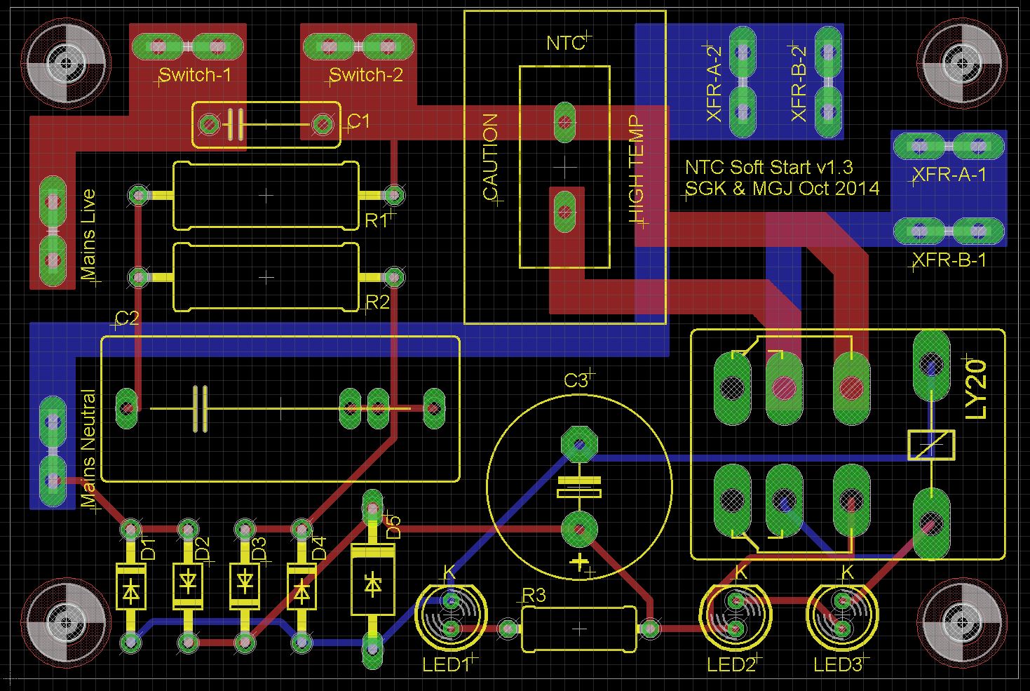

OK - thanks a lot So greater clearance for all mains voltage traces and components. The links you provided and a few others from Google point to same/similar calculators. If I plug in 350V peak I get 2.5mm for IPC-2221B external, 0.8mm for coated and 2.3mm for IPC 9592. I've not yet been able to find out what constitutes "coated"? Is a Hasl finished PCB "coated" in the sense these calculators mean? Clearances of near 100mil will be difficult to achieve when the pins of the DPDT switch are only a fraction over 75mil apart. Perhaps that's a reasonable benchmark to use.
Revised draft attached. (25mil grid albeit hard to see it clearly with this snip.) Perhaps still some issues in top right quadrant (eg XFR-A-1 Faston distance from the trace from the NTC). Maintaining large separation at the relay pins is challenging if the trace is to envelop the pin. Necessary?
A related question regarding thermals: is it better to turn them off for the high current trace connections? (i.e. Fastons, NTC and relay). Off with narrower trace (which doesn't envelop the pin)?

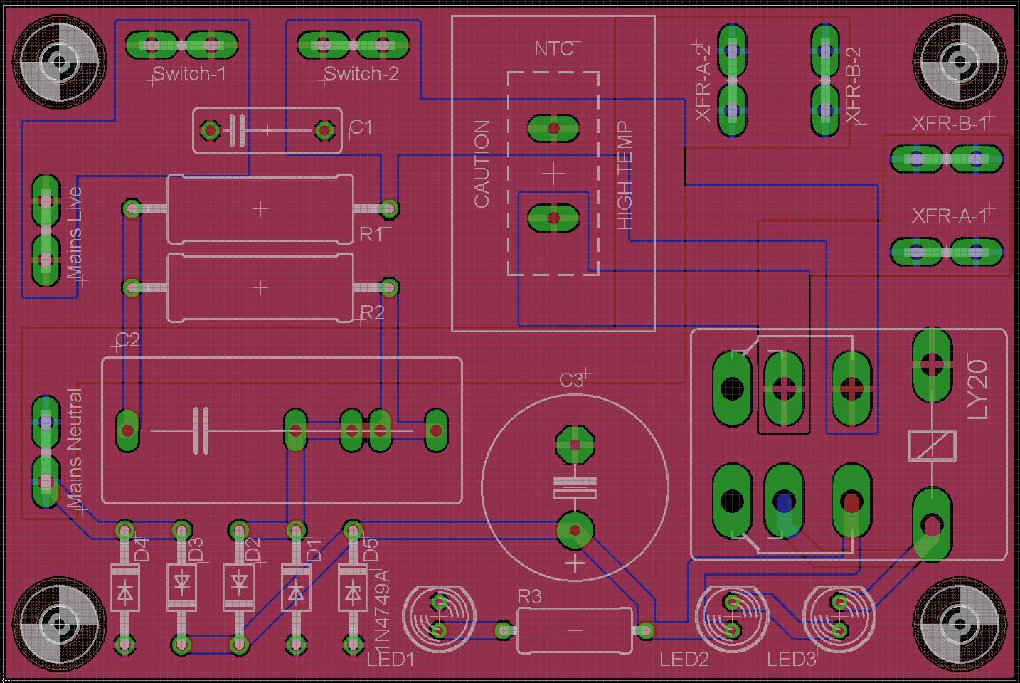

Why is all unoccupied PCB area "filled" (maybe your software calls it "flooded")? Is the filled/flooded area electrically [special=]%[/special]floating, or is it connected to a circuit node? By design the circuit has no transformer to provide isolation; every single node of the circuit is derived from the AC mains. The deadly AC mains.
I might be especially concerned about the filled area surrounding the mounting holes. Over time, as the solder mask insulation abrades away, the mounting fasteners could eventually short to the fill, making the fastener bolt/nut/washer "live" (a danger to service personnel), and possibly shorting to the chassis.
I just did a ground plane (top and bottom). Sounds like that's not a good idea here - damage could lead to the ground plane being connected directly to the mains.
Re the mounting holes, The inner circle of 3.2mm diameter is the drill hole. The outermost circle is the beginning of the ground pour (i.e. no copper inside the outer circle). Even with a washer the fastenings don't extend to the ground pour.
I'd suggest you change the footprint and drill size of the zener diode, so your board can accommodate both the 1N4749 and the 1N5359 (24V, 5W); the board will work no matter which diode the purchasing agent happens to buy.

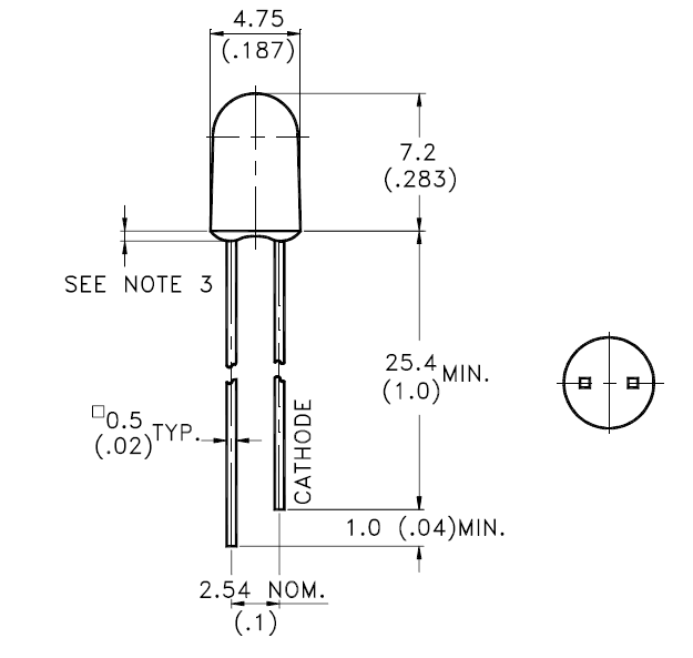

I'd also suggest putting a silkscreen "K" next to the cathodes of the 3 LEDs, in case your purchasing agent happens to buy LEDs that don't have a flat spot on the package. The boneheads at Lite-On sell quite a few LEDs whose only indication of polarity, is the length of the leads. Yes really.
Finally, I suggest you put something on the bottom side of the board (silkscreen? text-in-copper?) that indicates the polarity of the electrolytic capacitor. When the cap is inserted, it covers up the silkscreen marking on the top side of the board, so a reminder on the bottom side will reassure the assembly technician that she hasn't stuffed the capacitor backwards.
Thanks Mark. I will make the first two changes tomorrow. Re the third, it's there already. (You can just make out the ghost of the + sitting on the bottom of the board more or less directly under the + on the top.) I took that from your earlier advice on other boards.

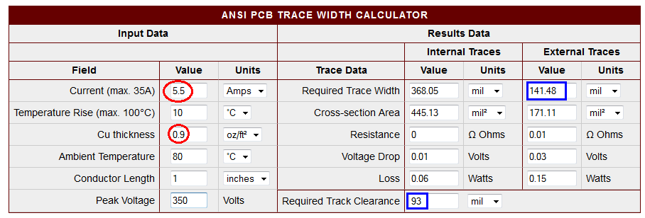

I have a question regarding trace widths and copper thickness. I have looked at a number of PCB trace width calculators, in particular this one. They would suggest that for 5A continuous and 1oz copper, 109mil is fine. I conclude that the 150mil or so traces for the main currents on this board should be more than enough. Is it really necessary to go to 2oz copper?
If anyone else has suggestions to improve the board please let me know.
Here's what I got (in blue). I used THIS online calculator.
I installed a couple of margins-of-safety (in red).
Thanks for the link to the calculator. Better than the one I was using. 2oz copper it is.

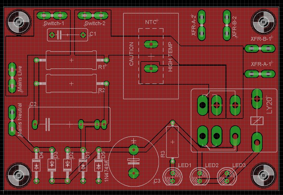

Pic of penultimate (maybe) version attached. D5 lengthened to accommodate a 1N5359B. Cathodes marked. Silk added.
Anyone else have other suggestions?
(If anyone is interested in sharing the cost of a small production run please let me know.)
- What's the simulated power dissipation in your 1 Megohm, 3 watt resistor? If I've done the calculation correctly, you will need 1700 volts across that resistor to make it dissipate 3 watts.
