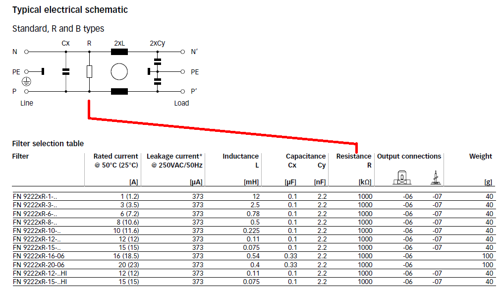

Then you don't want to apply for a job at Schaffner, making powerline EMI suppression filters. They use a single resistor across the 240VAC mains.
(Here is one of their representative products, with a link to its datasheet), and I've attached a couple of relevant portions, below.

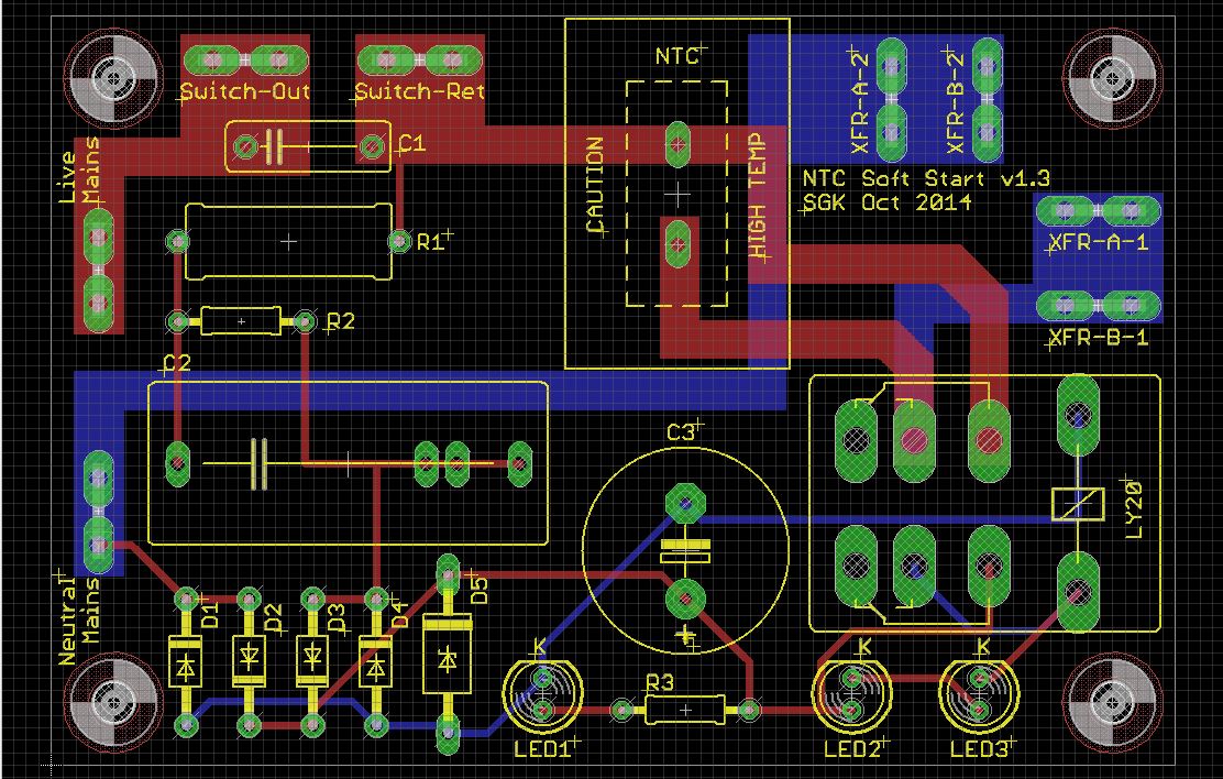

Cheers. This version has been sent to SeeedStudio. I keep working on my other stuff. (I've integrated the soft start model into my overall model of the three voltage rails etc. Need to iron out some issues there before doing any more board work.)
One somewhat generic question: the footprint on the board for C2 is 13x32mm. The EPCOS 1uF cap suggested by Mark is 11x31.5mm. Its 1.5uF brother is 12.5x31.5mm. Their 2.2uF brother is 15x31.5mm. The latter could fit were it not for the fact that the casing would get very close to, if not touch/overlap, the pad for D5. Would that be a bad thing - my presumption is the case isn't conductive and so, while perhaps a little untidy, it wouldn't be a problem...(he says rather meekly)
Yes I could change the board layout to accommodate the larger cap. My question, though, was more as regards what's possible "as is" because
This version has been sent to Seeedstudio.
1.5uF for C2 and 7.5k for R3 (with UK voltages) results in the bypass kicking in after about 320ms. I realised that for my specific application I could have it kick in even sooner. It's not the end of the world if it doesn't but my rail voltages, as currently profiled, can't come up to their max 5A load with the NTC in the loop and the NTC needn't be in the loop for longer than about 150ms. I likely couldn't turn on the rear panel switch then the front one within 320ms anyway and I very much doubt the load will be so high so quickly either. Of course I could also reconfigure the softstart to delay front-panel power-on until after the by-pass kicks in but I wanted this soft-start module to be more generic and potentially of use to others.
If I do another version I will surely accommodate the slightly wider cap.
It's best practice to usually have all diodes (also applies to polarized caps), to have their polarities all oriented in the same direction. Less chance of mistakes happening when manually populating them.
You can rotate D2 and D3 180-degrees.
Personally, I like (+) to be on top, so C3 can be rotated too. - but that's my personal preference.
** MMMmmmm.... The bottom layer copper by the relay seems to be touching (or very close to) the (3) relay pads.
