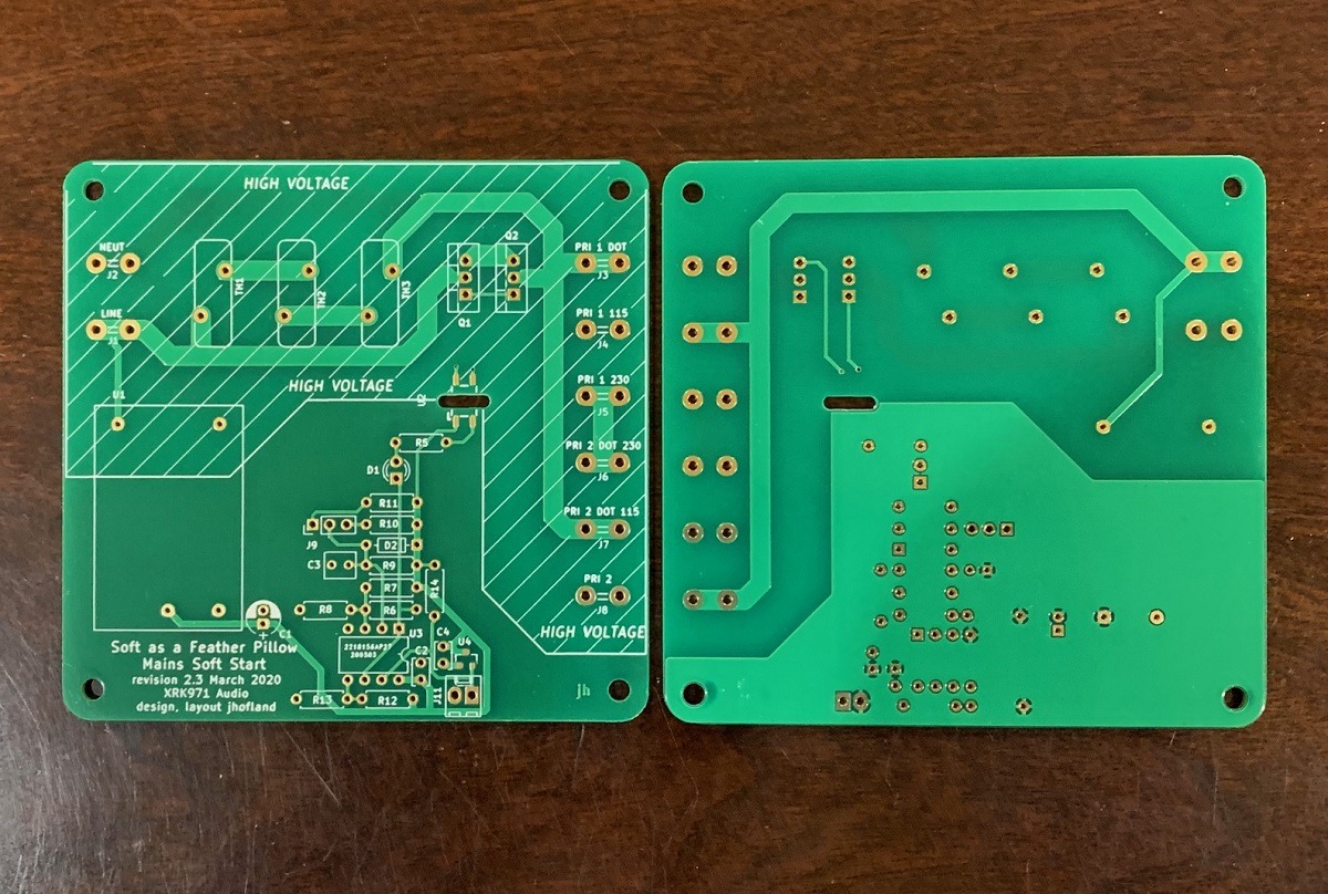

Hello fellow forum members,
Just an update on my FH9HVX build.

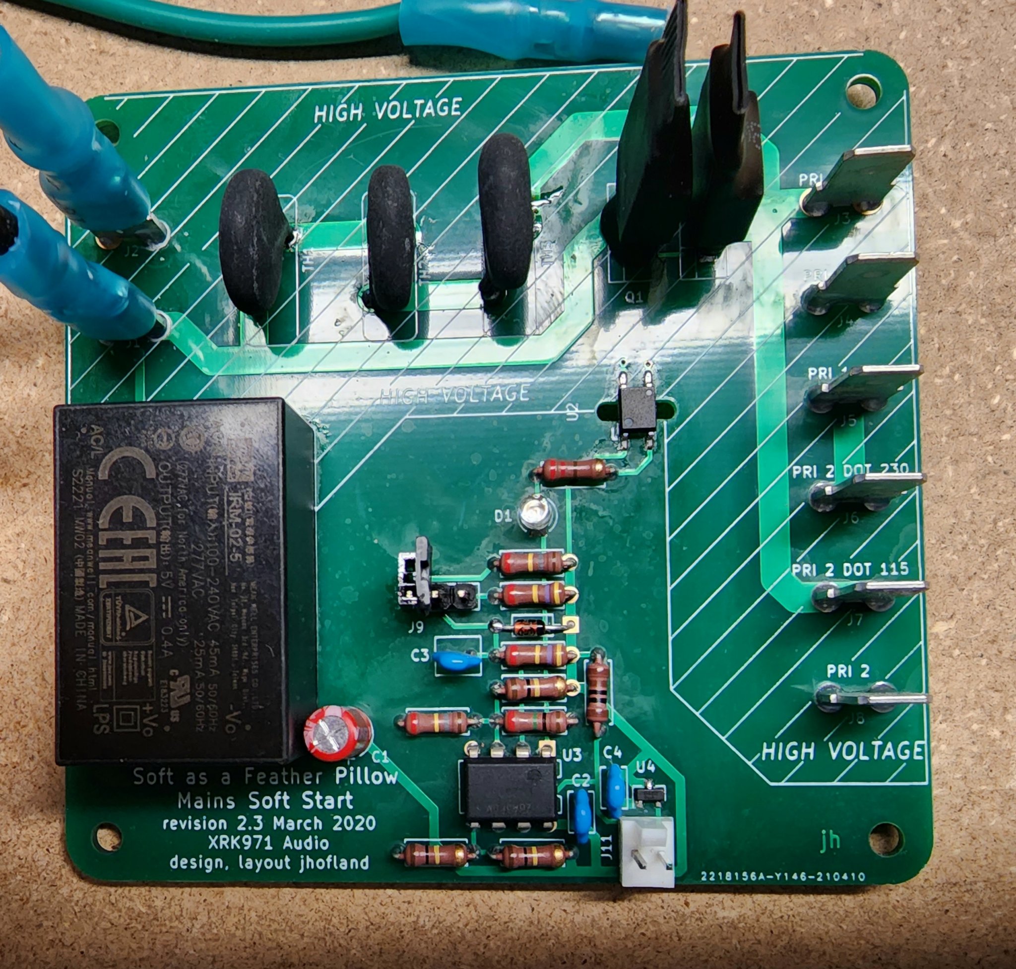

The SFP soft-start board is the only one of my boards that isn't operating properly. (The other issue I had was a wiring error).
When applying mains power to the board, I get 115AC at J3 and J4. However, the LED doesn't light and I had trouble detecting any DC voltage at J11. The most obvious explanation in my mind is that I may have placed the LED backwards.
I read the previous posts on this thread regarding points to test for voltage. However, because none of the pins are marked it will take me a little time to research data sheets and identify test points. In the mean time I am going to order a few extra LED's as a back-up plan.

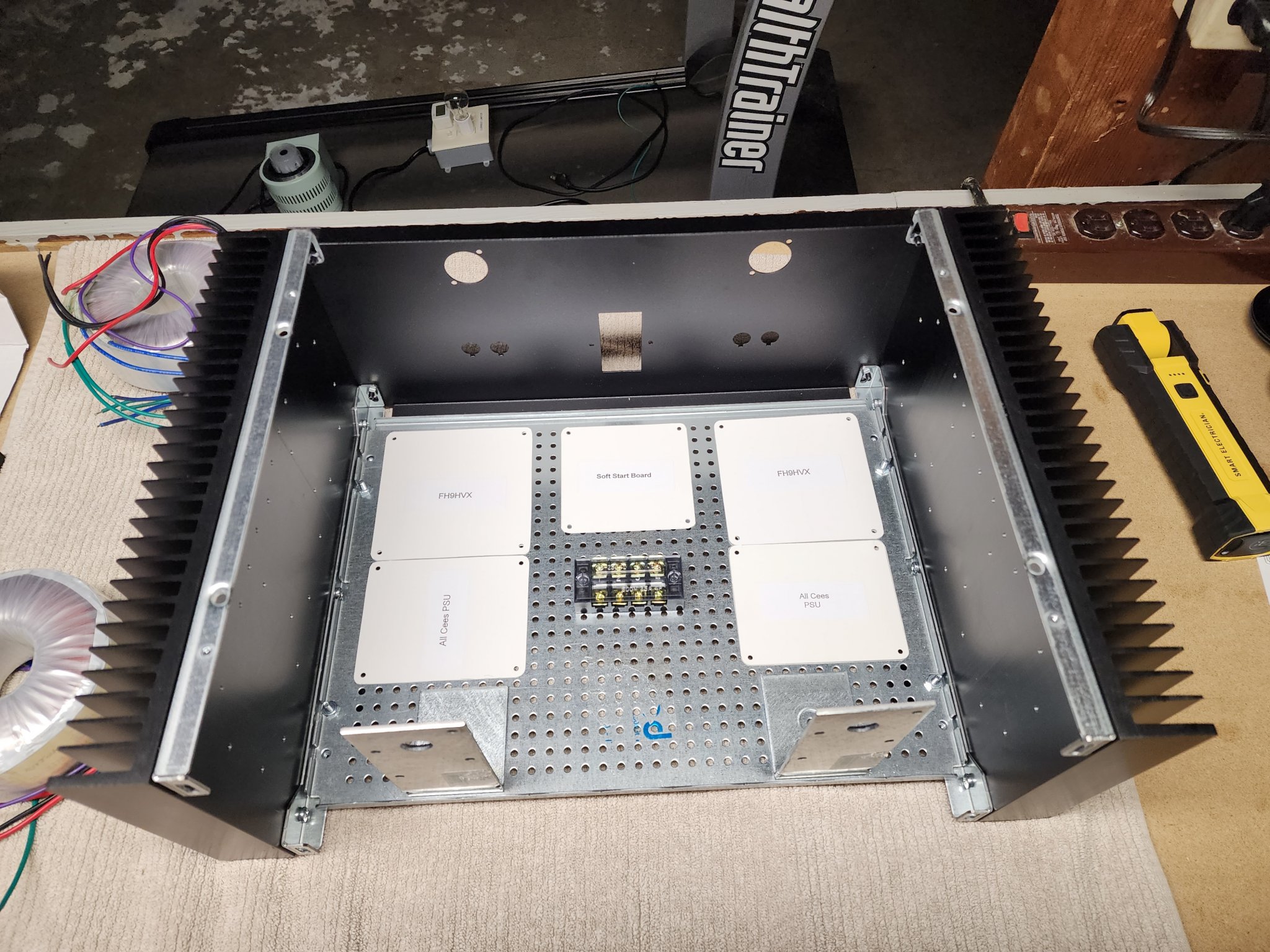

I posted a pic of my board although it may or may not provide useful information. I also posted a pic of my current enclosure mock-up with poster board footprints of my boards. (It's part of my obsessive-compulsive nature lol). I didn't post the schematic because it's at the beginning of this thread.
Thanks to X and Poseiden's Voice for hanging in there with me during my build.🙂
Respectfully. Dave M.

The other way to look at it is to make sure the anode of the LED (the long lead) is inserted into the hole closest to R5, which of course means that the cathode of the LED (short lead) would be in the other hole [which appears square in the PCB seen above].
Understand the phase configuration of the primaries of your Antek transformer. Each Antek toroid power transformer has dual primaries. Each RED colored cable on the transformer should be connected to J3 and J7 while the Black colored cables should be connected to J4 and J8. I see you have a terminal strip, so you want to be sure you connect your pair of Antek toroids properly. You can just connect the toroid primaries to the terminal strip and then have single wires from the terminal strip connect directly to J3,4,7 and 8 for ease of wiring and making sure it looks neat. If you want, use the same colored wires to avoid confusion. I would also twist any wire that is carrying AC primary voltage.
Please also flip the pcb over (like you did with the FH9HVX) and make sure all your soldering is neat and clean; it might take a little more heat/flux as these are thick boards. The assumption is you placed all the correct resistors in their proper locations! 😉

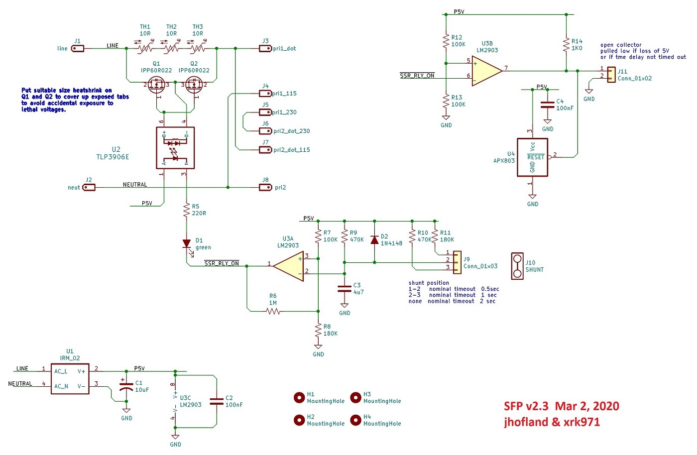

When you test the board, look at the schematic and notice all the areas that +5V DC should be present. Check those areas so you are convinced that all them are receiving +5V. Examples: Pin 1 of U2. Pin 8 of U3. Pin 3 of U4. Be careful with your multimeter. You don’t want the leads to accidentally slip and cause a short. Look at the schematic and the blank pcb you see above for hints and observe where the 5V supply trace travels on the pcb. Understand that the function of transistors U2, U3 and U4 depend on a properly functioning U1 (the black Meanwell IRM switcher).
