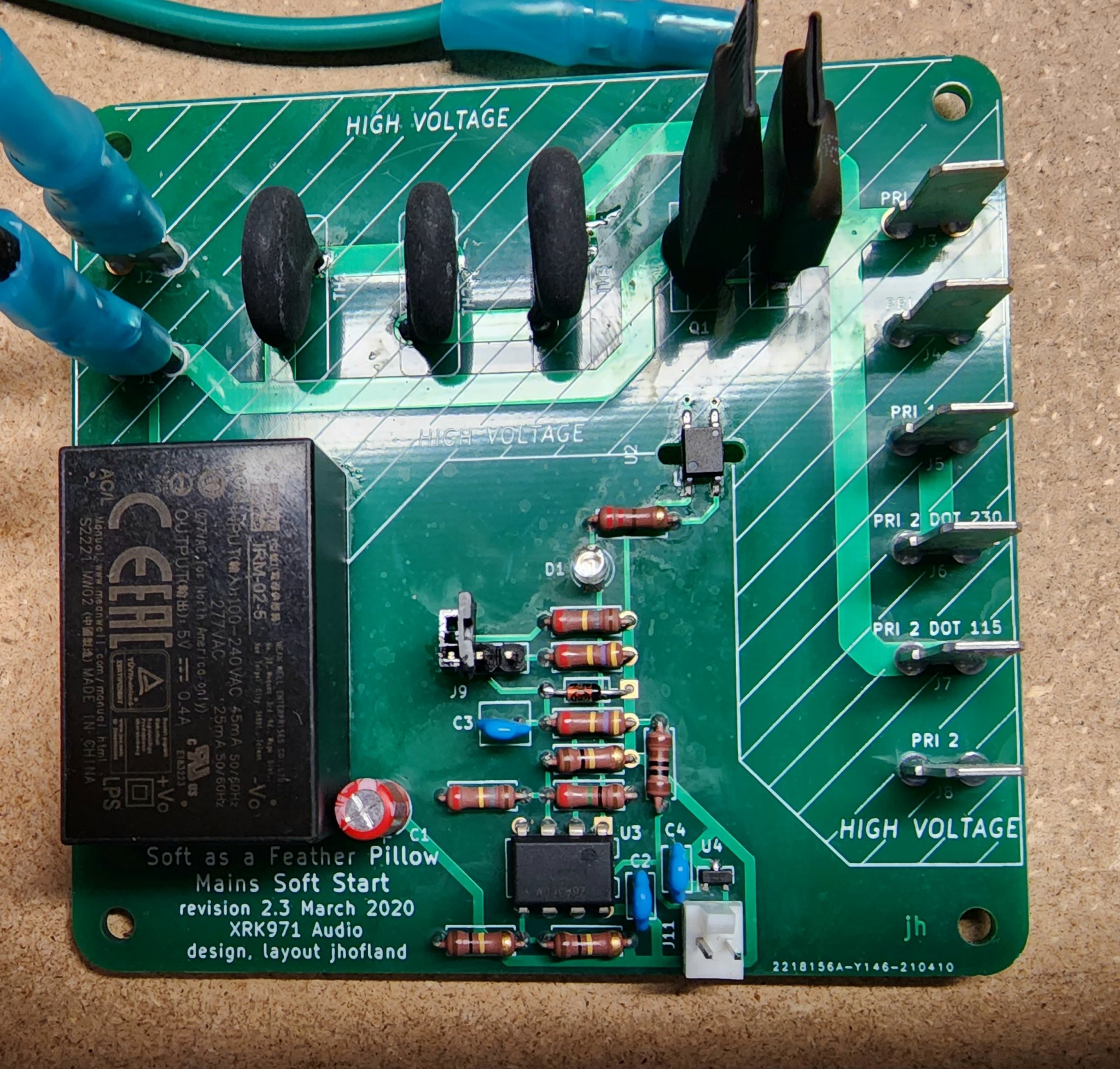

I received my LED's from Mouser, installed one with the  correct orientation and bingo; it lit up as expected. However, my testing results have me scratching my head.

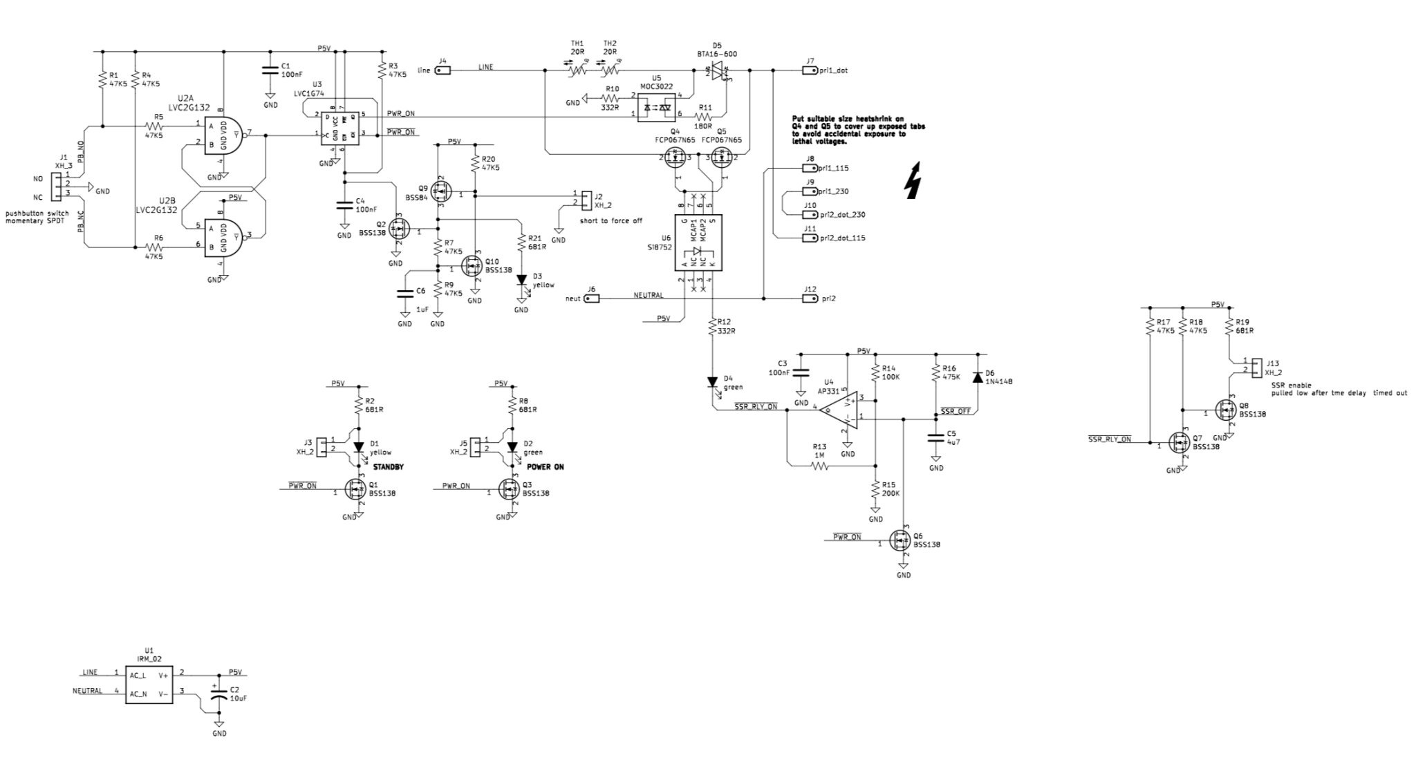

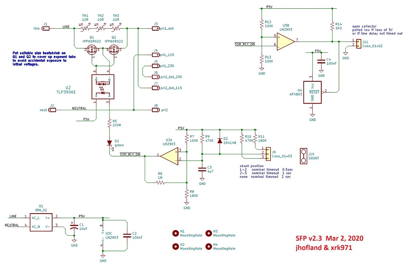

I 'carefully' checked voltage on the underside of U1 and the DMM read 4.99 vDC. Pin 1 of U2 reads 4.99vDC, pin 8 of U3 reads 4.99vDC, pin 3 of U4 reads 4.99vDC. So what reading do I get accross J11? (0.69 vDC) I should be getting the same voltage accross J11 shouldn't I? I reflowed all of the solder joints in that area of the board to no avail. I also removed R14 and tested it, thinking that maybe I had the wrong value resistor. However, R14 tested out at 1004 ohms. Any thoughts before I start replacing parts wholesale? I do wear a carbon fiber wrist strap but could I have zapped one of the transistors?
Thanks in advance for your time and your ideas. Respectfully, Dave M.

Hi UncleMud,
What you measure at J11 is the open collector logic to control the SSR’s. Note that 5v goes through the 1k resistor. It’s meant to provide a current loop through J11 to activate the optoisolator on the SSR speaker protect board. In normal operation this resistor provides 5mA of current to light up the LED in the optoisolator. When a trigger event occurs, the “open collector” comparator acts as a current sink and shuts off the current flow to SSRs by sinking that pin close to GND. That stops the 5mA current from activating the optoisolator in the SSRs. So I think what you have is normal. You can test this by putting an LED across J11 (anode to pin 1 and cathode to pin 2) and see that it lights up only after about a 2 second delay after turn on. I think all is good and you have a good working unit.
If you are using a low capacitance PSU for your SSR speaker project board that will handle the quick shutdown and it already has a built in 2 second turn on delay. So you don’t need to use J11. It is there for anyone who wants an open collector logic to integrate their own electronics for specific purposes tied to the SFP on state.

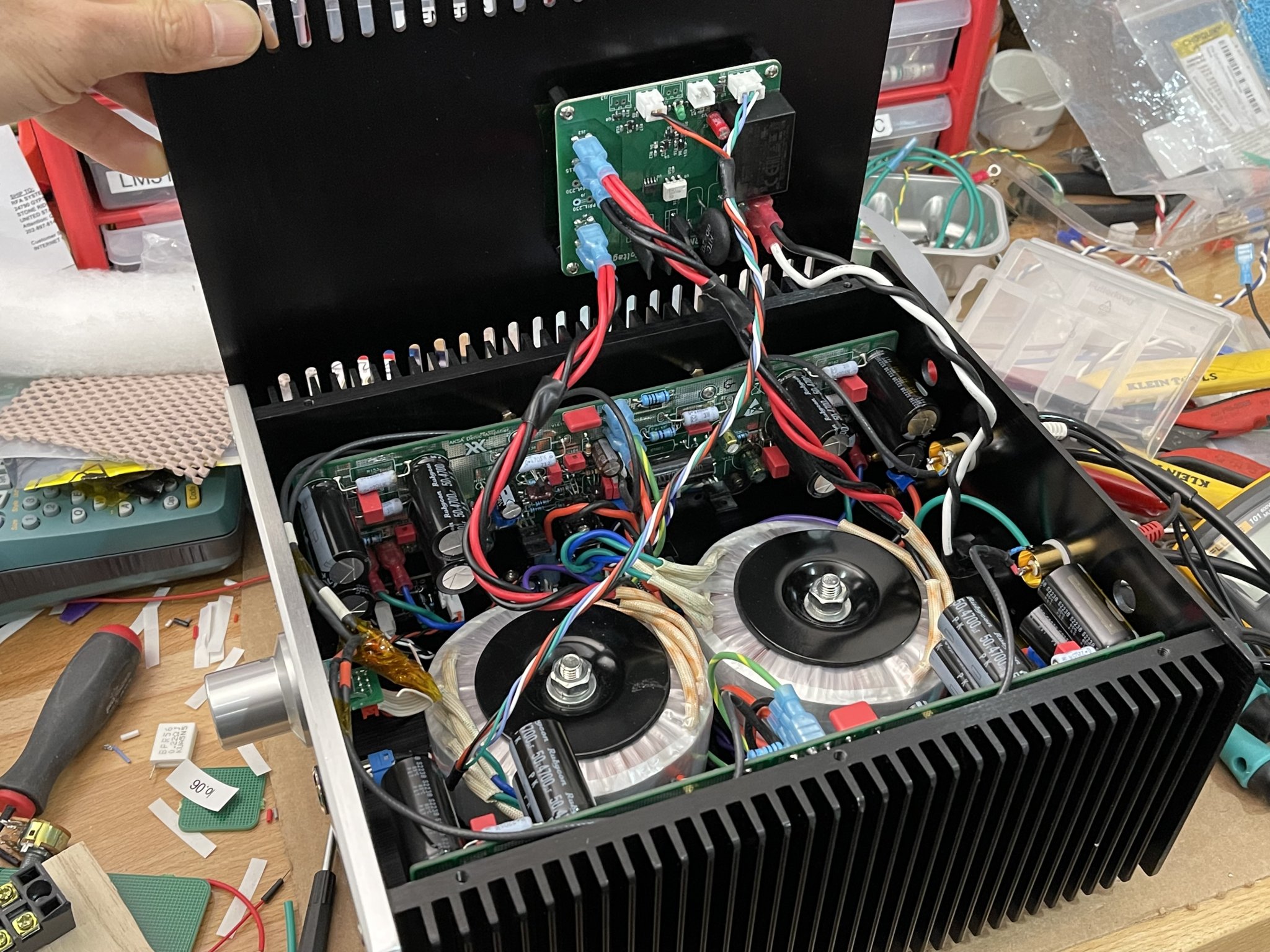

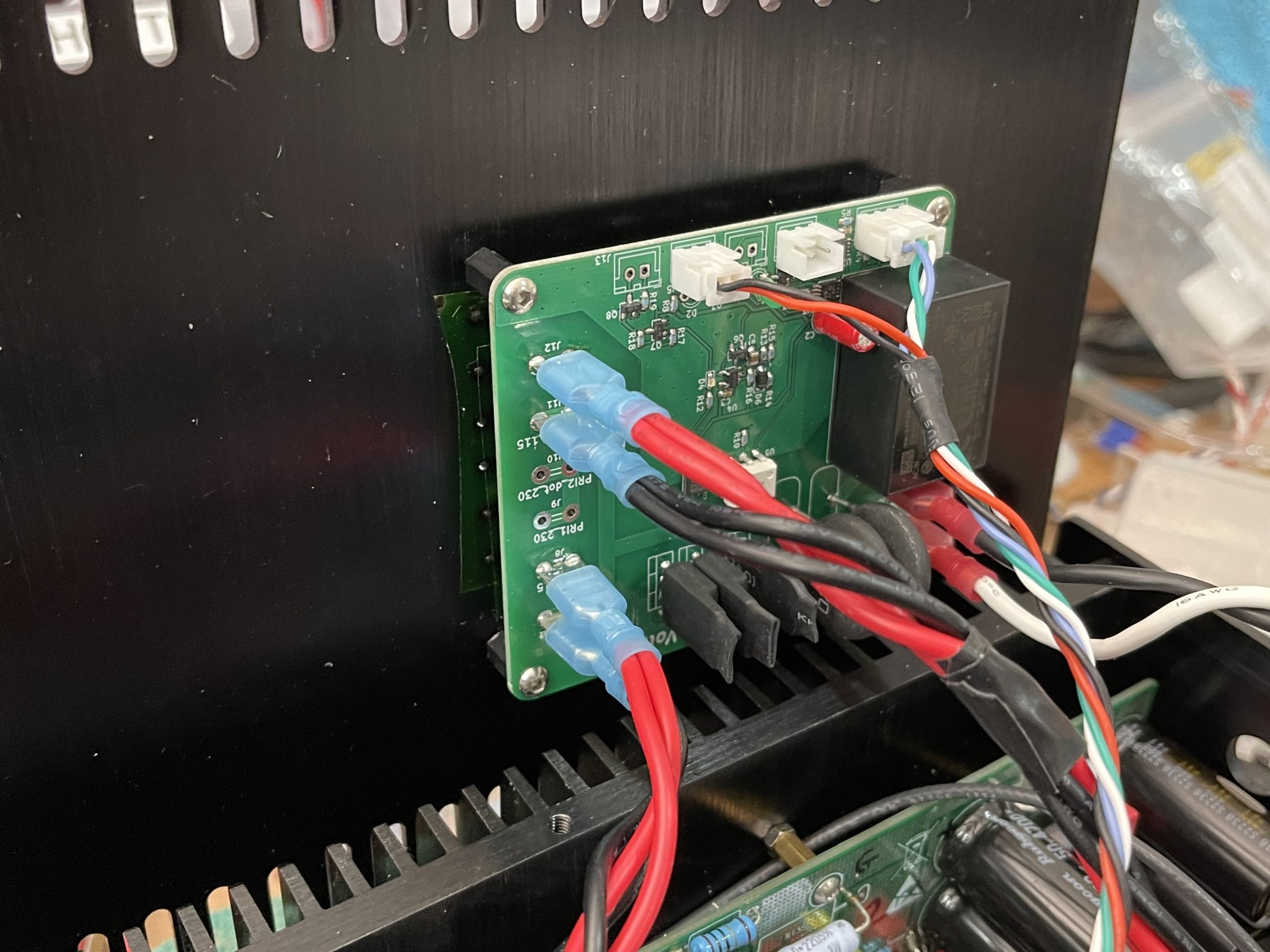

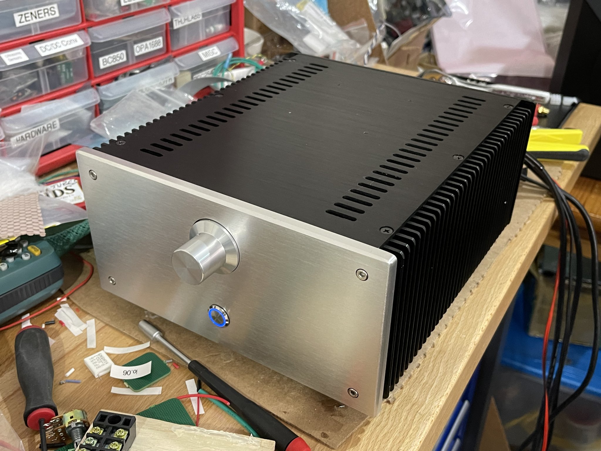

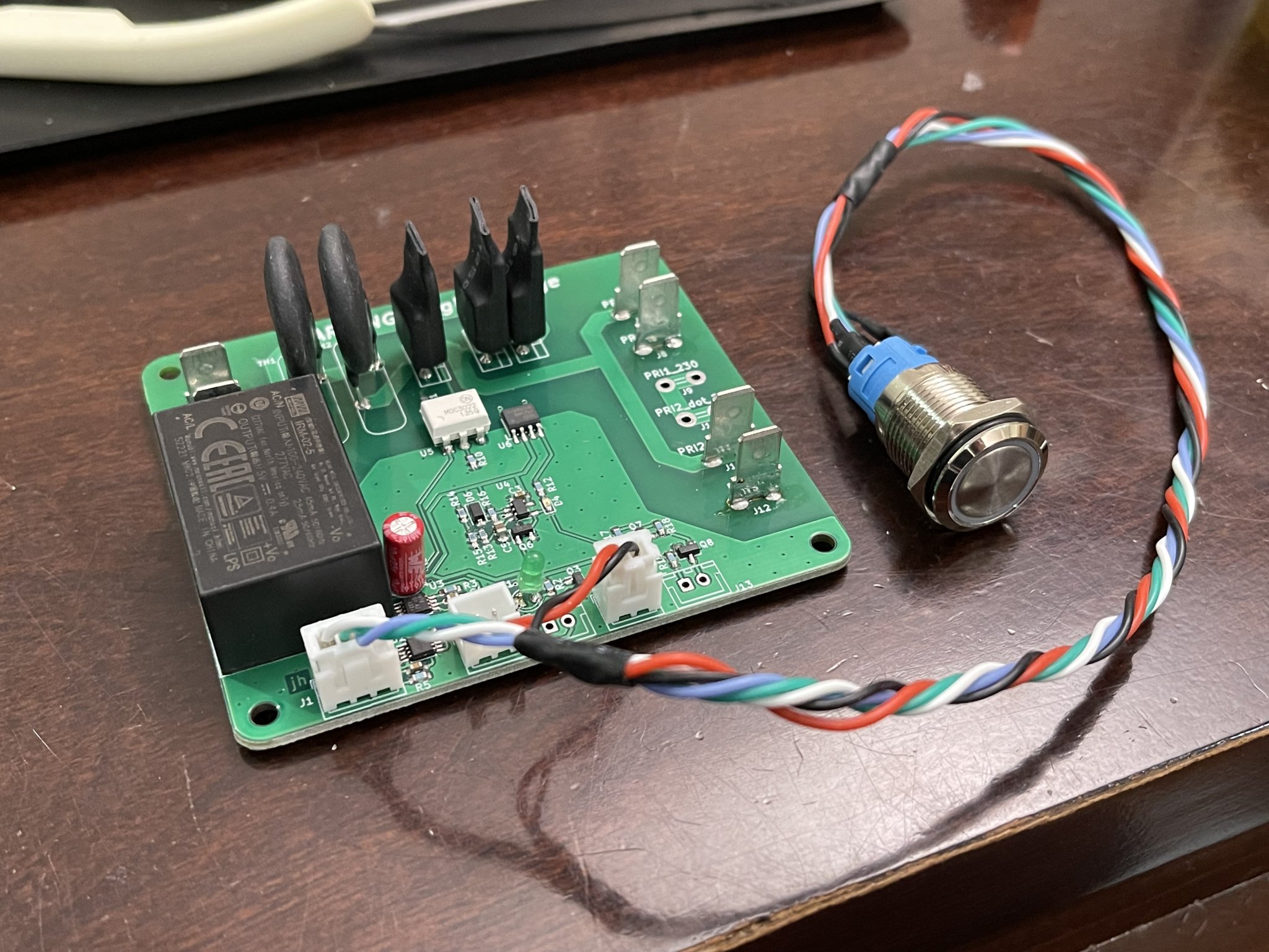

I have had a chance to test out the SFP Plus (SFPP) a few more times now. It includes ability to be turned on/off with a momentary pushbutton switch, allows for thermal shutdown switch, and has logic to drive speaker protection SSR with open collector logic. Latest amp I am using it on is the Aksa Deltic.
This board has a lot of tiny SMT parts and is a bit tricky to assemble. This might be a good option for a ready to run (RTR) board. Or it would have to be redesigned with as much TH parts as possible. Or maybe just have the small SMT stuff preinstalled.
Nonetheless, it’s a sweet board and gives your amp a professional and very satisfying push button click on without throwing a big mechanical switch or relay. The LED ring light on the button comes on and is very nice.
It’s mounted on the top lid of the Deltic since I ran out of space.
