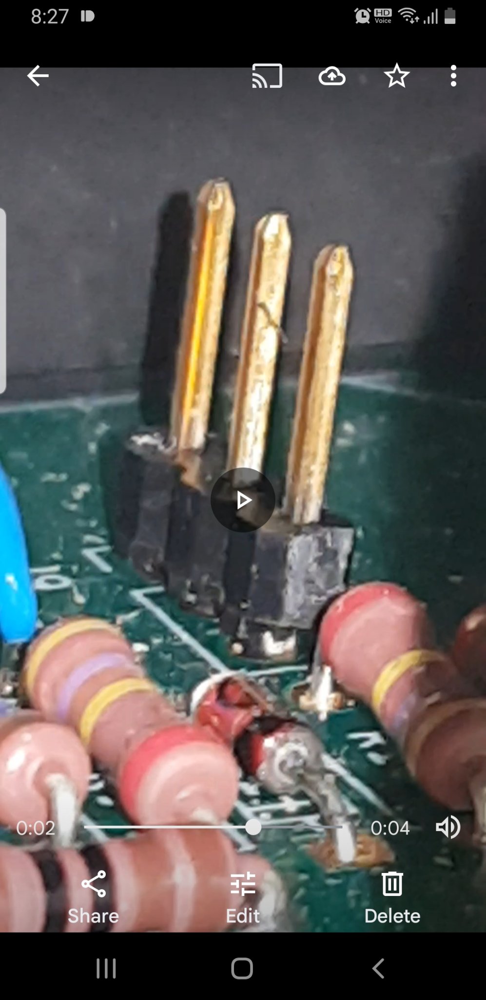

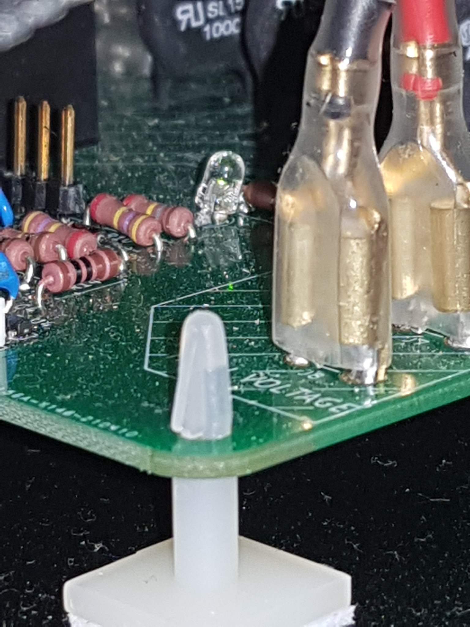

I am using it without jumper and the D2 direction seems correct.
Today I power it up and it sounds immediately without any 0.5sec delay.
I don't know why.
Will I have to reflow all solderings?
I don't know why.

That sounds consistent with the design. On power up connection is made via the triac and the NTC devices. The initial current surge is moderated by the NTC's. After about 2 seconds the MOSFETs engage and short out across the NTC and triac.
Yes, I was going to say what Jhofland said. Unless there is a load that draws a lot of current, the voltage will measure high when the triac turns on - immediately. Looks like your SFP is working as expected.
Yes it immediately plays but the current in rush is limited by the three NTCs in series. This prevents the mechanical and thermal stresses of a high current pulse hitting the trafo windings and other components. It’s different than an anti-pop turn on “mute” function. That requires an SSR at the speaker output with a delay - and you get that if you use my speaker protect SSR.

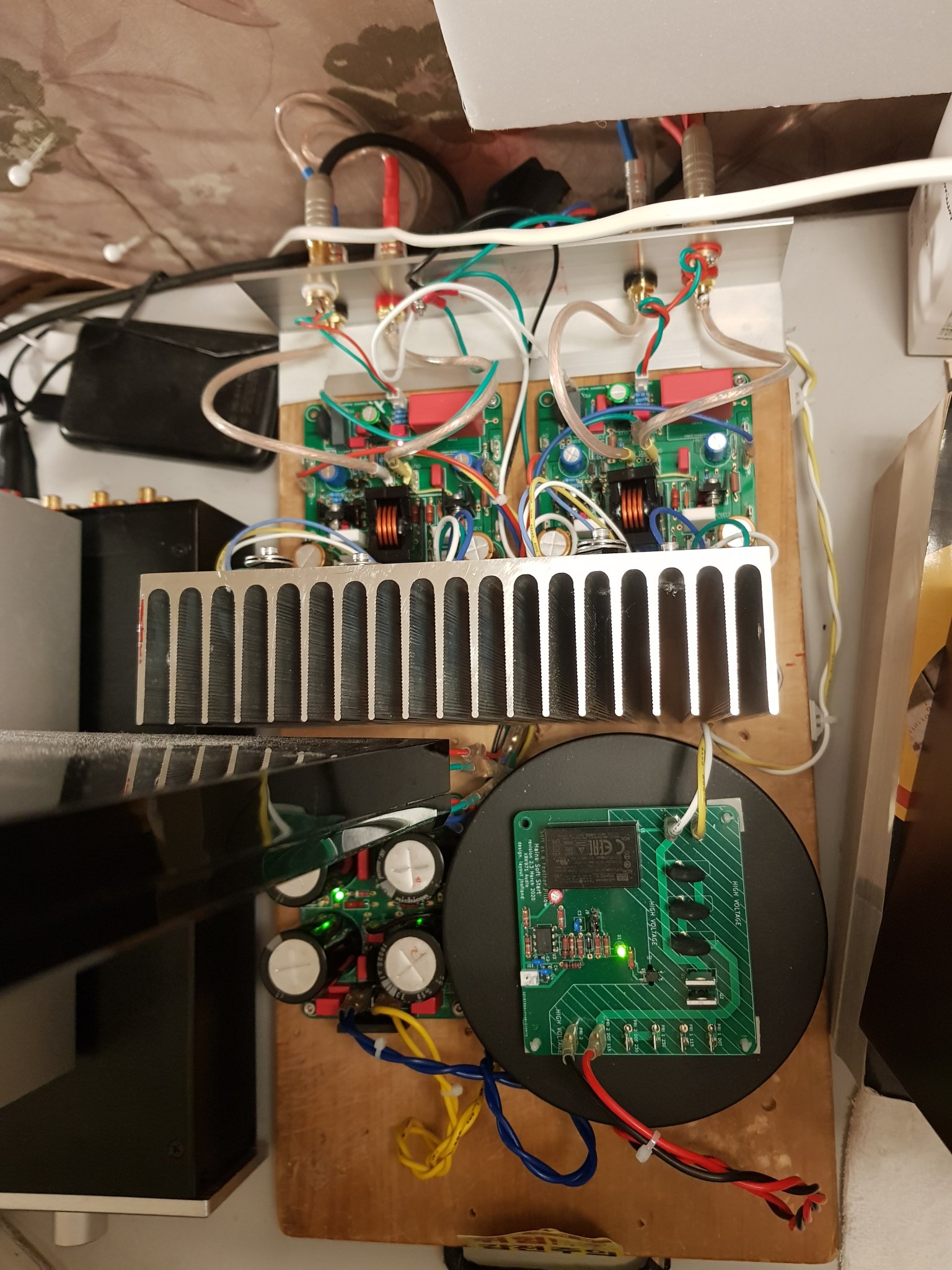

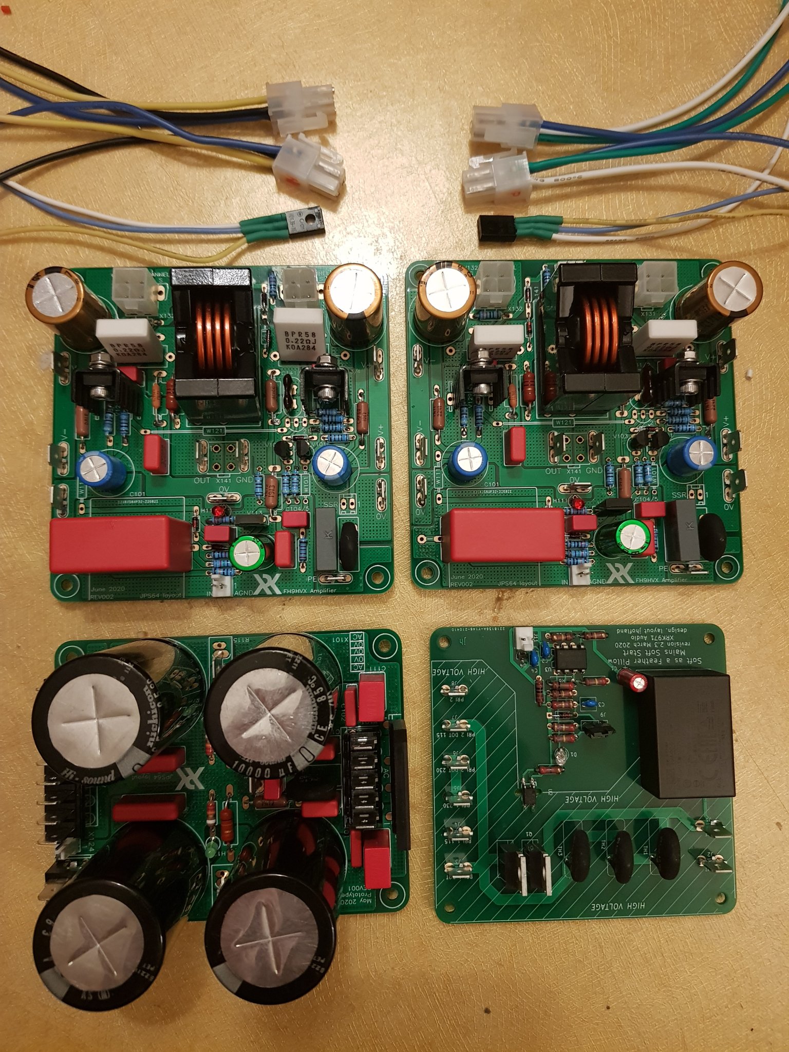

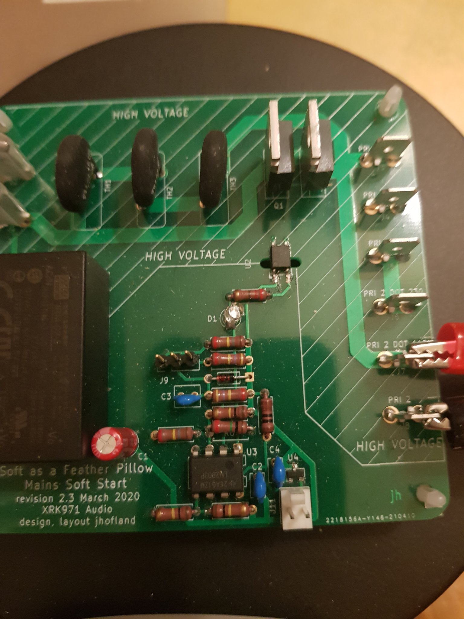

Good evening.
I am slowly progressing with my amp built.
Time to check if I have soldered soft start correctly.
Can anyone please confirm all is good so I can power it up ?
Looks good. Note that without a load, there will be a few volts after the triac when in the off state. But that’s normal.
