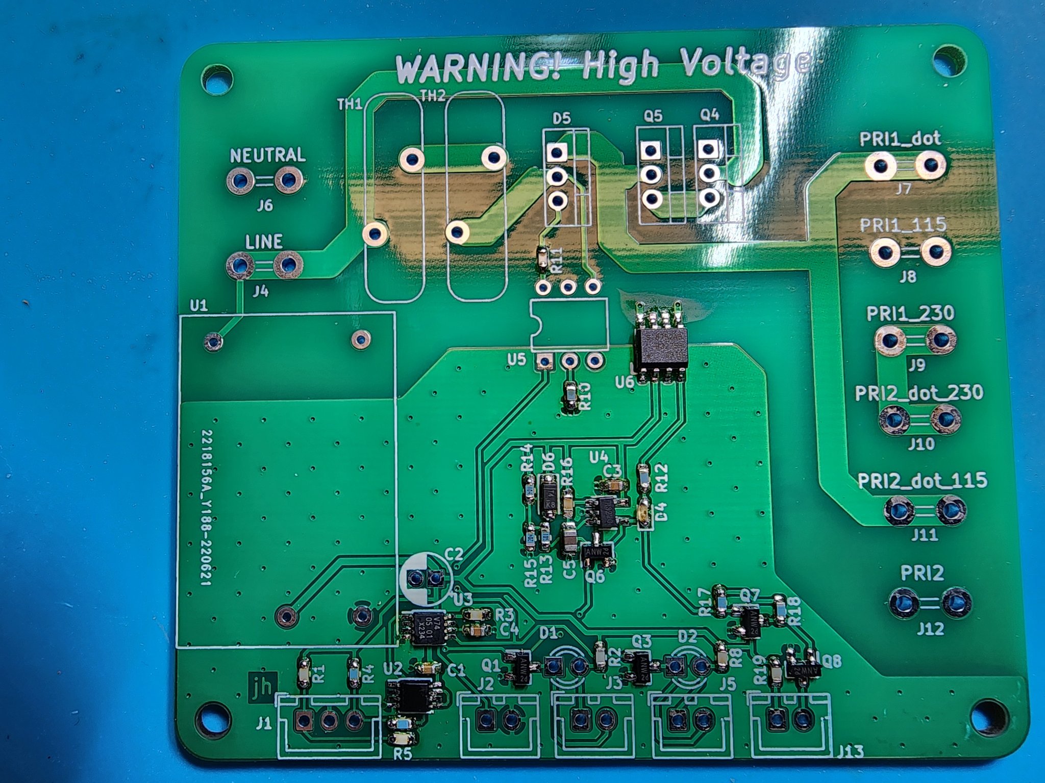

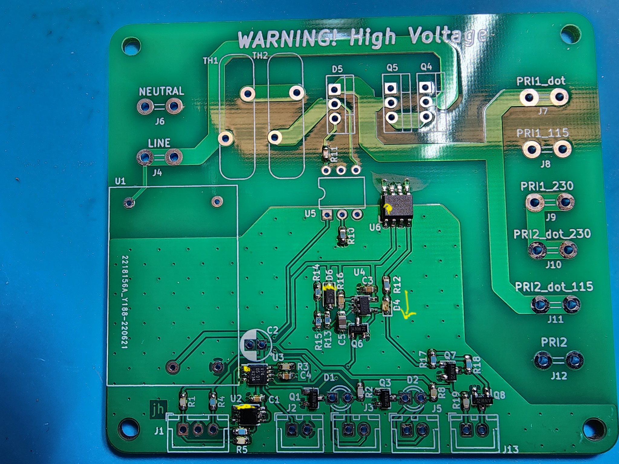

Hello Forum Members,
Looking for feedback. I'm wondering if anyone with more experience building the SFPP soft-start board would care to take a look at the orientation of my IC's and diodes.
Also, feel free to offer feedback on the soldering quality. I used the hotplate/hot-air wand method which worked very well. Unfortunately, I used too much solder paste and had to go back with braid to fix bridges on the IC's. I still think I see one on U4.

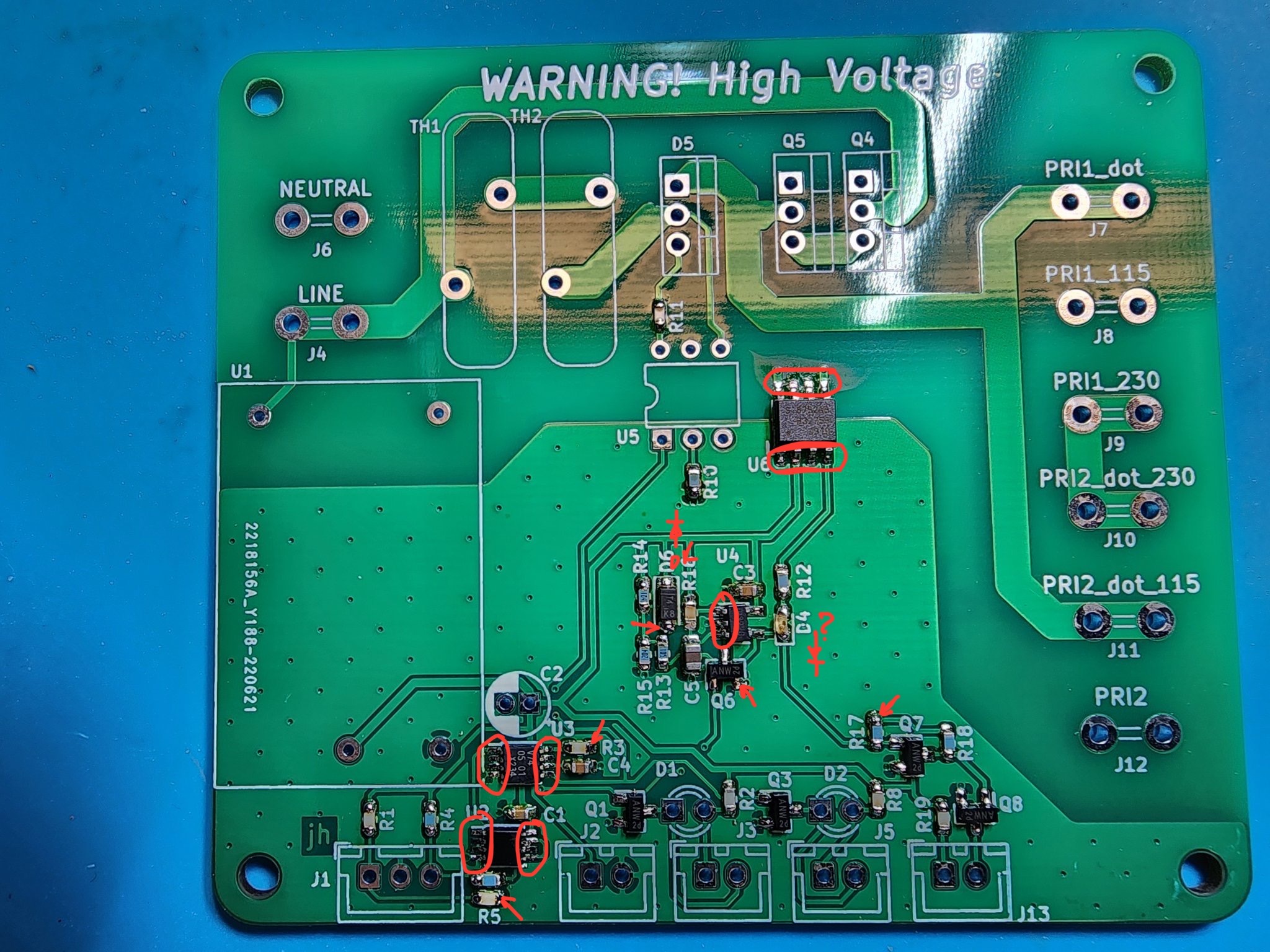

Hi UncleMud,
Nice first attempt. As you saw, much less solder paste is needed. Also I think your temps were not high enough as some joints don’t look like a smooth fillet or ball. I would suggest going over the small IC pins with copper braid soaked in flux with a chisel tip iron on top of the braid to soak up excess solder on the pins to prevent bridges. Especially U2 and U3. They are very sensitive. You will notice that once the ACDC is installed, it’s tough to get to one side of the pins on U3. So solder the AC/DC very lightly - almost just the tips of pins touching. This way, you can remove it easily to rework.
All the joints I circled need either solder braid and flux to remove excess solder or just go over with a hot iron to reflow the solder. It should form a smoother joint. You might have a cold solder joint on some of these. The LED orientation is hard to say unless you look at the bottom of it first.
Good luck!

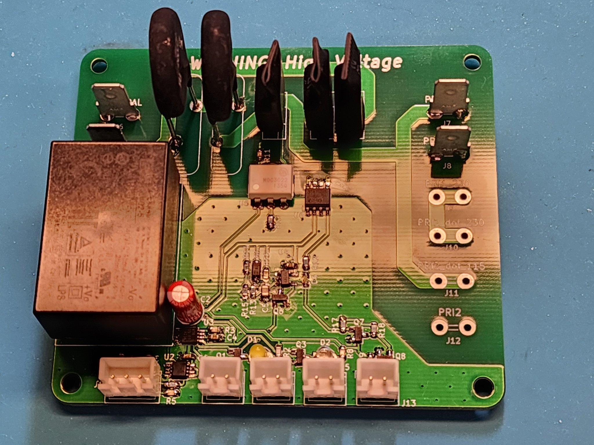

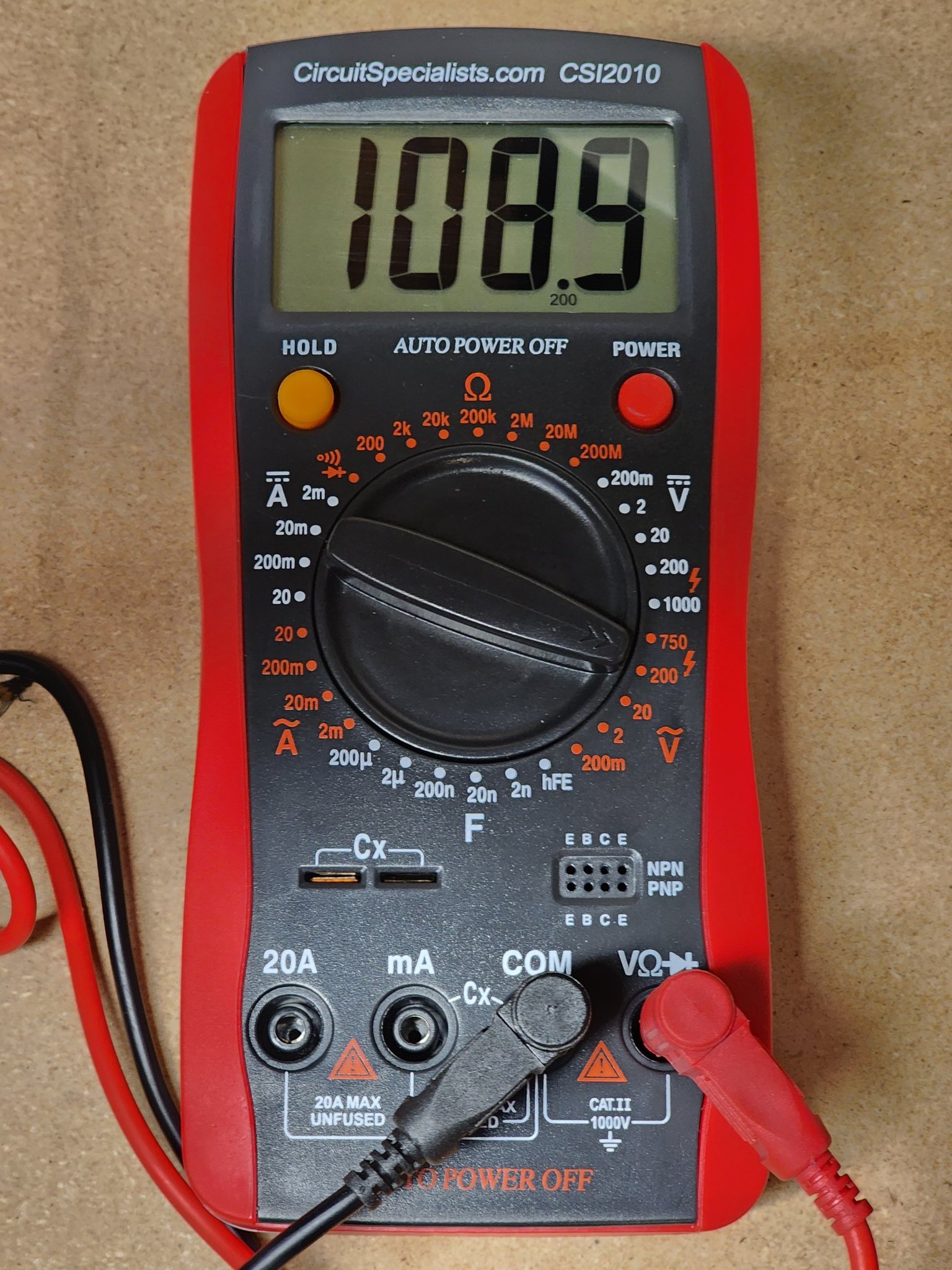

Well, I wired up my SFPP board for a test drive. It has some issues.
On a positive note, the switch Vunce suggested will look beautiful on my Honey Badger if I can successfully de-bug the board.
The switch does light up when cycled. The light also goes out properly when cycled. Howver, I have no illumination from the standby LED at anytime. Additionally, the board allows mains voltage to pass through at all times, regardless of switch position.
I have attached several pics in the hope they will be helpful. Any suggestions where I should start?
Thank you in advance! Dave M.

Dave,
Connect a transformer to the SFPP, it needs a load to work properly. If not connected you will get the results your showing. Just be sure the secondaries are not touching anything so no chance of shorting.
The standby LED could be as simple as reversed polarity.
