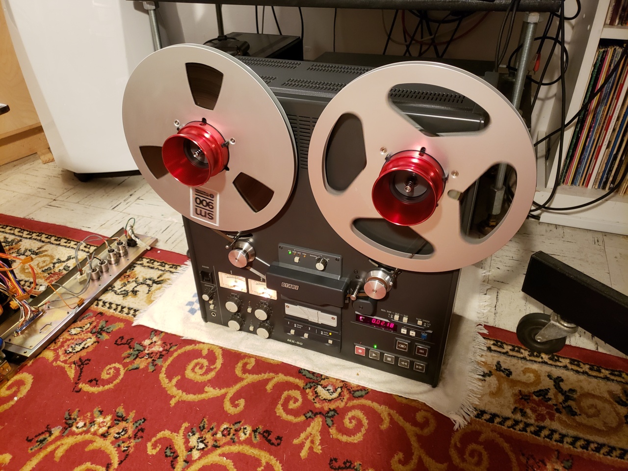

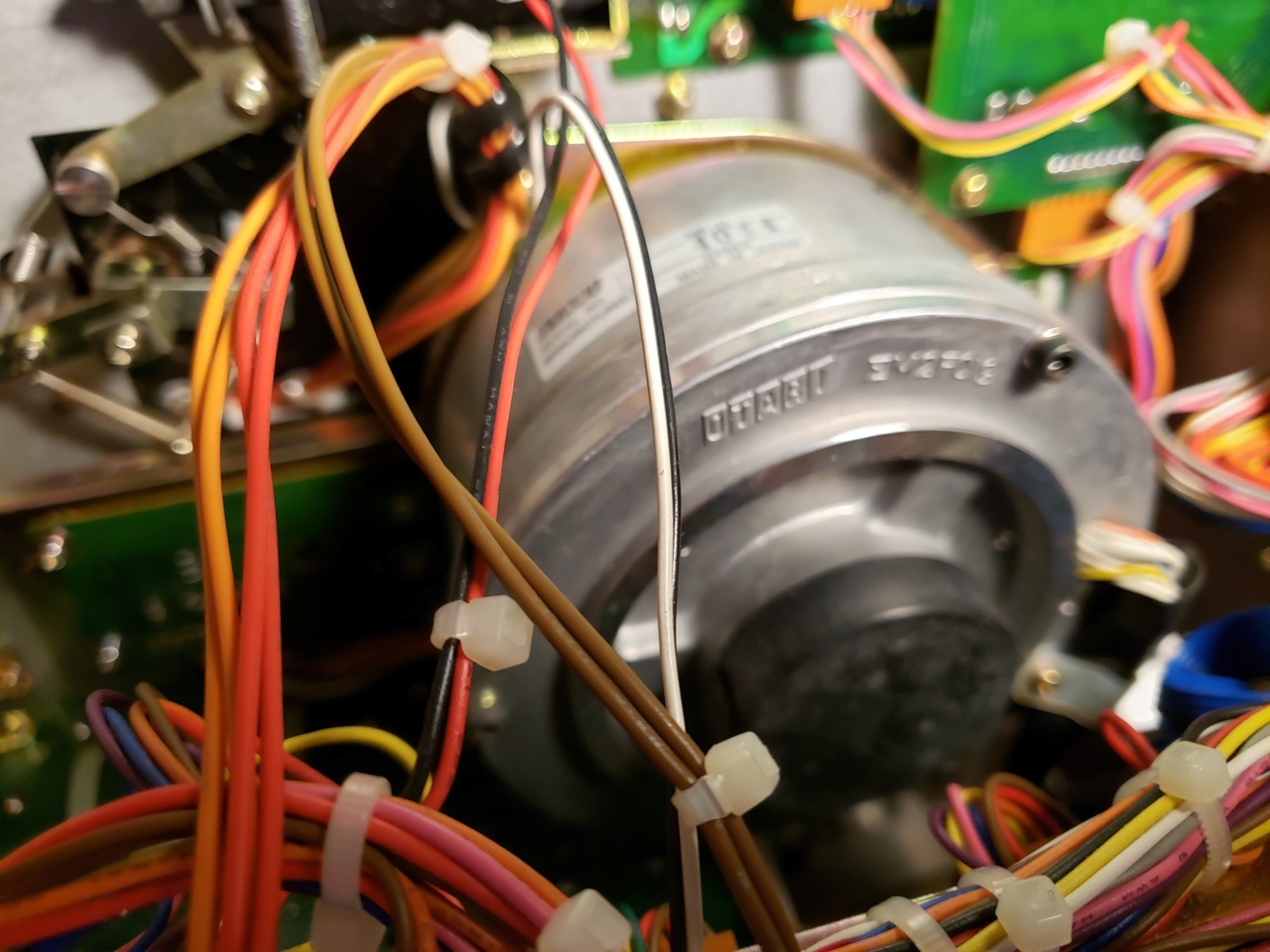

I now also own two MX-50N, the first one needs a lot work, but sounded good enough to persuade me to purchase a really nice one.
The first one shown arrived today and is a very mint MX-50N II which needs an electronic refresh. (Caps replaced and some other minor ministrations.)
The second one shown arrived last week and was involved in some sort of mishap that resulted in it getting wet. The reel tables and table holders are unserviceable due to damage and it currently has MX-5050 reel tables and holders on it. It does run, and is currently is in lots of pieces as I assess and repair damage. Recap will be soon.
I would frankly recommend a well cared for MX-50 for anyone not willing to do the mods discussed in this thread. It sounds pretty good out of the box and has a transport that is much gentler on fragile tapes. On the down side it lacks oscillator and external calibration controls for recording and you have to take the bottom off to do the calibration. The machine does not have the macho industrial look of the 5050, they are contemporaries of very late BII/MKIII and early BIII.

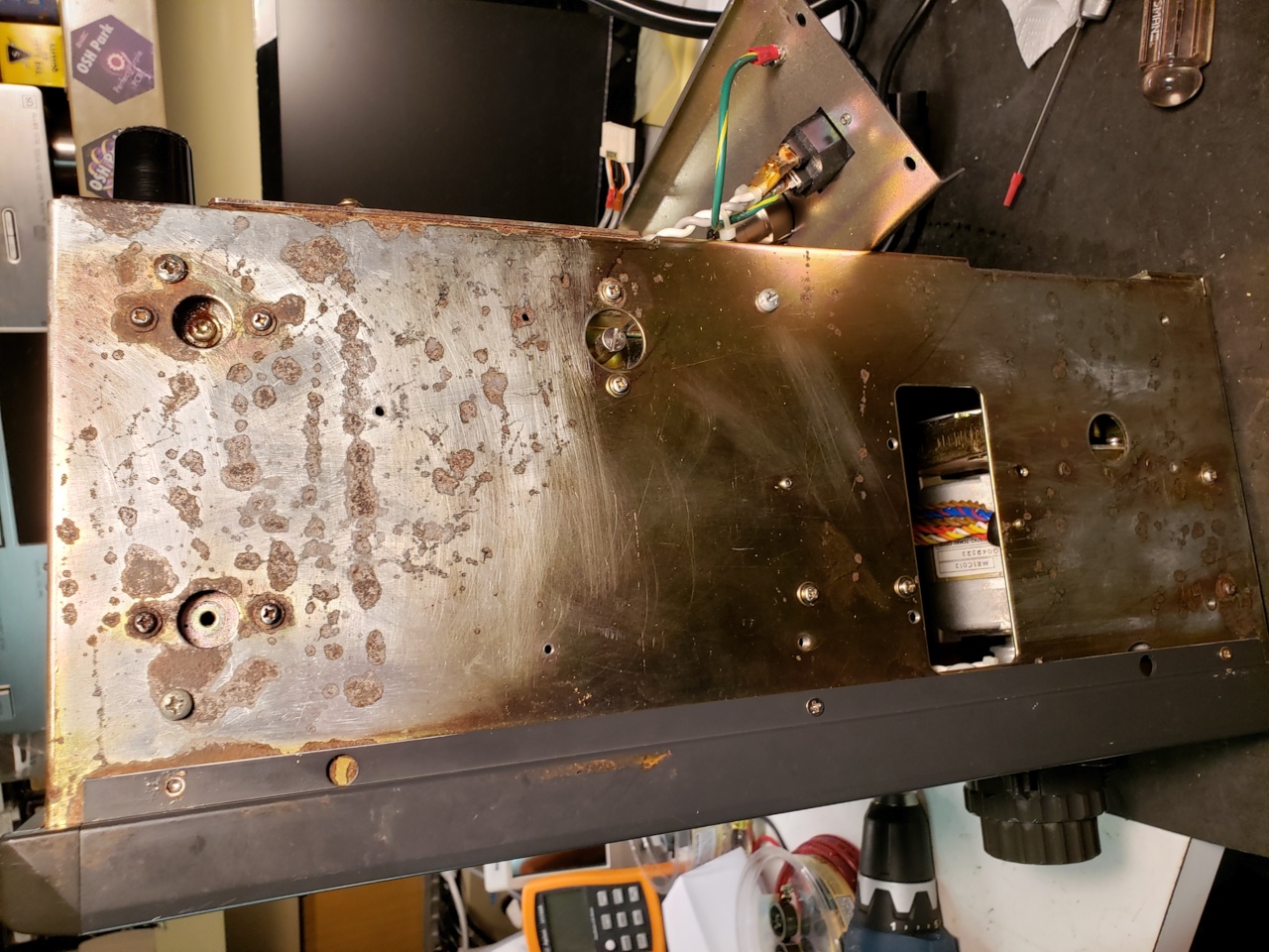

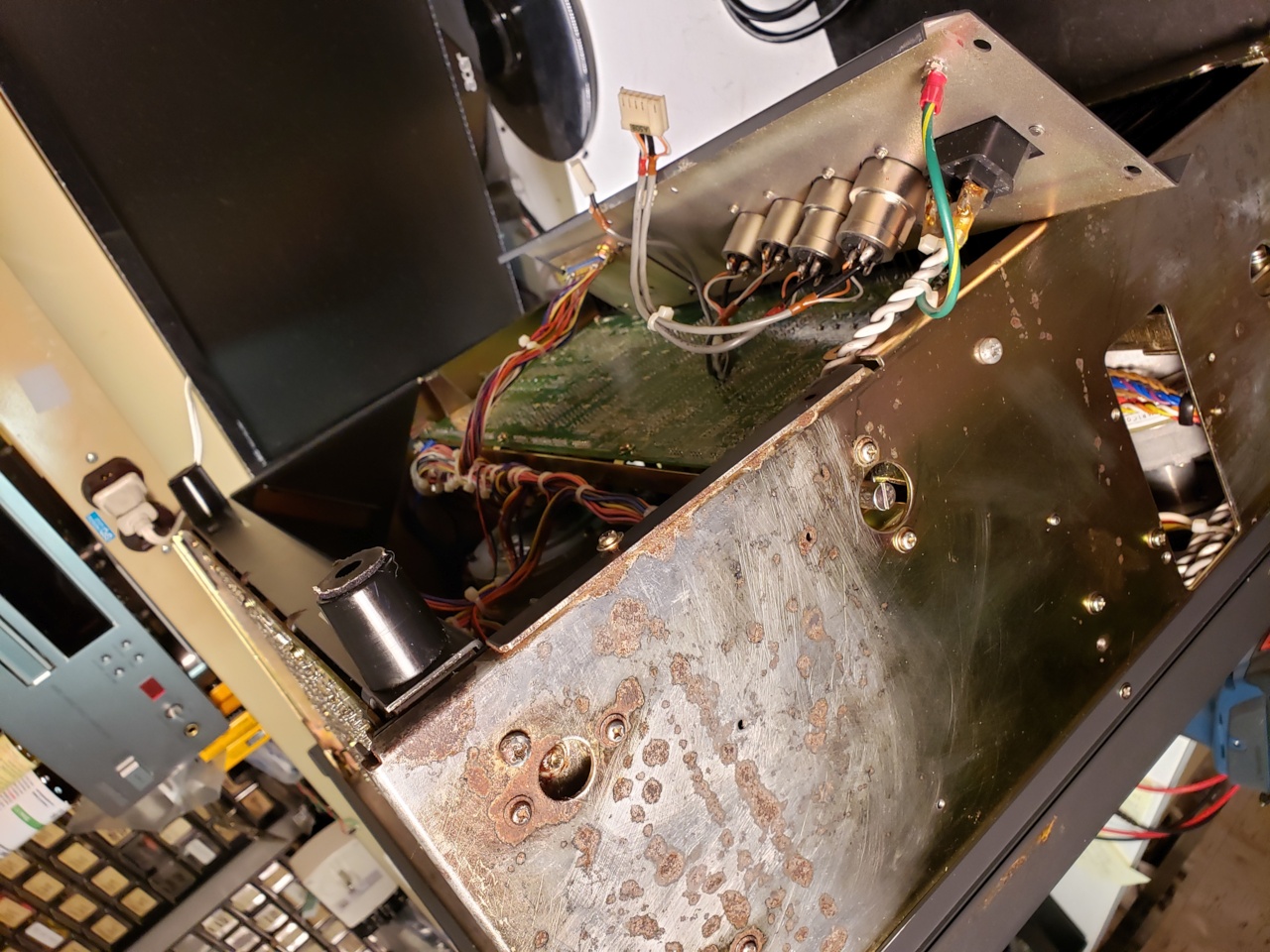

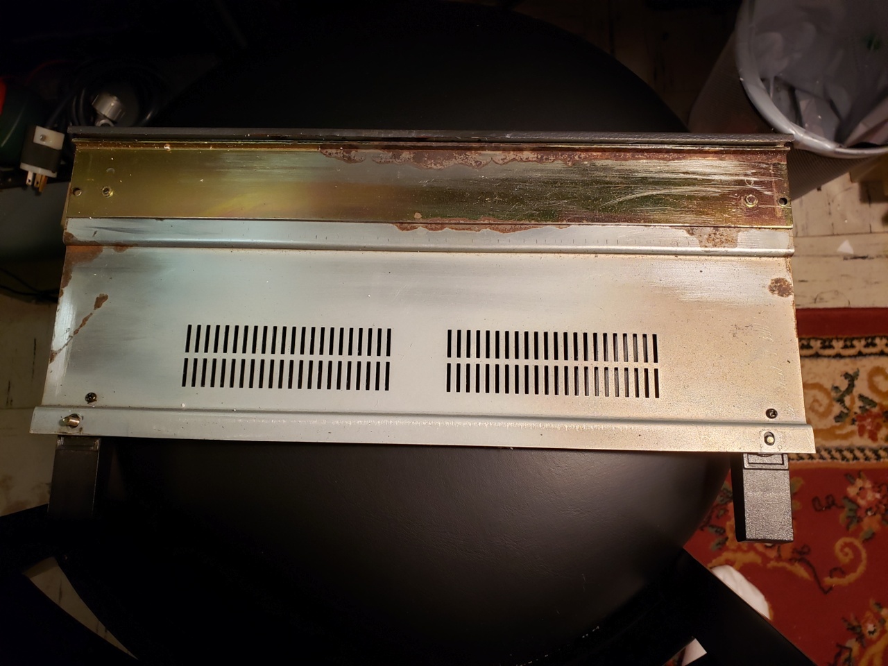

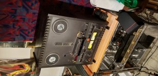

MX-50N (Water Damage)
Here is the deck in its last running configuration and as it currently sits.

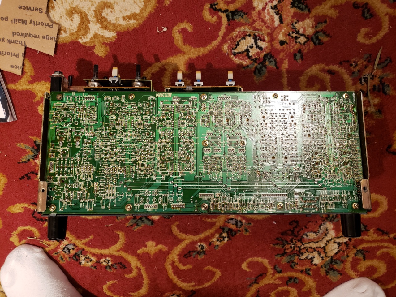

I have to my chagrin discovered that the audio board actually got wet, and there is evidence of some sort of contamination mixed with what appears to be rosin. This coating is on all of the boards and nowhere else - I am how it got there.
There is some very minor corrosion damage on the bottom of the board.
The logic board has the same stuff on the back side as well.
The plan is to clean these boards thoroughly and replace all of the electrolytics. They are much less trivial to take apart than the MKIII, but perhaps not quite as bad as the BII, bearing in mind I have not tried to put it back together yet.
It sounded quite good while it was actually running.

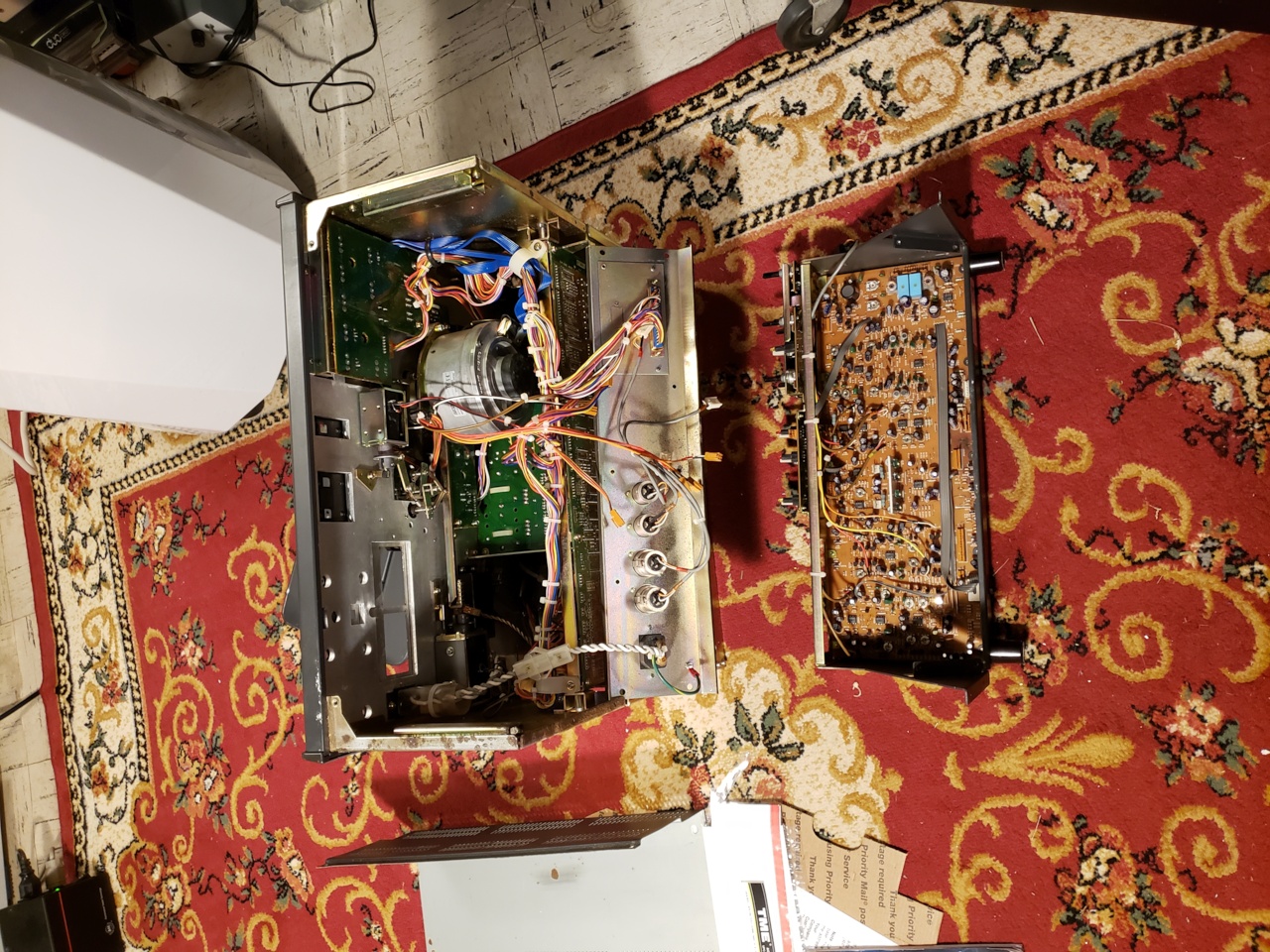

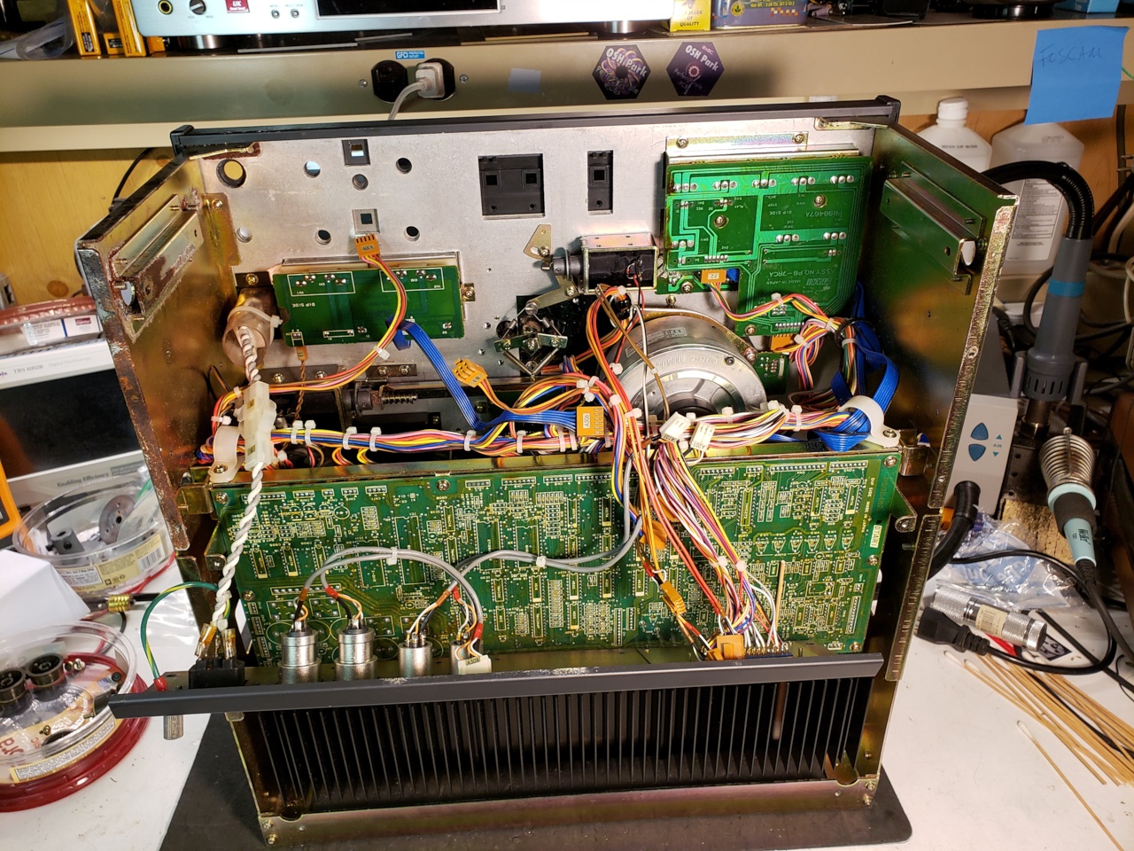

Hi Kevin,
Your MX-50N reminds me of working on the Tascam 80-8 in some ways.
The PCBs don't look too bad. The metalwork somewhat worse. I'm sure that electrically it will clean up fine. Some of the metal will need a good sanding. A repaint after sandblast would make it look new-ish again. I'm pretty sure tht it will perform very well once you're done Kevin.

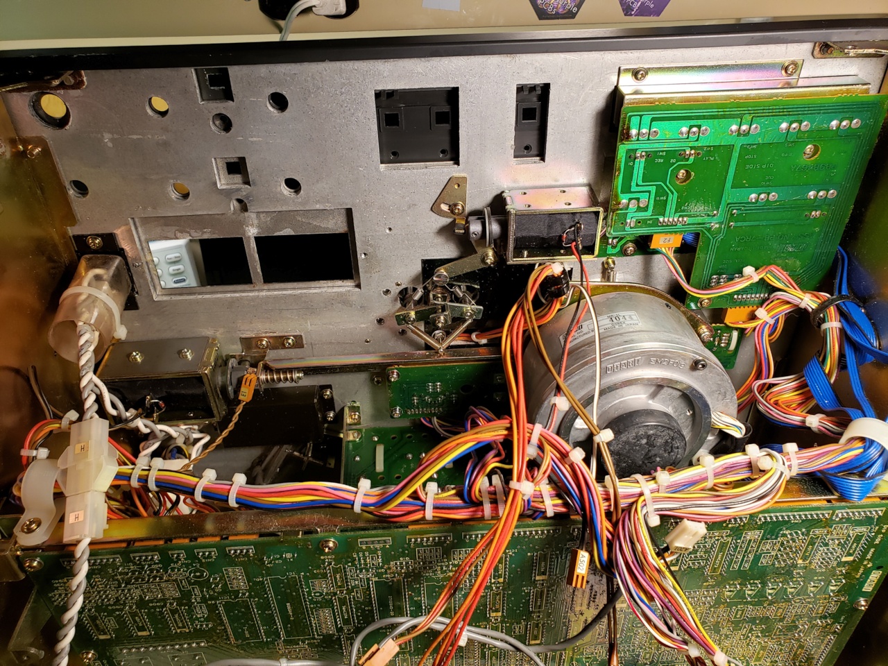

They are not too difficult to take apart to service. The MKIII-2 is the clear winner in this regard if it is installed in a cart - just remove the audio module or flip it over to gain access to the transport electronics.
My MKIII-2 was destined for the scrap heap and after a lot of relatively easy and trivial work/modifications several of my friends agree it is the best sounding deck I have and overall is a pretty nice machine. It's biggest downside is it's not very gentle, I do plan to reduce reel motor torque a bit in the future.
The two MX-50N are more of an open question, my suspicion is that with the right heads and some additional mods they could top the performance of the current MX-5050 winner. (Or who knows, I'm not done with that one yet either... 😛 )

Well after some listening it is pretty clear it is not quite in the same league as my modified MKIII-2, but we will see how far I can go with these decks. Most likely they would need comparable heads to the SAKI heads on the MKIII-2 and I am not sure whether I can procure more or not.
Edit: In direct comparison it's not all that close. The MKIII-2 is actually a lot better, but it has special heads and rather a lot of modifications. I hope to close the gap a bit at worst and achieve parity at best. I will perform the same modifications where applicable.

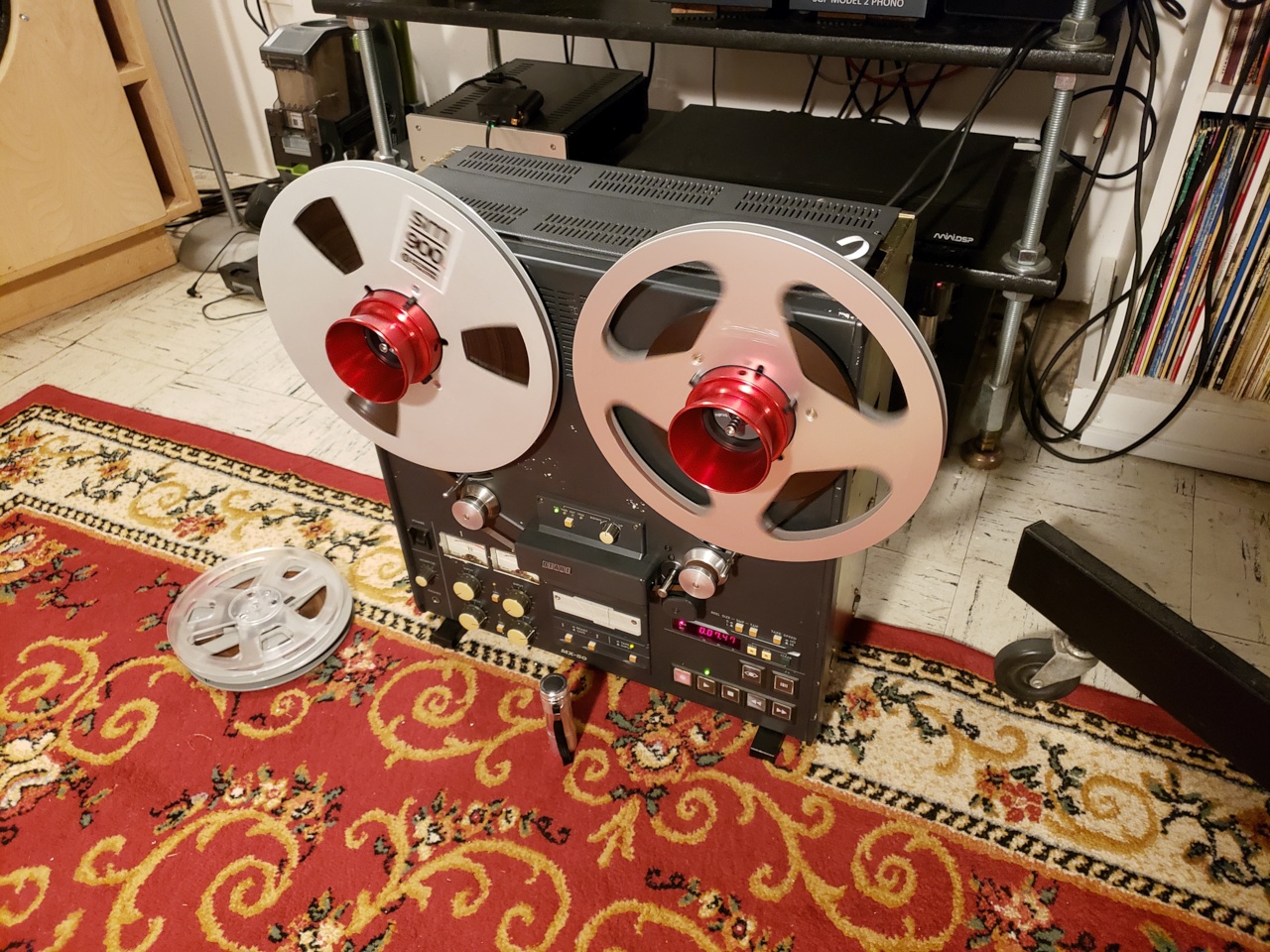

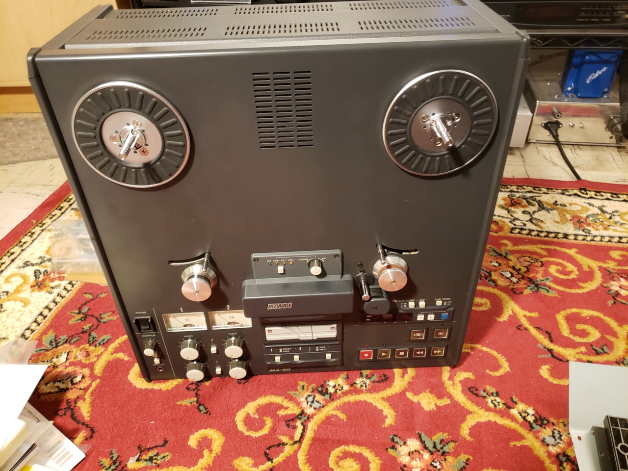

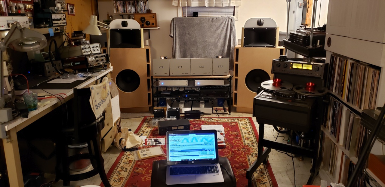

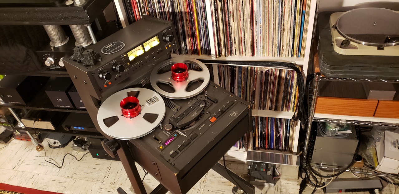

Here is a shot of it running.
I ran it at both 7.5ips and 15ips and observed no problems.
Brakes do not work any better than MX-5050 even with the retrofit, but they do work.. Overall it is gentler to the tape, smoother and better damped switching between modes and stop.

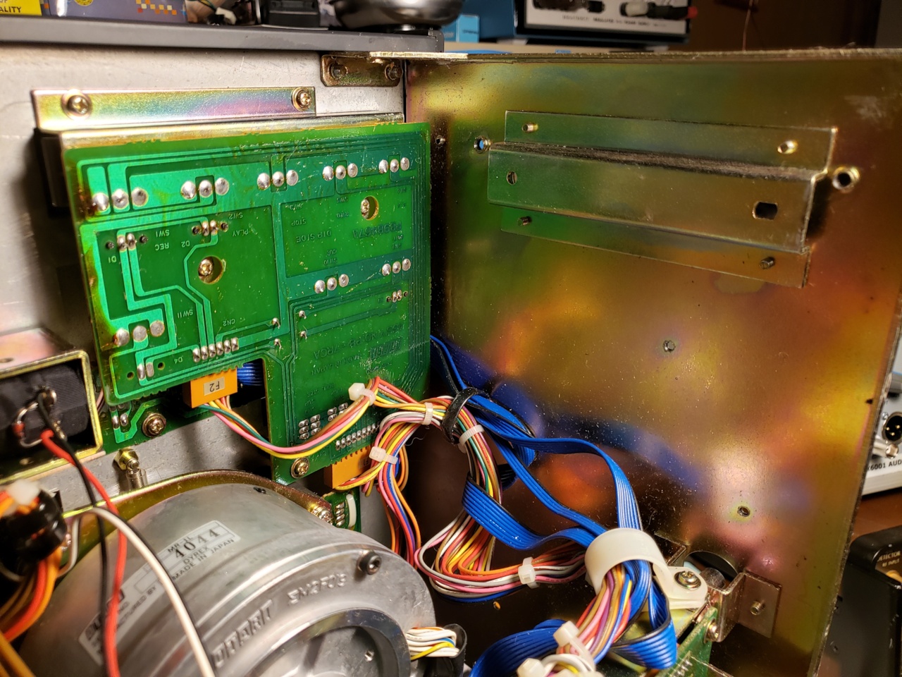

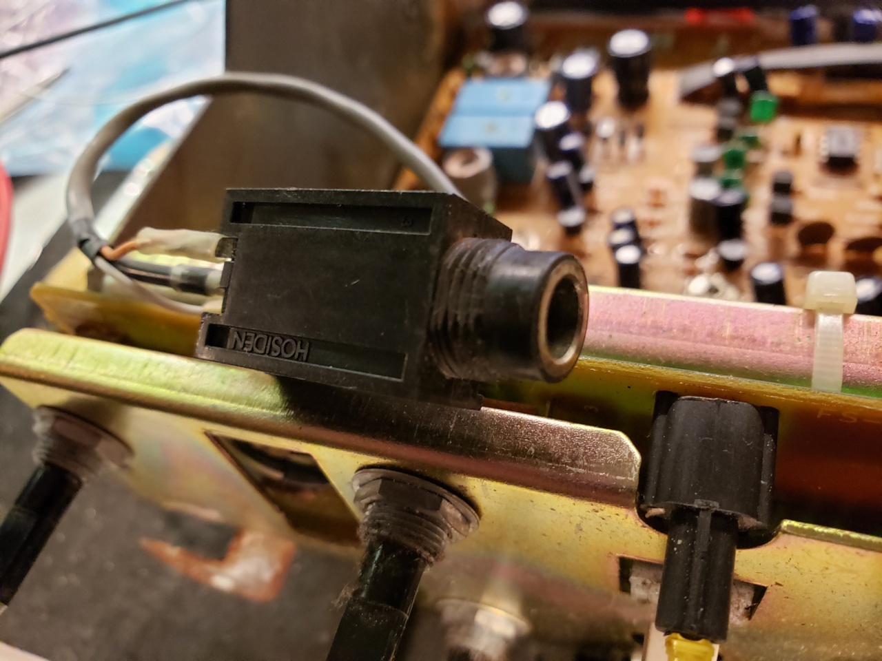

I am now turning my focus to the MX-50N with water damage that I picked up a week ago. Just finished cleaning the bottom of the audio module PCB.
It is lovely to discover that I may have difficulty replacing the corroded headphone jack because apparently no one makes one anymore that fits and is isolated. I will have to keep looking.

Hi Kevin,
Nice!
How about a picture of the headphone jack. Also, if you need the isolation a more modern plastic jack might fit.

It was a very common part made by Hosiden so I'm going to have a look over at DigiKey and Mouser. I looked on eBay and did not find one, but I need to look some more.
It may even be salvageable but I'd prefer to replace it, the nut and washer are seriously corroded.
The sad irony is not too many years ago I am pretty confident I had a couple of these knocking around. Pretty sure I gave them away.
Hi Kevin,
I've seen a thousand of those on different pieces of equipment. It is entirely possible that they are NLA, but you could use the nut and washer off a different jack if you can clean that one up.
