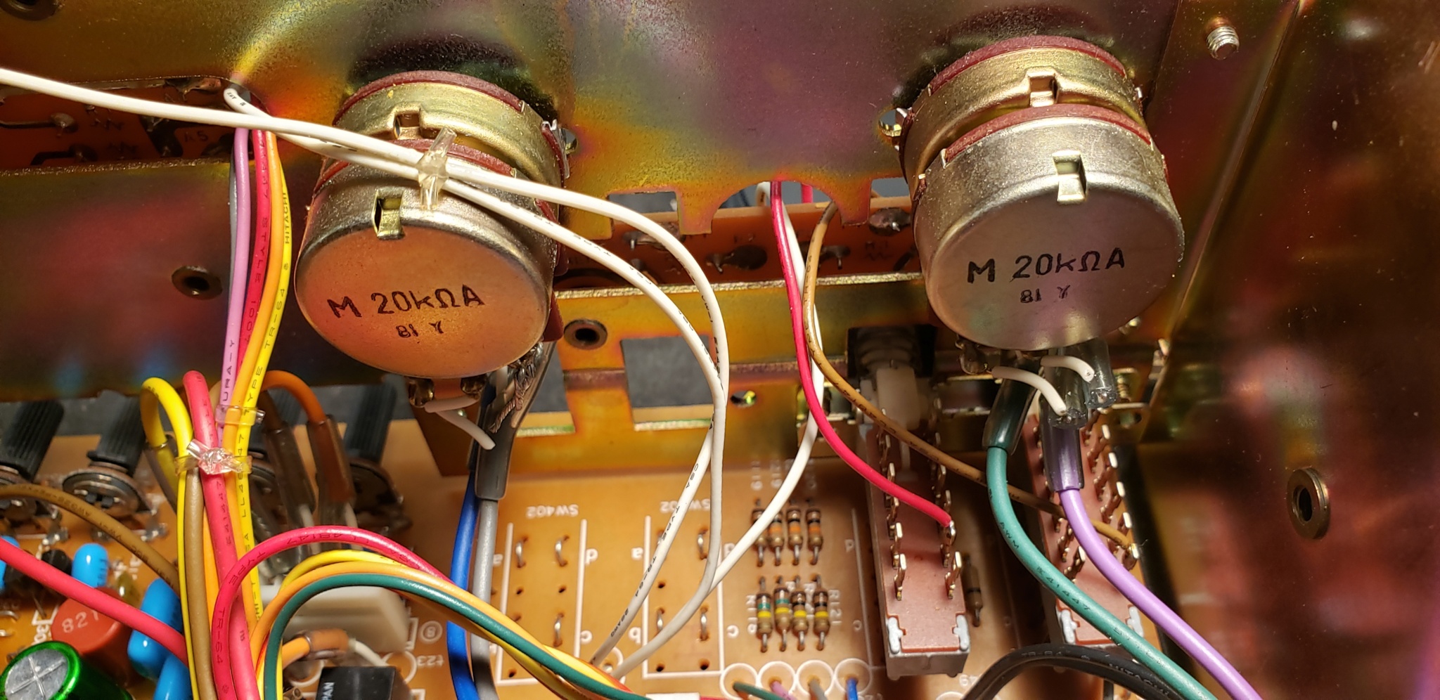

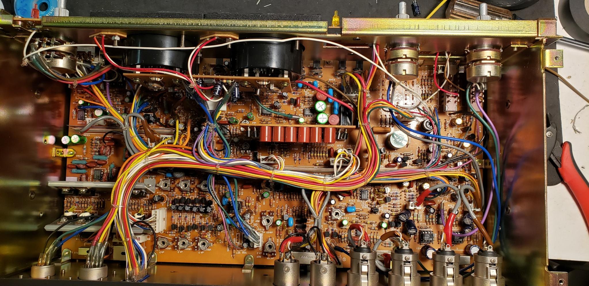

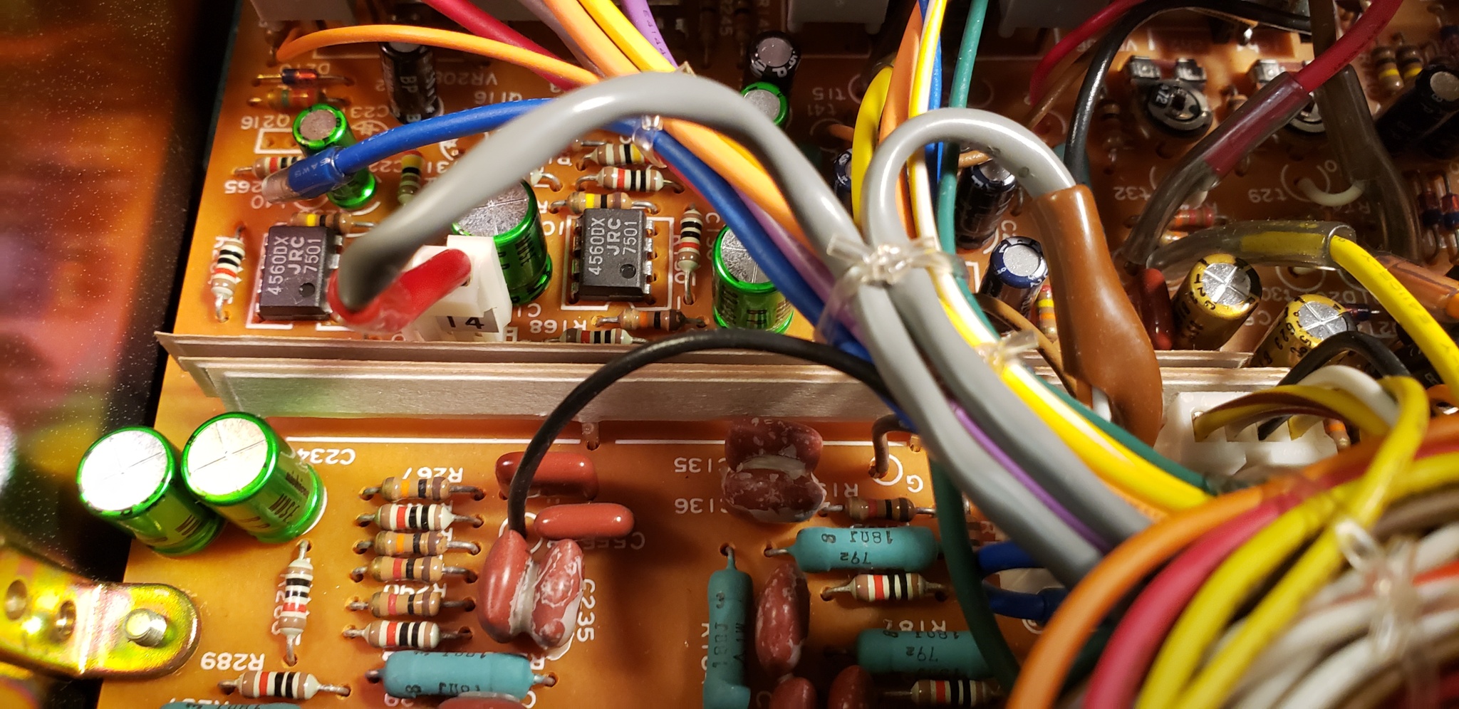

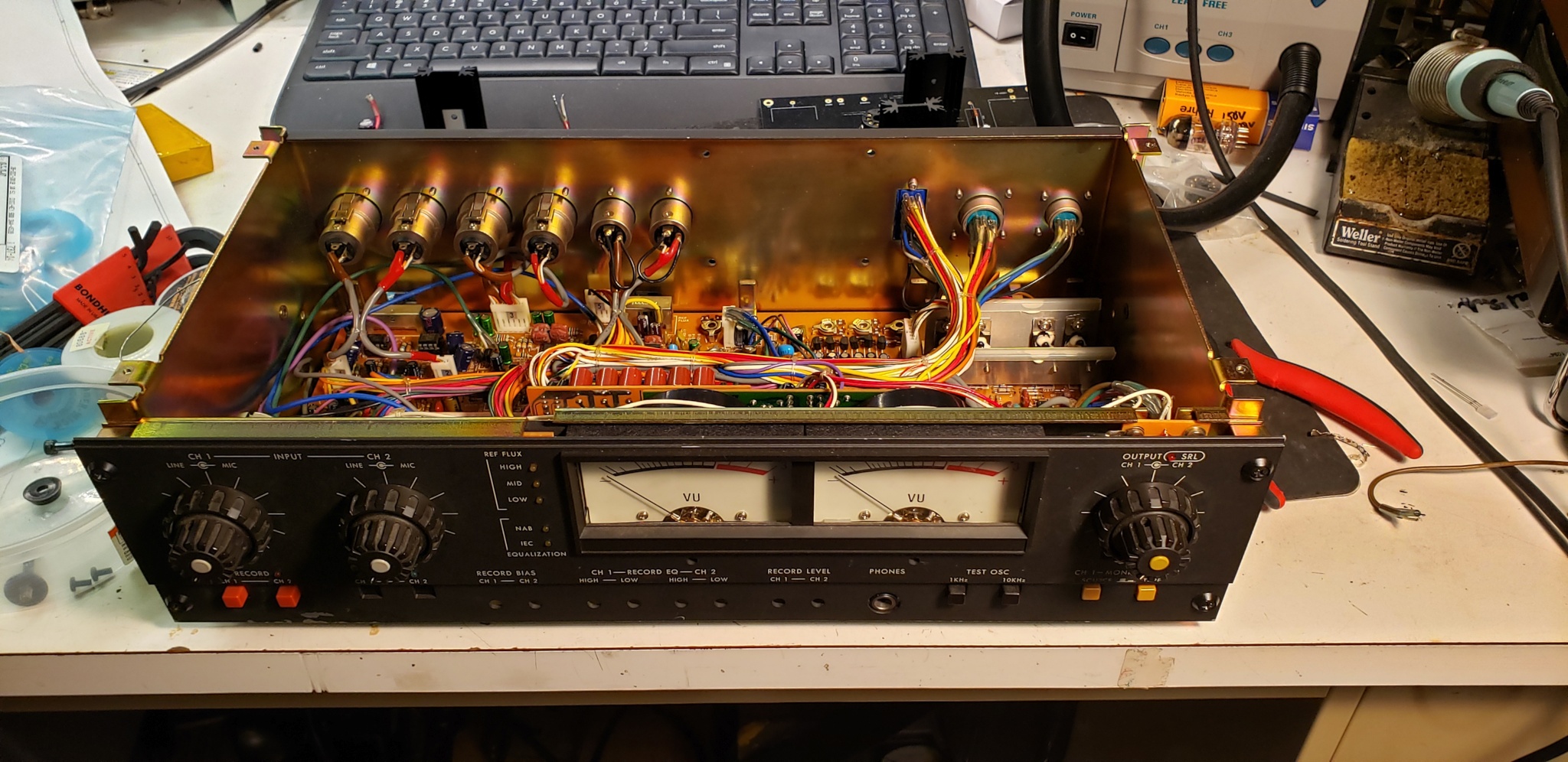

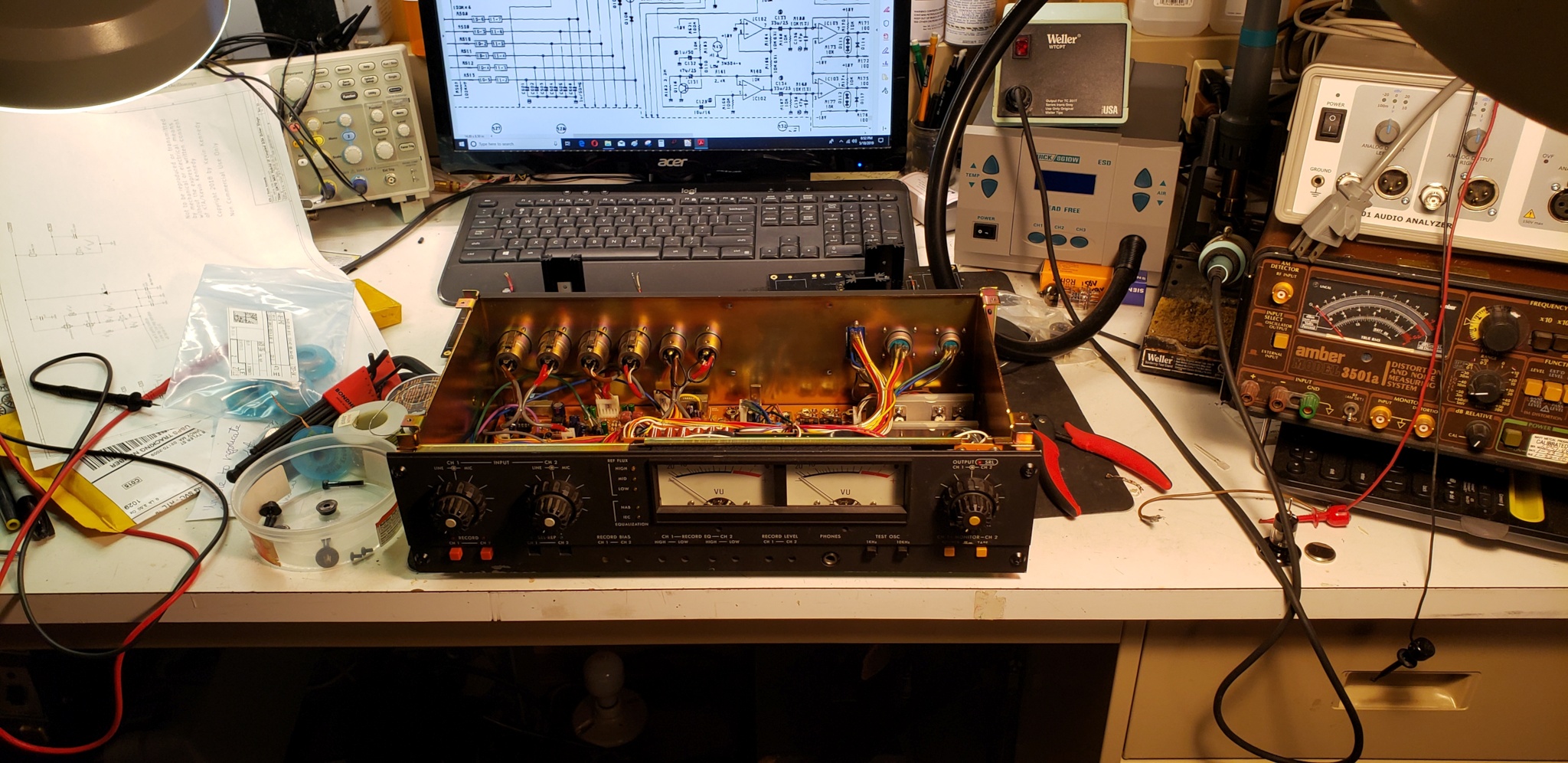

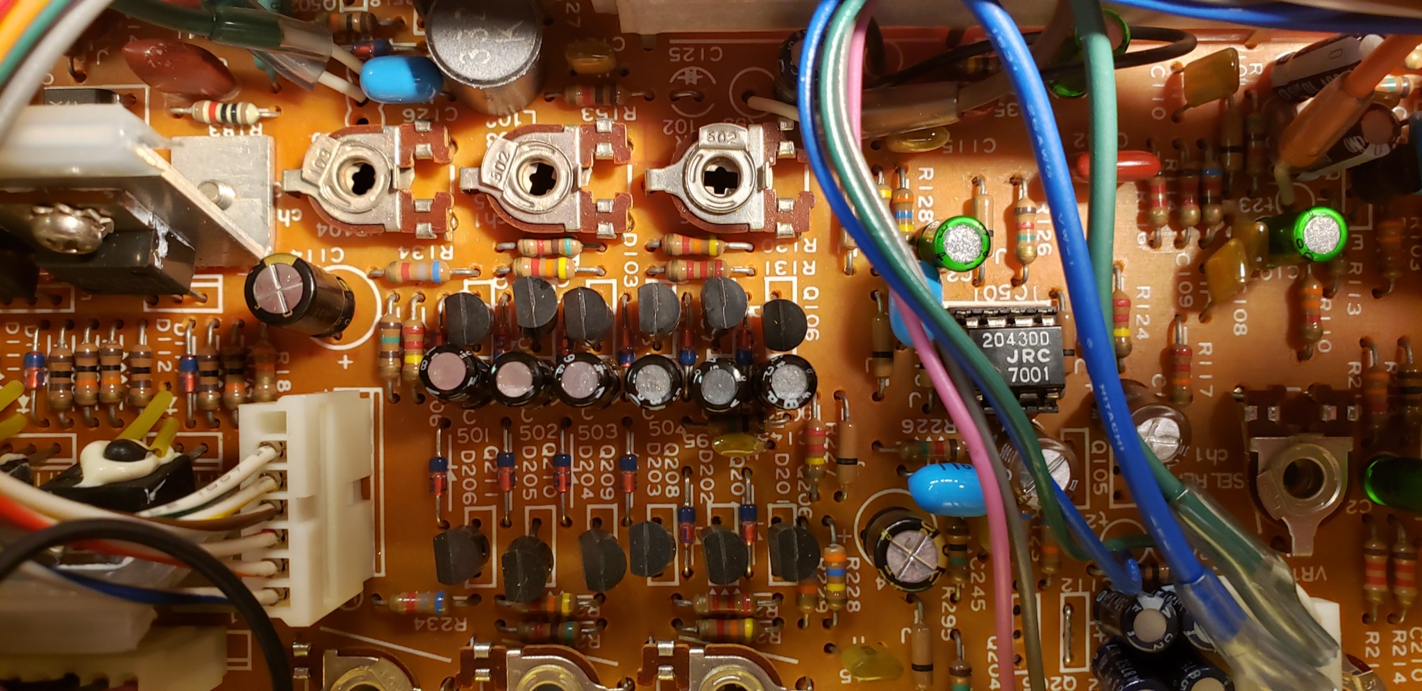

I completed some more cap replacements and changed a few things. (Noted in previous post) New photos..

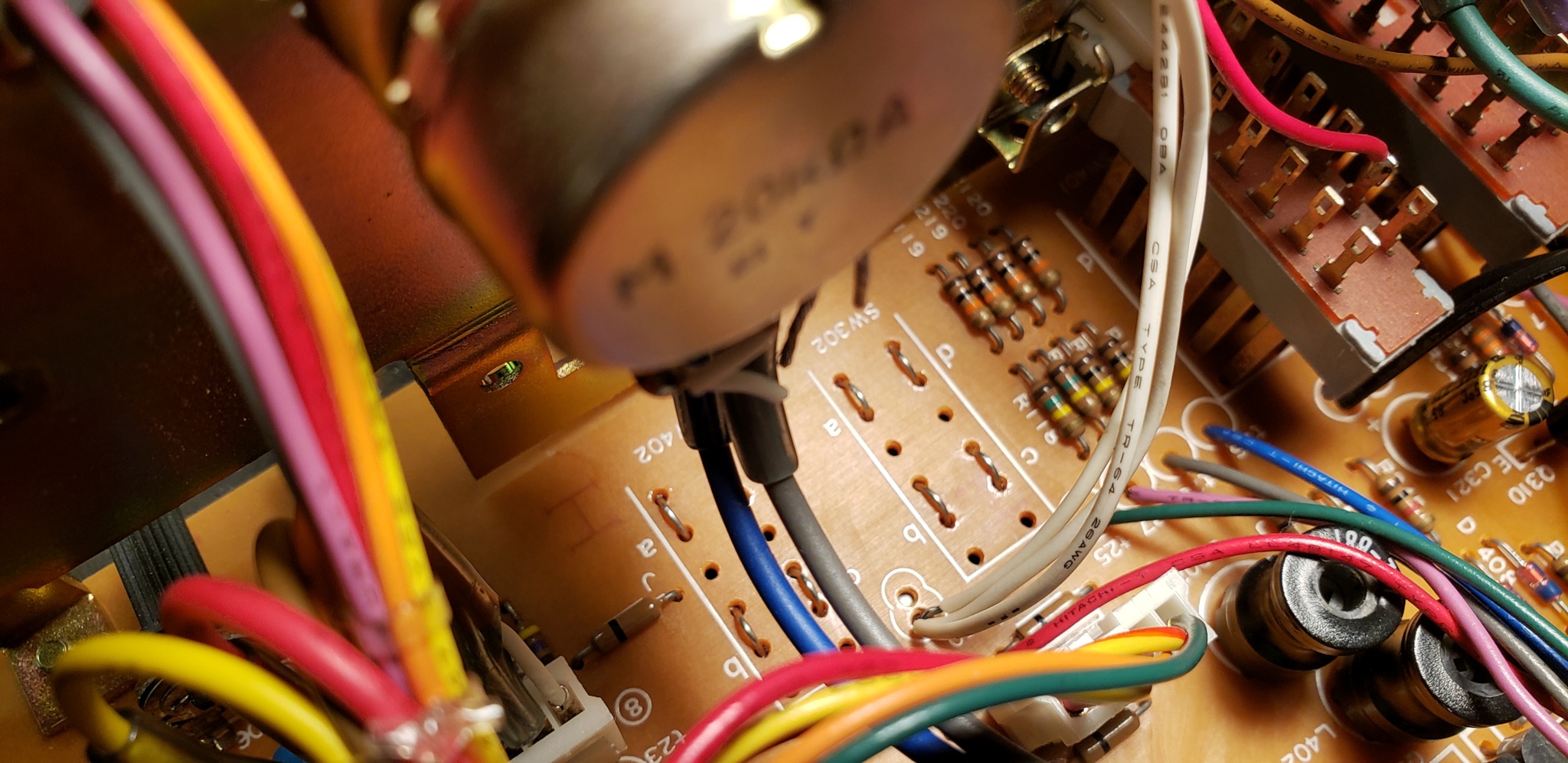

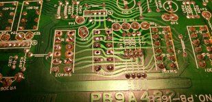

Removed some switches and a few more transistors.
There are a number of shots relating to removal and bypassing of the SEL REP switches (SOS, etc.)

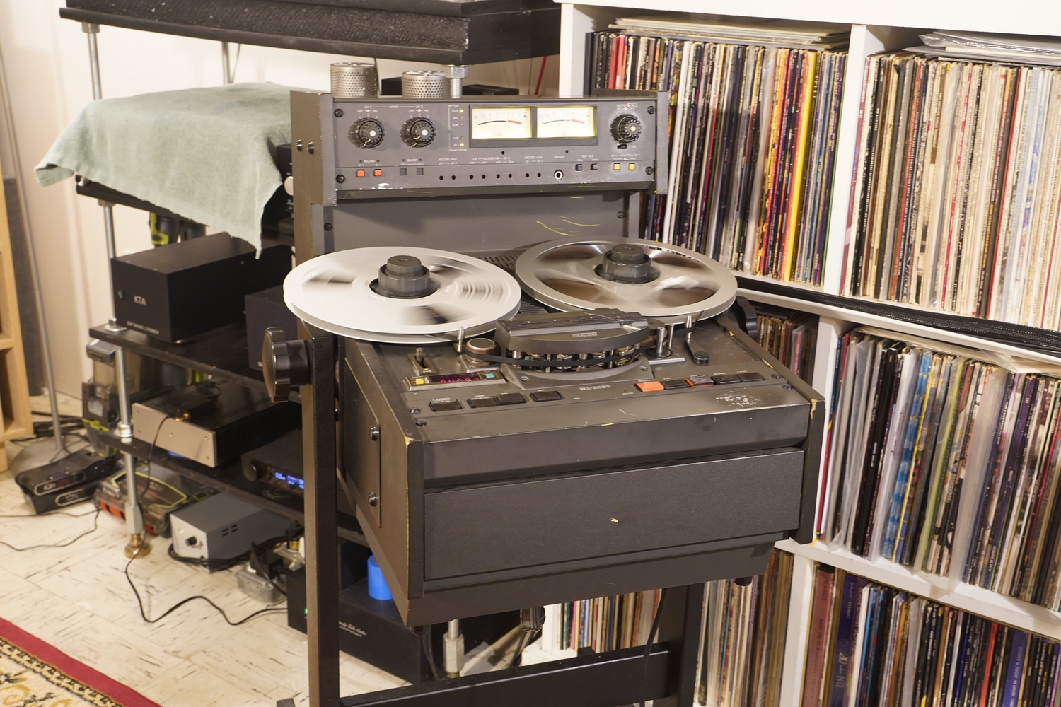

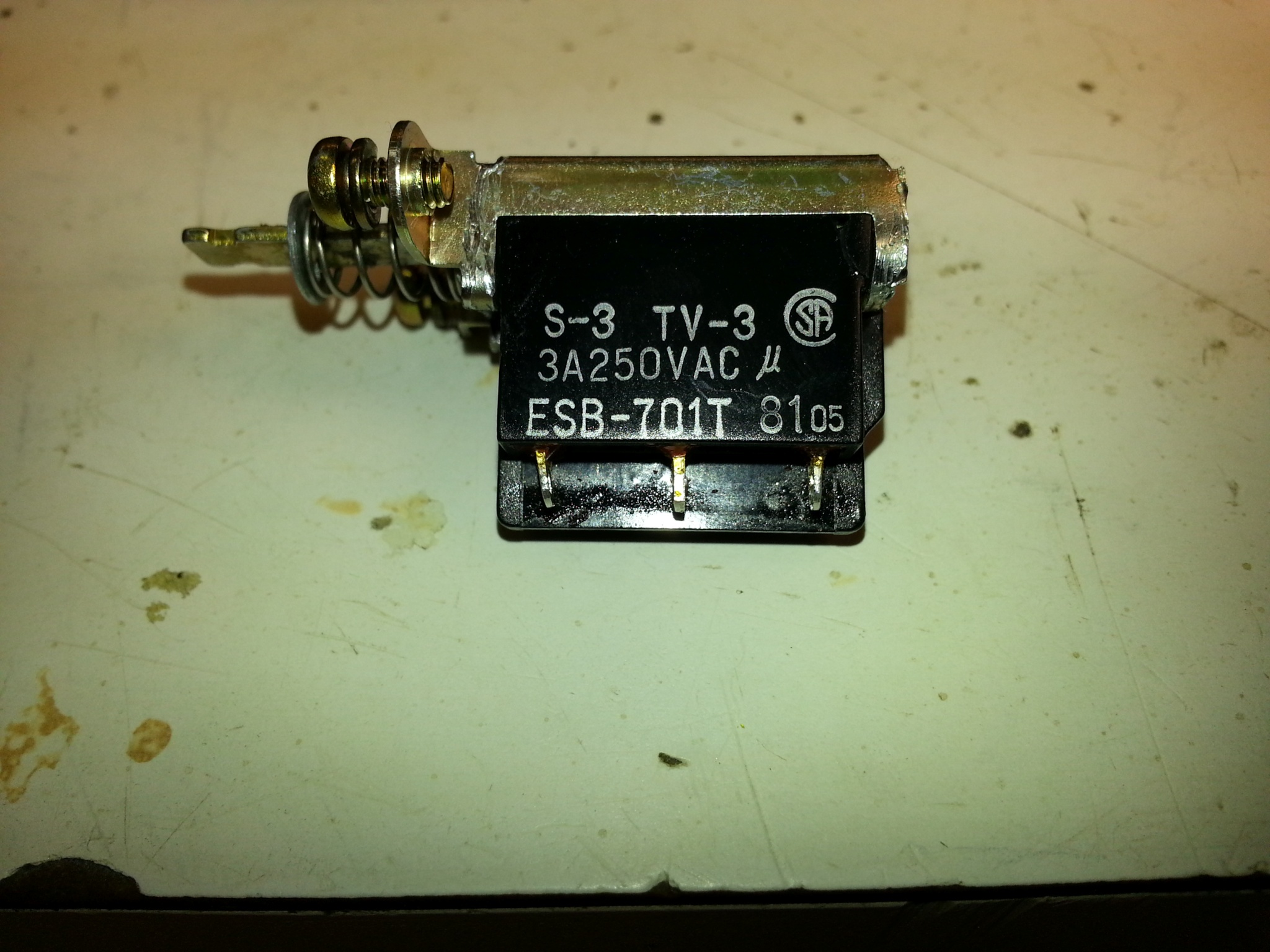

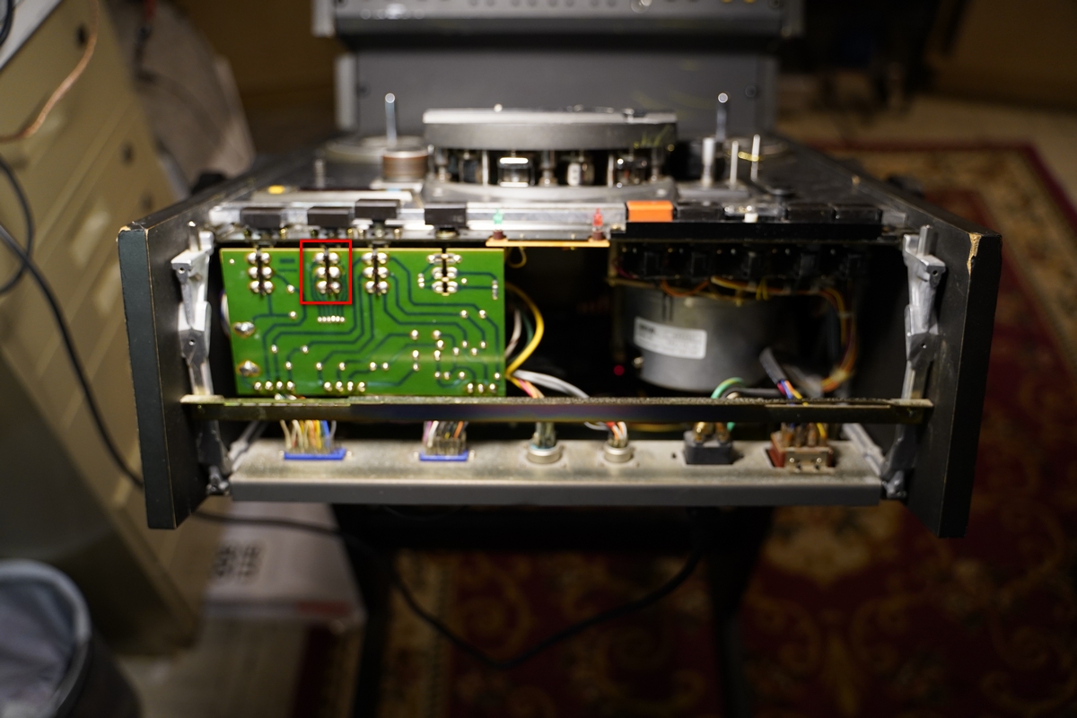

Otari Switch Problems (Panasonic Switches)
The Panasonic ESB-701T was used to switch power in the MX-5050BII series as well as the MKIII. It was not used in later decks, and was probably used in earlier models not familiar to me.
These switches were used to switch AC power where they usually, but not always hold up well. Where they fair less well is in logic level applications - tape speed/reel size/edit where their use was inappropriate as they were not designed for switching low level signals - predictably the contacts oxidize or the goo they applied to the contacts hardens with age and the low operating currents render the switch inoperable.
These switches were discontinued decades ago, new replacements are almost impossible to find and go for stupid money when you do. Purchasing board assemblies that contain them seems to be the best way to get replacements. This is what I did - the tape speed switch on my MKIII was bad, low speed worked, but high speed was at best intermittent and basically did not work.
Here are some pictures of the switch.
Hi Kevin,
You're right. That is a popular old power switch. Power switches are not suitable for switching low currents either. Maybe you can use them to control signal relays? You can use a resistor or light bulb to draw current to make the contacts happier.
I am wishing you luck on this one.
-Chris
-Chris

All Japanese op-amps which are several notches better sounding than the TL072/82 series stuff you referenced. (No fet op-amps in this design)
Low noise JRC2043 in the tape pre-amp and JRC 4560 which are higher performance cousins (faster, more bandwidth, lower noise) of the 4558/4559 you are probably already familiar with. (They are admittedly mediocre by today's standards, but my history with op-amp upgrades has not been positive - some of the older devices sound just fine and replacing them with more modern ones has not resulted in substantial improvements in sound quality, sometimes unfortunately quite the reverse.)
Given the overall design approach I strongly recommend not changing the op-amps, I think given the complexity of the design and the lack of any decoupling at the op-amps this is just begging for trouble. This is a single sided PCB with relatively mediocre board ground - there are a lot of buss bars for power and ground.
Given the way it now sounds I also don't see a lot of reason to make the change. None of the JRC stuff IMHO is bad sounding - past upgrades of devices like dacs and CD players using these parts did not result in the sort of gains in performance I would have expected.
I suspect in a lot of ways this is a pretty studied design and was the result of a lot of evolution with small changes over the years.
Further improvement is likely possible but I will need to look at what's next.
Edit: You might be surprised but I am not a fan of the OPA2132 sound at all, much prefer the newer OPA1641 and 1642 to the old BB devices. It sounds too warm and slow to me.

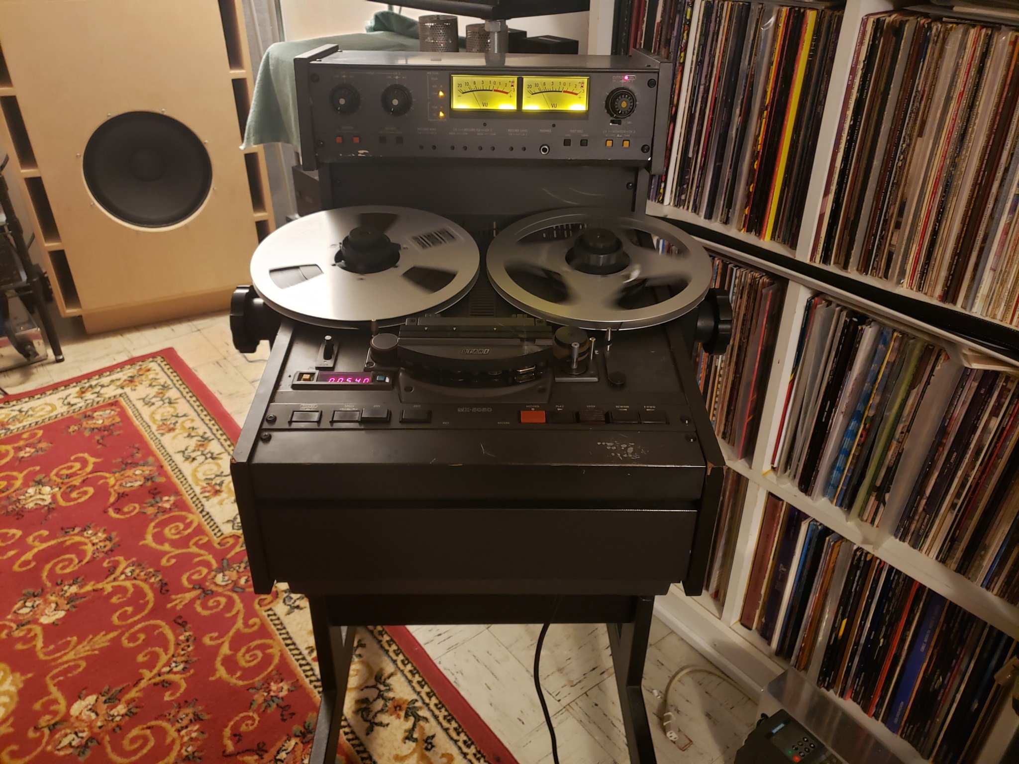

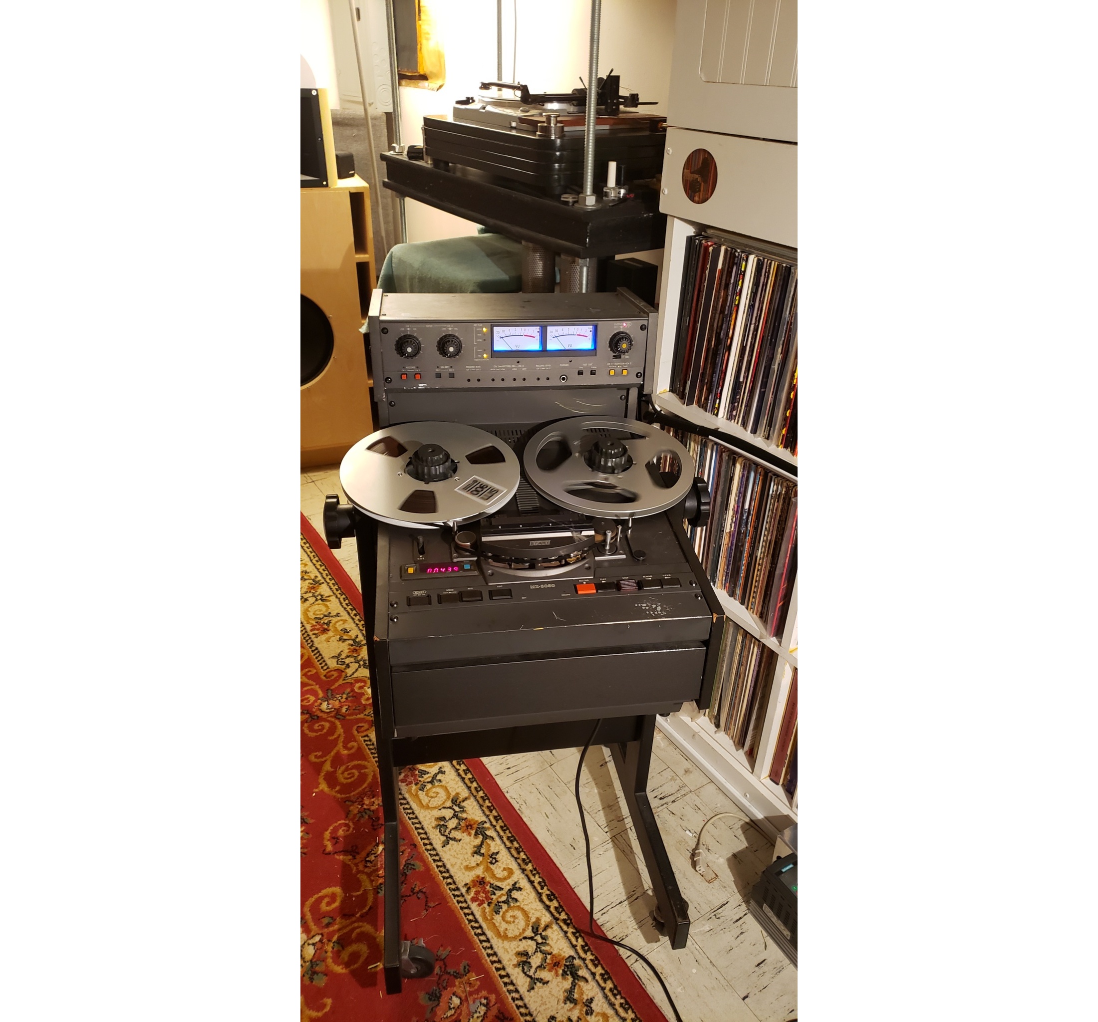

My plan ultimately for these machines is to use them for casual recording as I see fit, and for playback of commercial studio quality tapes I will start to acquire once I am confident that these machines will play them safely.

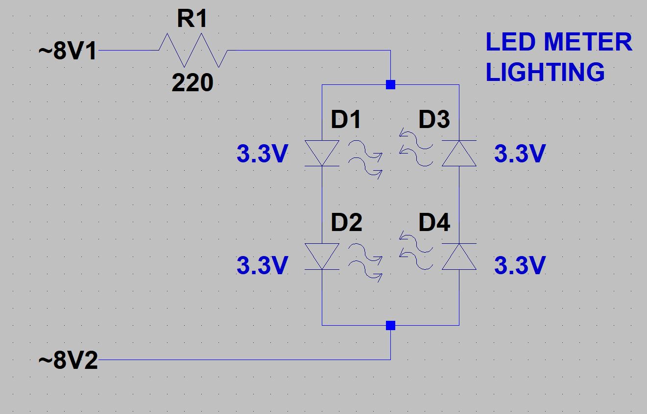

Replaced all the caps on the meter boards and swapped out the LEDS for warm white.. (They are very warm, but not quite as yellow as they appear in the photo.
Replaced a few straggler electrolytics. Most of the ones that are left are in the microphone pre-amp and since that is disconnected I think I will leave them as is.

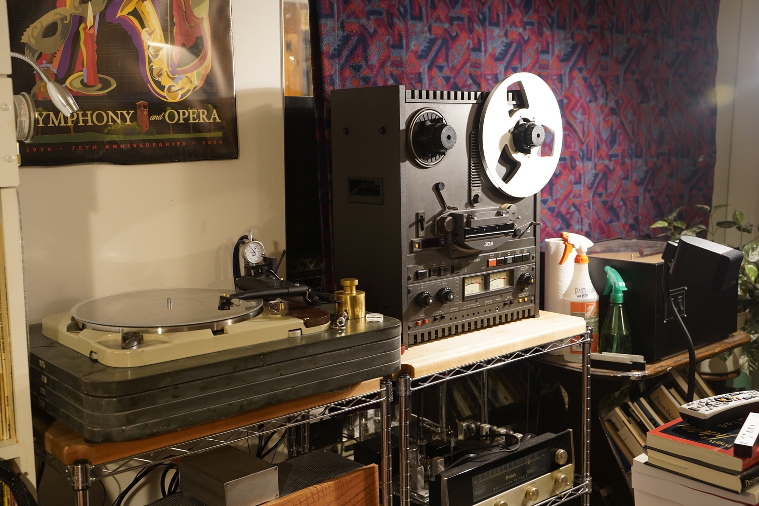

- Analogue Source
- So you think you want to play with tape: An Otari Story
