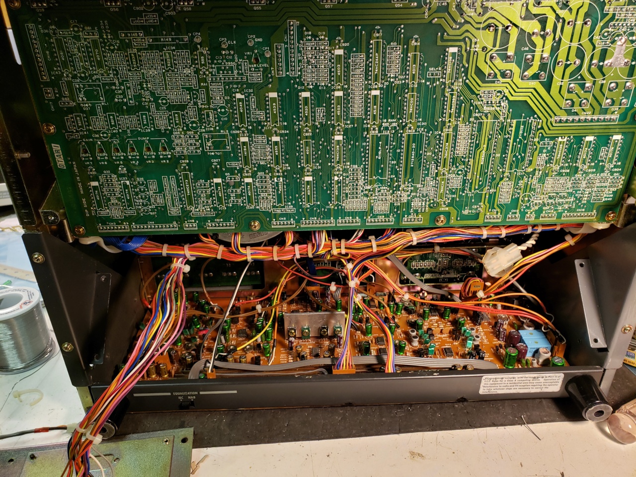

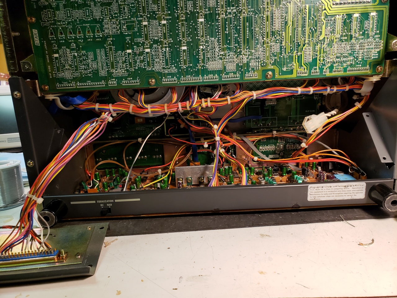

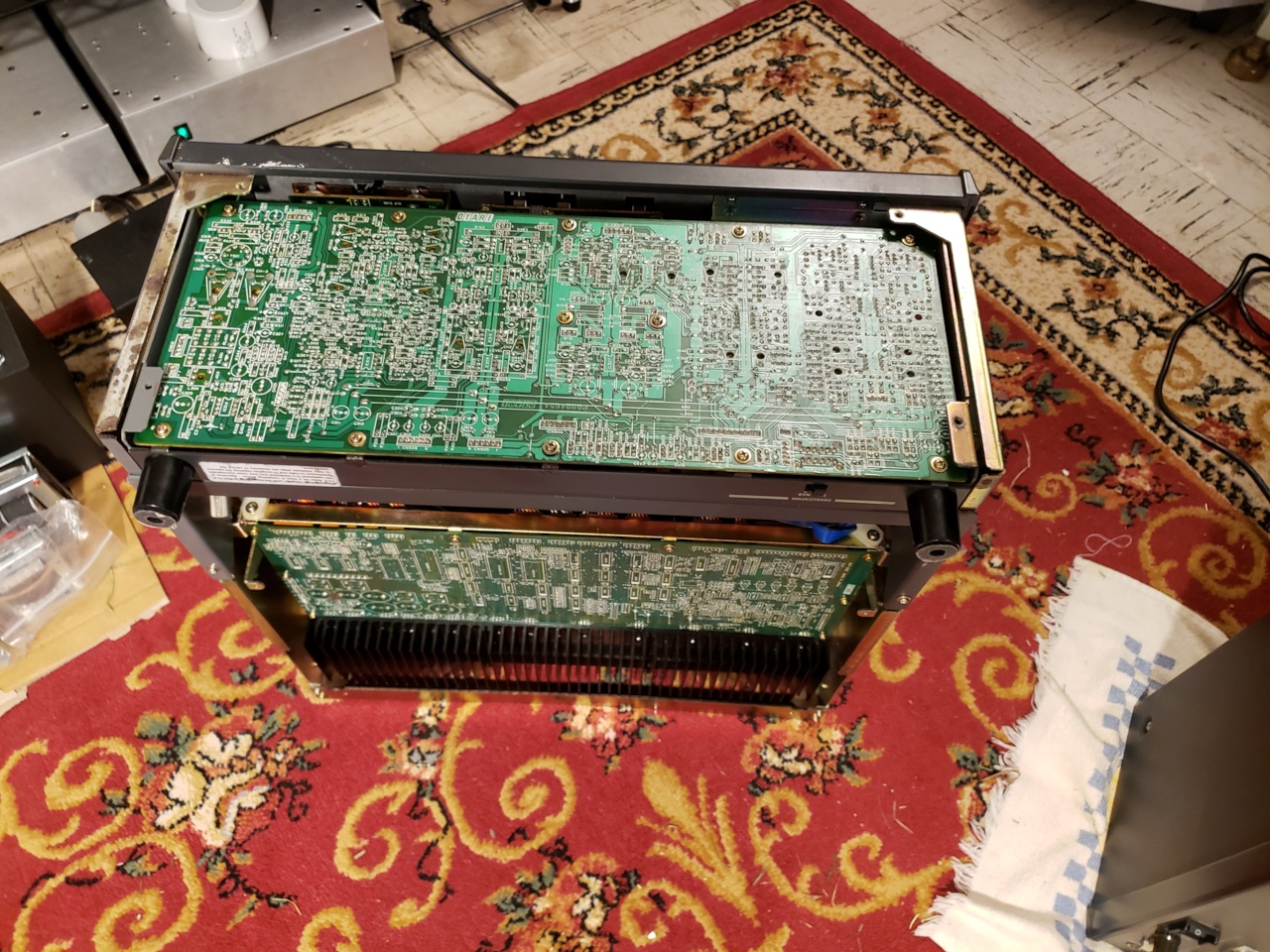

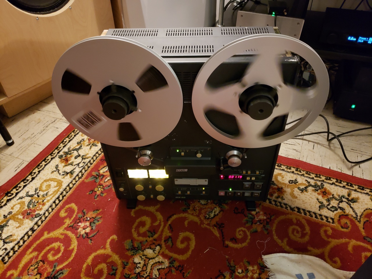

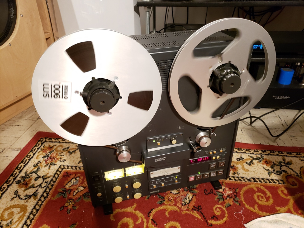

Well I finished putting the MX-50N (the one from NJ that got wet) back together tonight, and it's running.
The transport in this thing is in quite another league from the MX-5050, I'm quite surprised, and the overhaul improved its performance considerably despite the 95% electrical orientation of the work I did.
Every electrolytic in the unit has been replaced. I cleaned the boards scrupulously as I went. Cleaned the brake bands and friction materials, lubricated the capstan motor, and fixed a lot of corrosion damage.
Unfortunately the original reel tables and holders are trashed, not sure yet what to do. I am running MX-5050 tables and holders with shims (~10 mil tape) between the tables and holders which just allows me to adjust table height to spec.
It runs better at this point than the pretty MX-50N II, and unlike that deck everything now seems to be working on this one. (I have not yet attempted to record, but it does go into record)
I need to purchase calibration tapes at this point. Both of the MX-50Ns will need to be more accurately calibrated for IEC playback and record - this because the EQ is really only optimized for NAB or IEC and I have no idea which it was originally on either of these machines. I only use IEC @ 7.5 ips and 15 ips so those are the tapes I will purchase.
