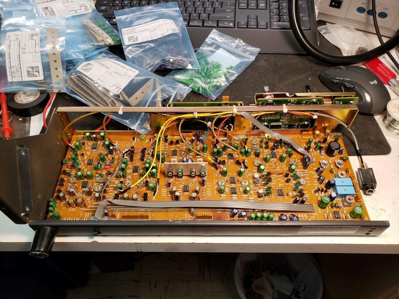

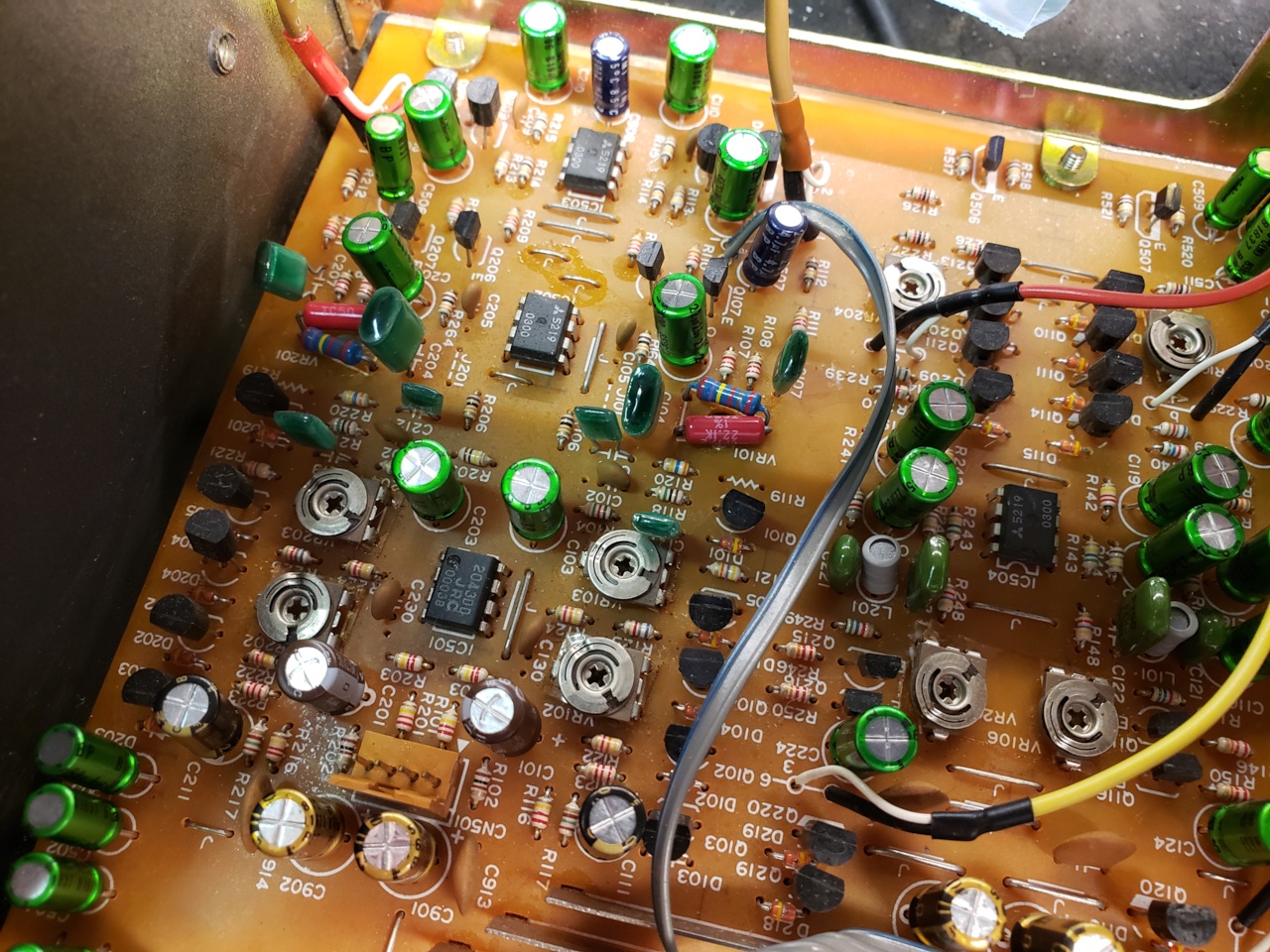

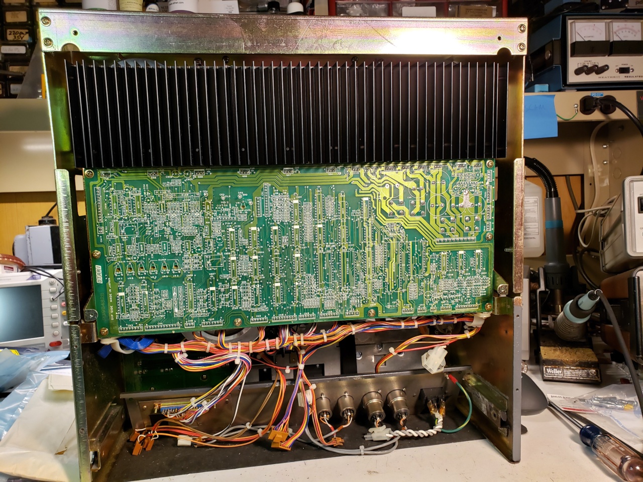

Some more progress to report on the MX-50N, today I replaced most of the electrolytic capacitors and modified the LF compensation circuit by replacing the pots with fixed resistors. Since I am not changing the heads on this machine this isn't a problem.
I have managed to keep the board clean as I do the reworks and determined that the SRL led that doesn't light is actually bad. I've ordered some replacement LEDs.
The sharp eyed will notice a trace or two that appear funky due to a discoloration of the solder mask - I initially thought these traces were open, but careful checking reveals they are in fact just fine.
Early next week I should have the remainder of the capacitors required and will re-install the audio module soon.

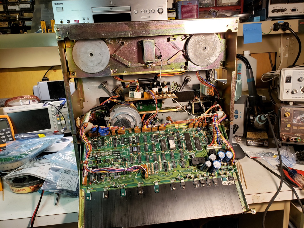

I will move on to cleaning the logic PCB and then replace all of the electrolytics on it as well.
I have cleaned up the corroded components and used a rust inhibitor and painted them.
I actually will have a parts unit soon, so I may swap some parts.
In other news an MX-55 could be headed this way - no idea where I will store it until I can look at it. A friend has one that needs a new home, hoping it is an N and not a D version as the D is a huge bridge style recorder and I can't fit another one. (The MKIII-2 is enough)
The damaged MX-50N is not going to be cosmetically restored although I will do my best to prevent any further corrosion damage, and some components if spares become available may be replaced.

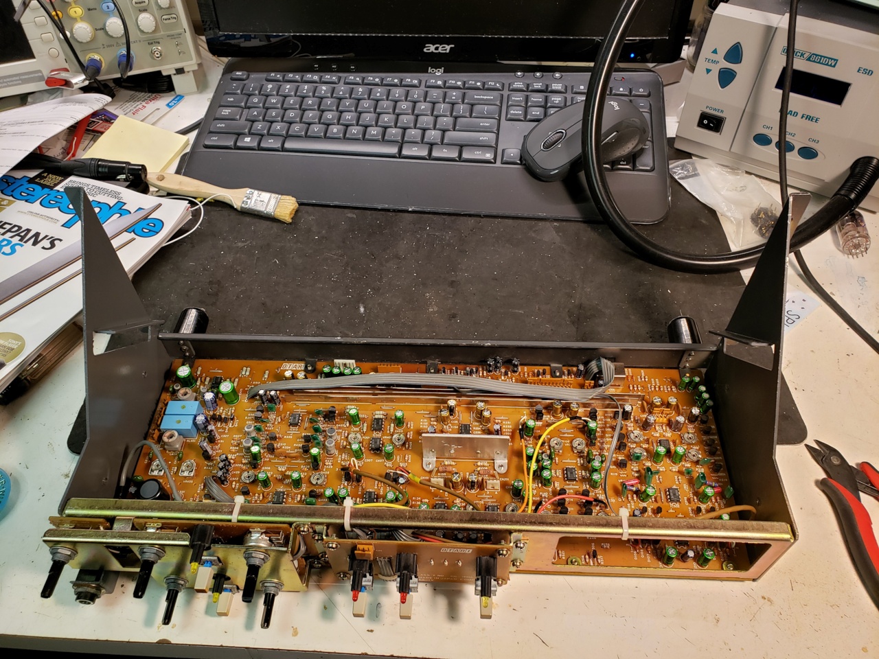

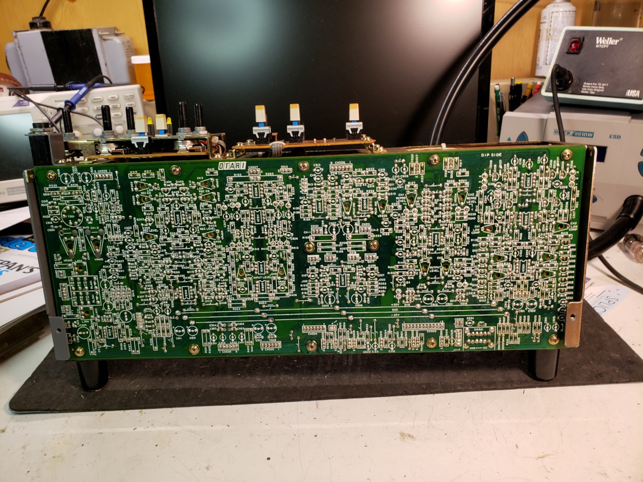

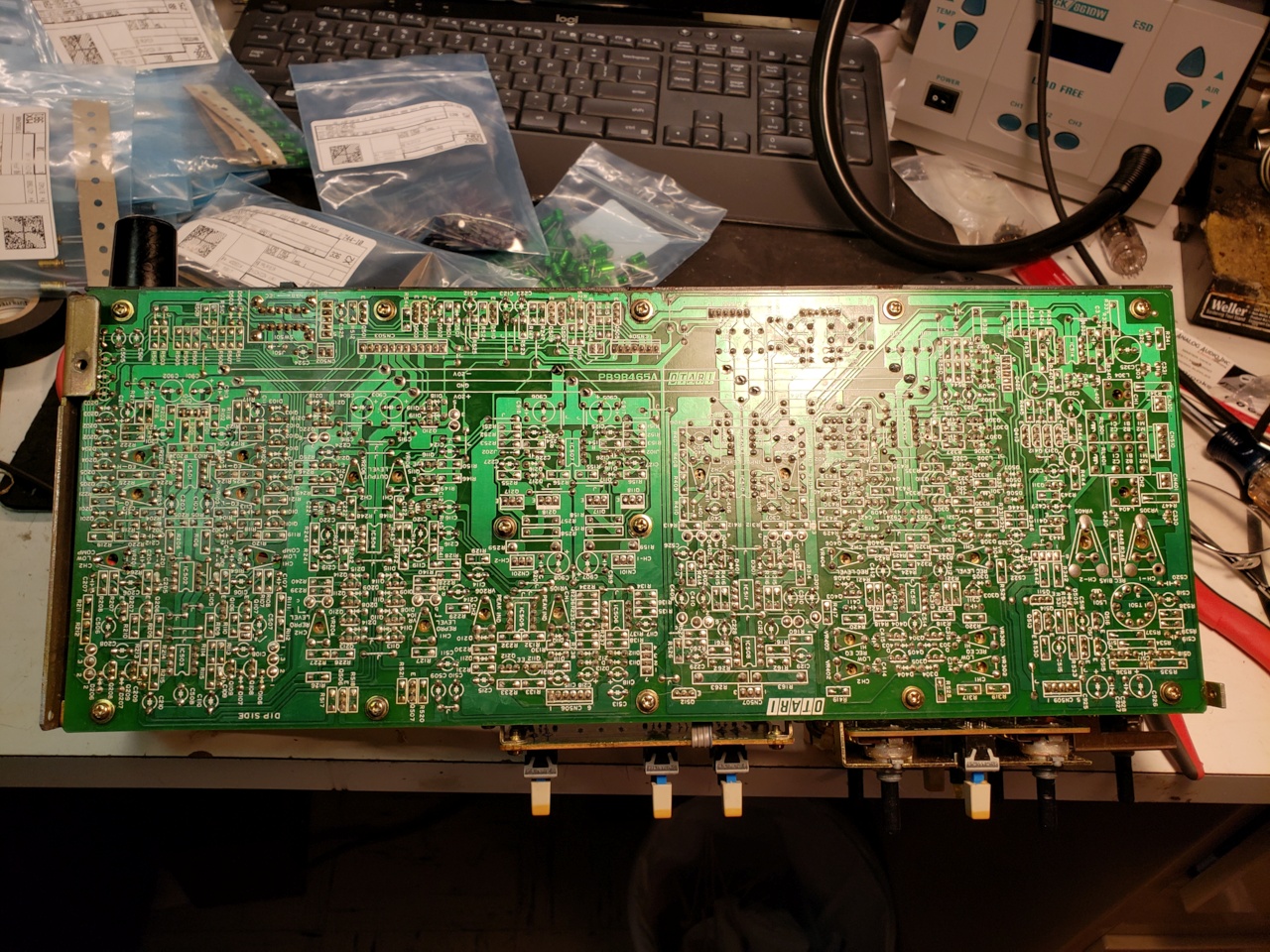

More recapping, just missing a few finally, and a lot of cleaning. The residue on the back of these boards seems like it's solder flux, but that would be uncharacteristically messy for Otari. It is very soluble in isopropyl alcohol.
There is nothing vaguely similar in the 50N II so I have to assume it's something else.
I've spent a lot of time dealing with the peripheral corrosion damage.
Looking forward to putting it back together and determining whether it runs correctly, if not some troubleshooting will follow. Hopefully the remainder of the capacitors (4 pieces, 3 values) will arrive in the next couple of days from DigiKey.

I've been offered a parts unit 50N and an MX-55 which I will look at this week-end. All of this of course begs the question of where I am going to store them.. LOL
The last caps required for the 50N recap arrived today, so tonight I will install them and start to put it back together. Hopefully I haven't broken anything..
