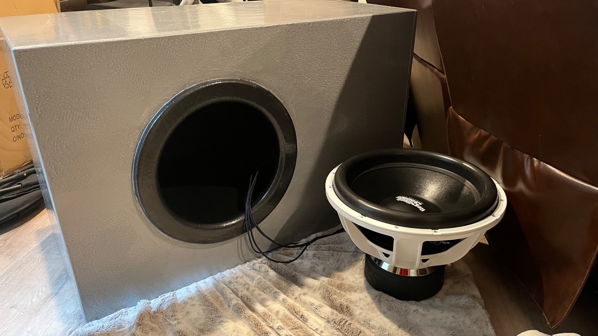

…Comically large port. That’s a monster 18 for reference. It doesn’t go in that box it’s about 7cf too small for an 18… also the wires are only there because I haven’t decided where I want the terminals to be yet. That port area will be breathing at about 30m/s full tilt 5kw at 26hz.

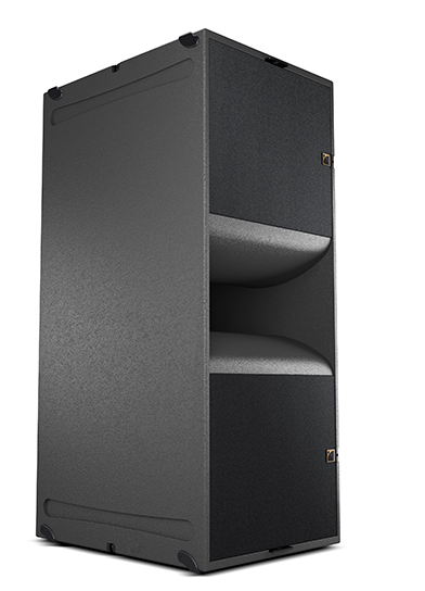

I mean double side flared rectangularish like the KS28what about a rectangularish port a la KS28 ( L. Acoustics)
I guess since it’s just a large sphincter the width of a few pieces of plywood instead of an actual ‘port’ that would drastically lower tuning and output for the already gigantic box ?
I guess since it’s just a large sphincter the width of a few pieces of plywood (like a ‘loading wall’) instead of an actual ‘port’ that would drastically lower tuning and output for the already gigantic box ?
(Like a loading wall)
Maybe , something like this

Naw, stick with your unique TH.
It needs a name.
What's funny is the enclosure looks like a front loader washer or dryer, yet it's not a FLH.

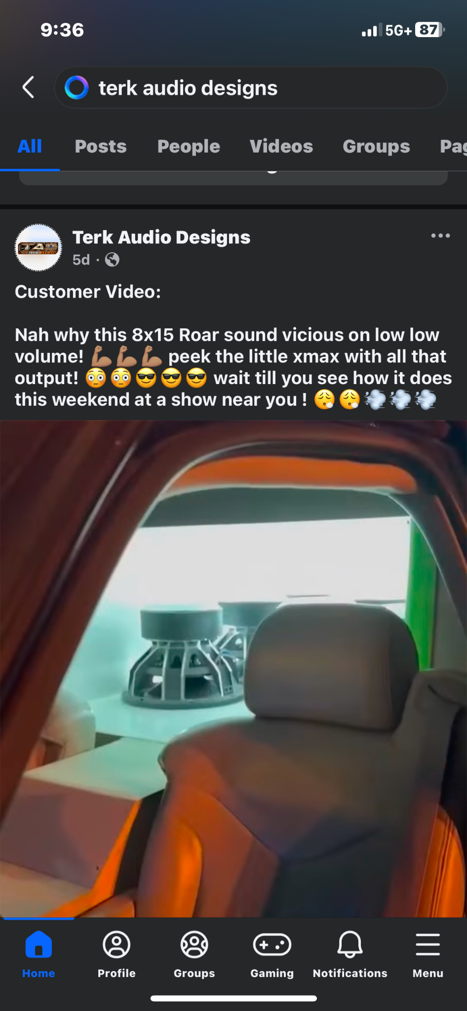

FLTH, The Cleaner, The Blower (30m/s), The Loader, The WhirlFool, The Mouth Gap, The Whirl Series (BP6S), The Mach Mouth, The Tommy Done (shoutout to Tom Danley), The Formidable (shoutout to GTF), etc.
It needs a name.
Sorry if I didn’t make it clear enough before but this design has already been established by circlomanen. It’s an hroar. I said it in a few posts including the original post when deciding what I was doing. I mean all the dimensions and pathlengths are unique but hroar is his design.Naw, stick with your unique TH.
It needs a name..

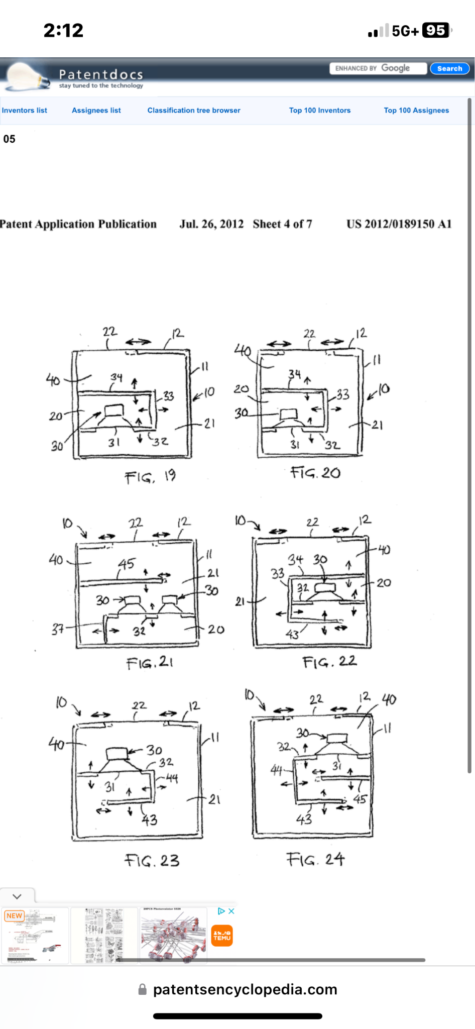

There’s a few ‘ROARs’ out there and keeping the name (instead of just saying series qw resonators) out of respect for the Swedish guys that messed around with them and showed us interesting ideas
23 and 24 are type O and A paraflex, but scoot the exit down further and it’s ‘roar’ etc
If you make a big csa change (impedance change ) at the other side of the driver it creates a new resonator ?? . Pretty cool

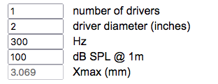

Assuming the CDT Audio Unity could do 3mm excursion without garbling the HF beyond recognition, the 2" model could do ~100dB:

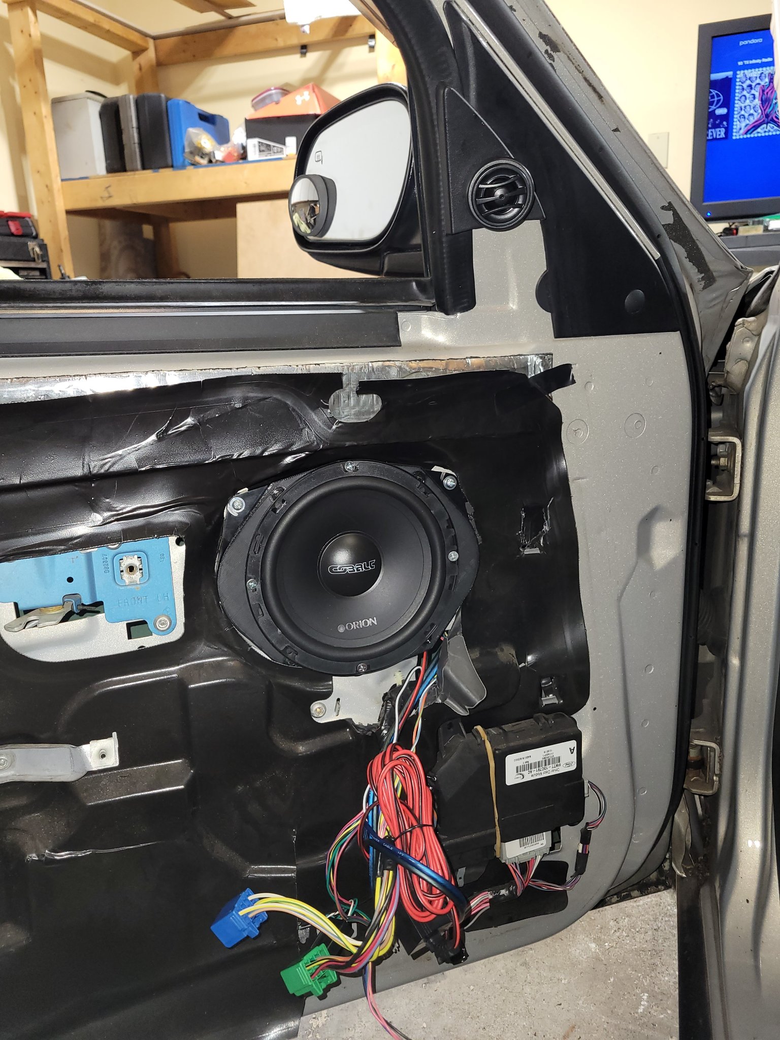

I converted my front door 6x8 coaxials to 6.5" components.I have a question you all may have experience with. I have 6.75 rear doors 6x9 front doors and 2.75 dash speakers. I’m going all cdt audio for the speakers (if you don’t know about cdt, now you do. You’re welcome.) questions is what would be best for clean clear soundstage? Coaxials in the doors or just bass? I’m thinking use the unity speakers in the dash to cover 300-50khz. how do you suspect it would muddy the imaging to have tweeters anywhere else? I’m thinking about not running any in the rear either.

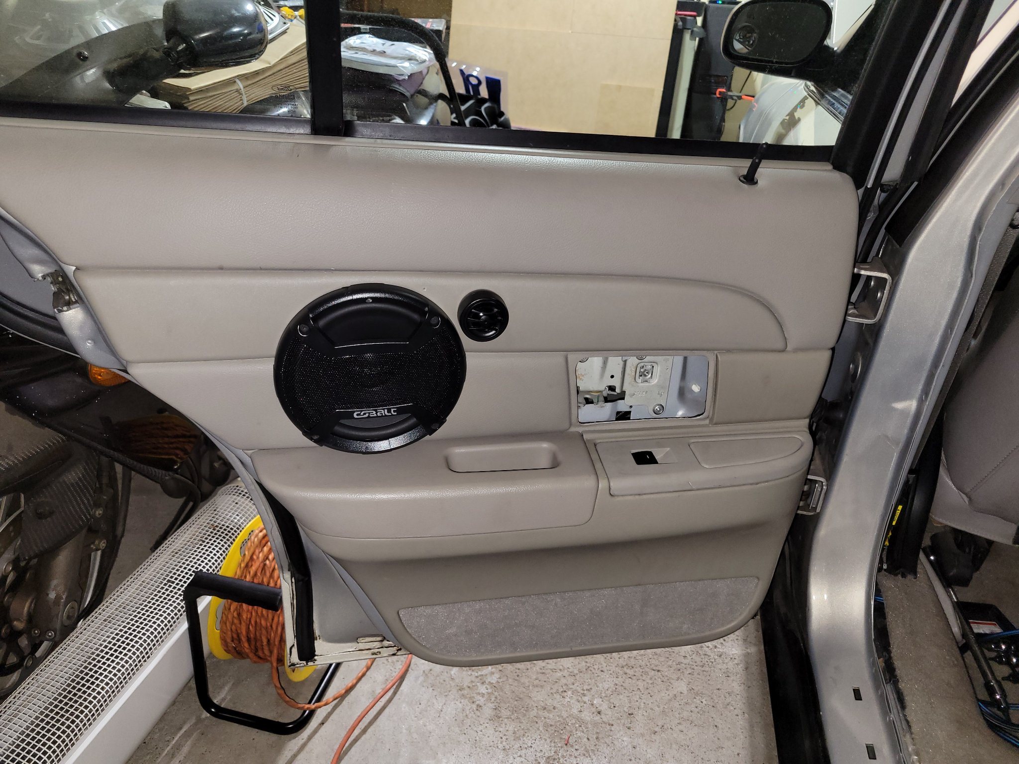

I removed the 6x8's from the rear deck so the trunk can breathe and put 6.5" components on the rear doors.
Just midbass in the front doors if you are doing 300hz and up on the dash.
