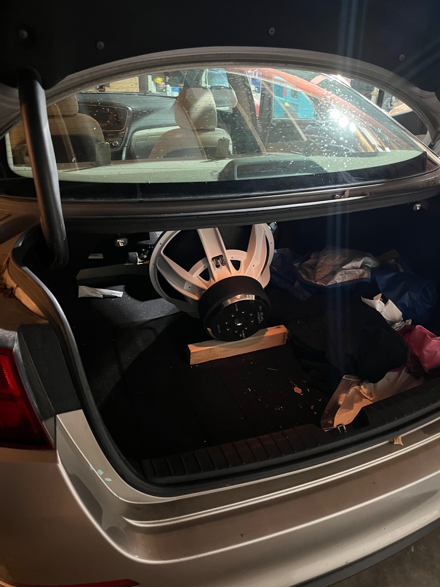

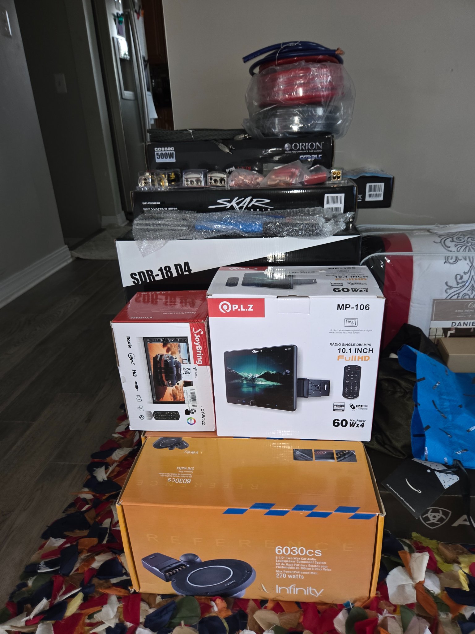

So i impulse bought a sub. What would you do with it?

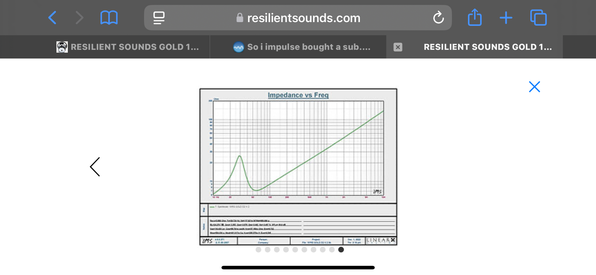

(I’m Just guessing). I Can’t read much of anything on the website on my phone it’s all ā€˜blurry’
https://www.resilientsounds.com/product-page/resilient-sounds-gold-18-v2

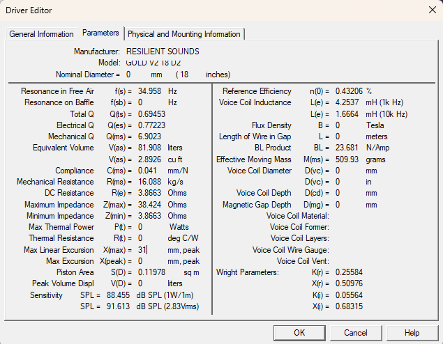

yep. heres the parameters fresh out of the box.
the suspension is incredibly tight on this thing right now. i expect it will fall in line with the website specs pretty closely but it will take a lot of time and power. my crown amp hates it in free air.
^^^FYI that was supposed to be self depreciating humor^^^ my wife reminds me all the time I’m an a******* lol. Also these are the specs you saw on the website
Reyc=3600 Qhm Fe=29.724 Hz Sd=117021m M2Ms=600.000 g
BL=24.276 T Qms= 3.353 Qes= 0.576 Qts= 0.492 No= 0.487 % SPLo= 88.9 dB
Vas=110.433 Ltr Cms=56.791m mm/N Krm=37.150m Qhm Frm=0,722
Mms=504.834 g Mmd=481.817m Kg
Kxm=205.375m H Exm=0.545
So yeah quite a ways off on q but it still needs to drop 5hz. Look at the compliance difference .041mm:56.79mm this has to be a decimal difference. this sub will never reach that. Maybe .56? They had to measure theirs in nanometers or something…

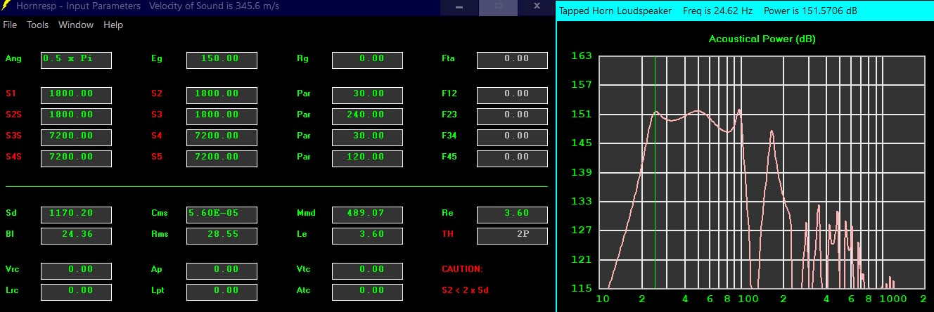

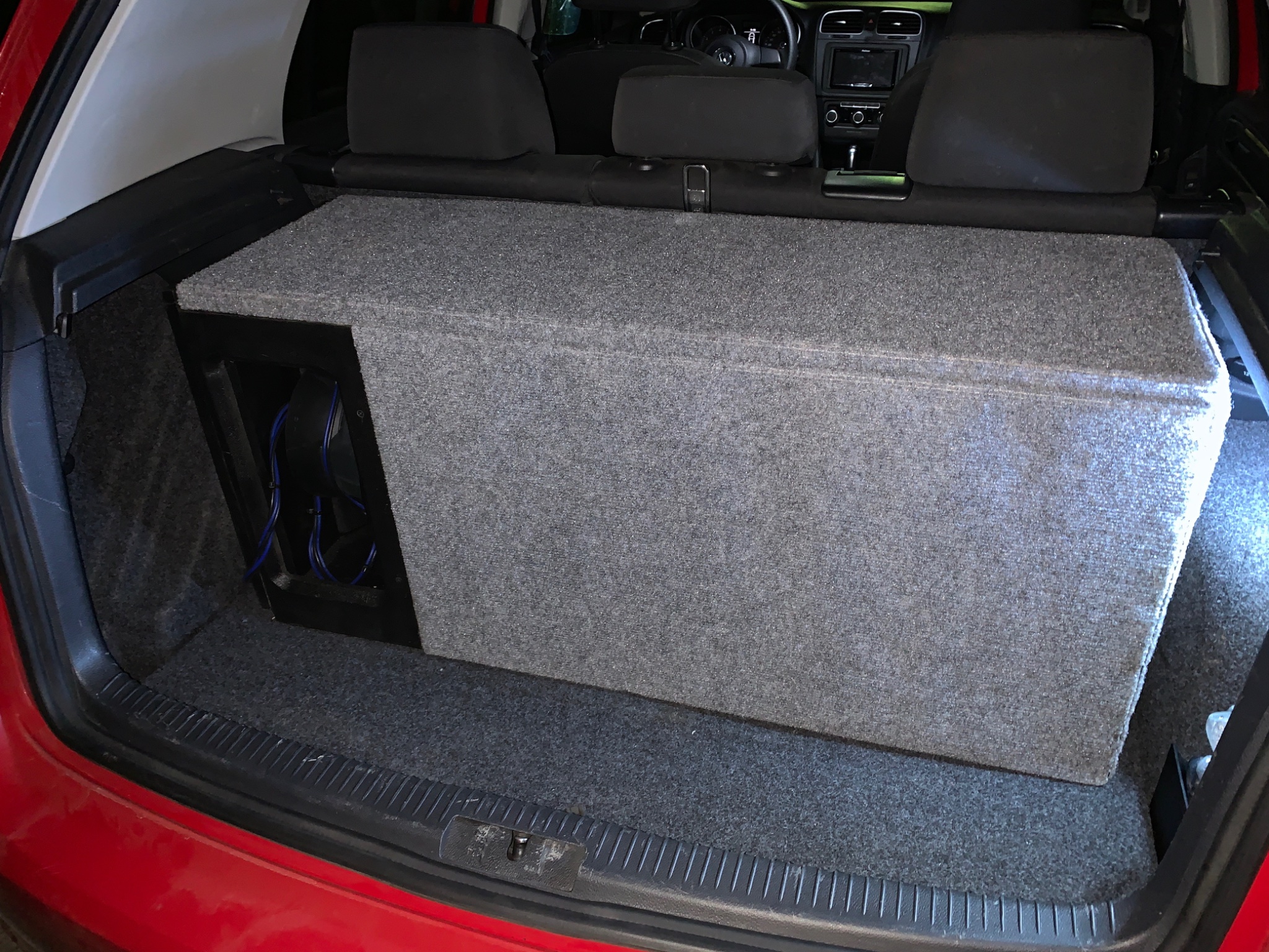

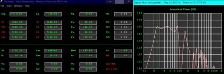

The iron law is so cruel 😄 OG ā€˜roar’ are gangster (resilient sounds ā€˜gold’ series?
150db is nice for 365$ driver. I’m guessing it’s over 20cf enclosure. The platinums are even better. Iron law is cruel but imagine trying to get there with displacement alone. You’d spend a fortune in equipment and you’d still end up the same size. The only drawback is sound quality. Some people prefer the sound.
