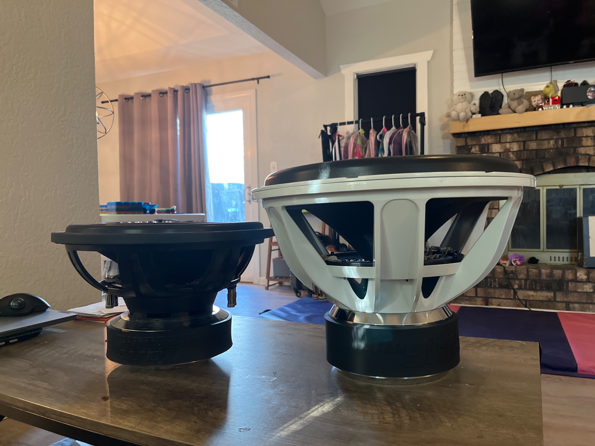

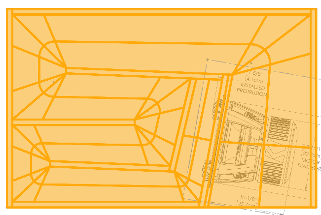

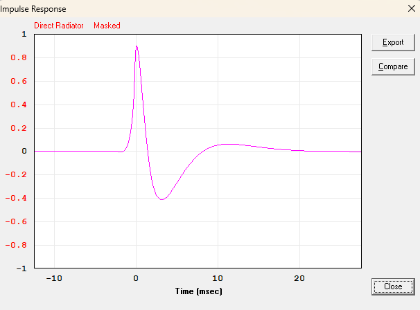

man im sitting here thinking on this. What are my goals for a good truck build after knowing what I know. First of all the sub I built has entirely too much output for my HOUSE. To get my mids and highs to match that level in my truck would be quite expensive and definitely damage my hearing. Second of all I really want something I can get in and out easily, not a huge box full of horn paths. And Id like something with a smooth response and good ir and gd. I mean 160db and hair tricks from a single 12 would certainly impress my friends, but that’s like a tiny portion of my experience with my system. No doubt, in my situation a sealed box is ideal. Resilient sounds sells an 18 that would get me well into the 140s with no gd, perfect ir and 3.5cf of airspace all for 365$. What do you guys think?

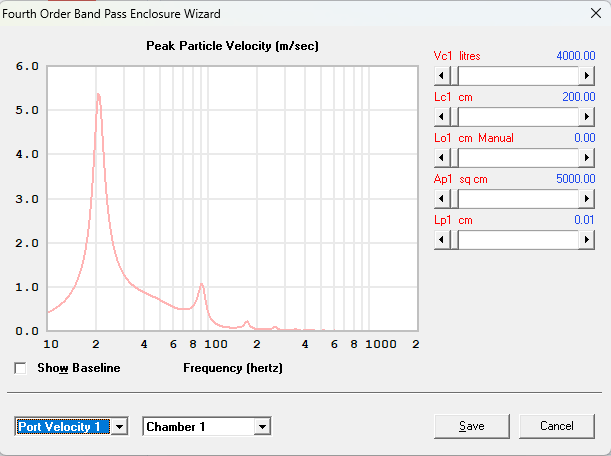

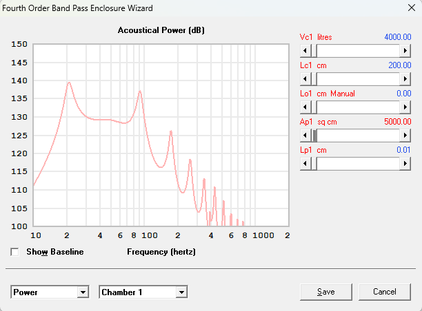

I think something like that second resonace in a mid sized suv (4runner/landcruissr) bit me in the butt a couple times? It was close to the second resonace in the 1/4 wave resonator (paraflex) and went crazy .

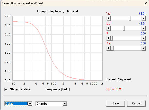

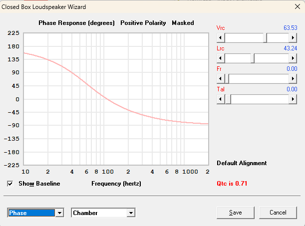

lc1 will make the second resonance vary WILDLY. i put in some numbers that resemble my cabin but these frequencies could really move anywhere. the lower resonance stays low and loud no matter what. i dont know how my seats and other obstructions might affect it. the port velocity is my window. might get to have my cake AND eat it. this box will only be 18.5"x18.5"x23.5" and should really be impressive. once i get my electrical upgraded ill stab 6kw+ to it. 😈 also correct me if im wrong but these measurements should be at the port which is my window which is where my head is. id like to see how this translates.
Yeah, up to and including what we can observe in horn response by moving the driver to ~66.66cm in a 200cm ‘resonator’ ?
could be. how did your measurement in car compare to hornresp predictions?I think something like that second resonace in a mid sized suv (4runner/landcruissr) bit me in the butt a couple times
The way I look at it is set the sub to the mains and have basically zero distortion due to all that dynamic headroom, extremely low VC heat rise, which in turn it'll likely sound like a sealed alignment once EQ'd 'in situ'. Worst case you have to critically damp the vent/terminus.man im sitting here thinking on this. What are my goals for a good truck build after knowing what I know. First of all the sub I built has entirely too much output for my HOUSE. To get my mids and highs to match that level in my truck would be quite expensive and definitely damage my hearing. Second of all I really want something I can get in and out easily, not a huge box full of horn paths. And Id like something with a smooth response and good ir and gd. I mean 160db and hair tricks from a single 12 would certainly impress my friends, but that’s like a tiny portion of my experience with my system. No doubt, in my situation a sealed box is ideal. Resilient sounds sells an 18 that would get me well into the 140s with no gd, perfect ir and 3.5cf of airspace all for 365$. What do you guys think?
That said, if a small, inexpensive sealed cab can actually get it done as you say to your satisfaction.............

all of which come from a sealed box with proper woofer. not to mention tapped horns have higher distortion to begin with. the truth of it is vehicles are already a part of a higher order system which should be considered. the woofer i purchased is predicted to have a 10db/oct rolloff and an f3 of 38hz. cabin gain is generally +12db/oct which starts sooner depending on the size of the cabin and its narrowest point. while its good to have headroom, theres no point in throwing away clean gain. so if i can get to the desired spl with a smaller box and the same money then i cant find a problem with that, if i were to put the box i originally built in there it would render the backseat useless and i have to remove the entire front bench to get it in and out. it will be a while before i get the power i need to reach maximum output but when i do, i would be surprised if i couldnt hit 150db at any frequency in a tiny sealed box.
I used to measure the electrical impedance with the dats in car but too much of a PITA to get laptop and extension cord out to the driveway for me after measuring junk in the garage first (I dropped laptop and broke screen, battery is toast, etc)
I hear you there. The best way is to run tones through your system and chase down any noises. Start low and Use ear protection*. neoprene foam is good for decoupling panels. butyl rubber for dampening sheet metal or even plastic panels
I really wanna see how the paraflex and roar change in the ‘car’ (multiple resonances to potentially join a cabin resonace and go nuts, or not) …I have a 4 door Tacoma I could get them in the backseat of. Laptop battery is frustrating though
