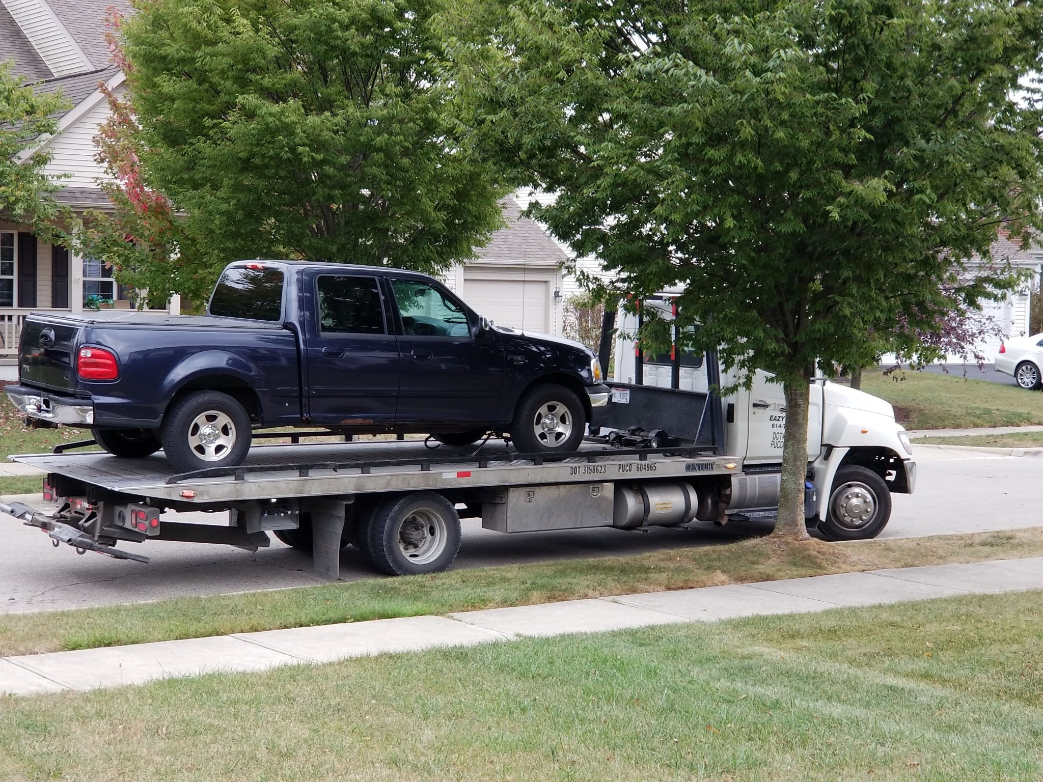

I loved them! I left them in the truck when I donated the truck to Kars4Kids.Cool install I’ve seen those polk momos before. one of the only shallow mount 15s ever made with nice xmax too. What did you think of them?
The brake line busted when I was about to pull the truck into the garage to pull the engine and replace all the freeze plugs due to a coolant leak between the transmission and engine block. I wasn't about to drop the gas tank too. Tho', I did it in the past to replace the fuel pump.

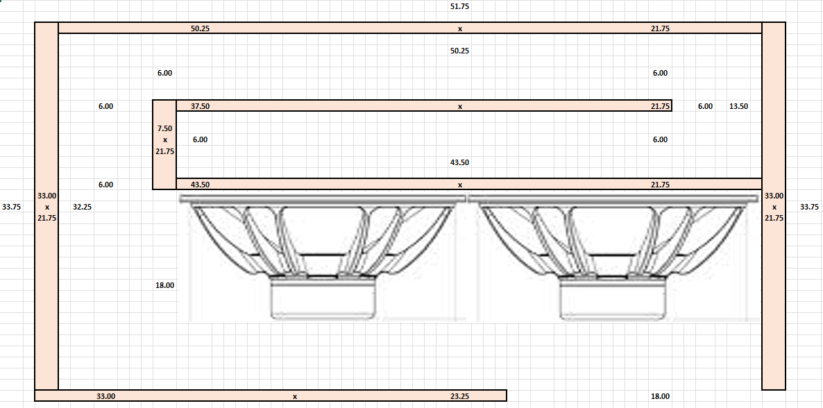

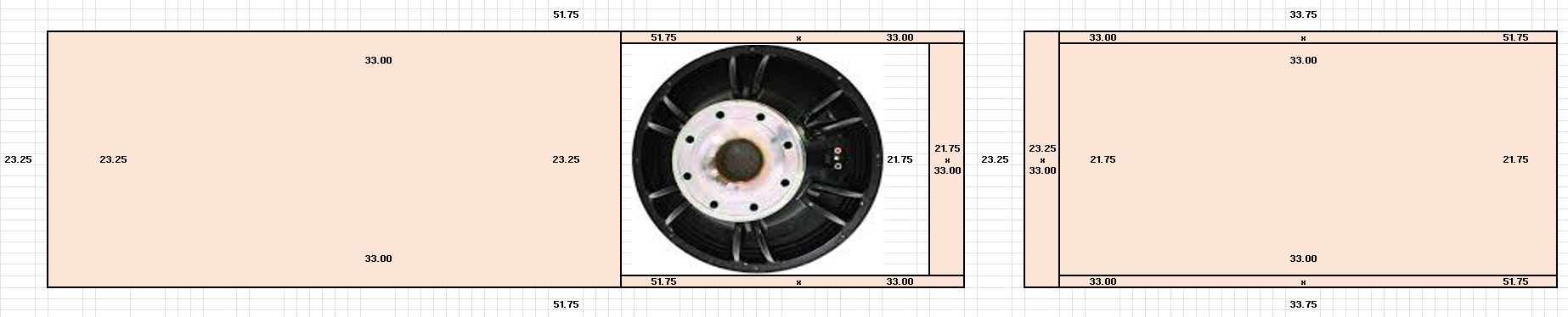

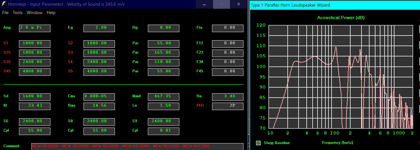

there is the new type O paraflex dual 21" cabinet plans
dual 21's must displace a bunch of air!!!

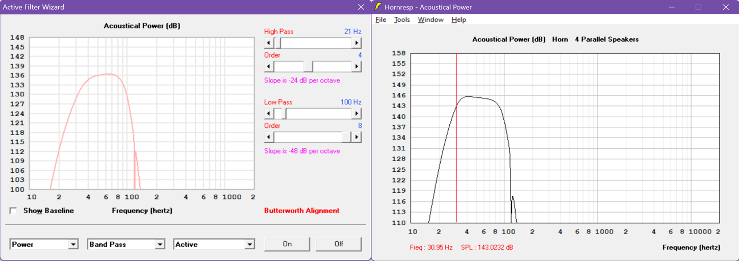

I prefer the hump to be around 80-100hz. I want a rising response around the low pass filter frequency.View attachment 1454347 it could get crazy, small children and pets might float away??
You ‘hump’ at 80hz? 😱 You must be in great shape to keep that going, Is the secret your suspension stiffness ?

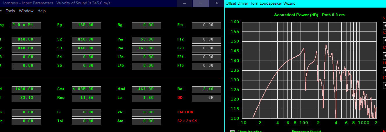

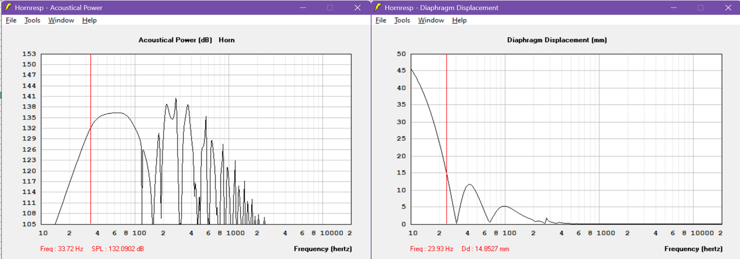

It seems If you’re going to incorporate both sides of the driver in a ‘parallel 1/4 wave’ resonator pipe (Bose wave cannon) that relies on a shared harmonic for its rising rate and ‘efficiency’ you’re kinda stuck in a window of opportunity or a big phase issue (and ringing) forms at 3 x Fb . (Mess around in horn response with resonators that aren’t 3:1 in tuning /length)
I’m Not sure if this video is a related example, but it’s intersting ? Using shared mechanical and electrical resonaces in this case?

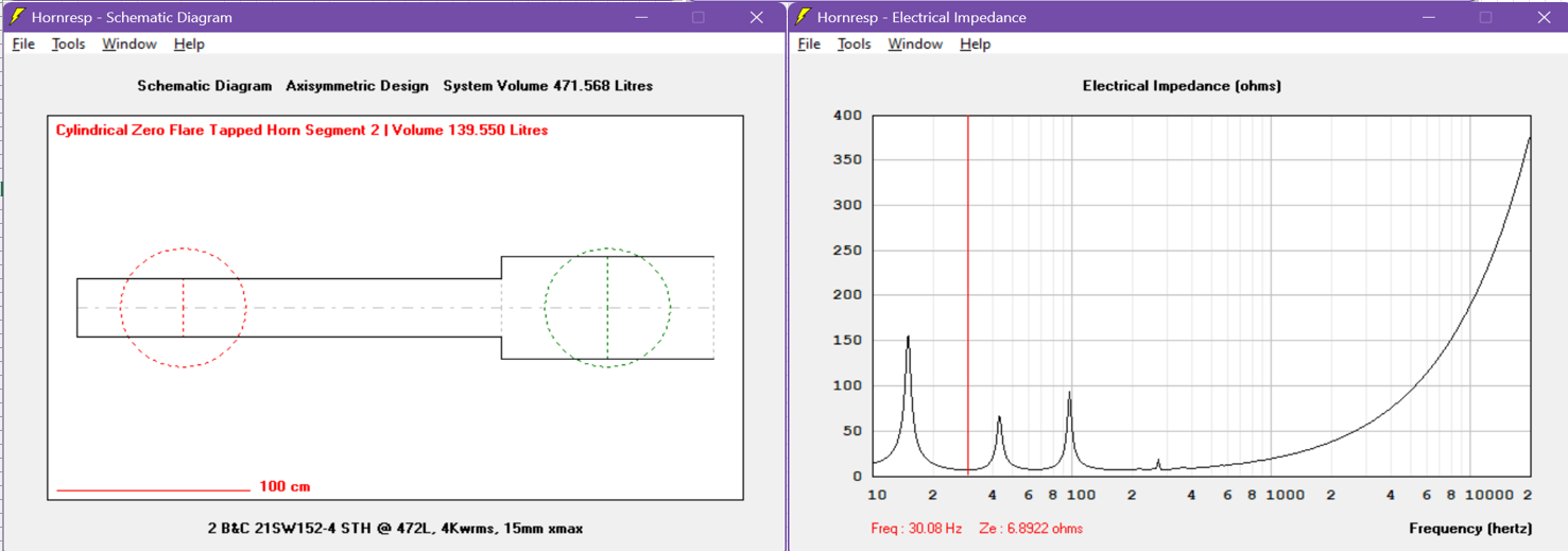

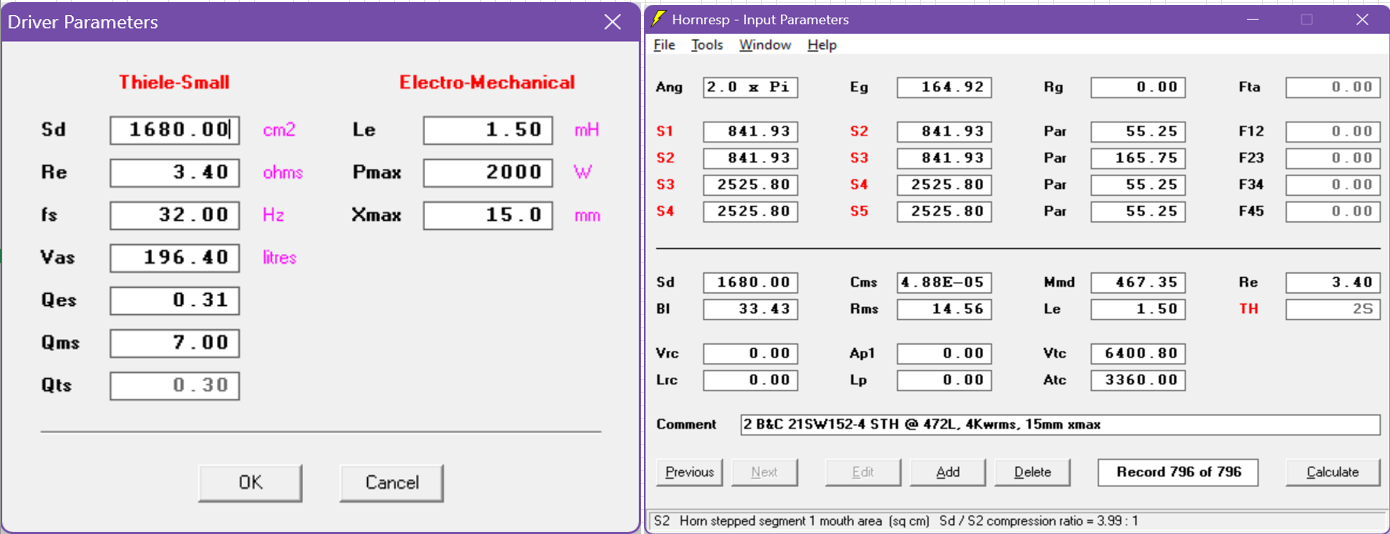

I assumed BW used 2 B&C 21SW152-4's in his Paraflex model based on the Sd and Re.

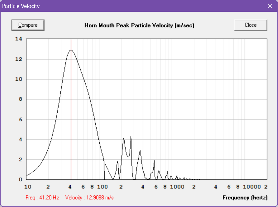

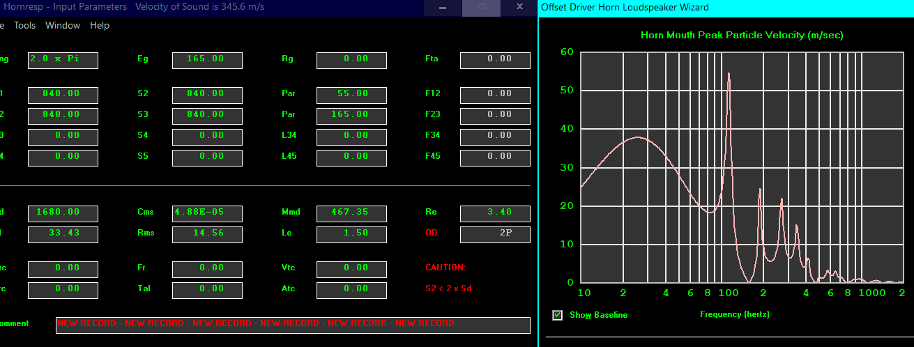

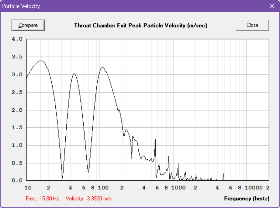

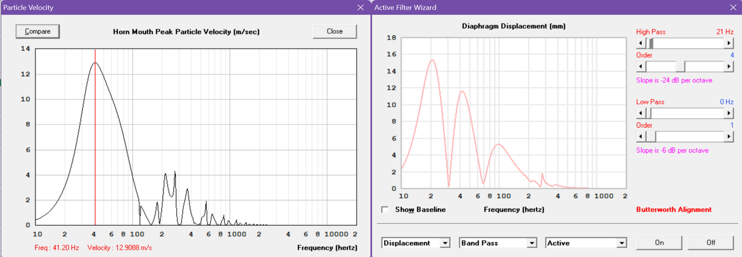

I wonder if you can get away with such a small crossectional area on the upstream pipe and not suffer an increasing turbulence and eventually a loss of output potential @ Fb?
I think That’s where people have been disappointed with these in the past .
Fb suffers greatly if severely overdamped (or the drivers used have less motorforce than assumed by advertised TS parameters)
I screwed up my first two paraflex in a similar way . It had a weak bottom end from a long skinny resonator , then those very easily excited higher frequency resonances were just annoying and ‘loud’

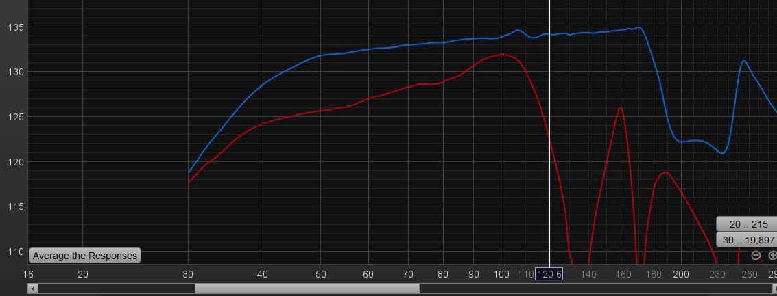

4,000 watts at 6.8 ohms. And, the 165 volts is below Xmax.
I wired the 2 drivers in series since they are Pro Audio.
