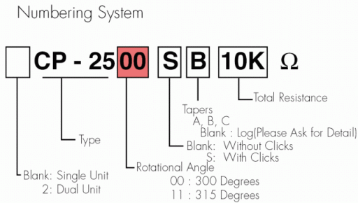

So, the "super-conductive plastic poti" from Germany mystery is solved.
PD: "It looks like TKD pot that someone was selling on a forum, and also available from percyaudio.com"
If not the same TKD as at Percy, then one very similar. Percy Model # CP2511. Thel Model # CP2500.
There dosn't seem to be alot if difference (see pic below)
They are also available at: THLaudio
Regards
James
