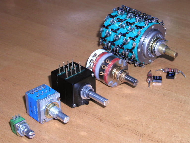

Recently I've been experimenting a bit with different pots. Here's what I tried (from left): Taiwan Alpha, Panasonic, Nobel, PEC carbon, discreet switcher based on fixed series Vishay/tantalum and switching Holcos for shunt.
None of those pots is completely neutral and all of them show their sonic signature when placed at amp's input.

Panasonic was the first one I evaluated. It has very natural sound and it is a rather musical pot. It's signature reminds of Panasonic FC capacitors: involving presentation. The only reservation I had here was the way it was softening the top end. But again, in some systems it may be desirable.
Nobel sounds cleaner than Panasonic and has more high frequency extention, however it's not as musical. If you fancy musicality, you'd better suited with Panasonic, if detail and speed is your thing, Nobel may be the right choice.
Two days ago I received this Alpha pot from Jaycar in New Zeland. As you see, it's very tiny and it could easily fit in a Walkman. It made very favourable first impression. It's not completely neutral, as it shows some slight coloration in upper midrange, but it's not very obvious. Also the detail is very good, but not as good as straight wire.
What I noticed comparing to Nobel, was slight loss of clarity and a bit less of separation and layering of instruments. It seemed that Alpha may had touch more bass
None of those pots was better than a switching volume attenuator built from discreet resistors.

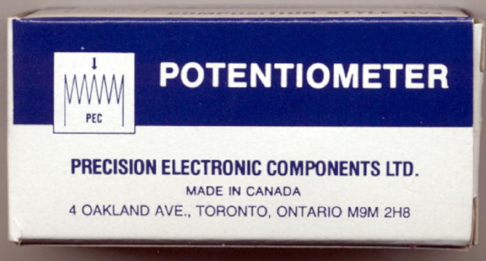

Recently, a forum member suggested to me trying the carbon pot from Precision Electronic Components. Digi-Key carries mono versions of the pot, but since the company is located in Toronto, I didn't have problem with sourcing few samples of a stereo version.

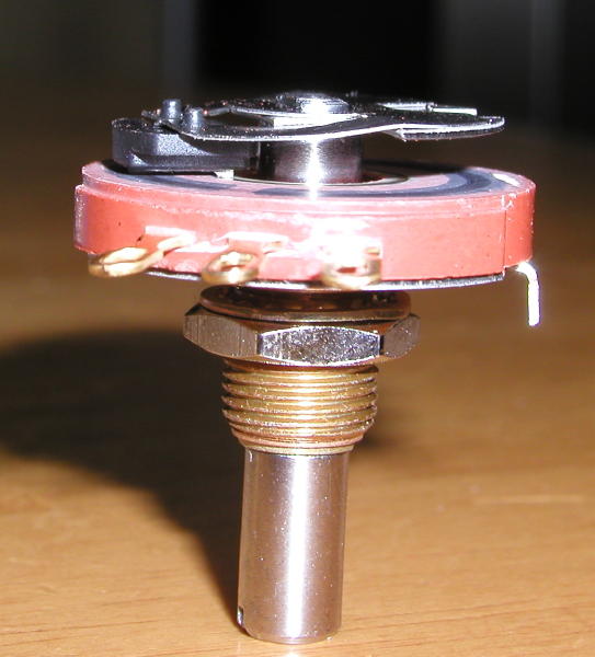

Here's the pic of the inside of PEC pot.

This is what I've been told with regards to their build quality:
Instead of cheap silkscreened resistive elements, they use a hot molded
carbon element, the same hot molded process used for making carbon comp
fixed resistors.
Instead of using silkscreened conductor paths with the terminals riveted to
them (because you can't solder to the silver-loaded epoxy), they use solid
one-piece terminals.
Instead of using spring metal for the wiper conductor, they use a solid
molded slug of carbon. It fits into a molded piece of plastic which is
attached to a spring metal disc to provide the contact pressure.
