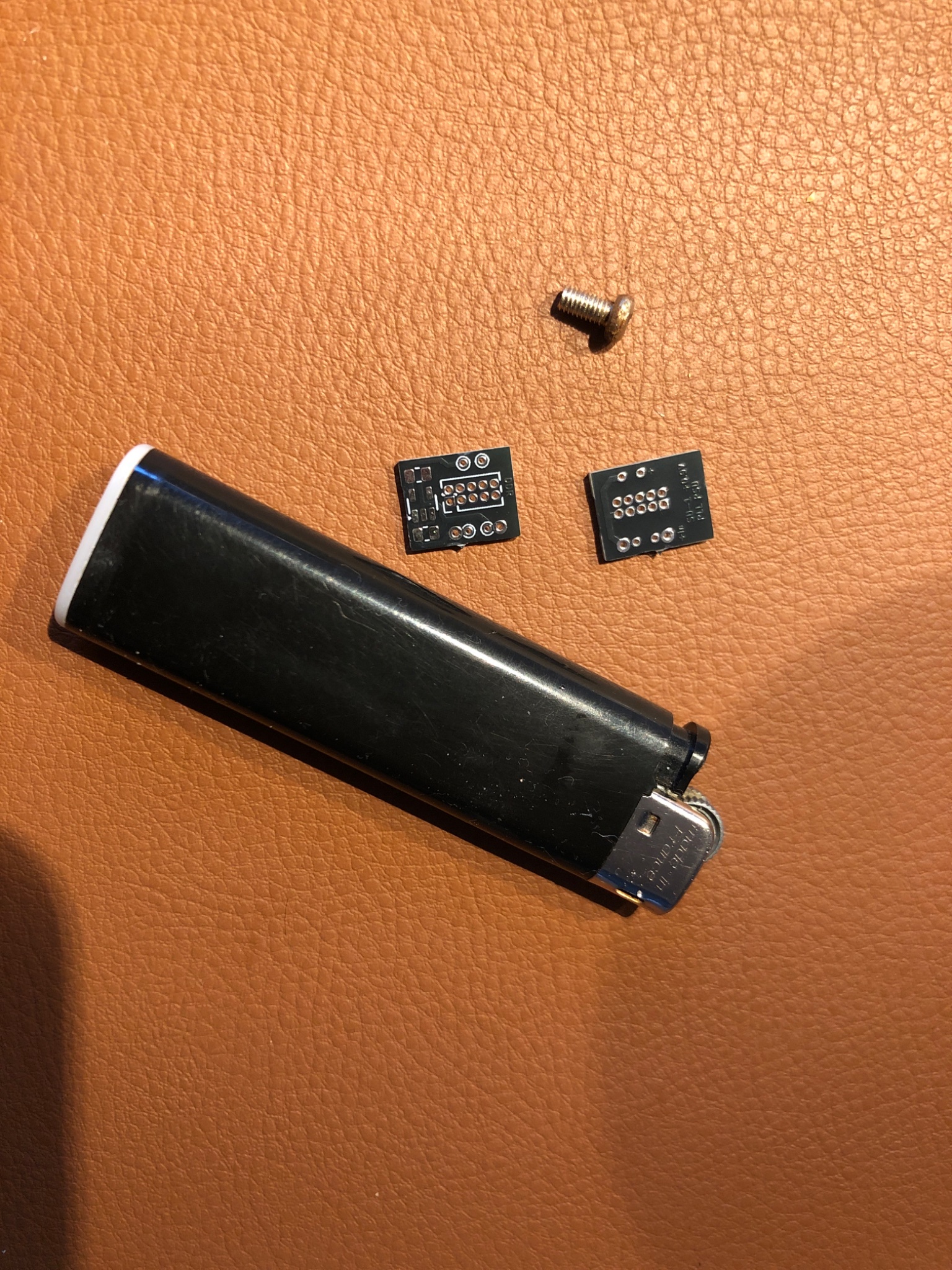

Small indeed. The thinking before acting method versus acting before thinking method conflict pictured in real life 🙂 I could have easily used 2 x 0.9V and 1 x 3.3V regulators instead of just 1 x 0.9V for the PLL as they hardly take board space.

It may not be needed but if I can choose an equally cheap but better specced part that would not hurt would it? I could have replaced all the switchers in SU-1 for linear ones.
Ha I see, just 1 PSU is not the way to go but it was also not OK to have a coil and cap for the PLL PSU pin isn't it? Things are as they are and I will only build the tiny PCB for PLL PSU and be done with it.
A complete redesign of the SU-1 mainboard and power supply lines is not my scope of interest really. A complete redesign of the internal DAC part and/or replacing the SMPS for a linear PSU of my audio player maybe is. 2025 will likely be an external DAC-less year.
No, of course it won't hurt.
It's just that 1117 in SOT223 or TO263 dissipate heat better and are easier to solder to an existing board with surface mount (wires) than SOT23-5.
Keep in mind that if all regulators are linear, they will dissipate amount of power and will require good heatsinks. Especially 1v rail.
By the way, why I use 2 linear regulators in series on the 1V line - one 1.8V and the second 1V:
1) Historically, this came from the XMOS XS1 processor with an external USB PHY, which requires the 1.8V line.
2) Even with the XMOS XCORE200 family (208, 216, etc.) I still use the same thing - to spread the heat between the 2 regulators (but in some designs, this 1.8V is switcher).
Alex.

Of course it can, but how to get 0.95-1V from it for core VDD supply?
Who said that 1V should be obtained from 1117 to 3.3V?!
Of course, it is possible, but there is no point - too much heat will be generated on it.
I have already said how I did it - from 5V there is a regulator for 1.8V, linear (1117-1.8) or switcher (LM3671MF-1.8), and after there is a linear one for 1V (TPS72010 or AP7365-10YG-13).
3.3V - separate 1117-3.3 for XMOS I/O and I2S isolators (Si8661).
Alex.
